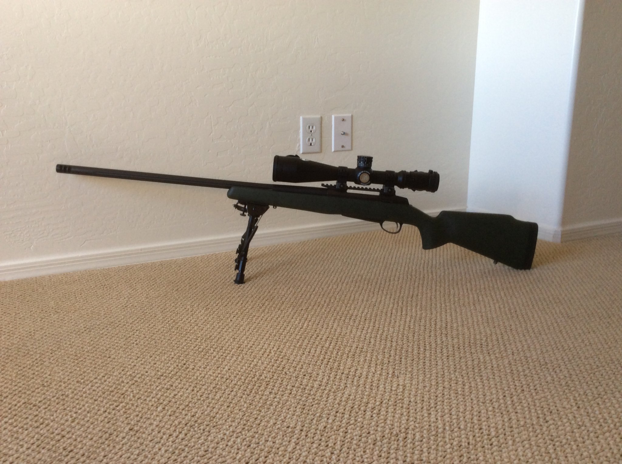

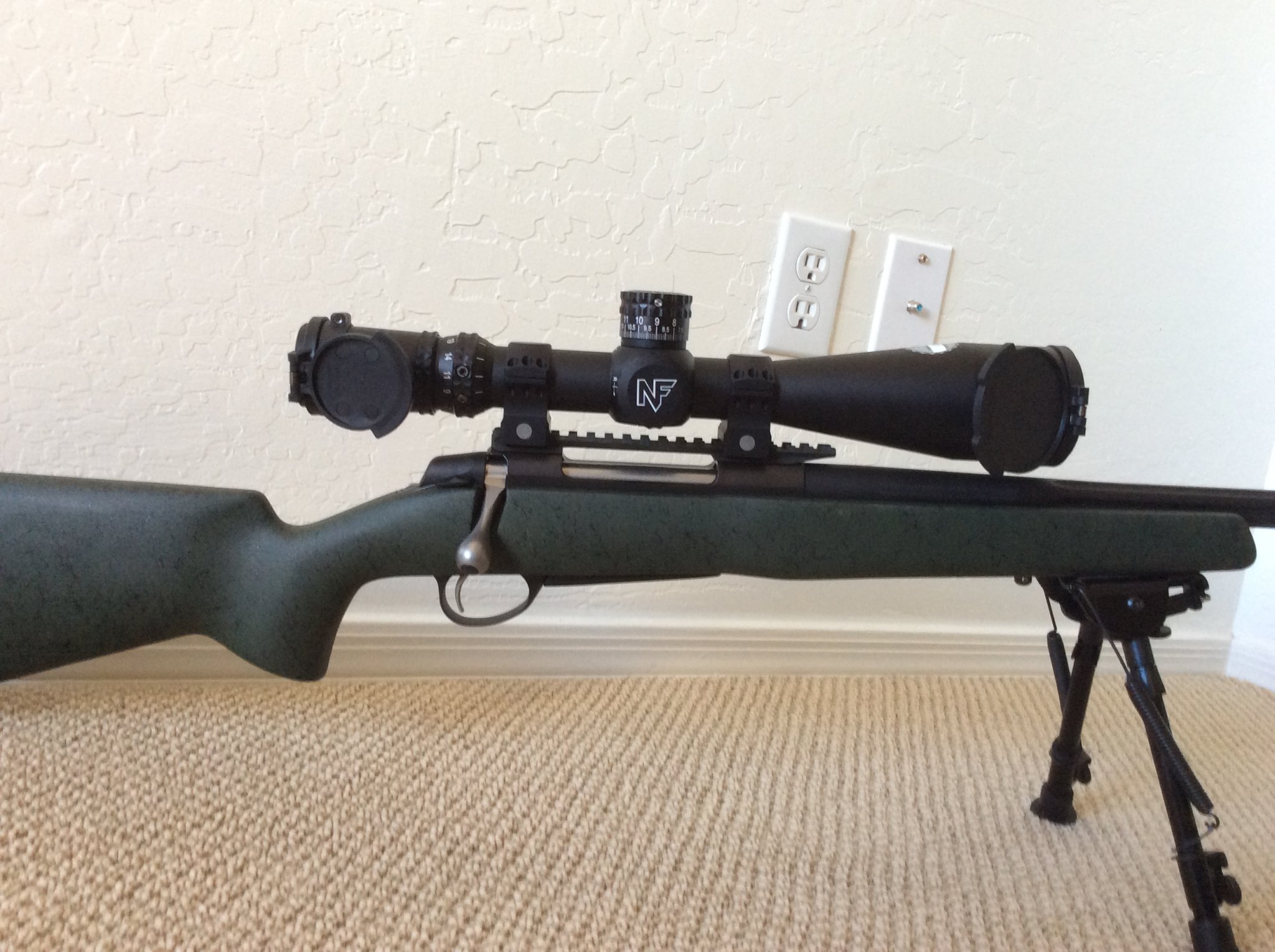

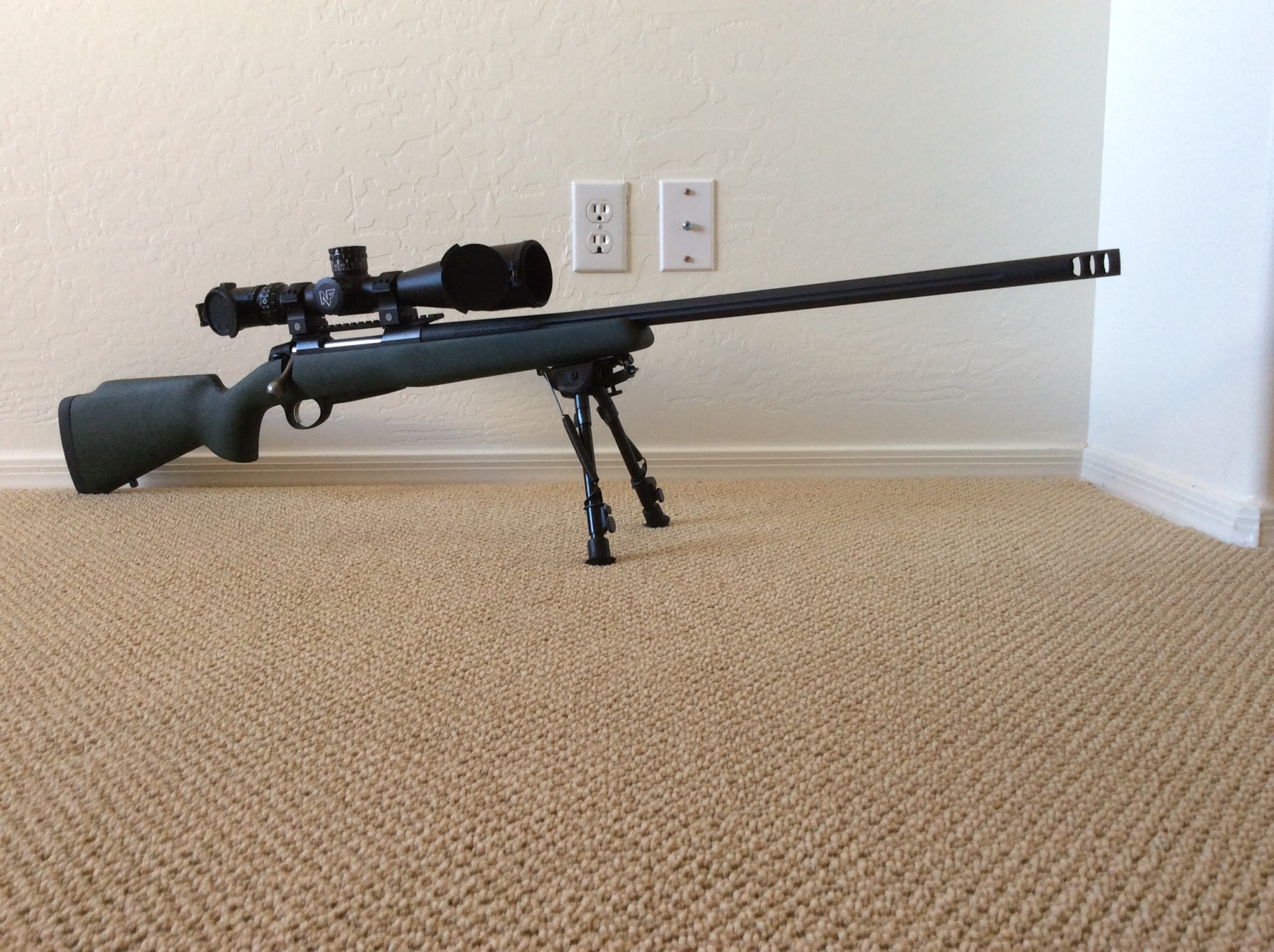

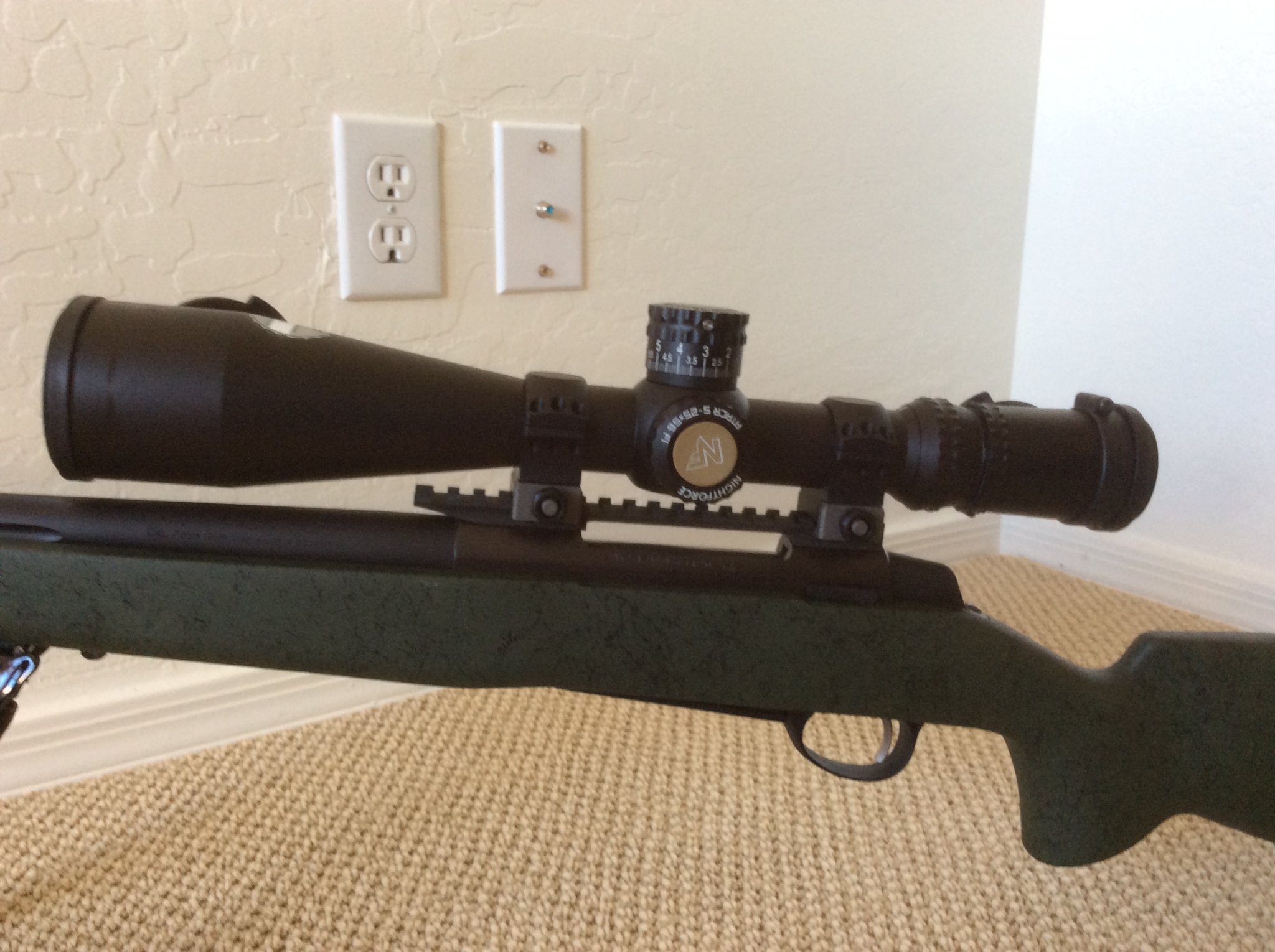

    Progress.....not as nice as most of the Hide but she’s mine?? Scope is here, finally decided on rings and that sexy pig is mounted up. So stoked right now? was going to go SPHUR but decided on all Nightforce, take the balance of what I would have spent on the SPUHR and ordering up a QD Atlas as I can’t take this Harris anymore. Nightforce 6 screw rings are no slouch sitting on top of a Nightforce 20 MOA rail cleaned and tourqed to spec with a fat wrench. Having the choice of green or red illumination is awesome and love the simplicity of the MilR reticle. Intend to dial and hold for wind.
    Progress.....not as nice as most of the Hide but she’s mine?? Scope is here, finally decided on rings and that sexy pig is mounted up. So stoked right now? was going to go SPHUR but decided on all Nightforce, take the balance of what I would have spent on the SPUHR and ordering up a QD Atlas as I can’t take this Harris anymore. Nightforce 6 screw rings are no slouch sitting on top of a Nightforce 20 MOA rail cleaned and tourqed to spec with a fat wrench. Having the choice of green or red illumination is awesome and love the simplicity of the MilR reticle. Intend to dial and hold for wind.View attachment 6915253View attachment 6915254View attachment 6915255View attachment 6915256
    very nice.either get a stock pack and build up with foam or buy a kydex adjustable cheek piece.
    You're going to need to raise your cheek weld.
    I really like a good stock pack with some foam underneath. not only does it provide proper cheek weld, but they have a small storage pouch for batteries and small tools.

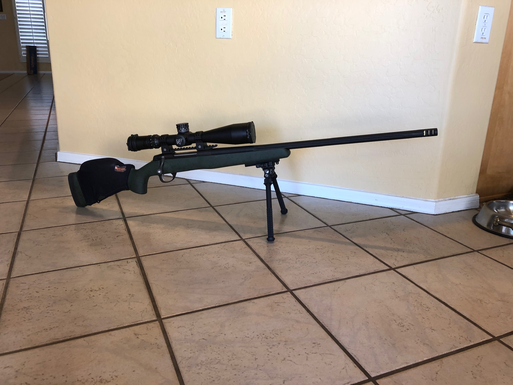

    Got a stock pack but it was way to high but your right. Don’t care for the jaw weld thing I have going on? Do you have a brand recommendation?
    Need another torque wrench as I can’t get 100 out of what I have. My fat wrench is 65+
    That's what I figured. Those 6 screw rings really need 100"#'s of torque, as the wider clamp won't hold as well at 65"#. Borka makes one. NF also has one. Both are way better than the FAT wrench, ime.
    Was going to try and source one locally in the morning as I have been the victim of my own stupidity before? Actually just started doing all this shit for myself because of mistakes others made when mounting things for me and having them walk. Practiced with my SHV while I waited for my ATACR. Hunted all my life but these are the first fully functional scopes I have owned and extremely pleased with both of them.
    Well she’s done.....for now? screws are at 100# and I ditched the Harris as I broke it last time out. 2nd one I have broken and I’m done. 7” QD Atlas, GG&G bipod adaptor and share it with my other rifles.
