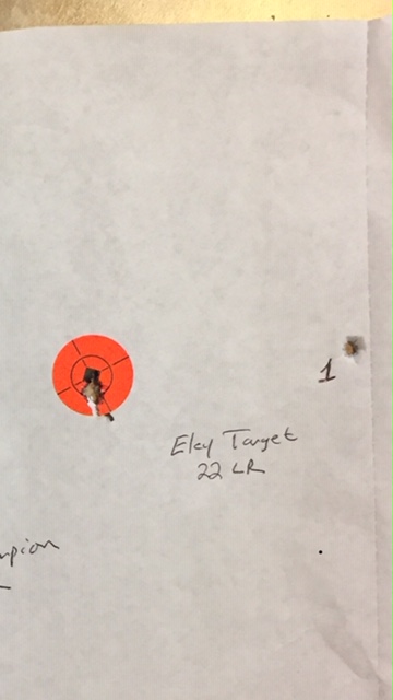

I meant no offense to you sir. I've studied this for a very long time. I've seen the problem over and over and over, again.
There is an entire thread dedicated to this anomaly in the CZ forum over on Rimfire Feminist Central. Most often they try to attribute it to the not so illusive carbon ring. They will scrub new dimensions into the chamber in attempt to rectify the problem , to no avail.
A carbon ring has 0 to do with the problem. Most 22 rimfire rifles will exhibit this problem because as I said, it IS a huge problem in the rimfire industry that is well known by the manufacturers, that they overlook and do nothing about.
Most people do not even know if they have the problem or not and here is why.
Buy gun, scope gun, ........start shooting gun to zero in.............get gun zeroed in, gun is accurate.
It is not until they start missing things wildly on the first shot that they start to investigate.
Most will chalk it up to an errant load. And many will accept that it is just the way things are for a 22.
Some won't even admit that the problem exists. And then comments like, " I can still hit a squirrel, so no big deal.
But it is a big deal with squirrel hunting. And here is why. There have been too many instances to count where I had to thread a shot between limbs of trees through a window smaller than an inch. Or time a shot on a squirrel moving back and forth in a slight wind, on the tip of ......or at the very end of a limb. These are impressive shots , especially if you have a witness that you're hunting with. " Wow what a shot, how did you do that!" The first thing needed is a gun that does not throw the cold bore shot , any which way.

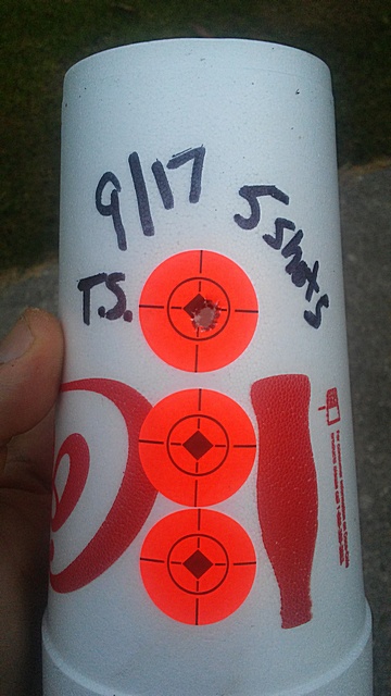

Here is an example of a target that I shot yesterday. They are shots 1 through 5 at 50 yards from a Vudoo gun that hadn't been fired for about a week. My guns are not kept in air conditioned rooms. Yet the temperature will still be slightly different from inside to outdoors. Not enough to cause condensation.
So the only thing that I did was allow the gun to sit outside for about 5 minutes before shooting this grouping. If you bring a gun from the inside to outdoors and moisture forms on your scope lenses, then that means it is also happening in the bore of the barrel. Which in turn wets the gunk thats in the barrel, which will not dry out nearly as fast as your lenses clear, or your barrel sweat disappears. This will indeed cause a flier. With a 22 , condensation in the bore is a big no no. This is why my guns are kept in a place where they are equalized.
So anyway here's the target. Feel free to call bullshit.

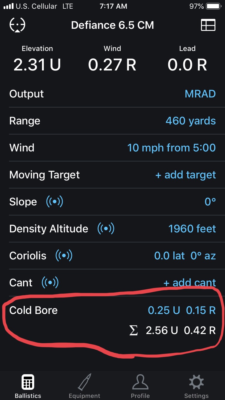

So is the suggestion here that an "accurate" gun should exhibit zero difference between that first cold bore shot and the rest? As a hunter I have definitely experienced a lower POI when the gun and ammo are 28 degrees vs 78. Maybe an inch over 100 yards. Much more so with a stone cold suppressor (which also contributes barrel droop). Now, if we're talking left/right (windage), I agree-- and my guns don't shift POI like that. But surely there is some physical difference in the speed of chemical reaction, friction coefficients, bore constriction (no matter how minute), etc.
Or we talking about a completely different phenomenon? I am talking about centerfire rifles, is this just about 22LR?

I'm having the same issue. Is it riffle, ammo, or shooter error that's my issue? I'm shooting an RPR 22 at 50yd 5 round group and haven't noticed it with my otherView attachment 7159286
This is terrible. You have a real problem on your hands.
That is entirely unacceptable and demonstrates exactly what I've been talking about for years.
That is not shooter or ammo error. Even the lousiest shooter in the world can shoot better than that and would have to be trying to get that far out at 50 yards.
T.S.
Is that a cold bore, or a cold and clean bore? Though that much shift is still uncalled for. After a very thorough cleaning, my very first shot out of the rifle @ 100 yards is usually about 3" low. To have what looks like 5" to the right @ 50 is just ridiculous.
You would be surprised if you knew how many guns exhibit this problem. It's a problem in the industry.
