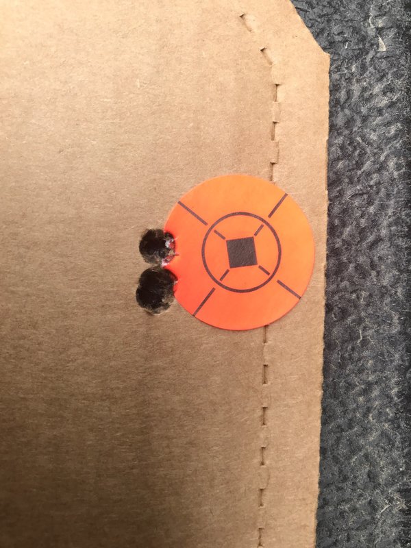

Got to try some of the new Hornady 108 ELD 6mm Creedmoor today in my GAP10. Shown below is the first 5 shots out of the rifle. Not too bad. The first shot was the high left. It was a cold bore/cold shooter shot.
I also shot the loads at various distances and found that the rounds would hit slightly lower than my Berger 105 Hybrid loads. My shots at 700 yards were 1/2 mil low. Wish I could have tried 1000 yards, but the range was still snowed in.
I hope we can buy these bullets soon. Would like to try them in my own reloads.

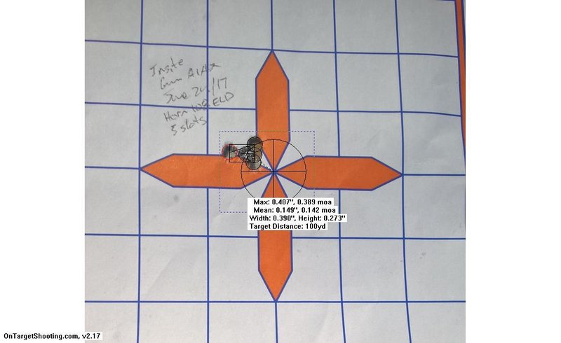

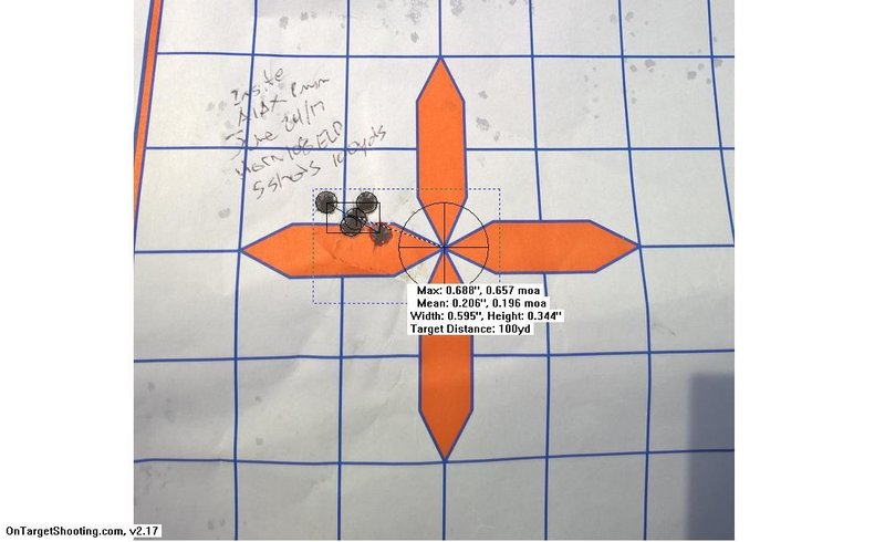

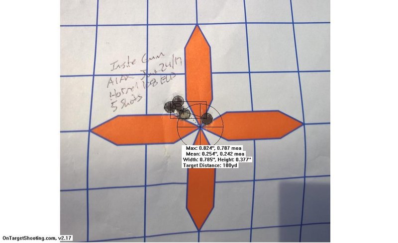

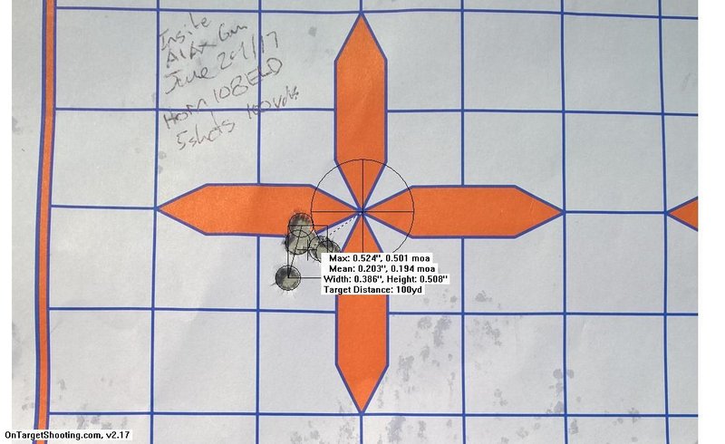

Factory Hornady 108 ELMD from my AI AX. Shot from bipod and rear bag off an old wood bench.
Hornady 6mm Creedmoor lot#3163698 measured with magneto speed, 26 inch barrel.
10 shots
Avg 2977
Sd19
Es58
