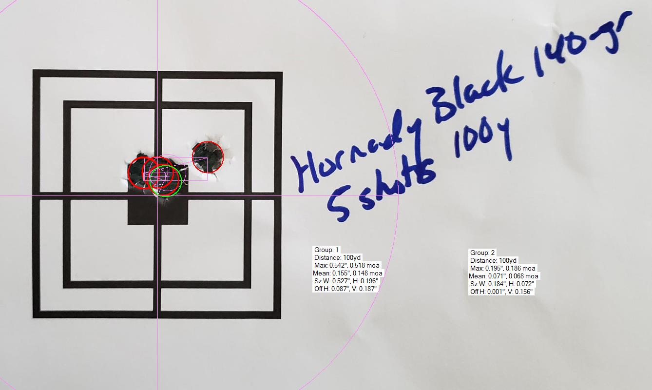

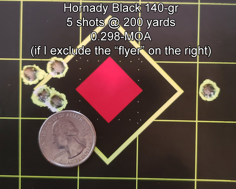

    But, then with American Gunner / Black, I get groups like this:
    Calculated with and without "flyer." :)
