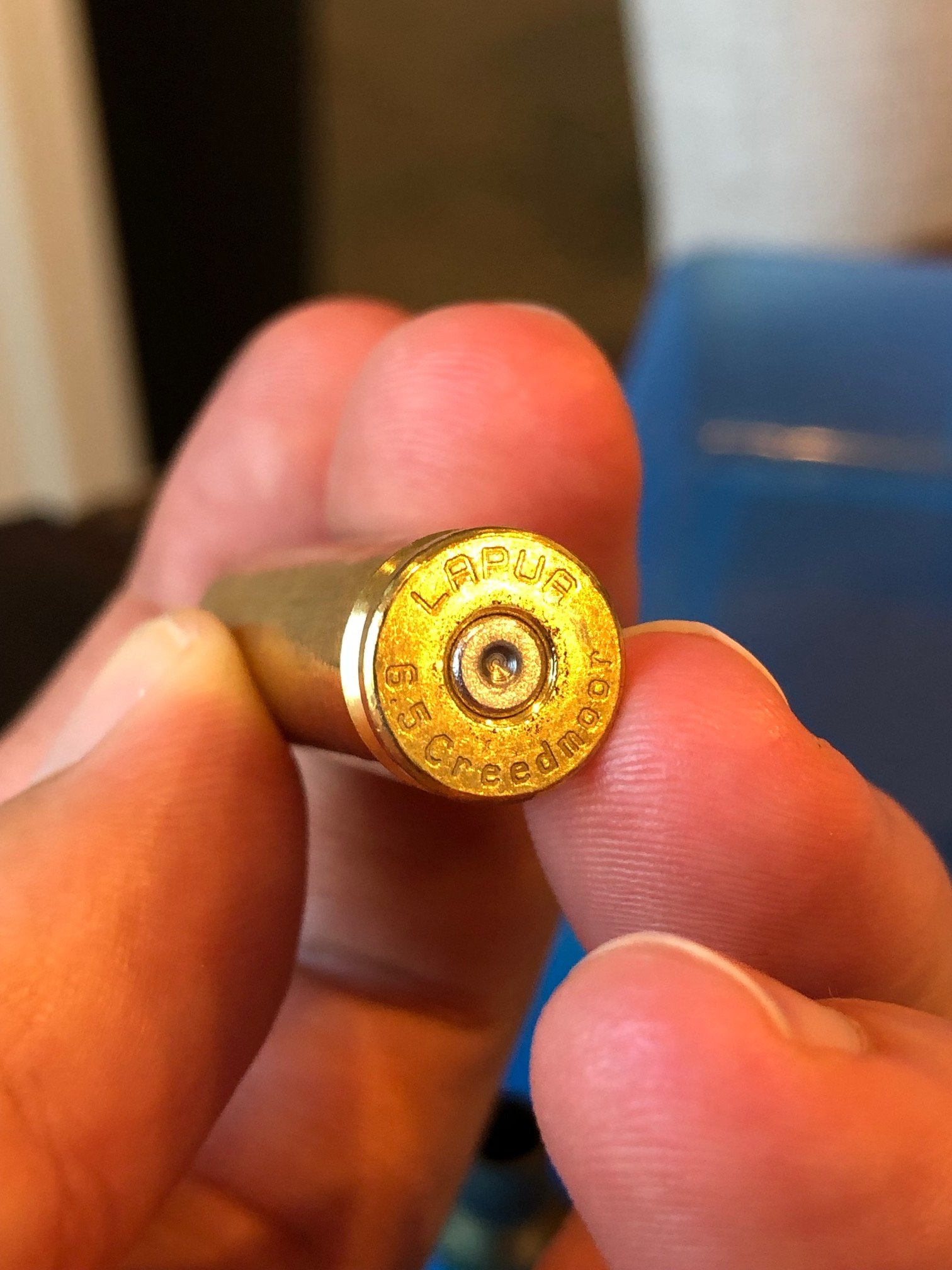

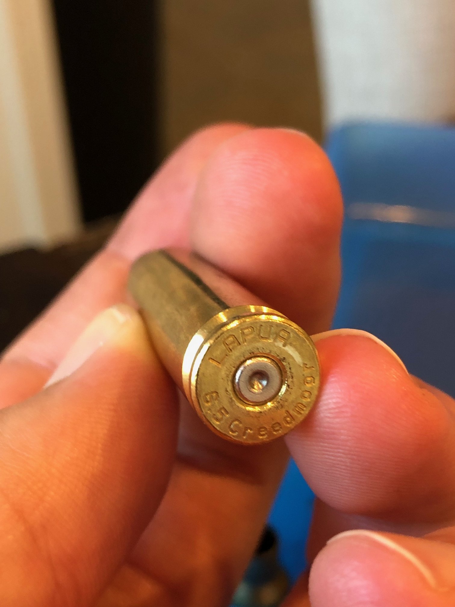

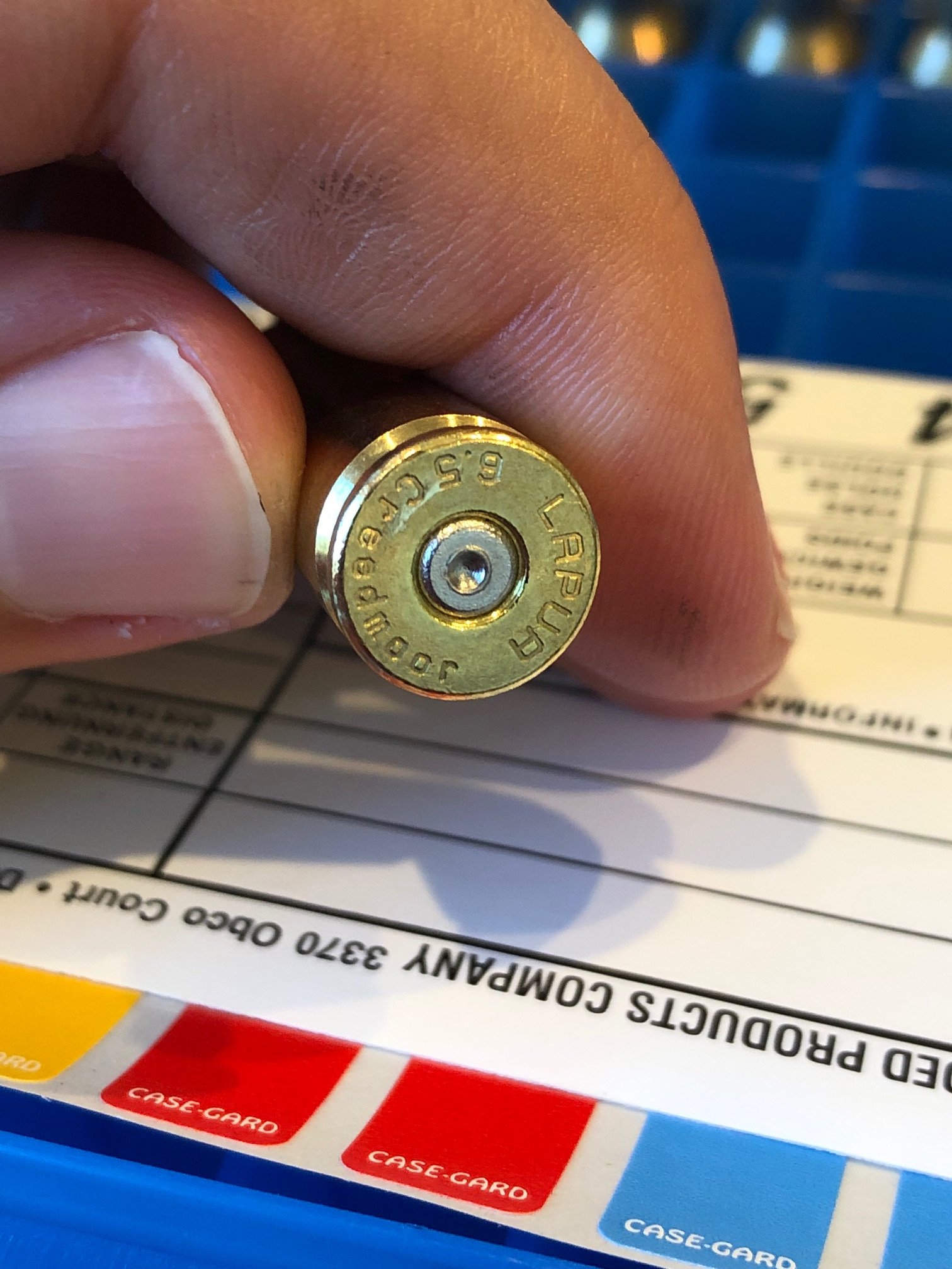

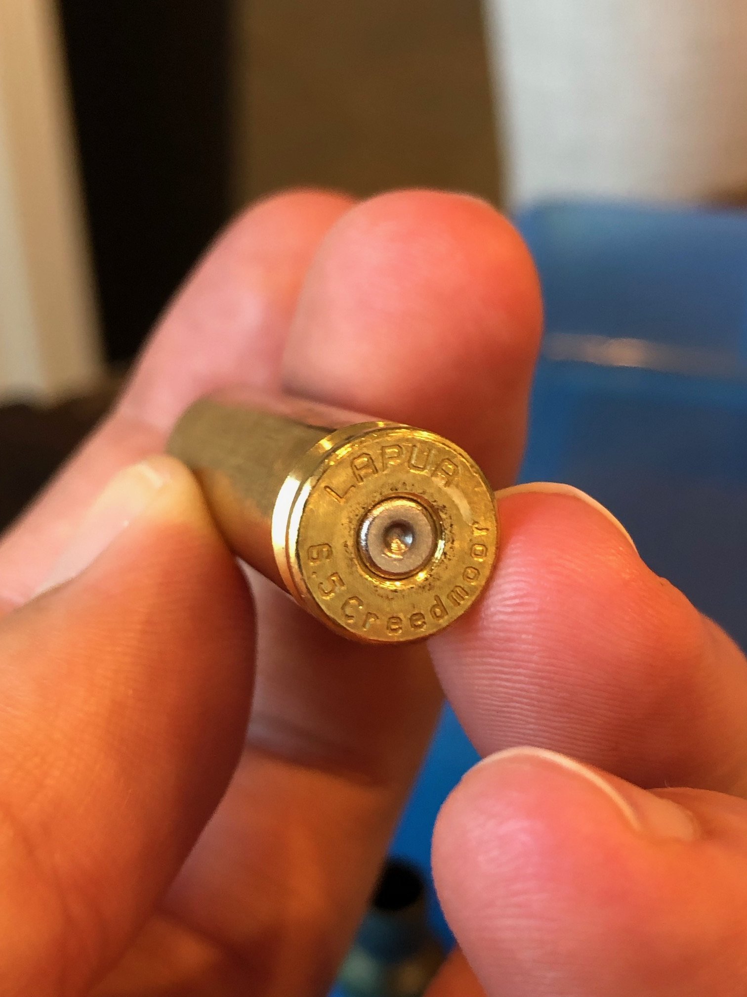

2. I did not see any signs of pressure with any of the loads. I was not expecting to shoot all 20 rounds. I've included pictures of my 20th casing as well as my 1st. There were no appreciable differences. Overall the Lapua brass from the loaded ammo had slightly more resistance when extracting vs the hornady factory ammo, not sure why (or if it was all in my head lol). This was noticed immediately even with the lightest load. However, there was no difference between any of the loaded rounds. (see pics below)

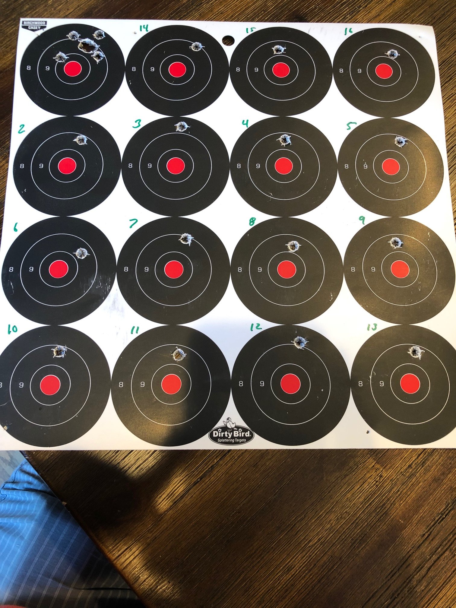

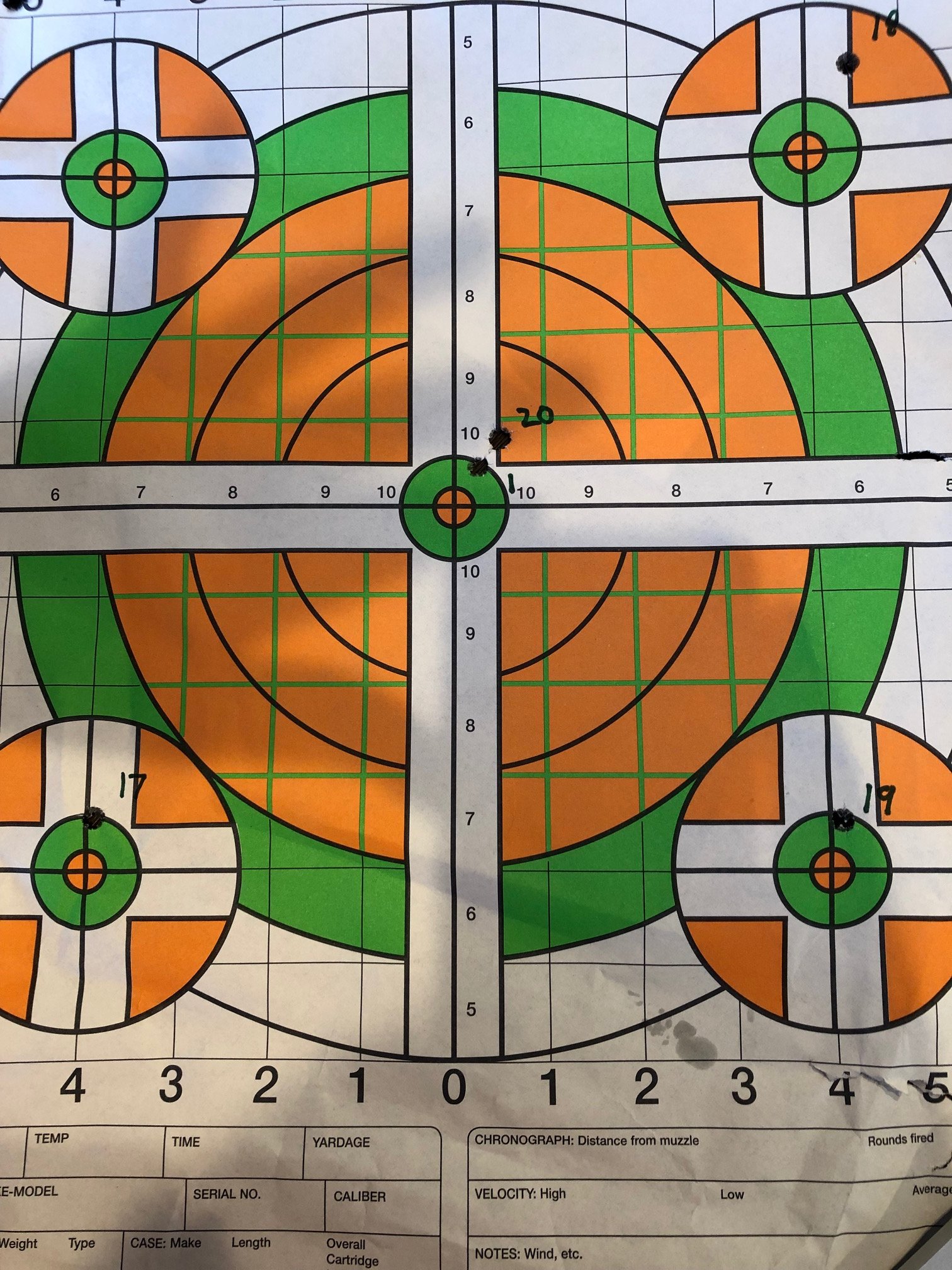

Top left target was factory ammo, I was having a hard time getting my chrono to read, it was my first time using my labradar with a muzzle brake, but once i figured it out it performed flawlessly. Round 1 was shot at the large green and orange target, to be honest i was not sure what to expect with my first ever loaded round so i wanted to make sure I hit the target. I then started on then started my string of shots beginning on the 2nd row. However i realized i only had 15 targets remaining on that specific sheet. I ended up shooting 18-20 on the green and orange target as well. All shots are marked with the corresponding number.
Now for the advice portion... Should continue to increase my charge to figure out what max load is? Or should load in 0.1 gr from 41.8-42.4. 3 rounds of each? This should give me more information on SD and ES. Or is there something i am missing?

The first 2 pictures of brass are the lowest load, the 3rd and 4th picture is the hottest load.

It's rare for guns to shoot their best at Max anyway. Primers are not a very good way to check pressure
Reactions: michiman
primers are not a good way to check pressure but if their edges are round I doubt you are at max pressure for your cases. you can also experiment with neck tension and federal primers.

From this target, I would look at the loads for target #3 and target #12. They are both higher than all the other targets; this might indicate a node, since one indication of a node is that the barrel is at the top of the vibration wave, sending that bullet higher than others which are not loaded at the node. You might shoot 5-shot groups with the loads for those two targets, and look for the one that has the least vertical spread. Minimal vertical spread is another indication of a node. If the horizontal spread is still too much, pick the load you like, and change the seating depth in 0.005" or 0.010" increments, and see if that eliminates the horizontal variation. Do not be hesitant to switch powder, maybe Varget or H4895. Some rifles simply shoot better with different components. It's not predictable.
Reactions: michiman
Side note- measure the fired brass headspace and see how much it grew on the first firing. If it grew a lot you may see more velocity/pressure on the second firing. The energy used to stretch the brass on the first firing will have to go somewhere on the second.
Reactions: michiman
3 and 12 were light loads. Roughly 2400 and 2500 FPS respectively. However 18 and 20 are also a bit higher than the rest and are in the 2700’s.
I’m not sure you would want to choose the 2 prints that were out of the norm. I would say do the opposite. Most of the others printed in about the same spot. That likely means it will be an easy barrel to load for.
While I think the 1 shot per charge weight might give you some useful info, I think maybe it is best to load 3 or 5 of each charge weight. You'll want to look at the average MV, ES, SD, & group size. This will provide you with much more info to make a better decision.
I think that shots 8-11, 13-16, & 19-20 all had a very similar POI which at least is something you want to look for.
