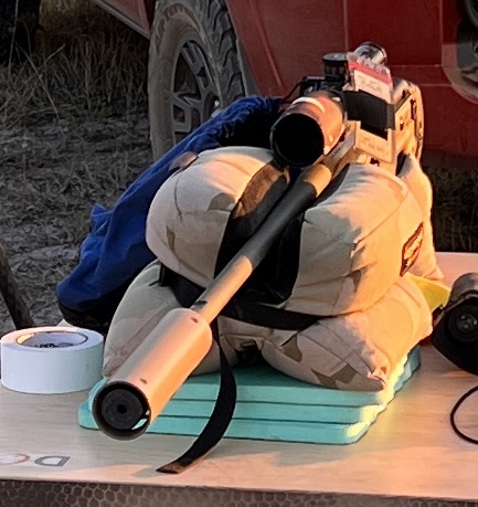

Thinking about the setup. Only the S&B was in my shooting x-bag, like shown below.
This was taken earlier this summer, so the light shown is not representative of the test.
The other three guns with scopes were on tripods.
I wonder if light could be bouncing off the light tan camo bag top and causing flare…hmmmm.
Ugh, more tests lol story of our gun lives.
