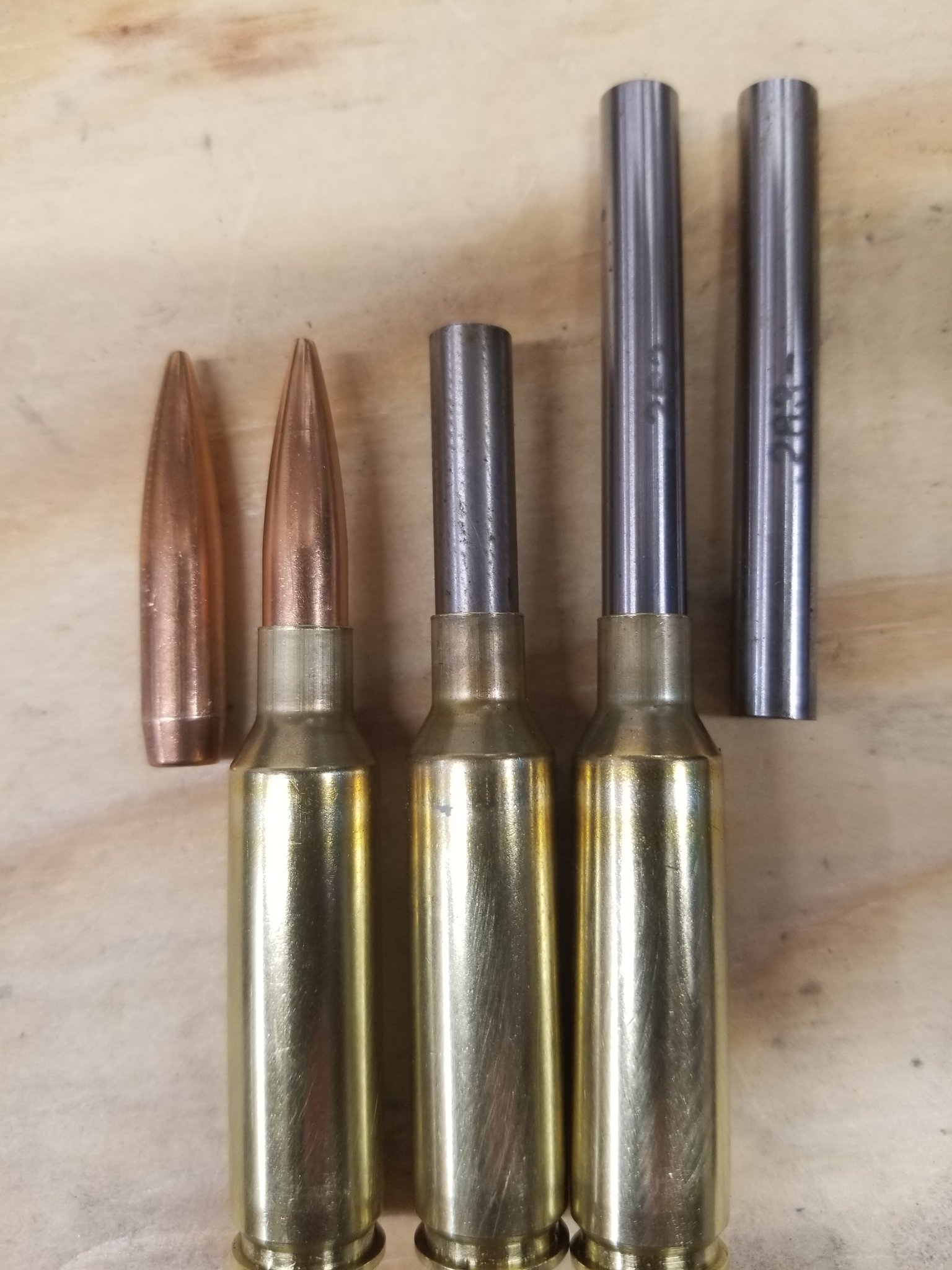

Force gauge almost maxing out.
Halfnutz
  • Jan 14, 2008
    1,898
    1,867
    Peoria County, Illinois
    Not sure what's causing this.
    I just started annealing with an Annealeez and using 750 tempilaq inside the case neck to set the timing.
    Removed the expander from Hornady Custom Grade 6.5 CM dies, so I am only sizing the neck down and bumping the shoulder. Then run them over a 21st Century Mandrel die (tin coated).
    Checked the necks with a .262 pin and the pin is stopping at the shoulder and case neck junction. A .261pin drops straight through. .263 pin is snug and takes a bit of pressure to start.
    Tried seating a few bullets and they start at about 30-40lbs on the gage. Then it takes all they way up to 150+ to seat all the way.
    Trimmed case length is 1.910.
    140gr Bullet length is 1.340
    COAL is 2.820.
    I have the boat tail past the neck slightly.
    Tried this on both Hornady and Nosler brass. With and without powder and am having the same issue.
    I haven't found a bushing die for 6.5CM in stock.
    When u anneal an oxide forms on the neck and interferes with bullet seating. You have to use dry lube on the inside of the neck to return to normal seating pressure.
    Tried that too. No love with imperial dry neck lube.
    The inner donut is there for sure. I can push the .262 pin through but it takes some extra pressure.
    No no no
    You don’t use a q-tip for this. You can use the ceramic media or dunk the neck in the graphite and tap the neck on a hard surface to get the excess out. Then you run the mandrel through, then back into the graphite before seating the bullet.
    What size mandrel are you pushing through the neck? I have been assuming it is a .262
    I can honestly say I have not measured it. But I will.
    I bought the only 6.5 tin coated that 21st Century sells. I didn't know what to expect for spring back so I didn't get into the custom sizes to start.
    I just received a Sinclair for .30 cal but haven't tried it yet. I haven't ordered a seater for .308 (.308 or 300WM) yet. I wanted to see how this first 6.5 went.
    COAL is 2.820.
    Your bullet is hitting the doughnut at the shoulder junction causing the heavy seating.
    Try a little test, push the mandrel in and out of the neck 3 or 4 times to iron out the doughnut then try seating the bullet.
    You say you can't find a bushing die (look at Whidden's site). I think you are sizing the neck down too far and then expecting the mandrel to force it back out to the correct size. In my opinion a mandrel can only open you back up a couple of thousands without having issues. Try it with the original sizing ball in it and see what happens. You could also size it with the die, anneal it again and then use the mandrel to finish size it. I think you need to find a bushing die or have your standard die honed out so that you are not sizing down so far.

    .262-.2625, with calipers.
    And what’s your outside sized vs loaded neck diameter?
    I think more lube during the mandrel process would be warranted almost always. I purposefully stand them up and spray lube in the necks from four directions before spraying the sides and shaking and then sizing and expanding. It just works better for everything.
    And since then I’ve only had issues with the oxide residue crap. Have you run a brush through the case necks? It made a world of difference for me. Just a cheap nylon brush before seating makes it smoother and easier.
    Very well could be a donut if your pin gauges are catching die to that and not plains thickness inconsistencies.

    I suspect he is collapsing the neck shoulder area slight when he is using the mandrel. More lube and brushing is good advise.

    Thanks for all the input.
    I have ran a brush through.
    I have dry lubed before the mandrel and before seating.
    Via the pin gage there is an obvious internal donut and it shows when seating.
    I will start looking for a bushing die so as to not oversize the neck down when bumping the shoulder. The Hornady takes it well under. Probably not conducive to brass life either.

    Thanks for that link. I had read most of that thread when it was first started and thought it applied to my situation but hadn't taken the time to find it again yet.
    A tight spot at the neck shoulder junction isn’t normal,
    It’s a donut.
    Not necessarily. If you invest in sensitive bullet seating equipment you will realize that bullet seating pressure is not uniform from start to finish. It always increases as the bullet shank penetrates the neck/shoulder junction.
    No no no
    You might also want to check the neck wall thickness for consistency. Remember brass flows forward and may produce inconsistent thickness
    This is a pretty cheap investment and I like mine about as well as my Gradient Lens borescope. It may or may not help see the issue inside the neck, but it's also a good excuse to have one for bore inspection and other needs for visualization inside tight spots. Handy for verifying actual AR15 gas block hole alignment, etc. (disclaimer: I'm not associated with Teslong in any way)
    Update. My Redding type S die and .290 bushing showed up and made a huge difference. I am no longer getting the constriction at the base of the neck and seating force extremes are now 40 to 55 lbs on the ones I have tested.
