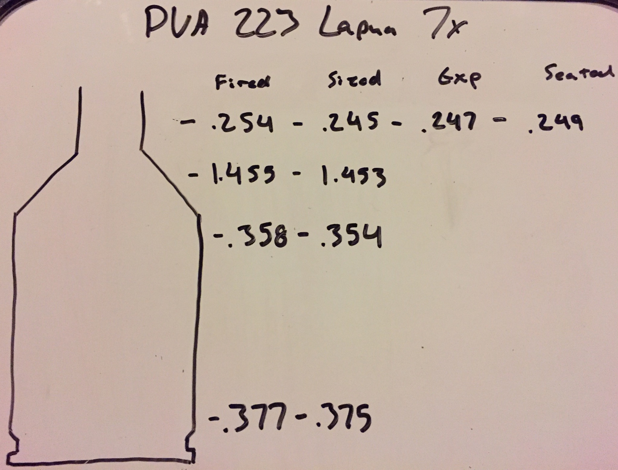

Here is the proper way to measure a 1x, deprimed piece of brass prior to setting up and FL sizing die.
This is the case headspace measurement of a 1x piece of 6.5cm brass shot in my Mega/Bartlein 6.5cm gasser. I have my Forster FL Sizing die set to bump my brass back .003" so all my sized brass measures 1.527"

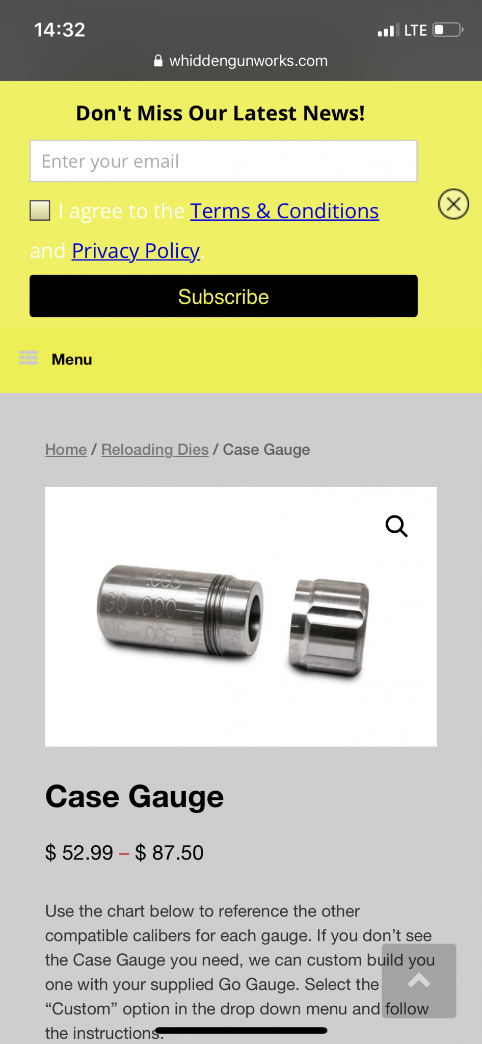

Am I not using a headspace gauge? It just doesn’t measure the case length like the hornady. It instead just gives the increase in shoulder length in thousandths? I am confused because I believe I showed my once fired numbers and included the headspace measurement. It just isn’t the longer measurement provided with the hornady.

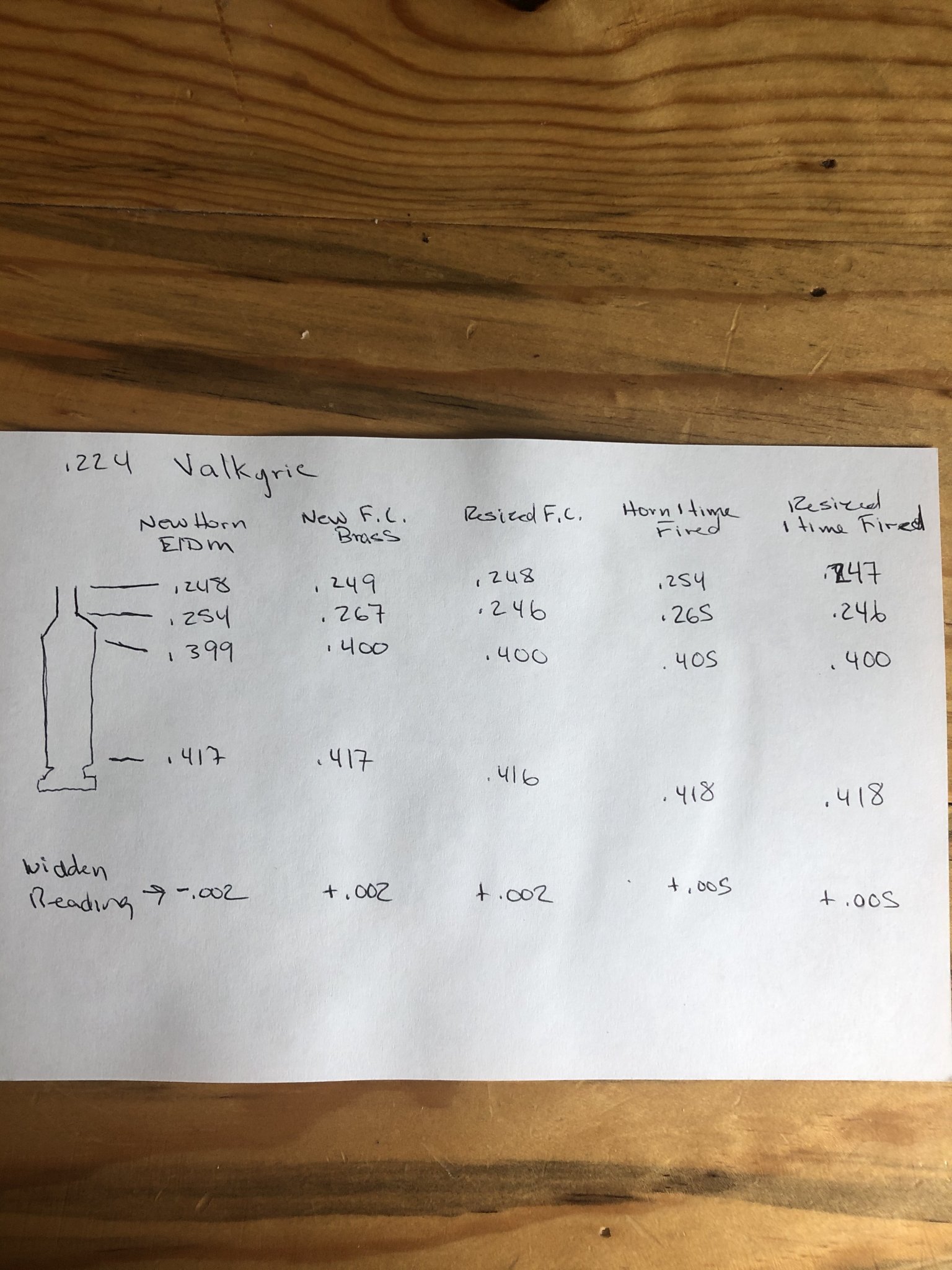

Hornady Unique lube. Die is screwed down touching then 1/4 turn further for cam over.

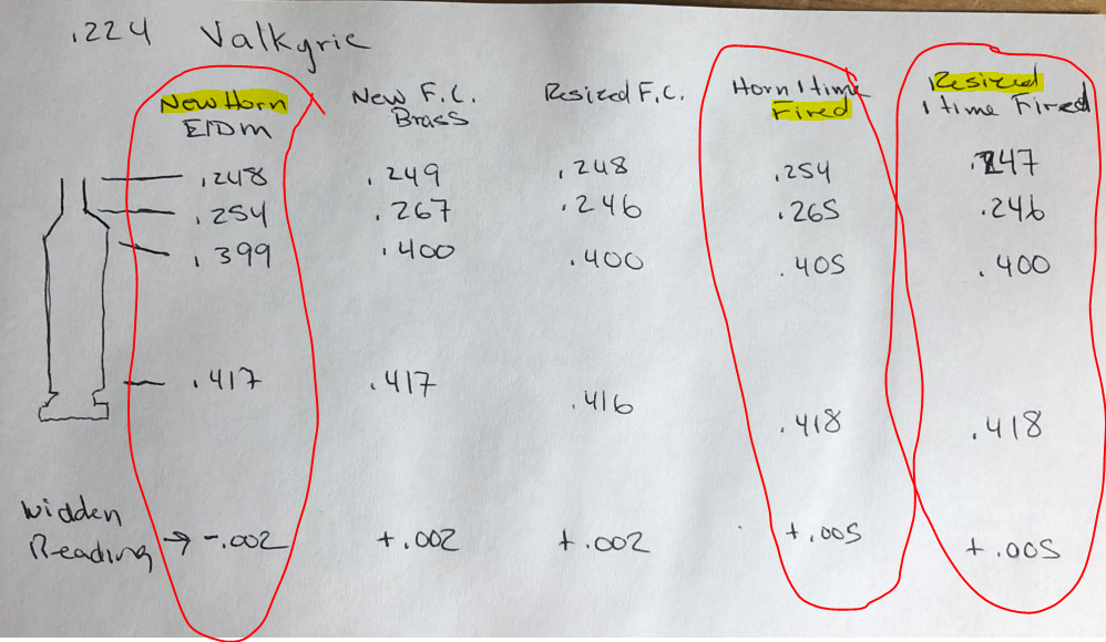

So what Im seeing is
Hornady:
  • neck diameter was .248 new, fired was .254 and sized was .247- that all seems in line.
  • Next measurement (what is this number, diameter of the neck base?) was .254 new, .265 fired and .246 sized- whatever it is,it is smaller after sizing than it was fired so it should not present a clearance issue.
  • Shoulder diameter was .399 new, .405 fired and .400 sized- that all seems in line.
  • Base diameter was .417 new, .418 fired and .418 sized- depending on the quality of your tools and their measuring precision this could be the issue.
The fired brass is the same base diameter as the sized brass, aka the die didnt size this area any. Now, you could not be sizing because the die is an improper fit for your brass and chamber.​
This video explains it as well​
But if they are lower pressure rounds then maybe the brass just hasnt expanded up to chamber size here so its a bit premature to know. Coloring the bass of the case with a sharpie will show whether a sized piece of brass has room in the chamber still or if it is getting wiped away when chambering due to being to large.​
  • Finally we get to your whidden relative measurements- this should give the same relative reading as the hornady comparator but I like that I can see what the hornady is doing without being hidden down inside of something. But thats a different story that padom is addressing above. New is -.002 your whidden 0, fired is +.005 above and sized is still +.005 above. So that tells me that you are not getting your shoulder pushed back any when sizing. Ideally with the .003 of minimum shoulder set back for the semi autos we would be hoping that our sized brass would come out with a measurement of +.002 from the whidden gauge.

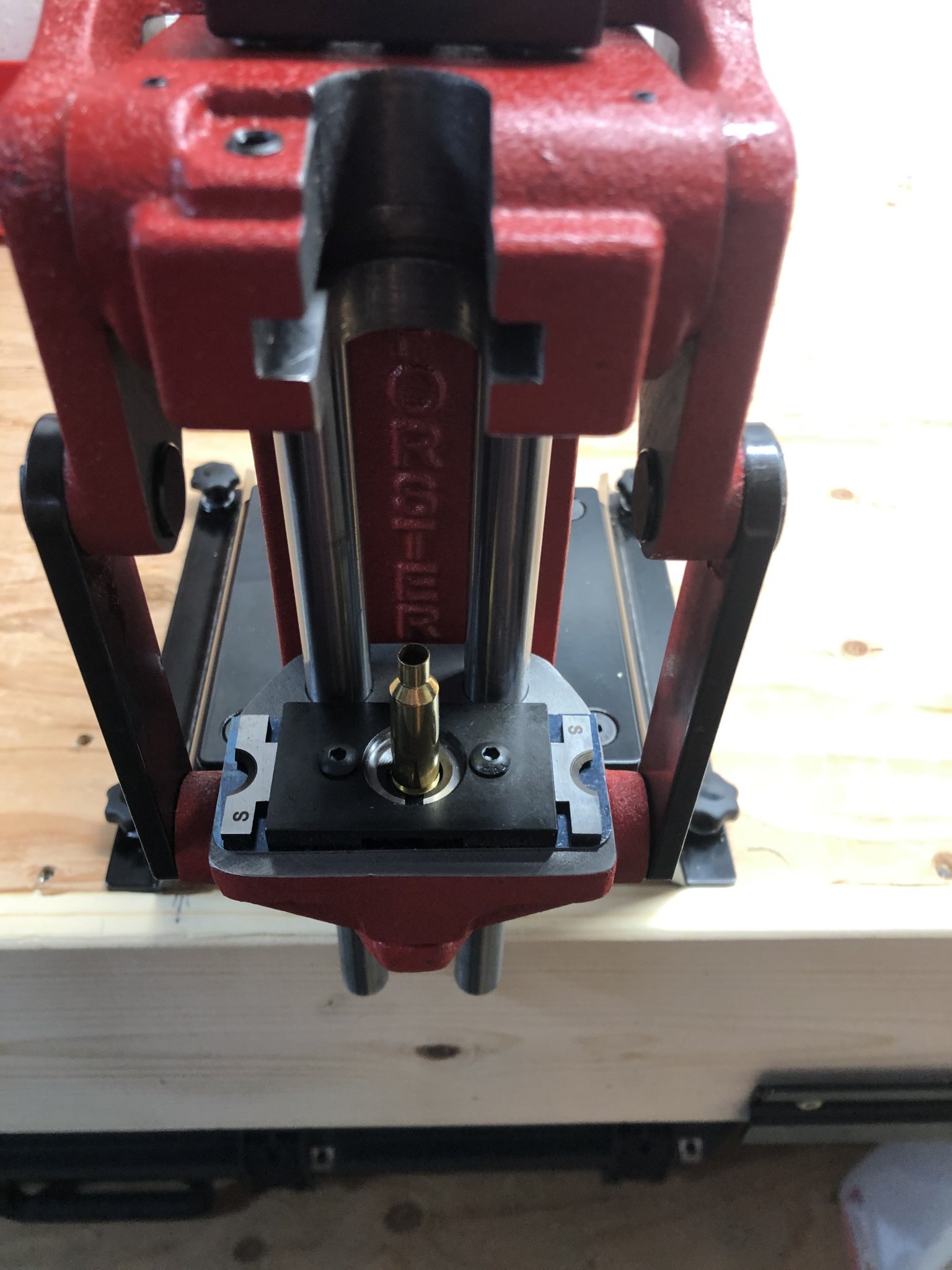

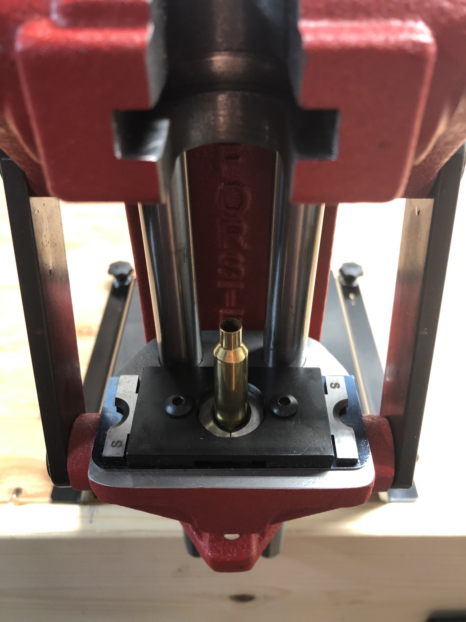

Not that we could tell much by looking at it but I would be interested in a pic of the press with a case in it.
No I have not. This is the first. The press is new and so is the die. And for that matter so am I. I will snap a picture and post soon.
