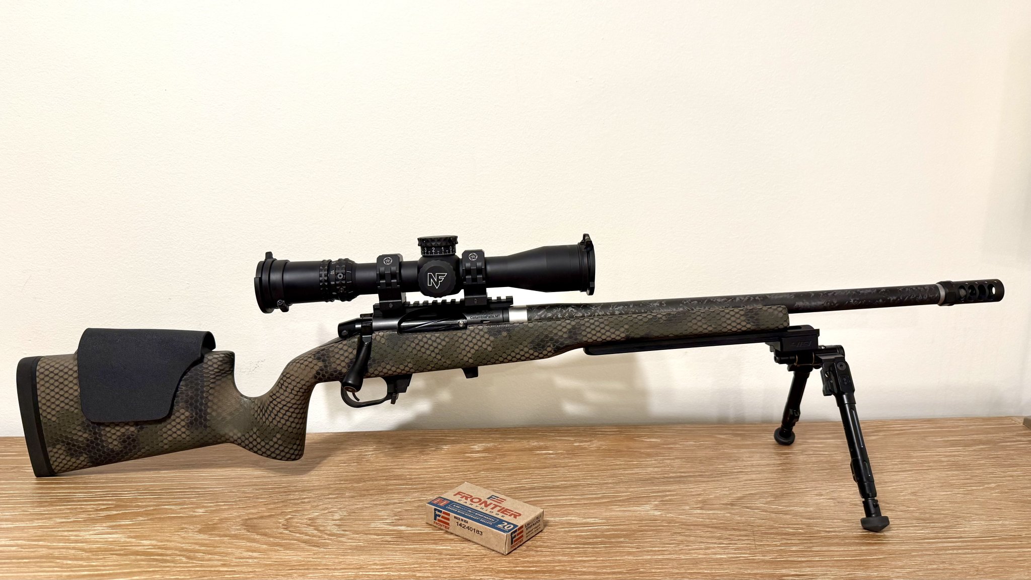

My new origin has this same issue. 15/20 rounds had light primer strikes it seems. The ones it did fire didn't seem to have any visible issues. I also checked the headspace using go/ no go and things are correct. Not sure if maybe somethings up with the bolt
Factory ammo?
I'm not real familiar with 6.5 creed, but is it common to use a harder "Mil" primer?
I'm guessing yes, since a lot of people have 6.5 creed semi autos with a floating firing pin.
As Origin stated above, it can be fixed at the expense of bolt lift/ lock.
I am tempted to see how much heavier it would make it. Lift and lock is real light on mine currently.

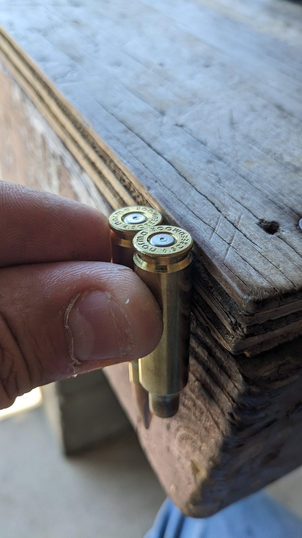

It could be such a thing that the IMI ammo was "shorter" to the shoulder, allowing it to be further into the chamber there by giving gap at the rear and being slightly out of reach of the firing pin itself. If you had a comparator to measure bump with, you could tell.
Your a got damn genius Gump. Your fucking IQ must be 160.
Joking aside, headspace is shorter for these rounds and causing lps. Your assumption was spot on.
