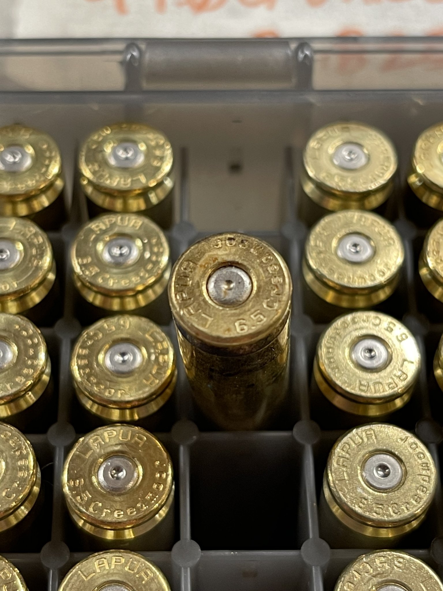

Late update.
Got out yesterday and had time to re zero the rifle and shoot a total of 20 rounds of 143 ELD-X in Lapua Brass with CCI 450’s. All fired just fine, no issues.
I have quite a bit of load development sitting on my bench to get through so we will see how that goes. I have some Hornady factory I just picked up so that will be my control ammo if problems start happening again.

I switched to CCI 400 and only bumping the shoulder 1 thou. Have shot 100 rounds so far and haven’t had a LPS.
Top paper is powder ocw test. Bottom is 2 shot seating depth test. The rifle looks to have potential to be stupid accurate with 153.5s going 2610 out of my 24”
