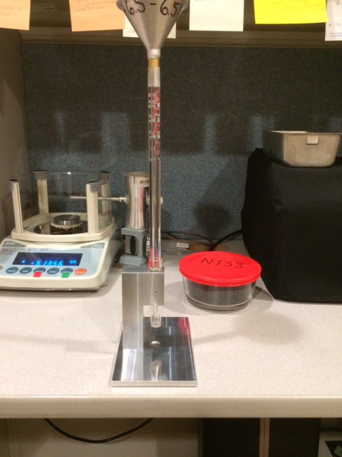

I like the Saturn funnels. Here's a pic of my setup with a 12" clear drop tube and a stand I made that holds the tube/funnel until I put a case under the tube.
