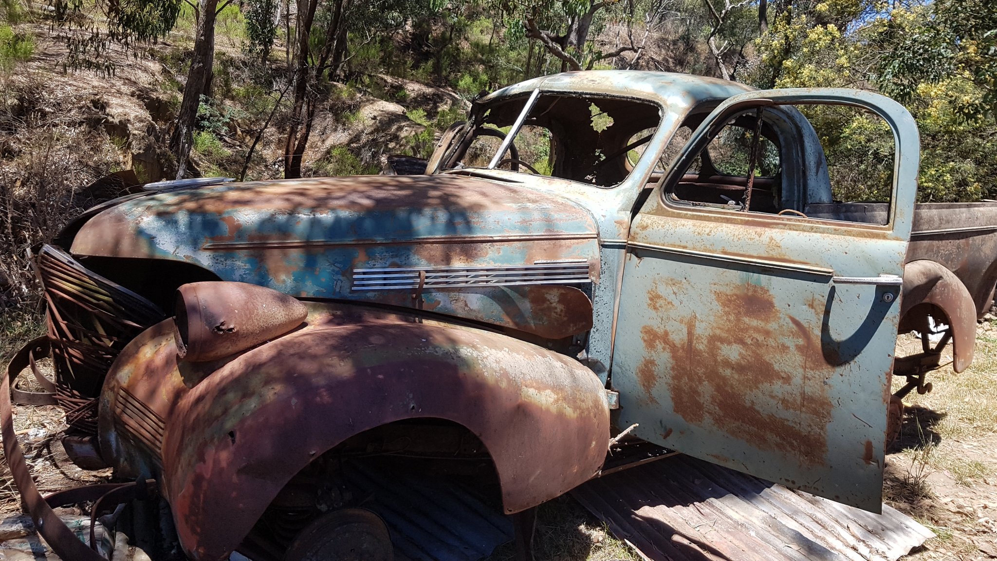

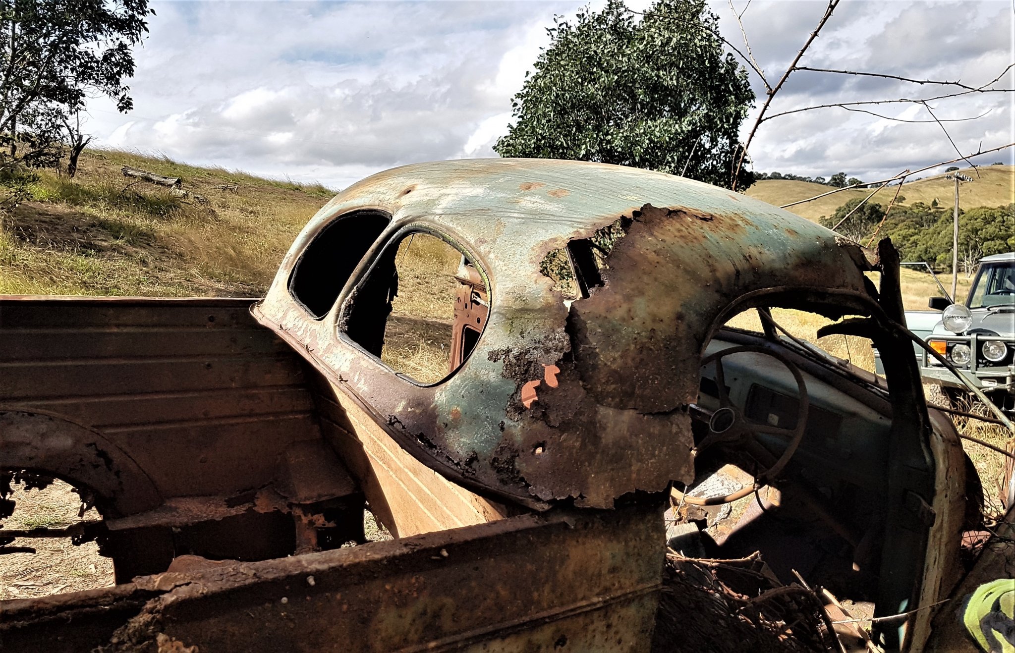

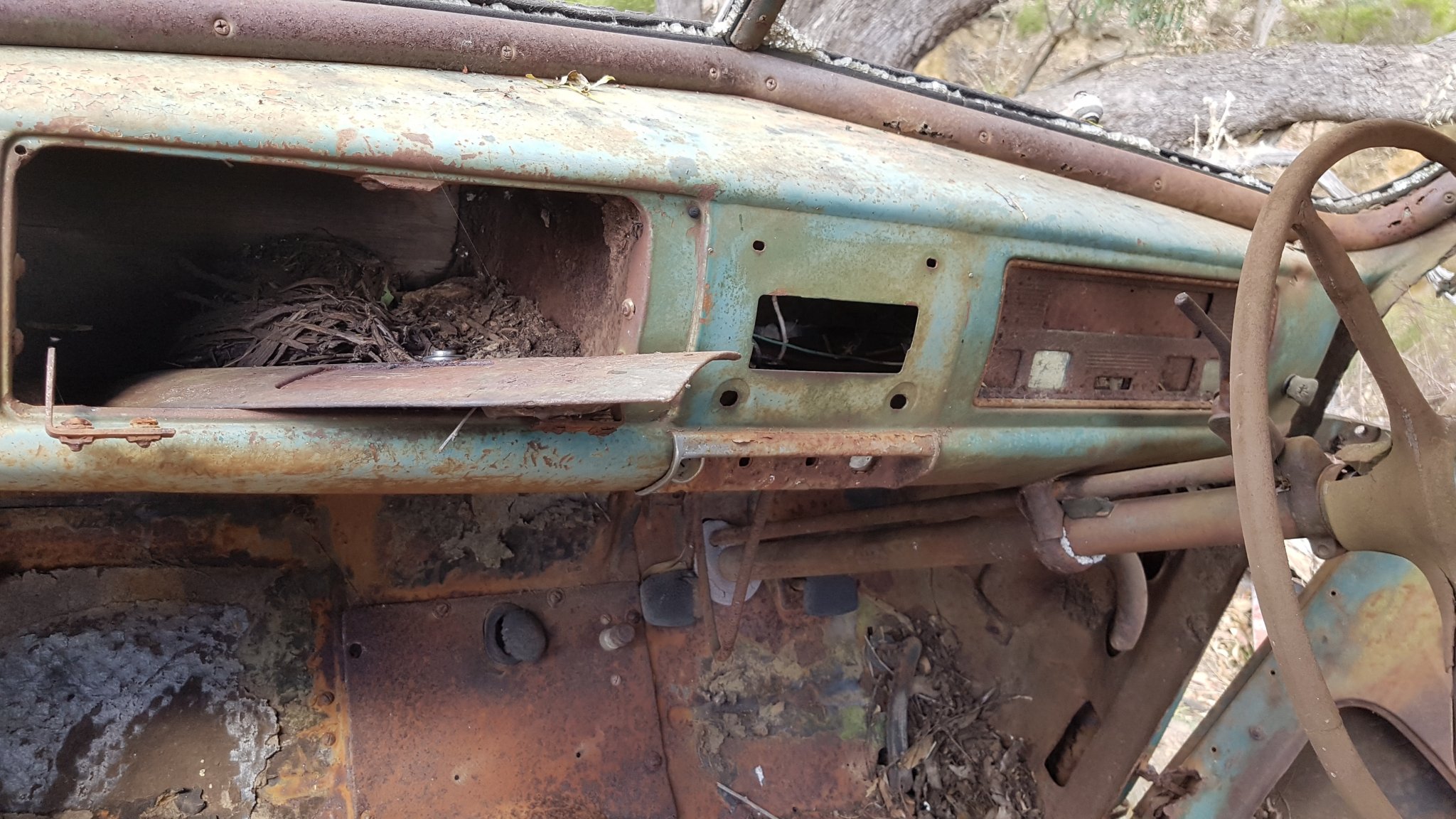

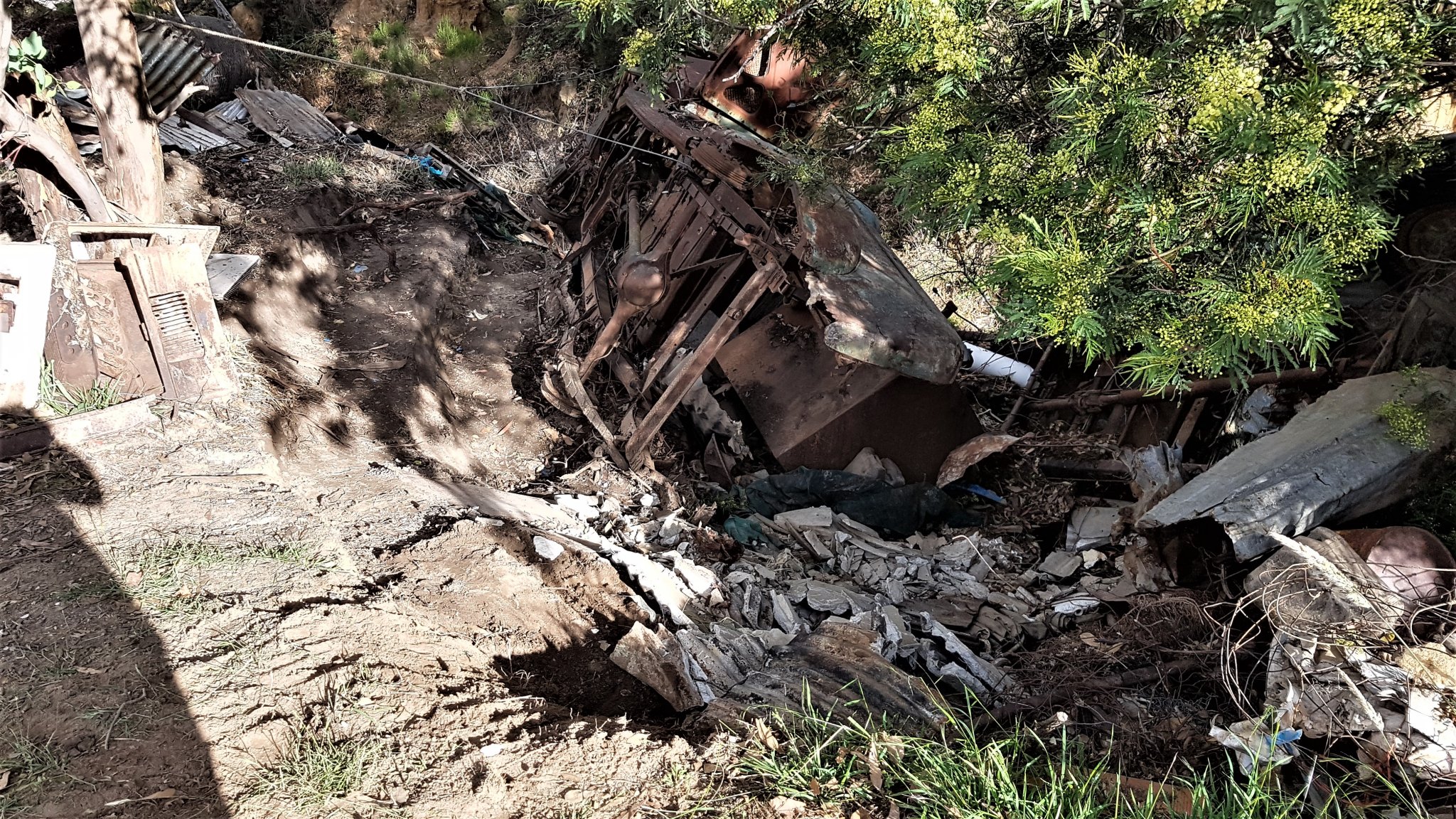

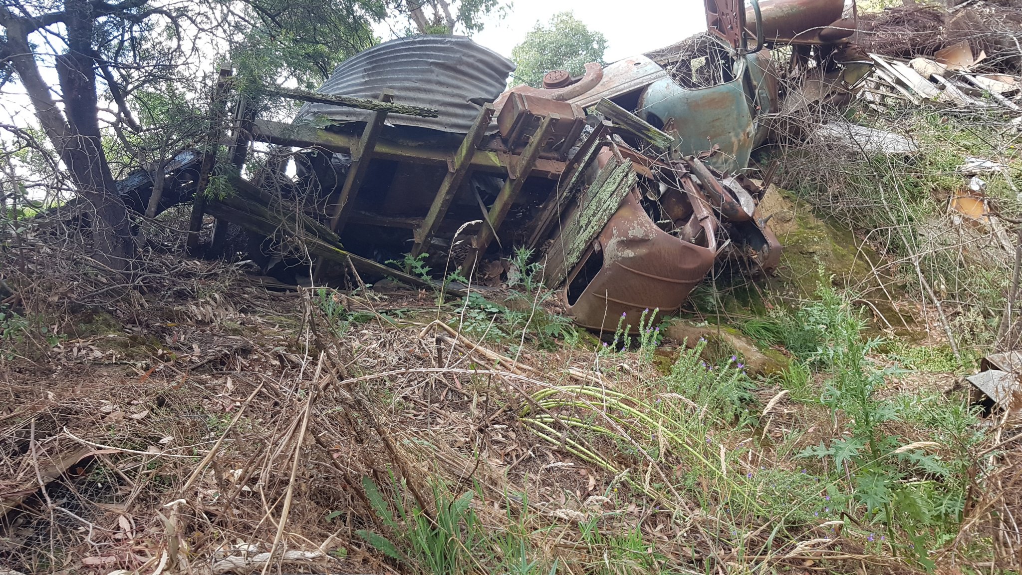

I'd never been able to decide which of the 1930s Chevys I liked best, until a few weeks ago when I discovered 1939 Chev Master Deluxe abandoned in a gully at the bottom of a steep valley down the back of the property. It's a rarity in the Chev lineup, being a pickup body. Now we have a winner.
They were shipped here from the factory in the US in FKD form and a local firm, Holden's Motor Body Builders built the Utility Body as it was called here.
When WW2 started, the HMBB factory stopped civilian production, including the Master Deluxe Utility and switched to defence.
HMBB was later bought out by GM and became General Motors Holden
This one's been saved from going all the way to the bottom by an outcrop of decomposed granite but is perched precariously on it's side and partly buried under 30yrs of farm trash.
It's slightly below ground level so I have put in some wire rope stays to keep it stable while I dig a bench beside it, onto which I can set it upright.
It's been on it's right side for at least 30 years, once it's upright I'll know whether I have a rat rod project or a parts harvesting project.
The plan is to set it upright, then putting the soil I dig out for the bench over the remains of the concrete tank I smashed up for base fill, I can make a ramp.
To prevent the truck from digging into the fresh soil I'll lay down the old corrugated iron roofing sheets that partly covered it as a surface and start pulling.
No shortage of trees for snatch block anchors.

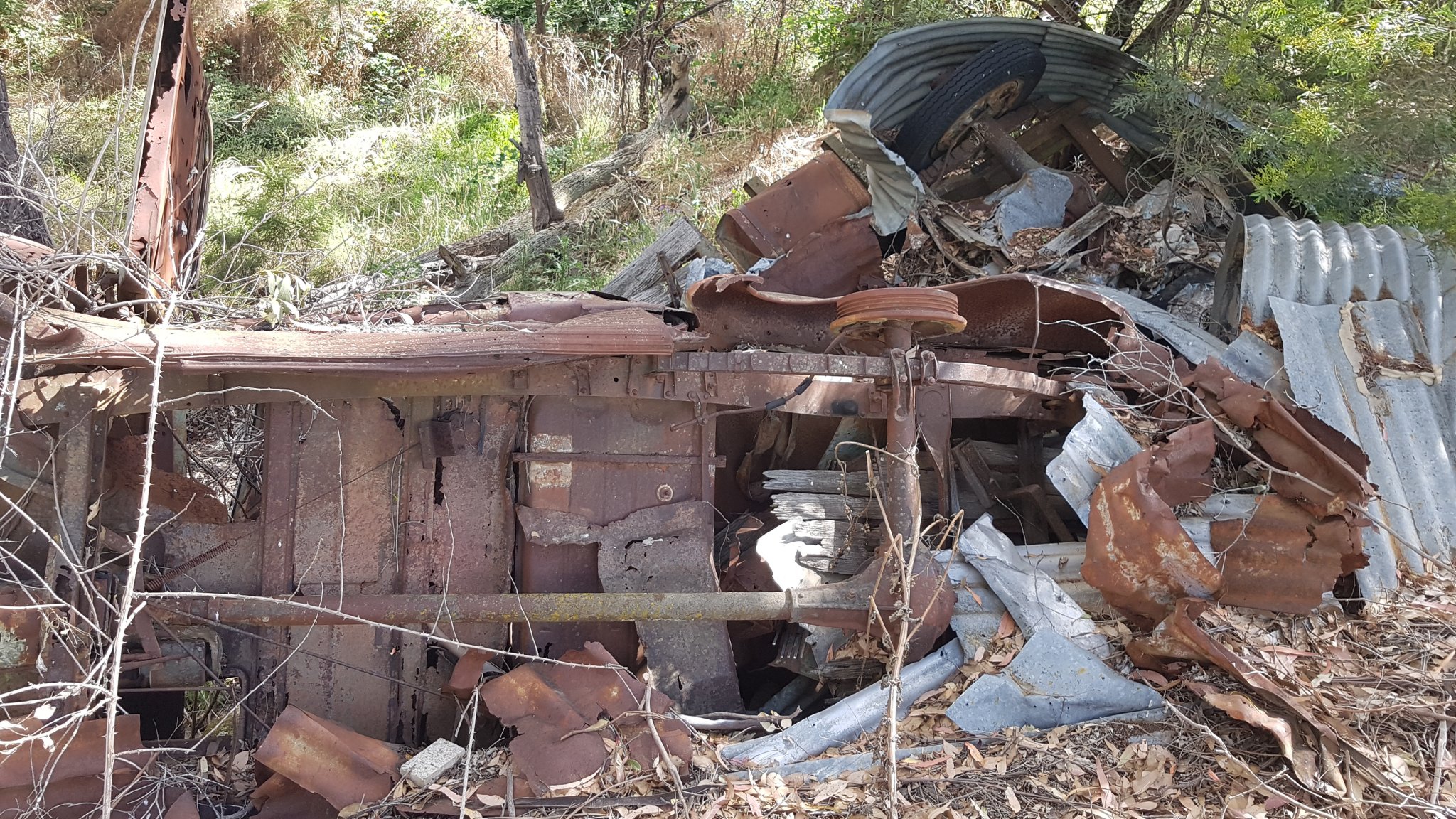

Just below it, caught on a bigger outcrop is an early 30s British Bedford flatbed, upside down, the cab and guards have taken a hit but the rest is in remarkably good condition.
Getting him out is going to be a much bigger challenge, the Chev I can do with the snatch blocks and the winch on my Range Rover but the Bedford is too heavy and too deep and the location precludes anything much bigger, being at the bottom of a 40 degree slope. It rained the other day while I was digging and I had to use the diff locks to get out.
If the body is as good as it seems, I'll put it on a later GMH 1 tonne flatbed chassis and do some customizing.
Surprisingly, after who knows how long since it was last used the drivetrain is still free. The engine is gone and I turned the input shaft on the gearbox the other day, it not only turns freely by hand but turns the hubs.

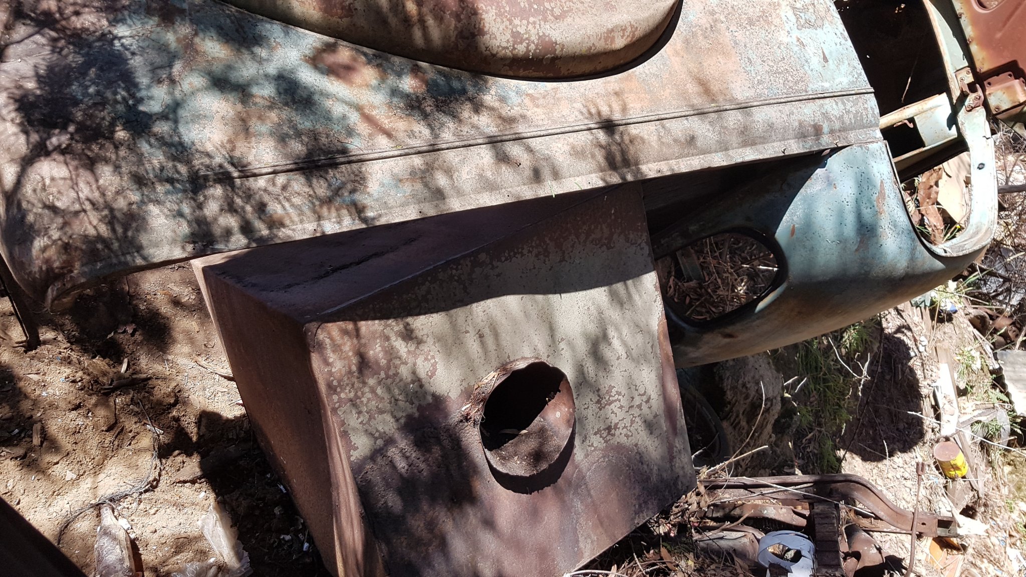

It took quite a bit of digging, rigging, winching and towing, but I got the old Chevy out of the gully, unfortunately confirming my worst fear about rust at the contact points with the ground.
It had landed on the right hand panels of the tray and the cab roof behind the driver and the A pillar, several decades allowed silt to collect at these spots and rot them out, as below
Even so, it would be potentially salvageable were it not for the prohibitively restrictive rules that grew out of a desire to prevent re-birthing stolen or written-off vehicles.
Even with those rules, with which I agree in the main as most are safety related, successive governments have raised the fees involved until it is beyond the average person.
If I build my own chassis, it has to be both inspected by a specifically licensed automotive engineer and tested on a torque bench, where it must provide at least 4000nm/mm resistance to deflection before it can be coated and fitted. That alone can reach around $10,000 in fees and gov charges.
When it is mated to the new chassis, it has to be put through a braking and handling test, as a vehicle that has never been registered, it can't be tested on a public road. The one person in my local area who has done this had to hire the local airport runway at $1500/hr for the test.
Why not just get a modern rolling chassis and use that, I hear you all thinking.
"They" are 3 steps ahead on that one. If I put, say, a 1980 chassis under the 1939 body, that body then defaults to the more recent safety standards that apply to the chassis. This means that it would then have to be fitted with 1980 safety devices, among others, inertia-reel seatbelts, washers for the wipers, heater/ demister, and bloody child restraint mounts FFS.
Then, after all the above expense and embuggeration, they can still fuck you.
Every step in the build has to be accompanied by the relevant inspection and approval, but you can get to the final inspection and the guy doing it has the final say, and can object to any previous certification and if it's the chassis, you are back to square one, because ANY change and the entire vehicle has to be recertified as it has changed.
If I put in a motor with more than 20% above the original 80hp, a whole new set of expensive, time consuming embuggerances kick off.
So, it's someone else's project, I'll find a buyer for the corpse and put the money towards the new lever gun I've been "Jonesing" for.

Yeah, but we all know that it's all good fun until someone gets poked in the eye.
I had a contract with a heavy towing firm in the early 90s to attend major truck accidents for site cleanup and have unfortunately had to clean up more than a couple messy endings of people in unsafe vehicles that have come unstuck at the worst possible moment.
So I agree wholeheartedly with the safety push.
What pokes a big stick up me though is the truly "governmental" part.
If I want to put a safe, modern chassis under that body and build a roadworthy vehicle, I'm penalized by taxation but if I buy 80yo parts off fleabay, bang it together with a few welds and leave it with all original, I can call it a "restoration" and do as you guys, go down to the mechanic, check lights and brakes, $48 and I'm on the road in a vehicle that would come apart like tissue paper if I hit a sparrow.
It's that hypocrisy I hate.
Like the Twilight Zone our gun laws inhabit, I can have a 50-110 WCF but it's considered unsafe for me to have the new Nerf gun because the little foam projectiles have too high a muzzle velocity.
Seriously, you couldn't make this shit up if you were on drugs.
