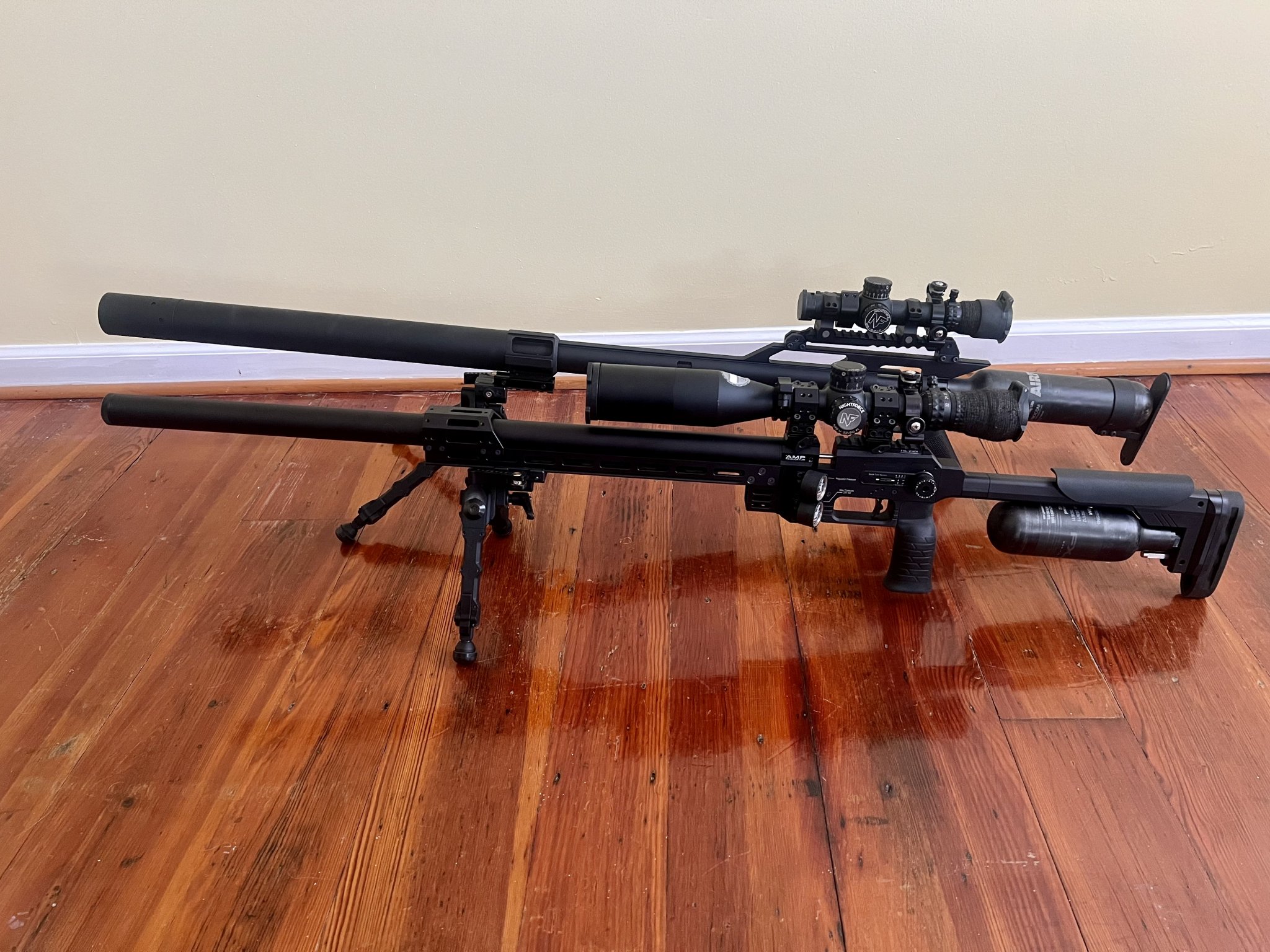

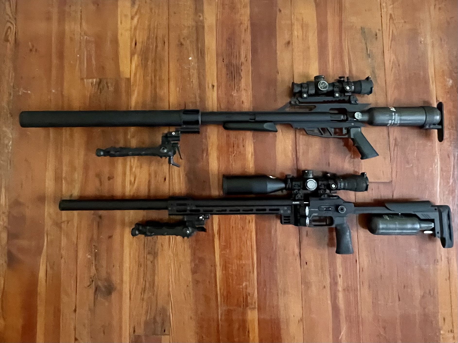

Here's a size comparison of the two. I had always thought the Texan LSS was a broomstick length rifle, and I had similar reservations about the 700mm Panthera, but neither are bad at all!!
Reactions: Trent A
The 700 panthera is honestly no longer than your typical hunting rifle. They shoot great, but are air hogs

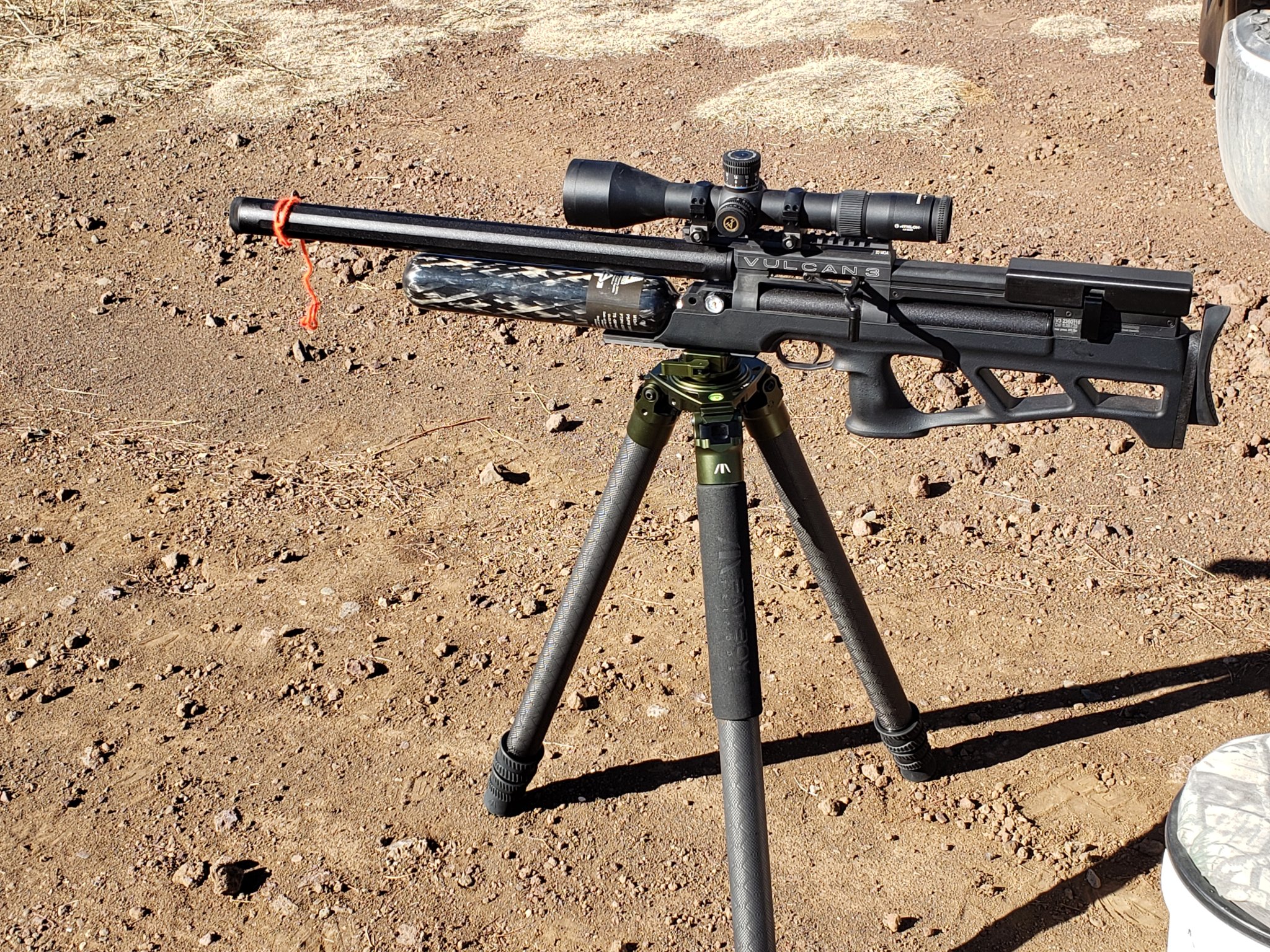

You can add the AGT Vulcan 3 to your list. Mine was tuned by Derrick at Tenacious Airguns, is 25 cal, holds zero well, and sends 60gr Altaros slugs at 862 fps which is 99 fpe. The G1 BC of this slug is .245 so they don't blow in the wind much compared to most other slugs. This combo in my gun is a consistent 1.1 MOA at 100Y with the net result of helping win quite a few Ultimate Field Target matches.

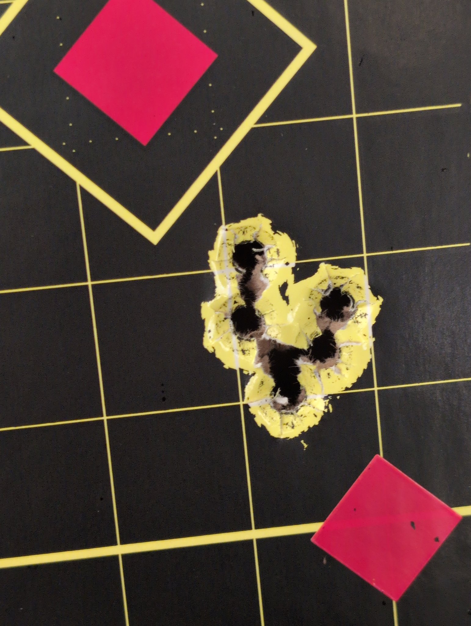

I have to say though, this Texan LSS .457 has amazed me with its accuracy!!! It's not picky with run of the mill swaged slugs (NSa 240/290/350) and it shoots well enough with 333-500gn cast ammo to hunt, but it's literally the tightest grouping PCP that I've ever owned when shooting 290-295gn RBT and those 365gn steel tipped RBT slugs (all made from Corbin tools). I've shot groups tethered that were maybe 1/20th of an MOA at 55y, and I've never run anything more than an NX8 1-8 LVPO on it. Put a Trij red dot with a 3x magnifier on it now, since the FOV is wider than a 1-8 and I find that it's just right for taking deer inside 100y.
Shot this 6-shot group at 58y couple of days ago from my tripod - untethered from my air tank shooting with 240gn NSA HP-DB's with the Trij red dot and 3x magnifier. The squares are 1x1", first shot was 972FPS and the 6th was 827FPS. Still had ~2300PSI in the bottle, which would have been more than enough for a 7th shot, but I ran out of ammo and didn't feel like digging in the basement for the rest of my 240's.e
Wanted to see what the shot curve and POI looked like with those light slugs, so I aimed at the top left red diamond and wasn't holding at all for elevation. Never would have thought that 6 shots were possible with this rifle, let alone the spread being an inch give or take from the first to last shots!

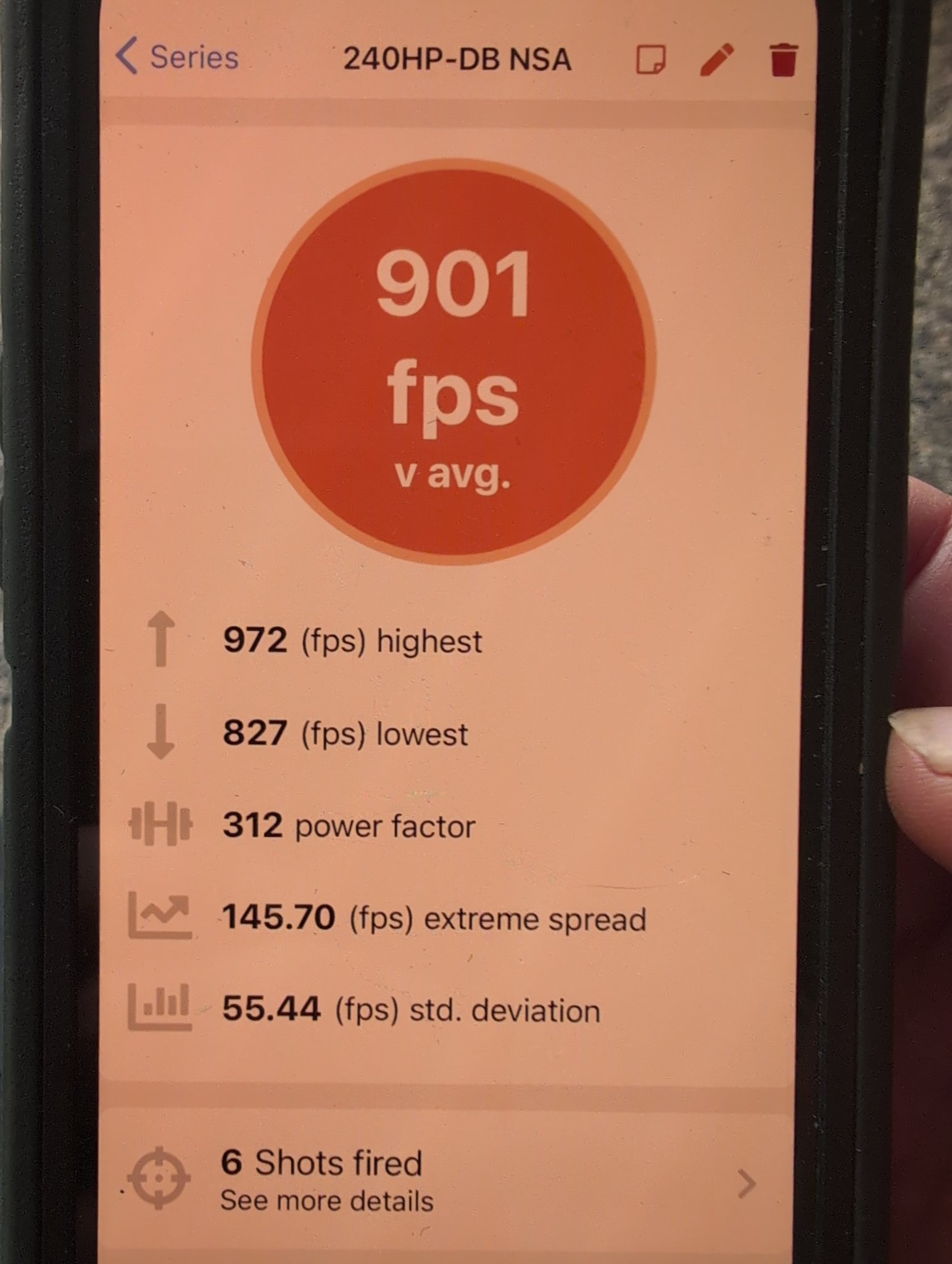

Yesterday I hit a kitty cat sized and shaped steel 8 times in a row at 300Y with the V3/60gr Altaros slugs. Man it got boring even with a 1.5 mil holdoff so I put the gun in the truck and got out the Steyr ProX to play with at normal distances instead. Only went out to 125Y using 18gr pellets with it but got reacquainted with how fun a gun it is to shoot.
My 1st gen Thomas HPX starting shooting weird last year and I hadn't been able to figure out why so I shelved it. Well a few months ago I got it out again and went to clean the barrel only to discover what the problem was. The thick receiver(I'm not sure what it's called) that holds/clamps to the barrel had loosened from the lower part of the action that it's attached to. Took the picatinny rail off and the three screws underneath needed to be retightened.
