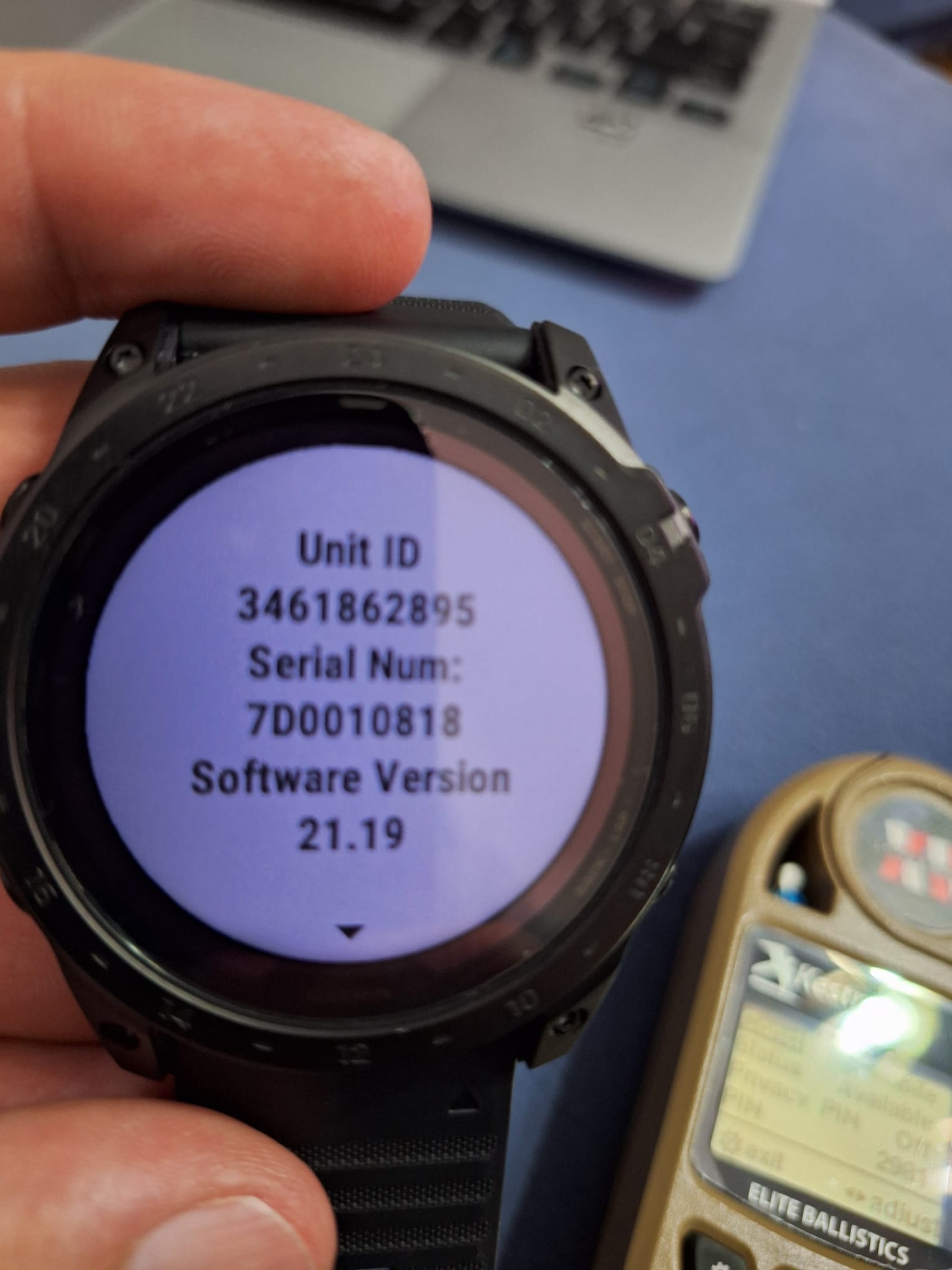

I have now taken the time to check the connectivity between the Kestrel 5700 Elite and the Tactix 7 Pro Balistics I received as a replacement from Garmin.
How unlucky would I be if the replacement watch had the same connectivity problem? 😢
Is there an updated software version that has solved this problem?
