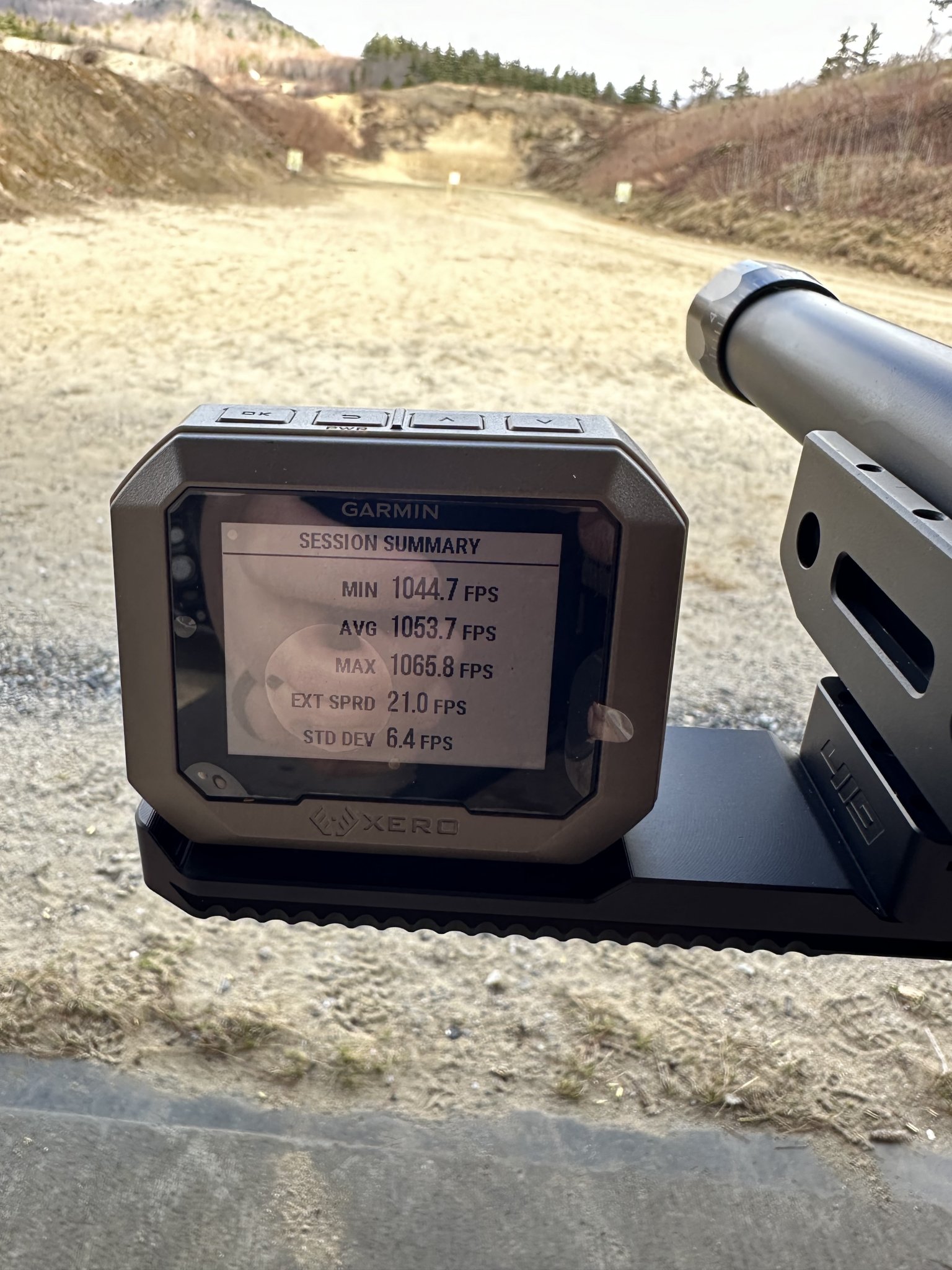

From the range history and a pic of it mounted

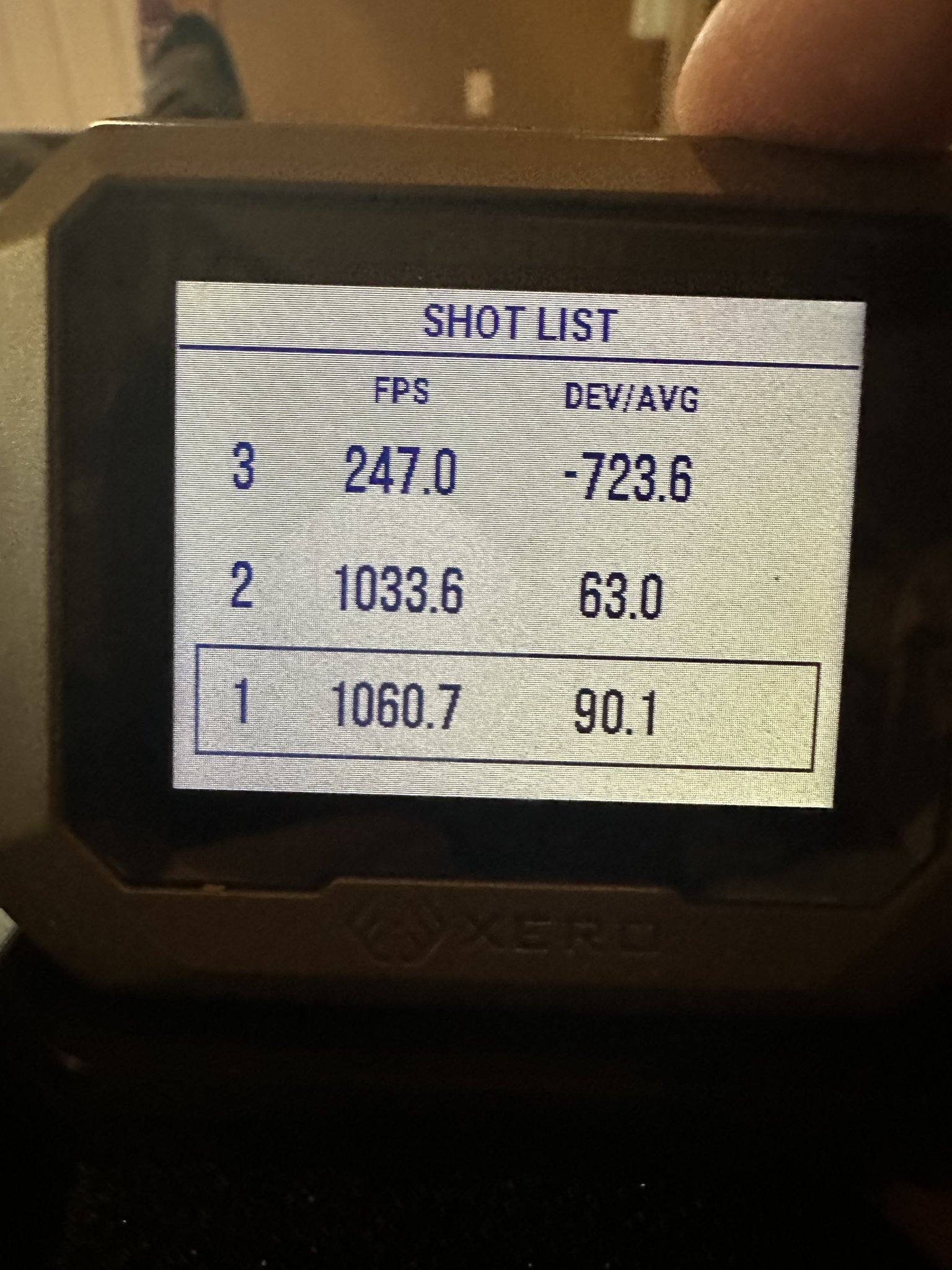

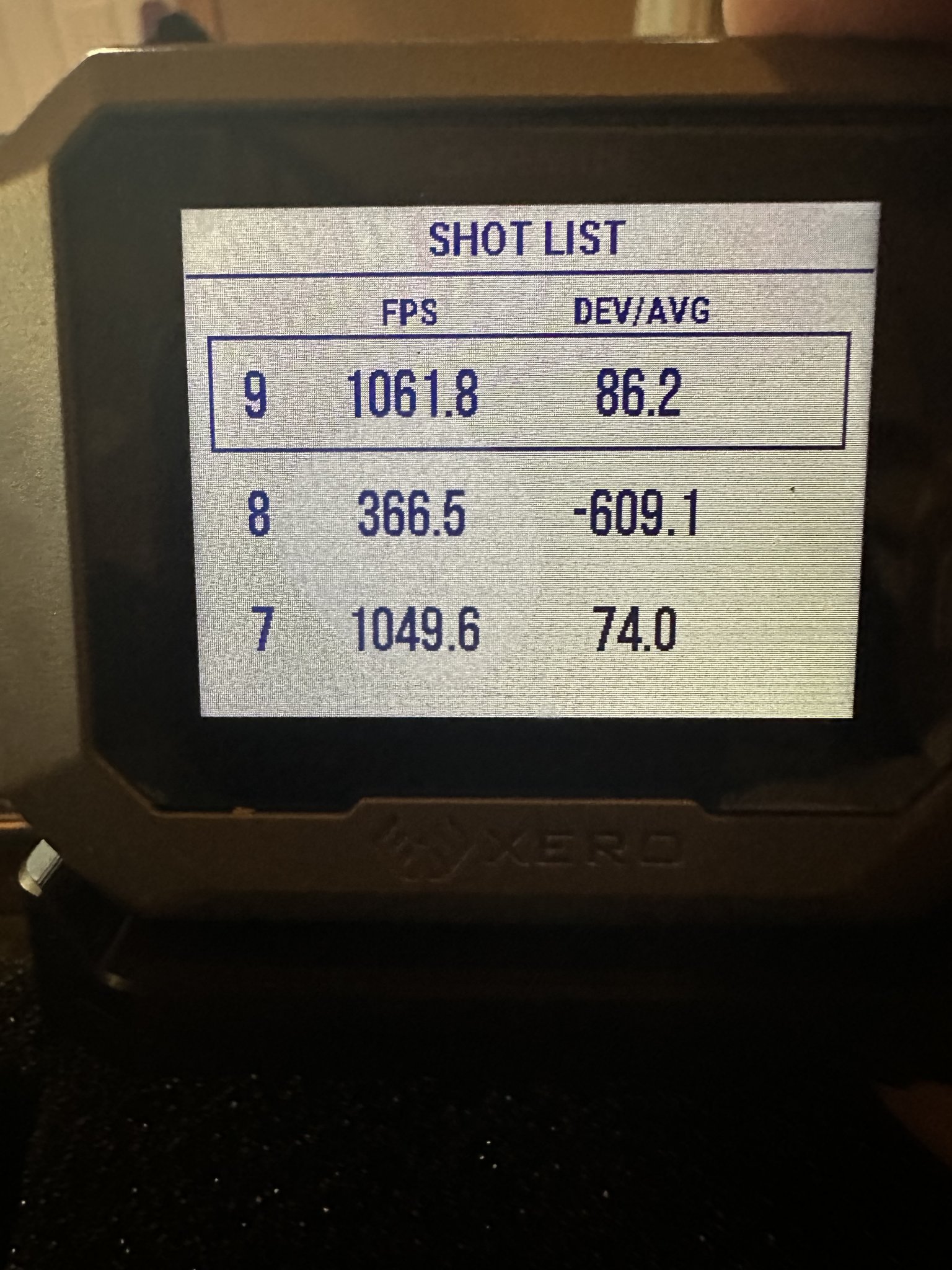

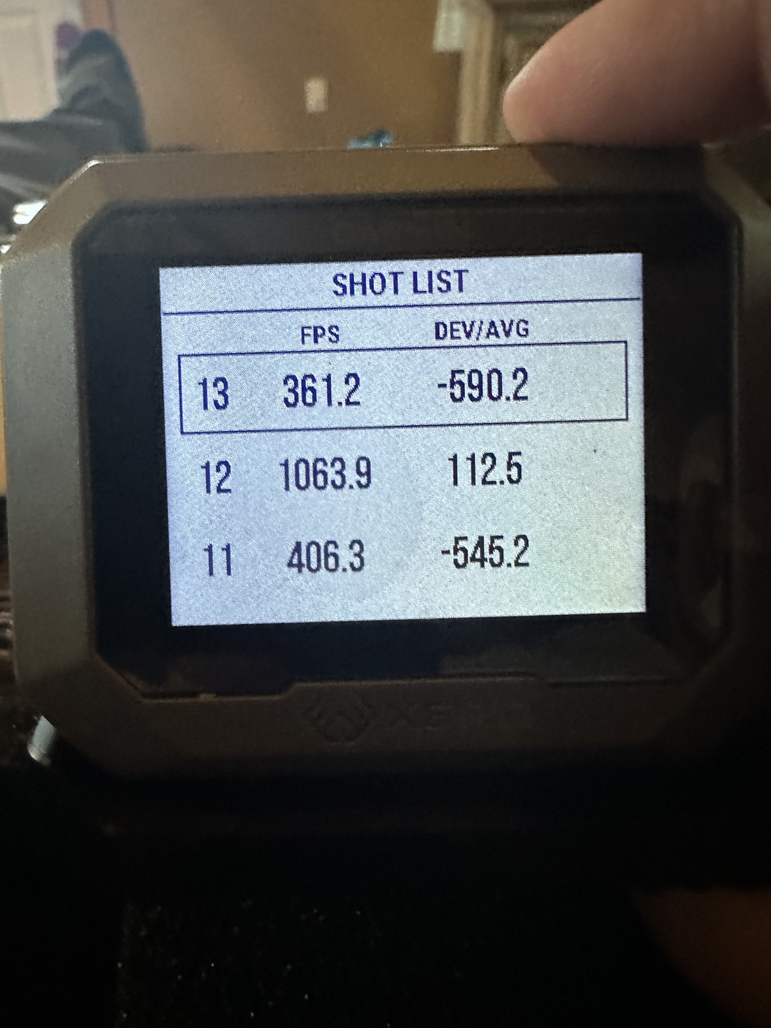

Happened every string for me. Shot analyzing when cycling bolt.

I have a buddy with one that gets the same error only when in the area 419 mount off the factory tripod works perfect. He recently bought a longer arca mount off amazon and it works fine, we believe being so close to the chassis might have an adverse effect on tracking the bullet.
But when no shot is sent and it’s triggered by the bolt cycling it shouldn’t read something

Yes, but mine are when the trigger is pulled but there's a fail to fire. Similar speeds and also mounted to my Vudoo in a similar fashion.
Just a guess but if the rifle moves when you cycle the bolt (maybe you slam it closed and it jolts the rifle forward, for example) the Garmin radar is moving as well and may be picking up motion from that and thinking it's a shot. Naturally if it's tripod mounted rather than on the rifle, the radar won't pick up any movement.
