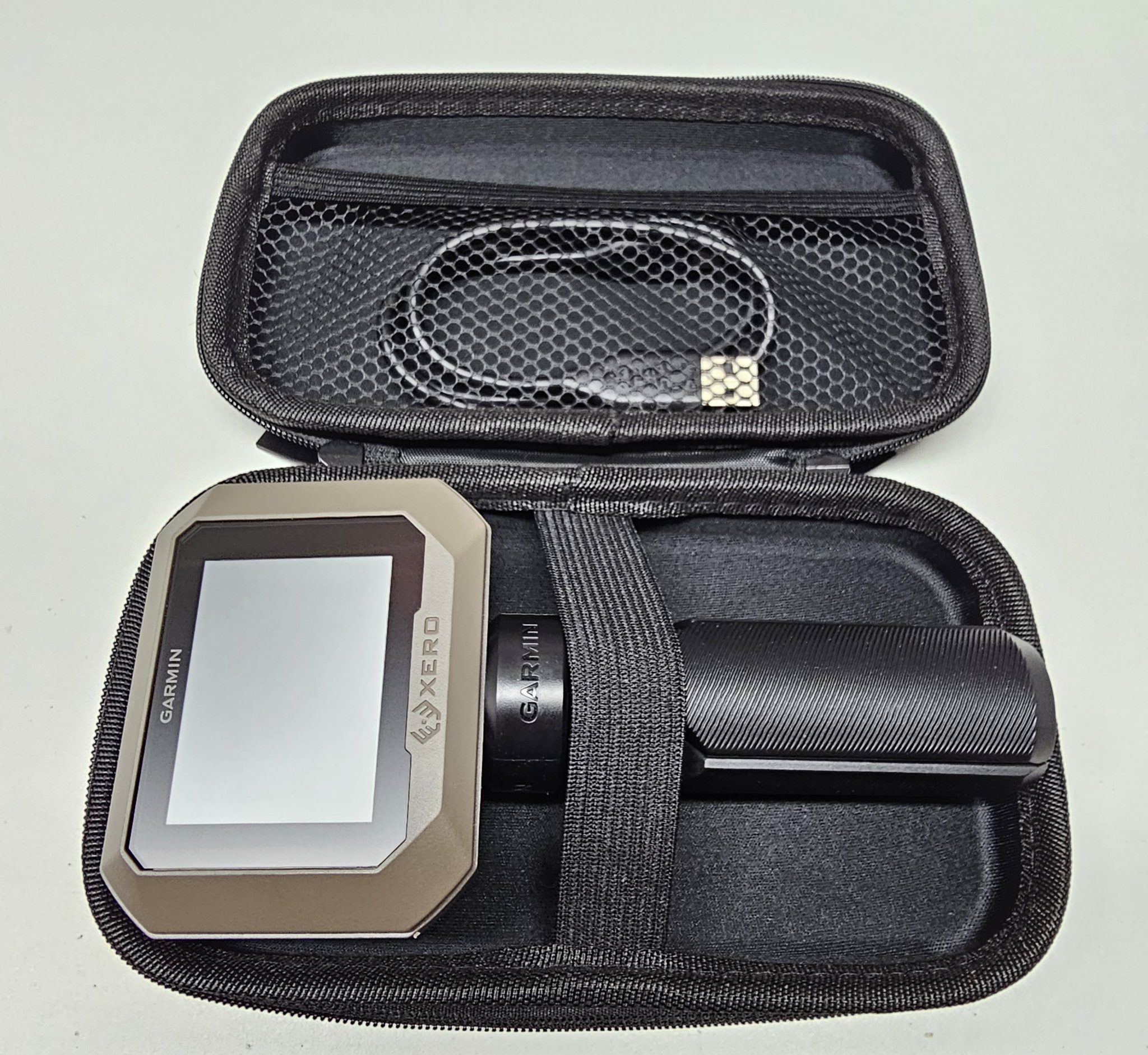

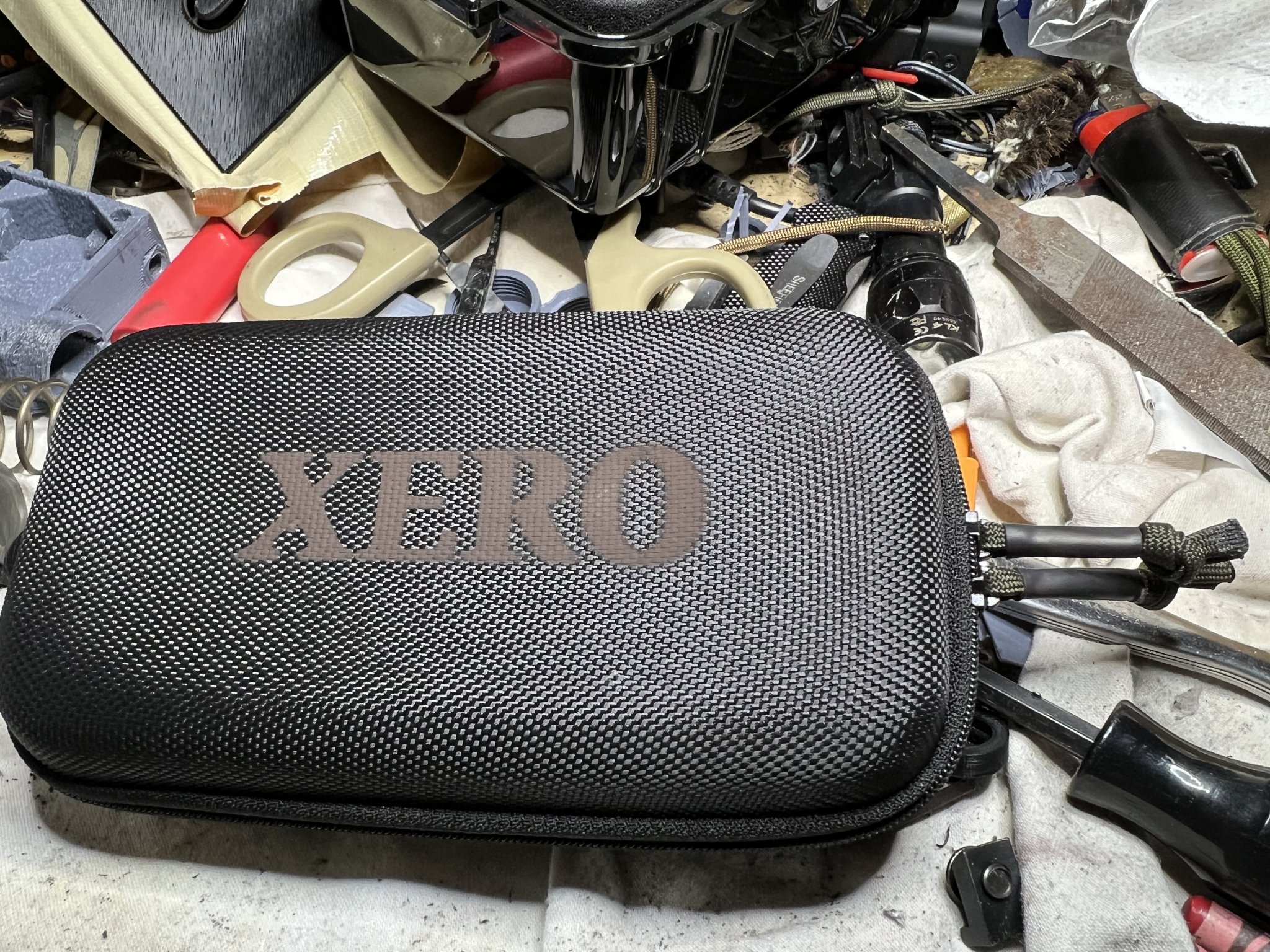

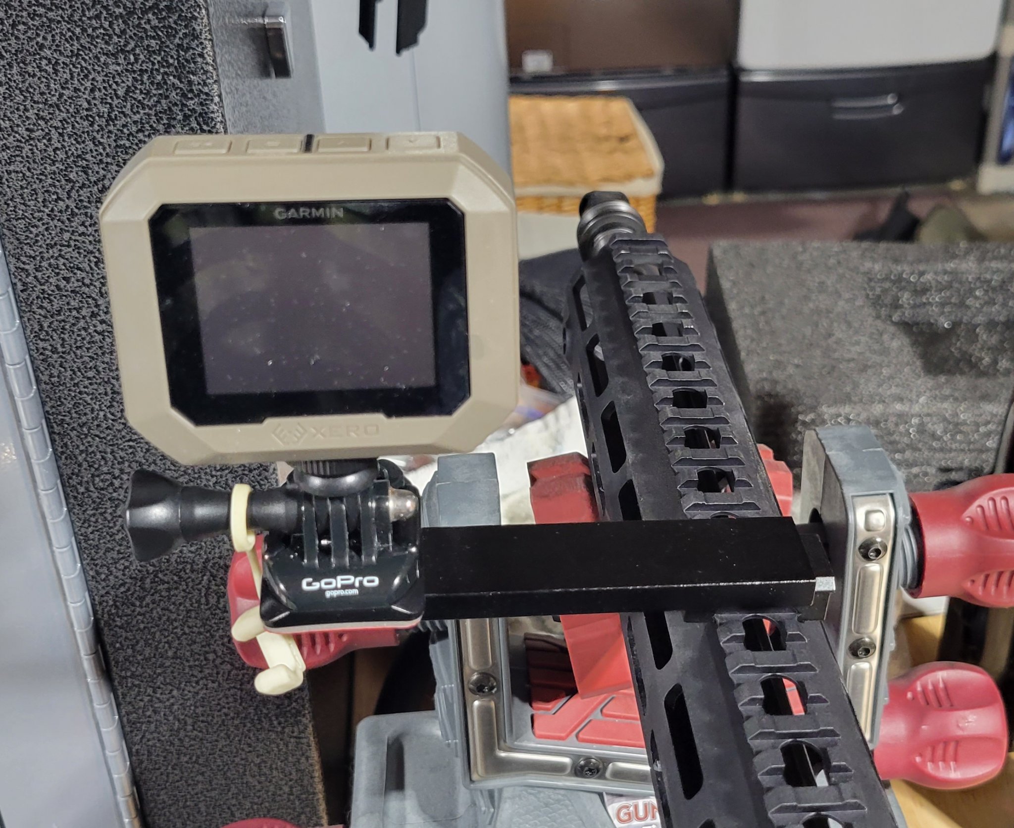

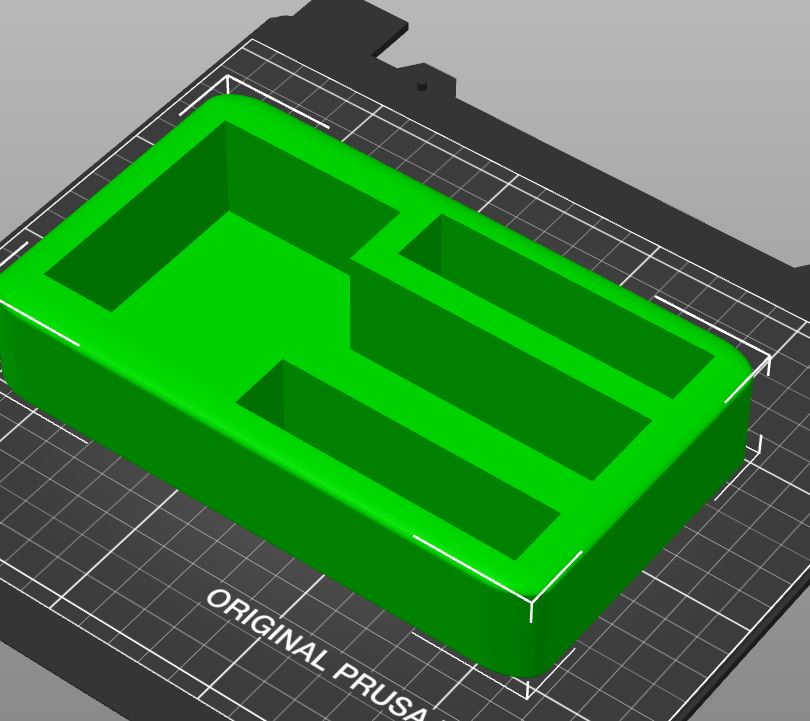

Made my $8 Amazon case all tactical and stuff because I was bored. Then remembered I 3d print all kinds of stuff, so making a TPU Xero insert for the $30 magpul DAKA small organizer case I just ordered, because I can’t just leave well enough alone.
Also printed up a Xero anti-concussion device printing out in TPU right now to replace the mock-up on my Amazon rail. Those corners have the slightest bit of curve I didn’t account for on my first try.

Dude, that's awesome! I'd love to mod my amazon Xero case like that! How much you charge for the laser etching and the 3D printed insert?

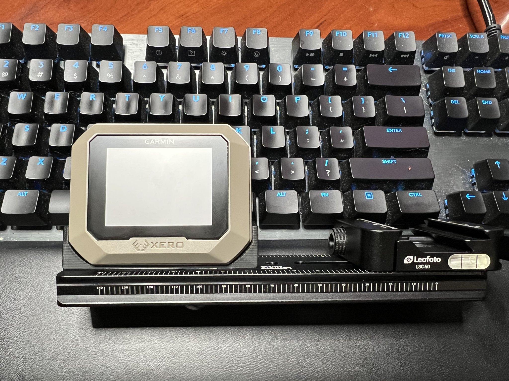

El cheapo plate from Amazon works. You do in my option need to add rubber padding or something squishy for the Xero to press against while you’re tightening the screw underneath. Gives the unit some tension so it doesn’t easily rotate. That’s why Area419 designed theirs to fit to not allow the unit to rotate. We are talking $20 vs $60.
I am going to add a minature acra plate to the bottom of my Xero, then a Arca clamp to the on rifle rig - for this reason as well as others.

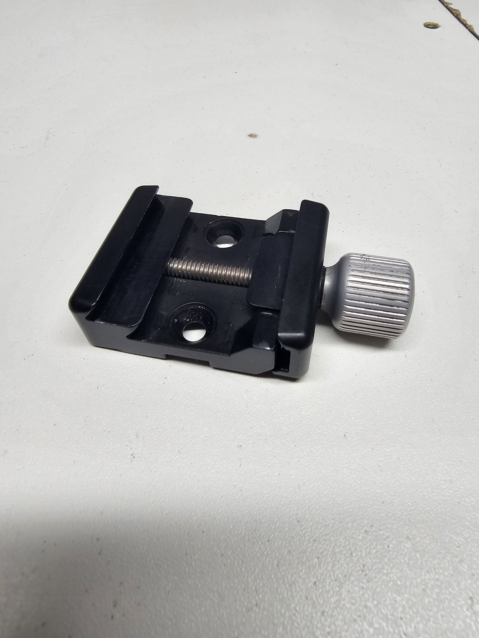

Show me another plate with an ARMS-17 interface for the RRS clamp?
Yeah sure, both orientations , first doesn't let the clamp open
Dang, @flyer1a and Area419 can probably make a change to the plate. The RRS are about the only clamp I run right now.

Is the ARMS-17 interface the groove that keeps it from turning? Don't know of another plate with that interface, that being said you can still clamp it to a flat rail.

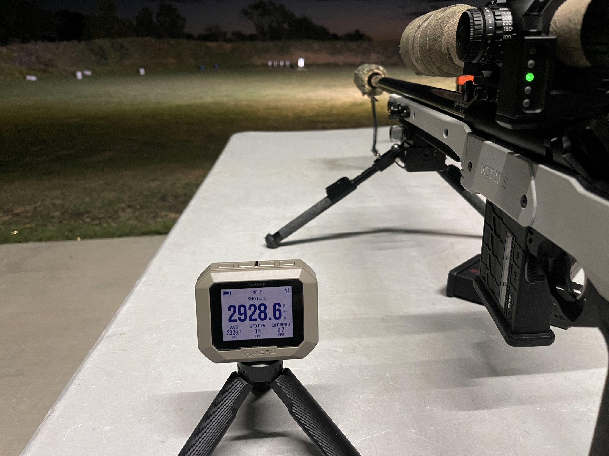

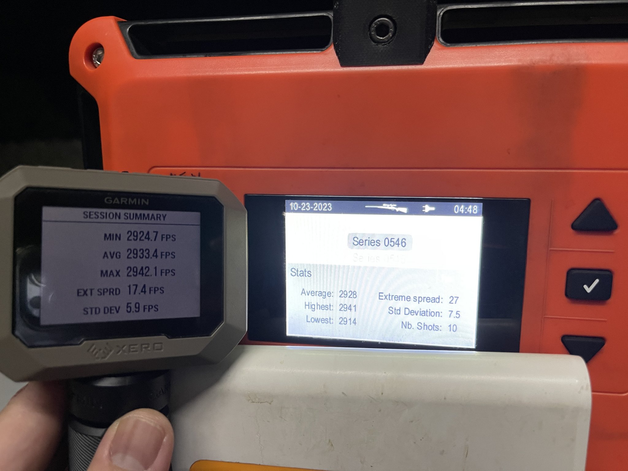

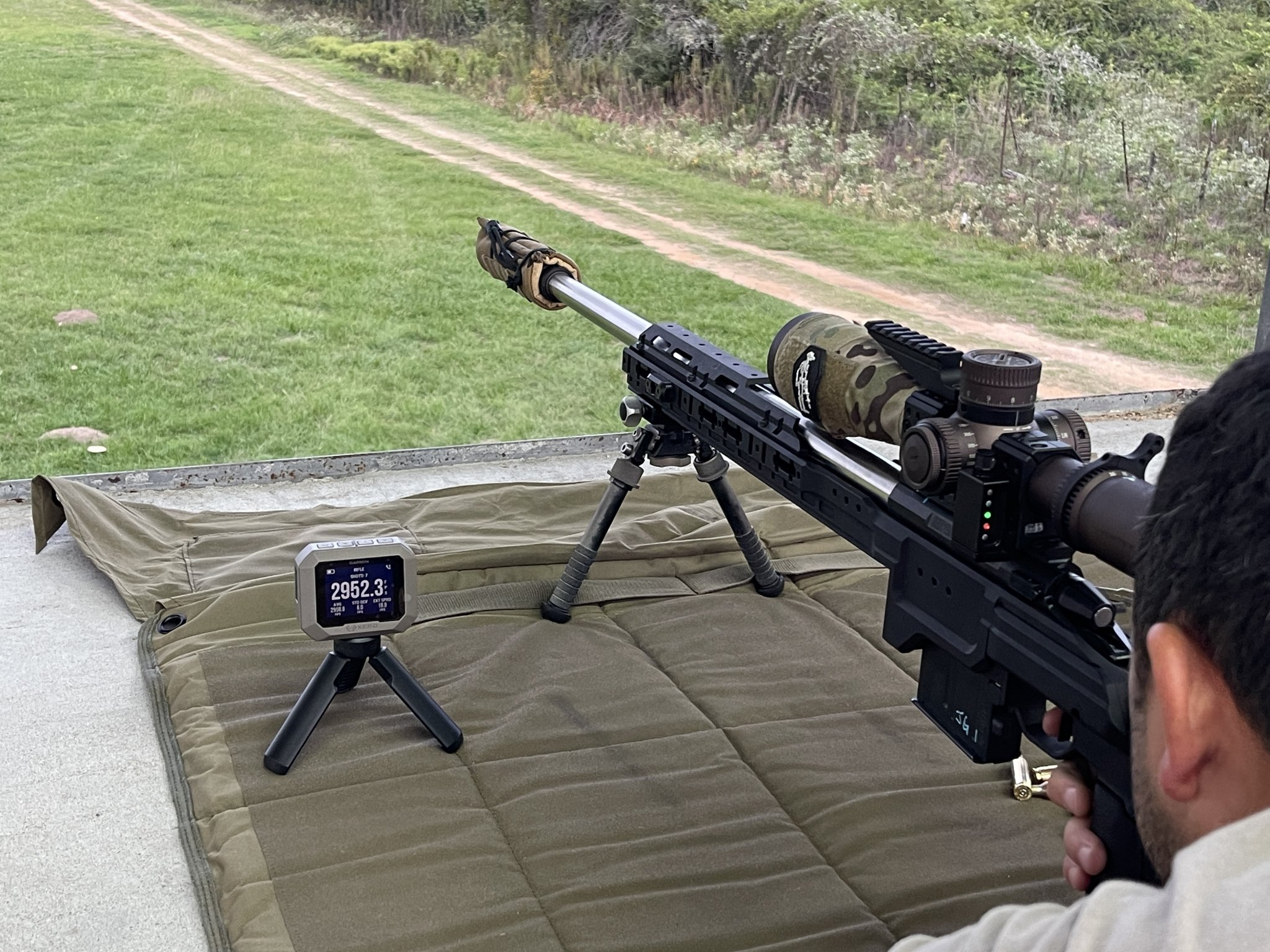

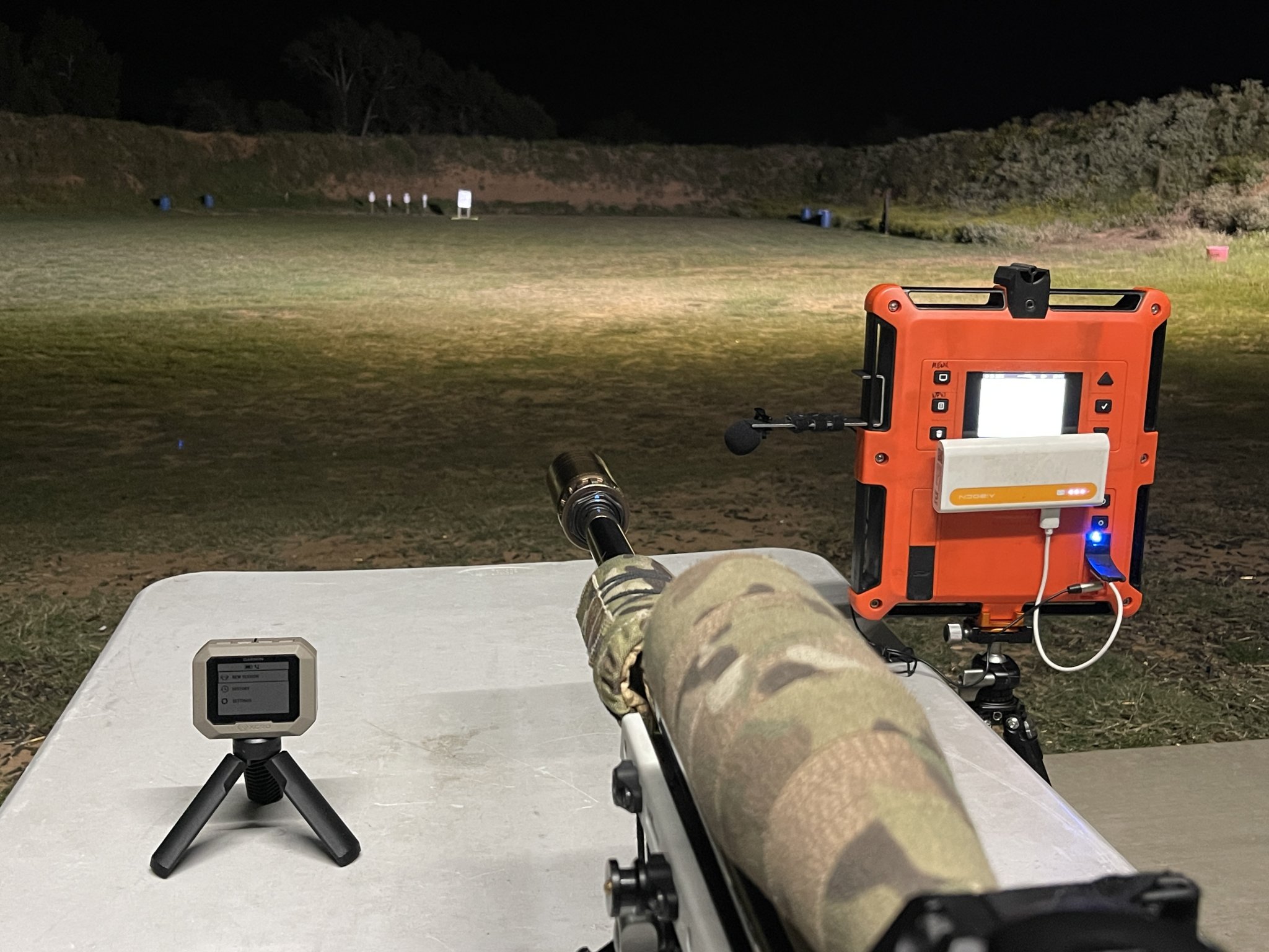

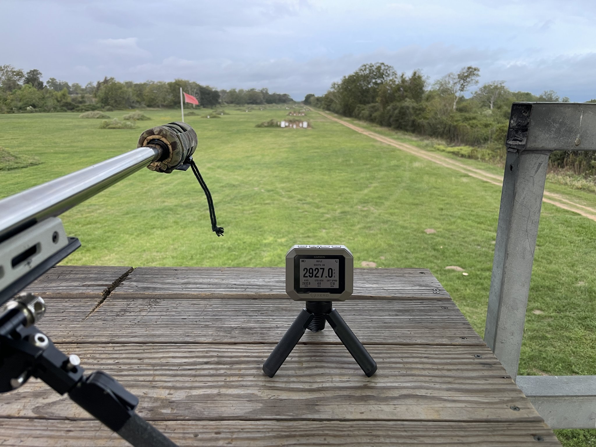

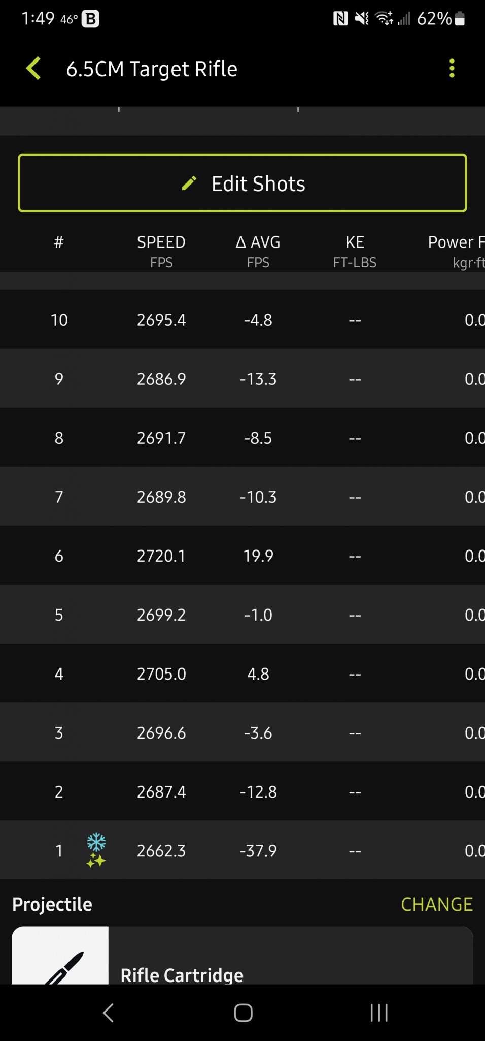

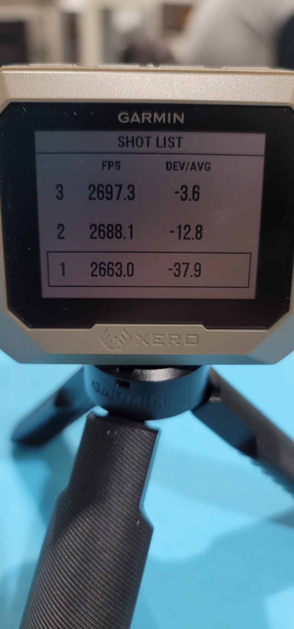

Final judgement. The Xero is THE shit. I had it pointed down range and it picked up every single shot from 100-990y. My buddy was prone a few feet away with his Xero and we did not pick up each other’s shot either. As a current LabRadar and Magnetospeed owner the Xero is king. Glad I spent the money.

Can you go back and edit / add more shots to the individual series or do you just keep adding new ones like the LabRadar?

Yea, two screws in line, many of the rails have a slot, those that don't can be drilled. Aluminum rail, it is pretty easy to drill a hole and thread for a screw. even a caveman can do it. Not sure why you'd need that interface to connect a short arca rail?

If you’re looking for a specific Xero mount then Area419 is the one. For preexisting camera accessory mounts then the Amazon Chicom stuff works just fine.
The Xero placement is so forgiving you honestly don’t need a mount unless you have nowhere to set it down.

you mind posting the STL for the rail buffer?
