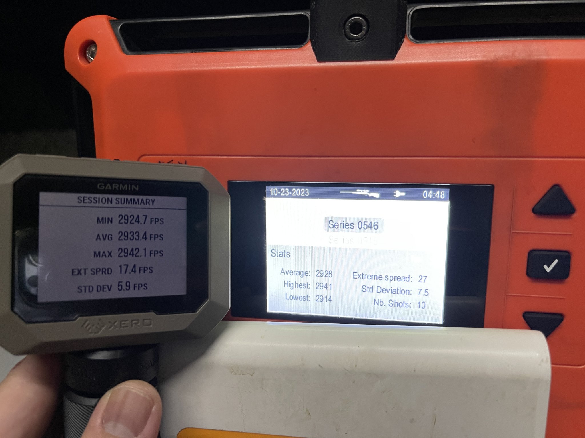

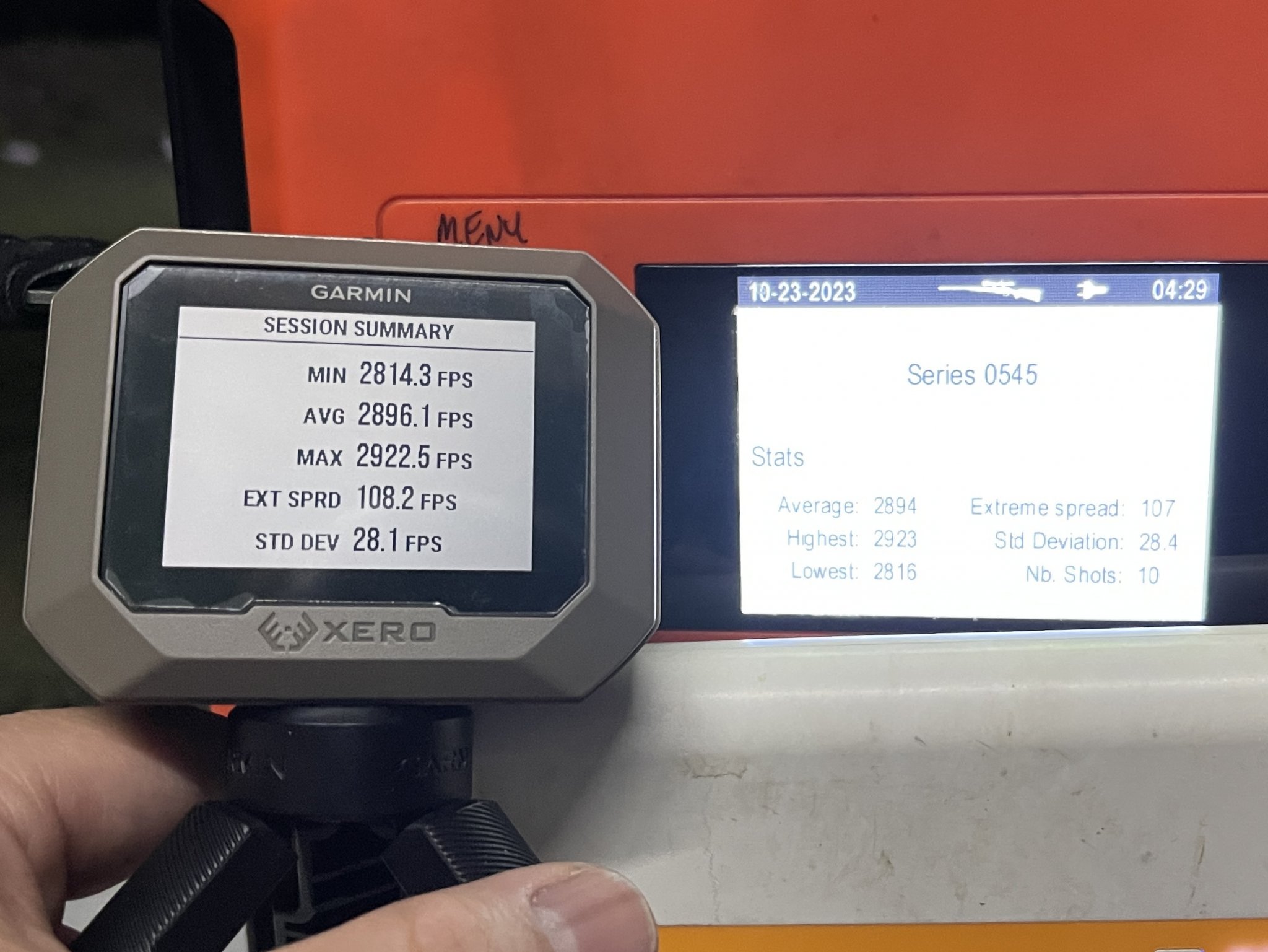

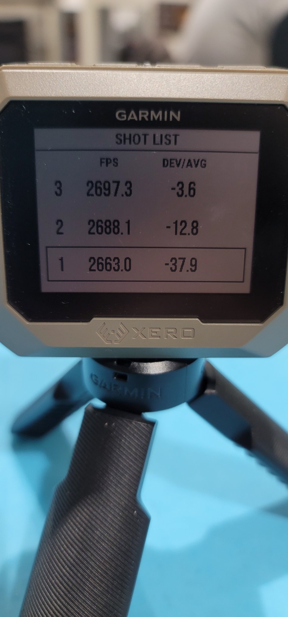

Received mine today and ran it alongside the BulletSeeker. Planned on running the MagnetoSpeed as well but it won't fit when using the Without Warning brake.
The Xero reads a bit faster than the BulletSeeker which I remember the MagnetoSpeed doing as well.
BulletSeekerXero
Avg 2668Avg 2676
SD 8SD 7.9
26542662.2
26712680.1
26732683.3
26792681.7
26642672.1

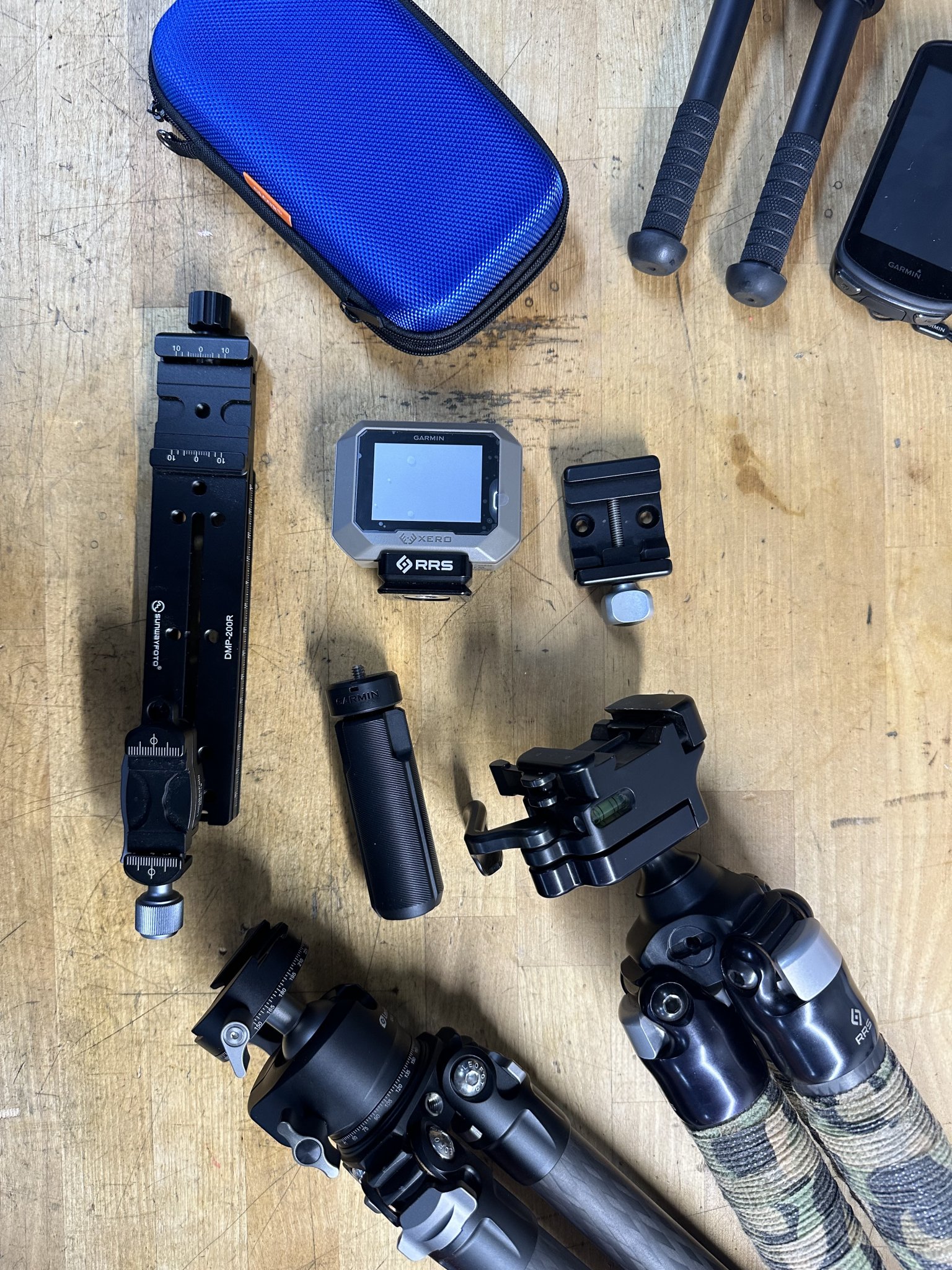

Shiiiit. Too many damn choices.

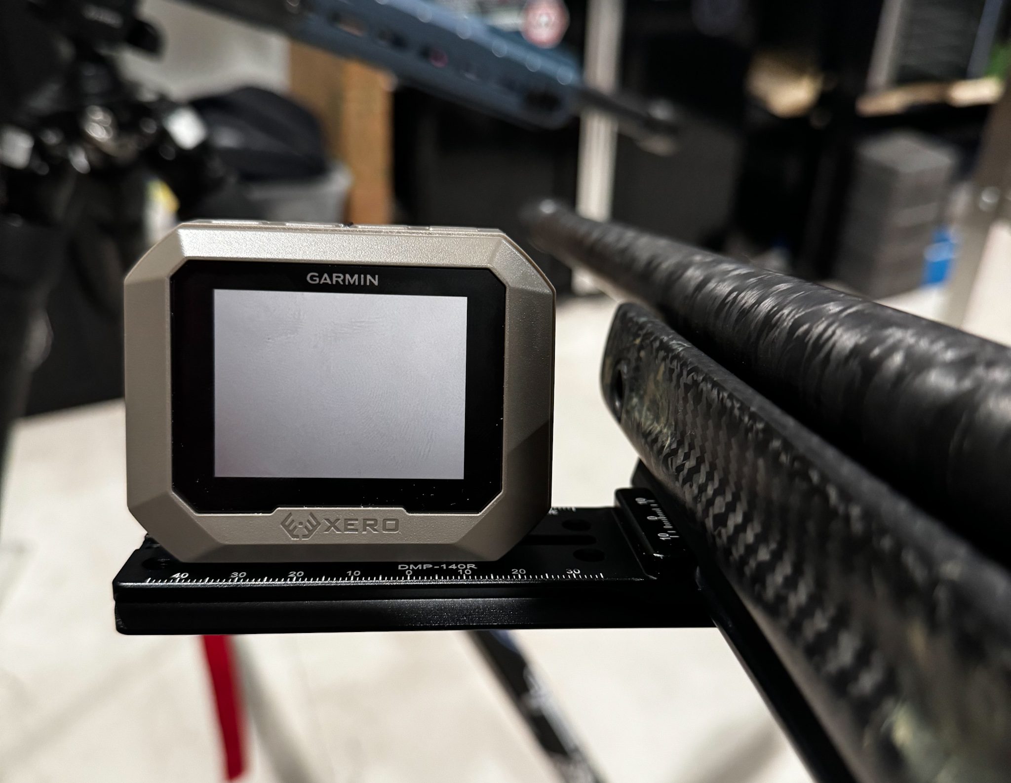

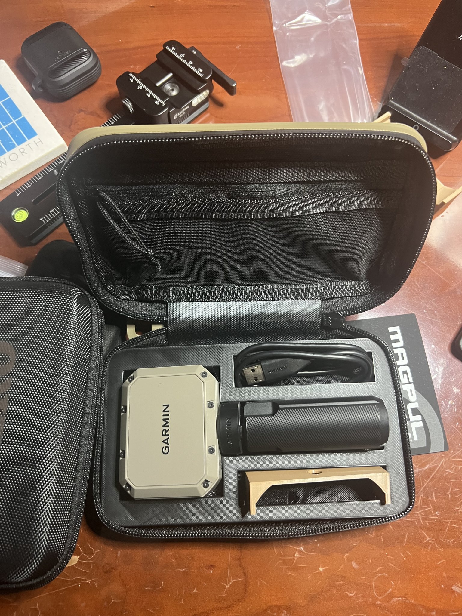

Leaning toward leaving RRS plate on the Xero and getting a cheap 1/4x20 Arca clamp for the Garmin Tripod.
Then getting a cheap Amazon nodal rail with ARCA/Pic rail one one end, ARCA alone on the other end. ARCA/Pic rail end for gun mount and the ARCA end for the Xero. This way I can quickly and easily mount to any config of short or tall tripod or gun mount.
My brain hurts
you mind posting the STL for the rail buffer?
Here you go, nothing fancy, this is 2mm thick on the bottom, so depending on your mounting screw you might want to thin it to 1mm. I don't know how much shock absorption 2mm of TPU will do, but doesn't hurt. There is a flat bottom one that prints easy, and I'm printing the locator tab version now. I'll post up a V2 when I make one, most likely going to kind of make a little more of a cradle. But a real CAD user will be along shortly with something good I am sure.
  • Xero Bumper V1 Flat.zip
  • Xero Bumper V1 Tabs.zip

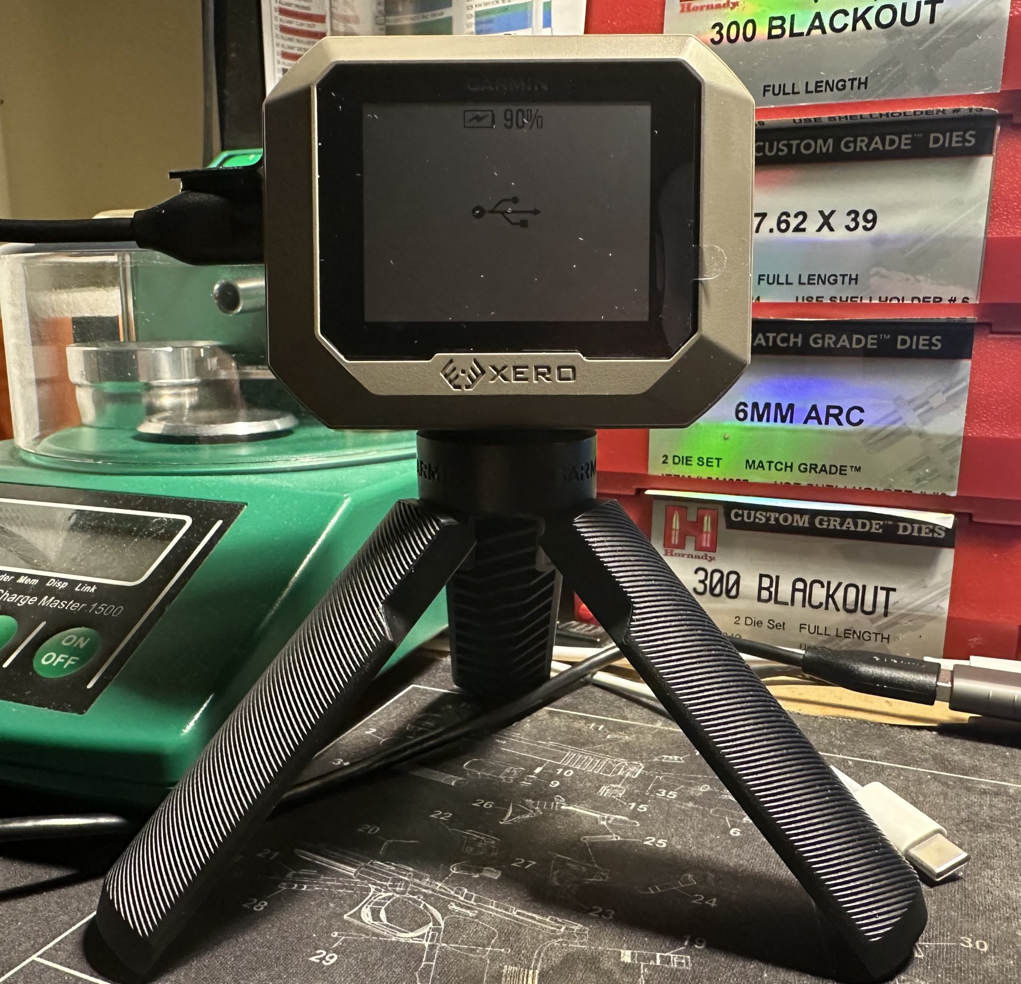

Anyone else experienced this? 10 rounds of CCI SV through my Ruger SSH 3" 22/45 with the DA Mask, and it didn't read any shots. It detected that a shot was fired, just didn't show any velocity numbers. I had it selected pistol and 600-1700 FPS, and tried it anywhere from 5" up to 10-15" above the unit.
@Garmin , yall got any thoughts? The unit is obviously not bricked, as it works (unlike the other guy's that had the issue after updating), but it won't spit out any numbers after detecting that a shot was fired...
I’ve got it charging now (as seen in the pic).

Mine came in today... I love the size of the unit! I followed Garmin's instructions in the book, plugged it into the computer, did the 3.11 update, and it won't read a damn thing. Just flashes a number "1" as if it read the shot crossing over it, but it did not show a speed.
Have you tried doing a reset to factory defaults after the firmware update? I think the button combination is on page 14 of the manual.

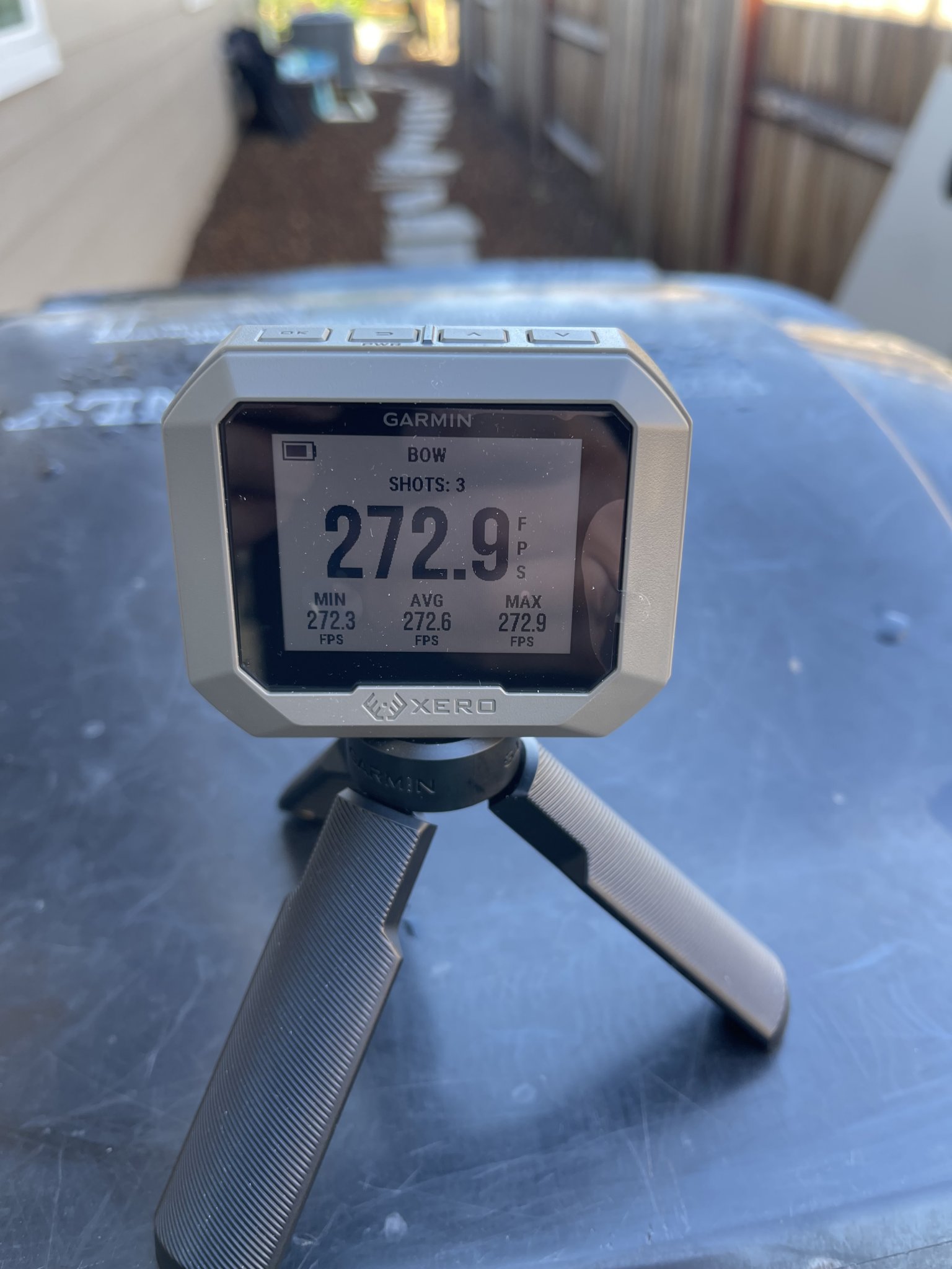

Mine arrived today, I mounted it on one of my PCP air rifles and it worked great. About 5 shots in it asked me if I wanted to update to v3.11, I hit yes, and a couple minutes later it was back ready to go and taking readings.
It's so ridiculously small compared to the labradar you almost don't think it's a real functioning product, lol

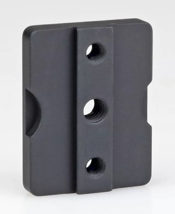

So I got a little obsessed over figuring out @TheOE800 ’s problem of using an RRS lever clamp with the Area419 rail (which is sold out anyway).
So:
1) Buy the Atlas BT56 Arms 17s adapter and attach to the RRS clamp’s bottom
2) Buy one of three USA made rails
http://www.hejnarphotostore.com/product-p/a4-60.htm
https://kirkphoto.com/lens-mounting...ates/universal-multi-use-lens-plate-6-25.html
https://reallyrightstuff.com/multi-purpose-rail-1/
(The Kirk and RRS both have an anti-twist option that might come in handy…it’s not pictured on the RRS but comes with it. All three companies make other lengths too, and I’ve used all of their products. They’re good companies.)
3) Use the 1/4-20 on the rails above to secure the Garmin
Or, I suppose you could use any old piece of wood/metal/etc for the “rail”, or an Asian-made rail.
Anyway, there you go.
