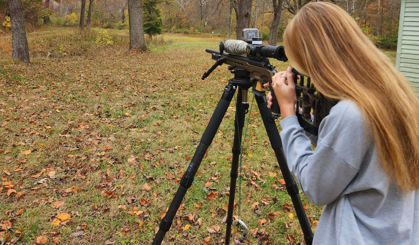

Is this you? Talk to me about this shooting position? Shouldered left side. Left eye on the scope? but right hand on the trigger.
Cross eye dominant?
Heck no, that ain't me. LOL Look at that setup. Now look at the shooter.
That shooter don't own that firearm.
It's my daughter, who is cross eye dominate, has always struggled mightily to get in the eye box on optics. She has never had fun shooting, unfortunately, but likes hanging out with me.
She did hit a 4" steel plate @ 230 yards with 22lr on the first trigger pull though. So, for all the bad positioning, still got her mark.

That ATACR isn’t making it much easier on her… they don’t have the tightest eye boxes, but they’re definitely not know for being the largest or most forgiving, either
100%
First rounds were at the full size torso profile plate about 150 yards, can be seen to the right, that was on the lowest magnification.
Then she said what about those ones further down there.... there is a 12" and 4" at 230, 233 yds respectively. I said okay. She hit the 12" at about 20x, but I bumped it to 35x for the 4" and she hit it on the first shot as well.

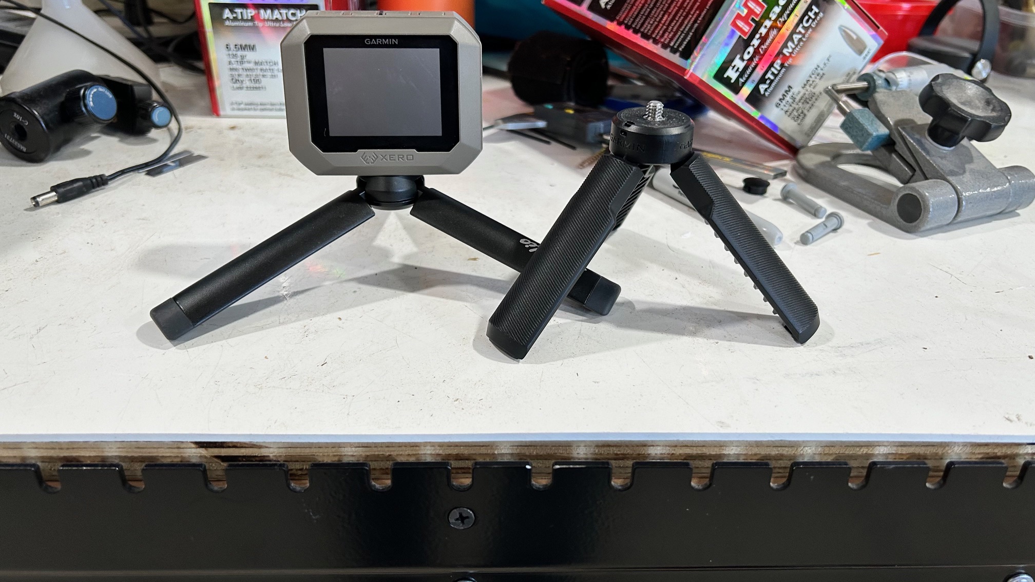

Got my Xero C1 Pro from Bass Pro today. First impression..., this thing is really SMALL!
When settng up on my unit, somehow I hit the wrong language instead of English. Tried factory reset several times but that didn't reset it. Parts of the menu were in English plus some other language. The ShotView App on my phone mentioned new software available that would fix language issues on the Xero. (You can't update Xero via your phone that I could find.) Reviewing the online manual, I found a troubleshooting note about adding a language to the device via the Garmin Express App. The Garmin Express App is used by Garmin to update their devices. I was familiar with the the app since I had used it to Garmin GPS units that I owned over the years. I added the app to my Macbook then added the Xero to my devices in the app. Took several minutes before app offered the 3.11 software update. Updated the the Xero with the new software which fixed my issue. Paired the phone to complete the setup.
Setup was easy except for my screw up. Off to the range to try it out.
Here's a metal tripod marginally longer than the Garmin. It can sit very low without blowing over in the wind. That's happening in today's wind with the Garmin tripod. The legs on the metal one have tighter tension and you can set them in any position.
