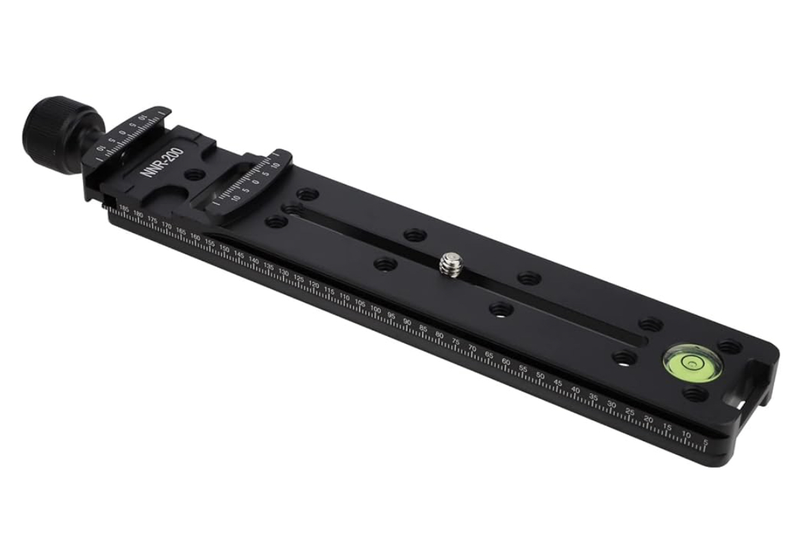

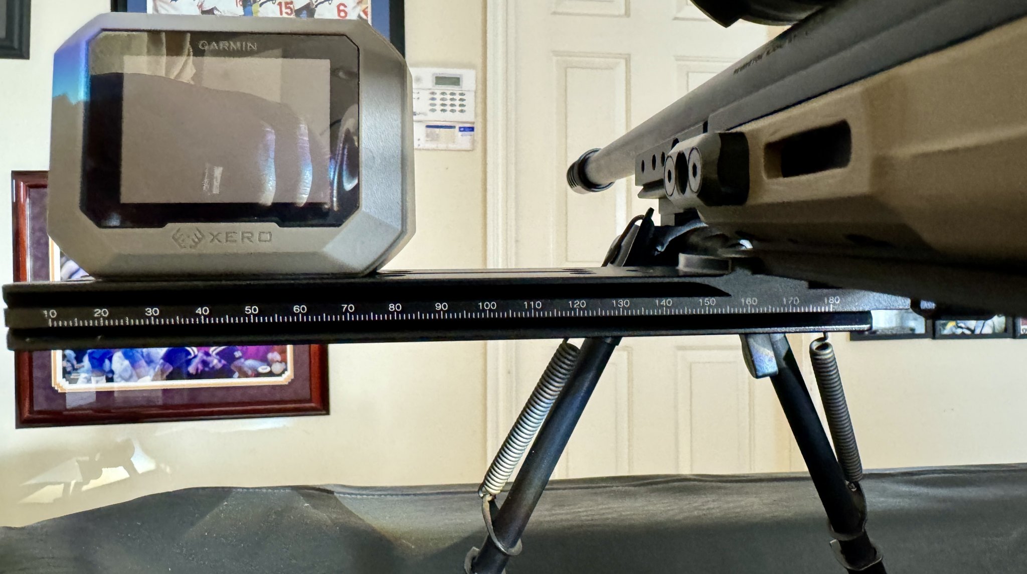

Not yet. Tomorrow I’ll use it for first time. Long term plan is to use a 200mm camera rail attached to rifle chassis ARC(on order). I’ll start first few shots as per Garmin’s setup instructions with tripod to baseline everything works then will try on the scope mount. I will be doing some positional shooting which is why I want it attached to rifle. Hoping scope mount works. Will report results.

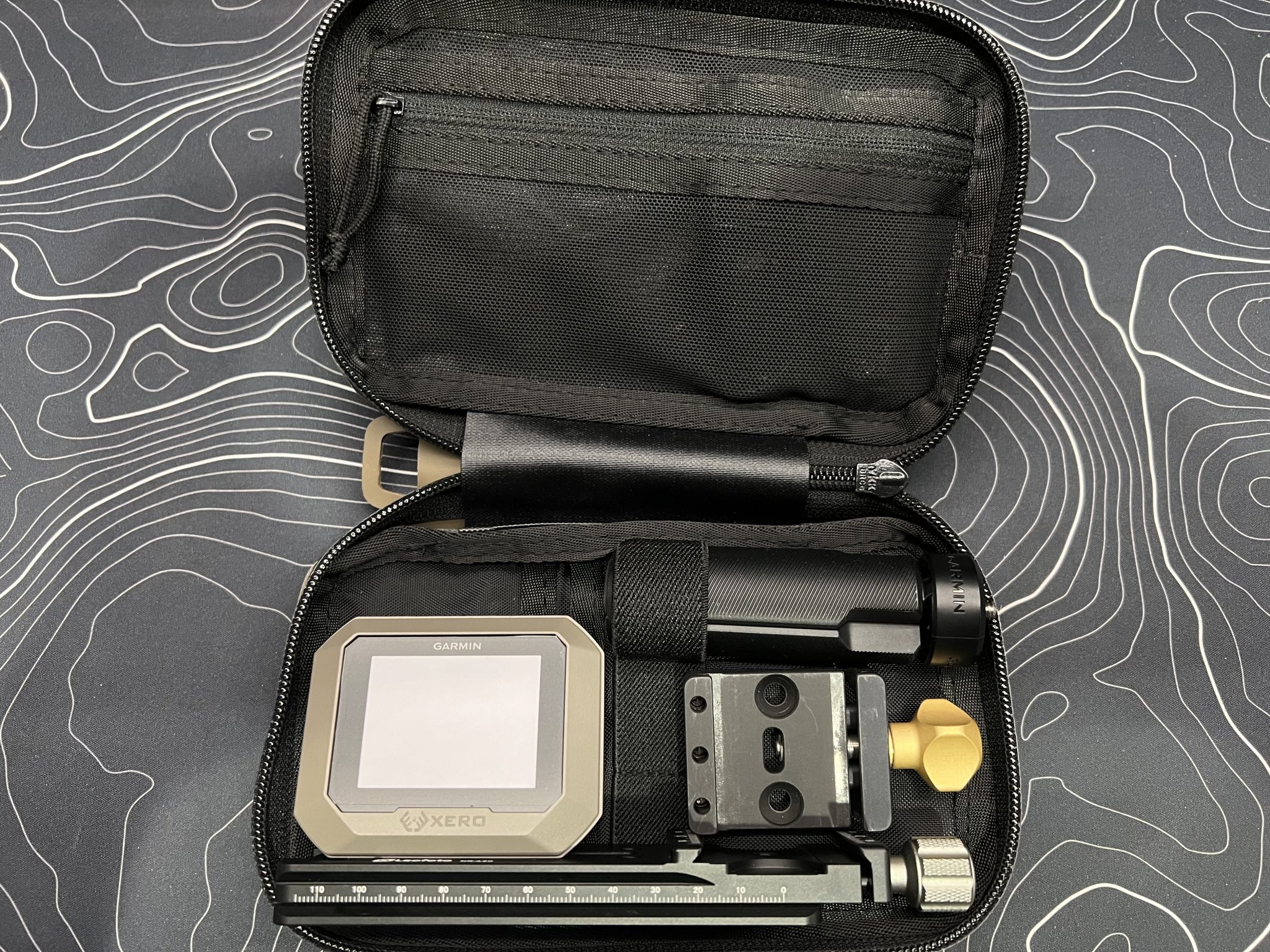

Evergreen 56, took over a week to deliver so Amazon refunded me plus $15 extra. It’s a tight fit with the bigger tripod and arca on the bottom of the garmin but everything fits fine.

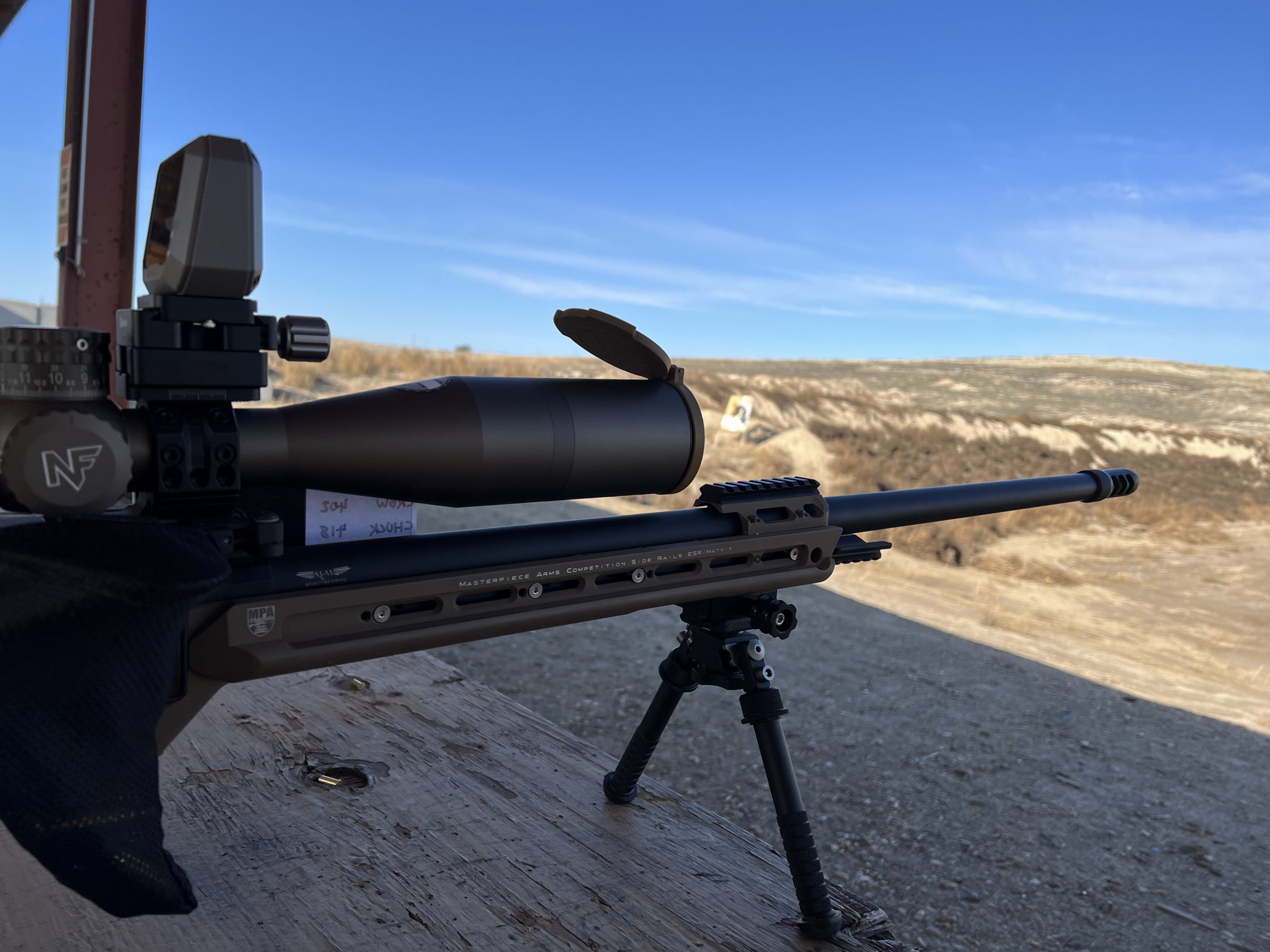

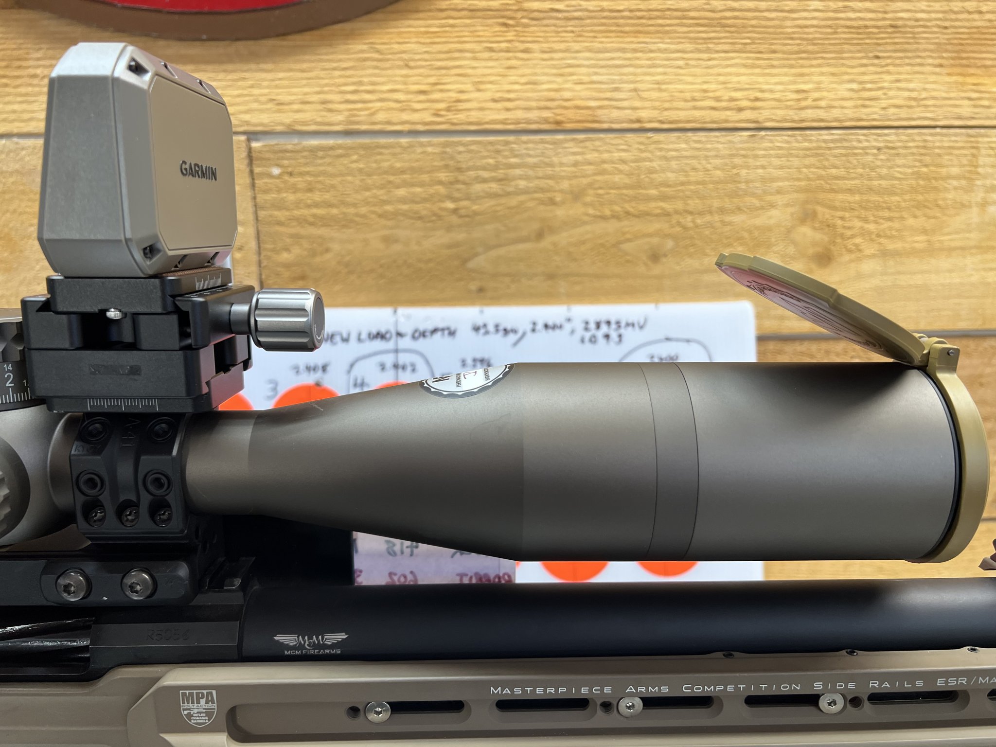

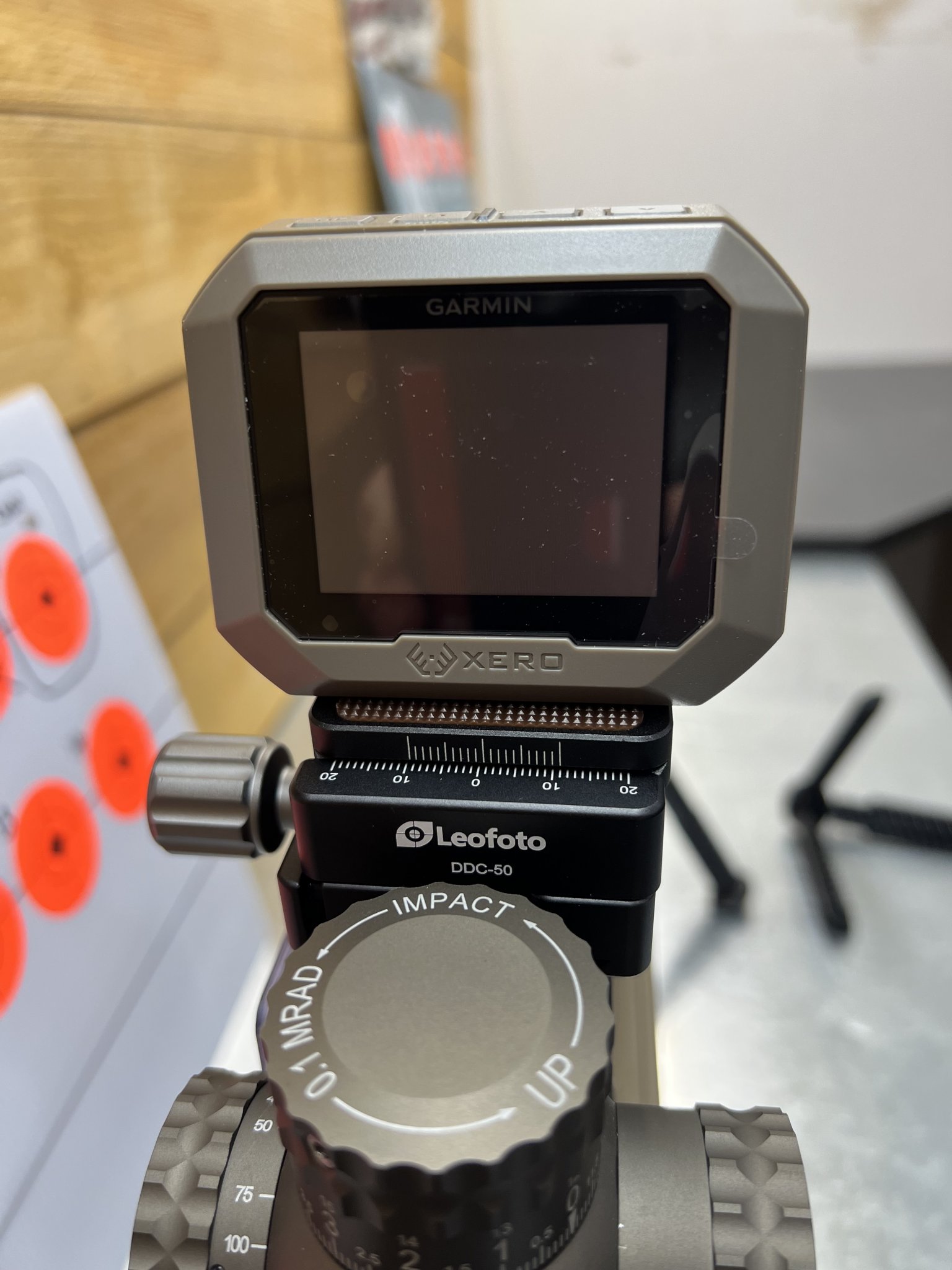

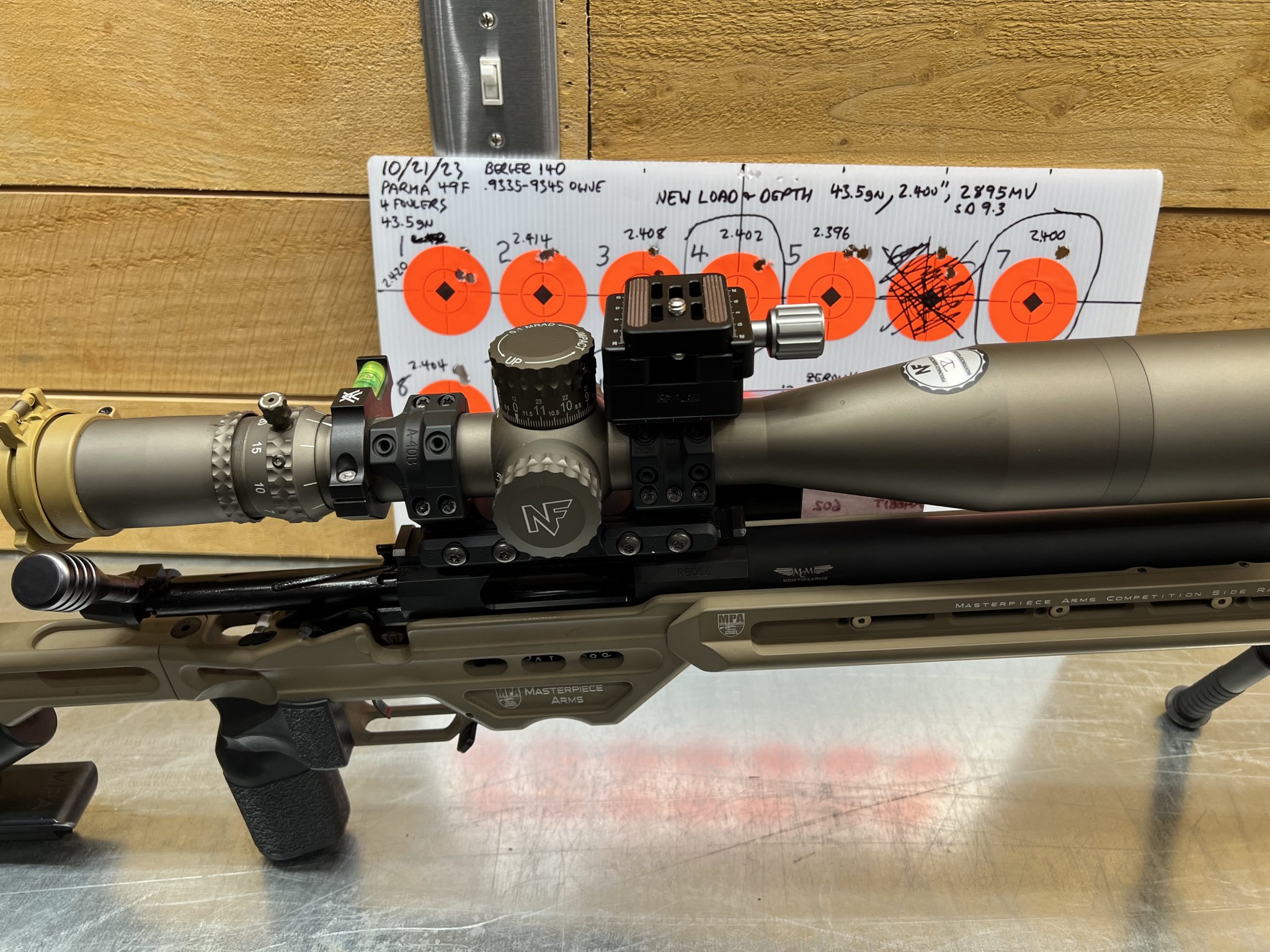

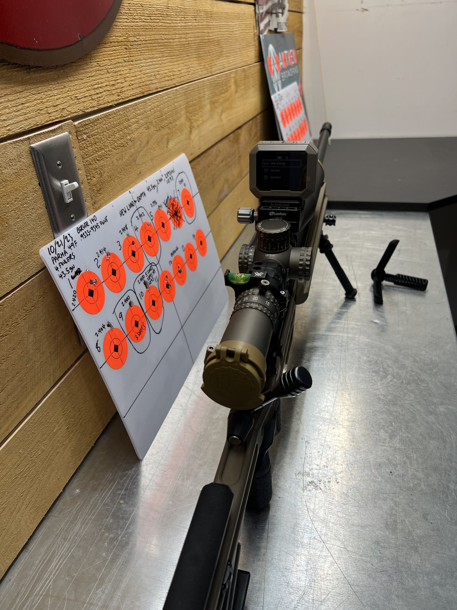

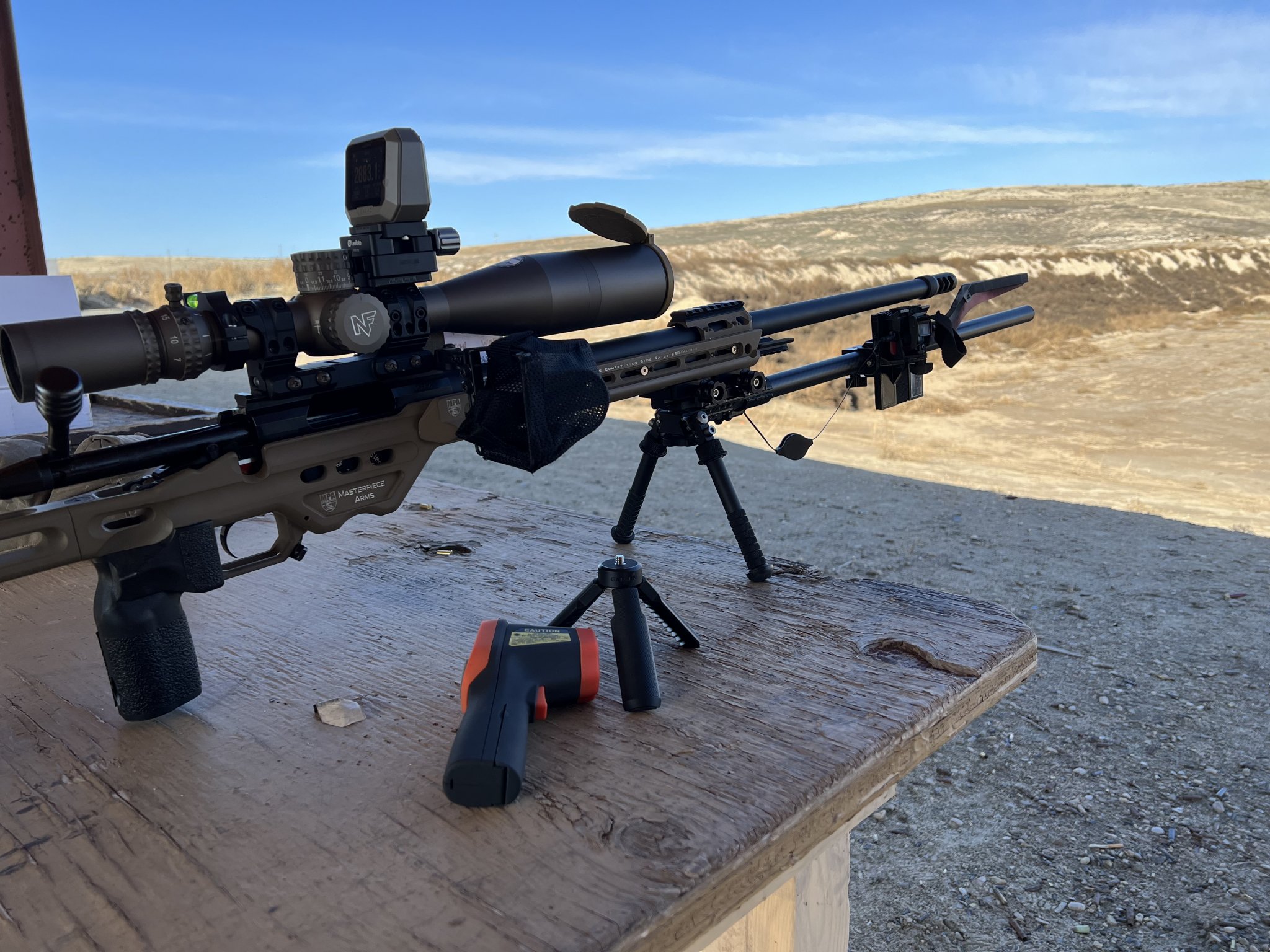

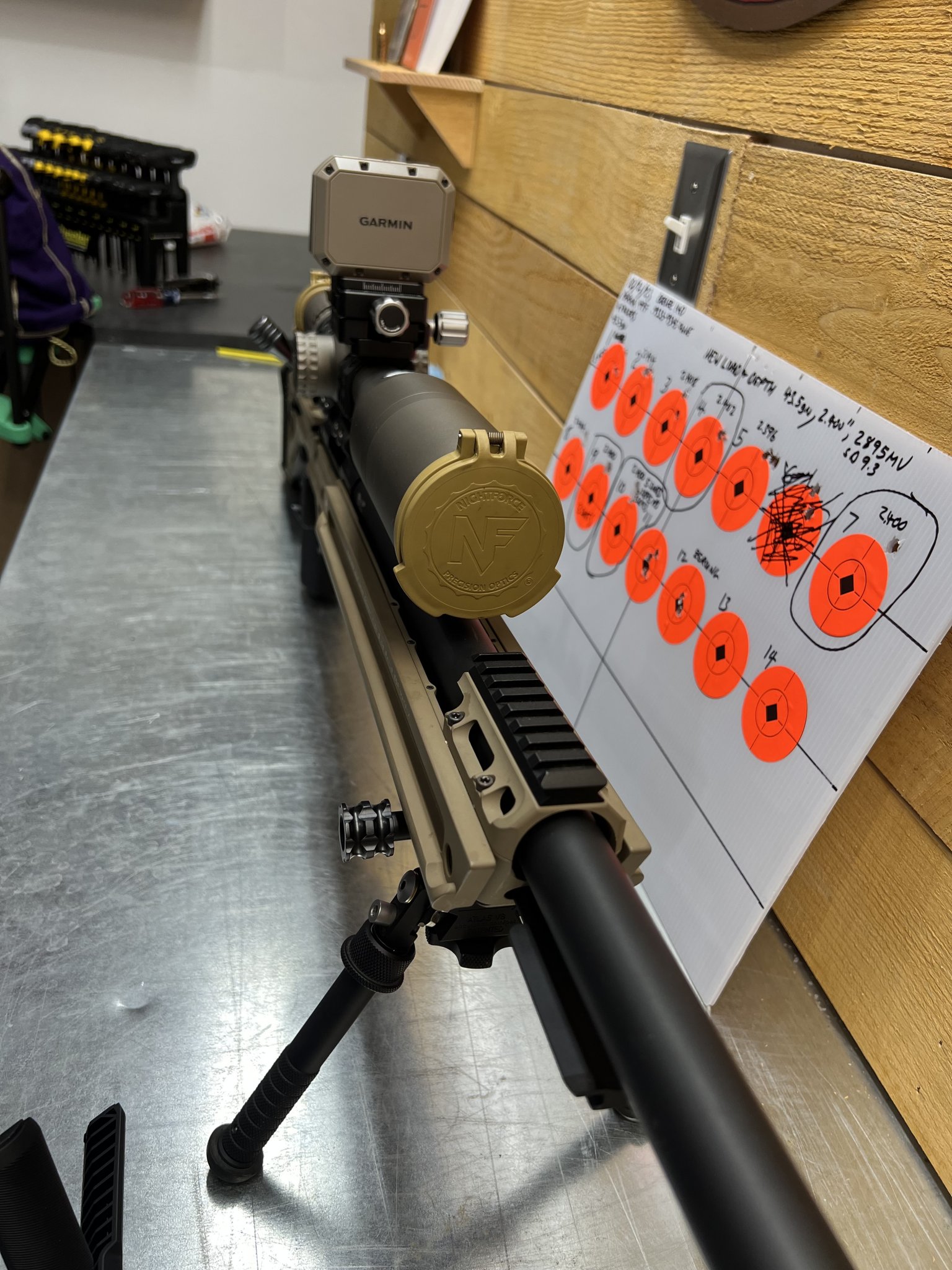

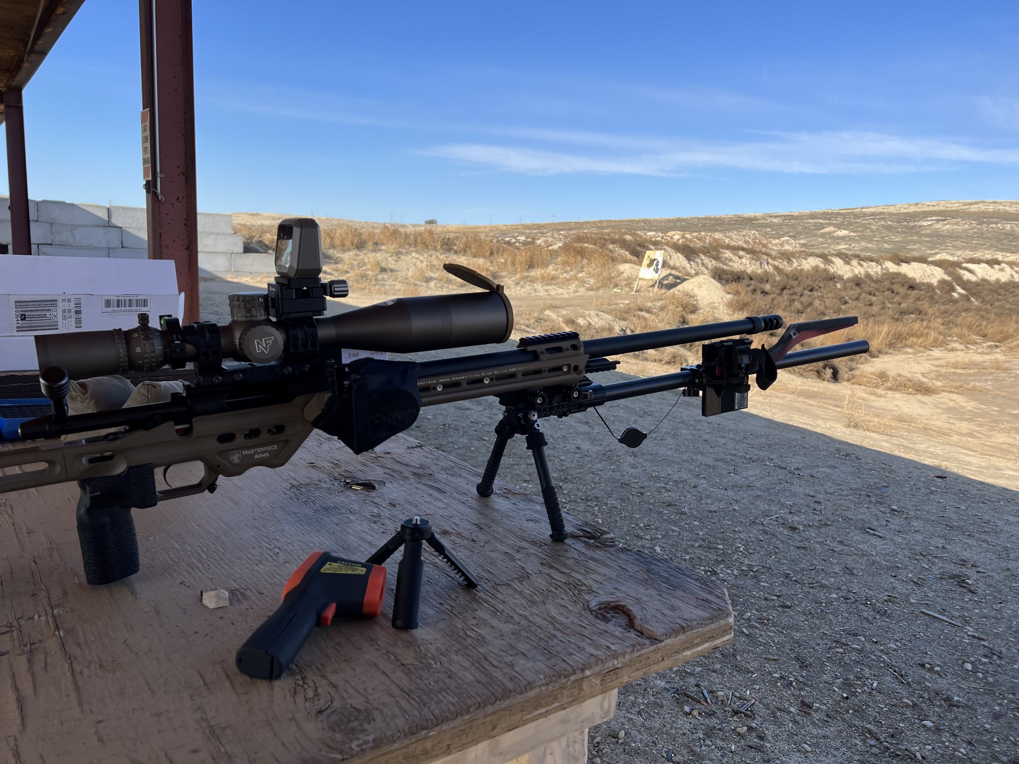

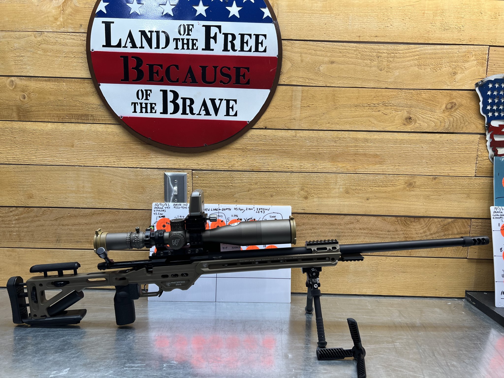

Used my Xero for first time today. 56 rounds and missed none. FWIW Shooting 65CM with Berger 140 hybrid targets. 43.5gn H4350, Lapua SRP brass and CCI450’s. 50f-55f 3-5mph wind. I did some chrono correlation between MagnetoSpeed V3 & Xero, results:
Xero mounted on top of the scope:
  • Back of Xero was 30” from the face of the brake
  • Bottom of Xero was 5” above centerline of the bore
  • The scope cover partially blocked the back of the Xero as you can see in pic
  • Result was 12.3fps Ave delta with Xero being slower
Xero on tripod:
  • Back of Xero was 20” from face of brake
  • Xero was 6” from the chassis
  • Result was 10.0fps Ave delta with Xero being slower
Xero on tripod:
  • Back of Xero was 15” from face of brake
  • Xero was 5” from chassis
Was expecting closer correlation vs other MS<->Xero data that has been reported. What was interesting is the MS was recording speeds 10fps faster than what I expected for the load I was shooting. Xero correlated perfectly to data I was expecting. I’ve shot hundreds of rounds with the load I was shooting so I know the Xero’s numbers are correct. I need to triangulate with another Xero but I trust the Xero’s numbers.

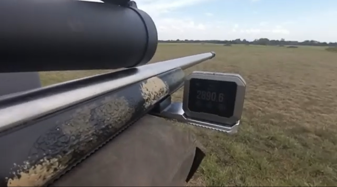

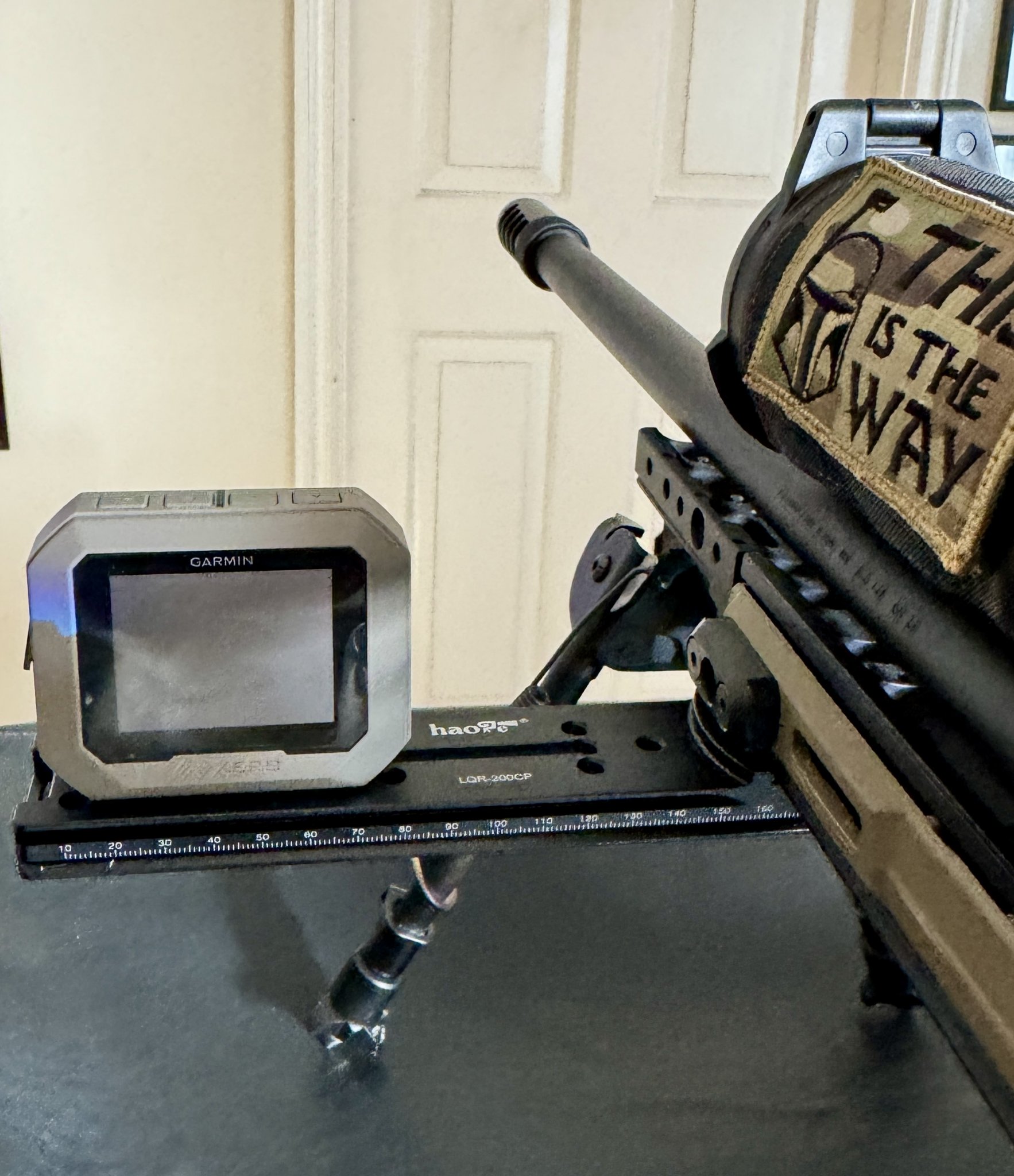

Yes I saw that LOL! Below is a snapshot from the Garmin product video😉. My 65CM rifle is 25lbs with little recoil. Gun featured in their video is a lighter weight gun that I’m sure recoils much more then a lot of PRS style guns like mine.

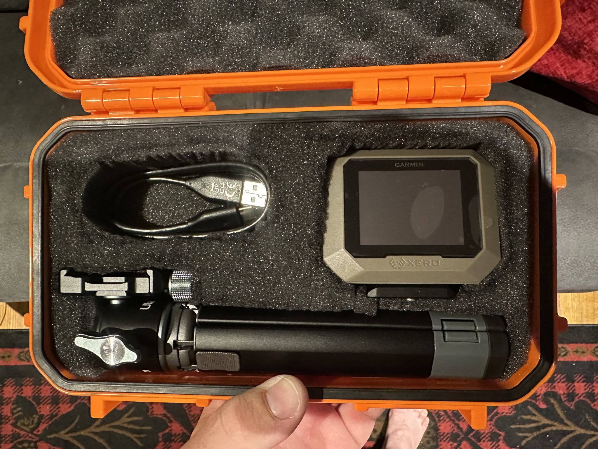

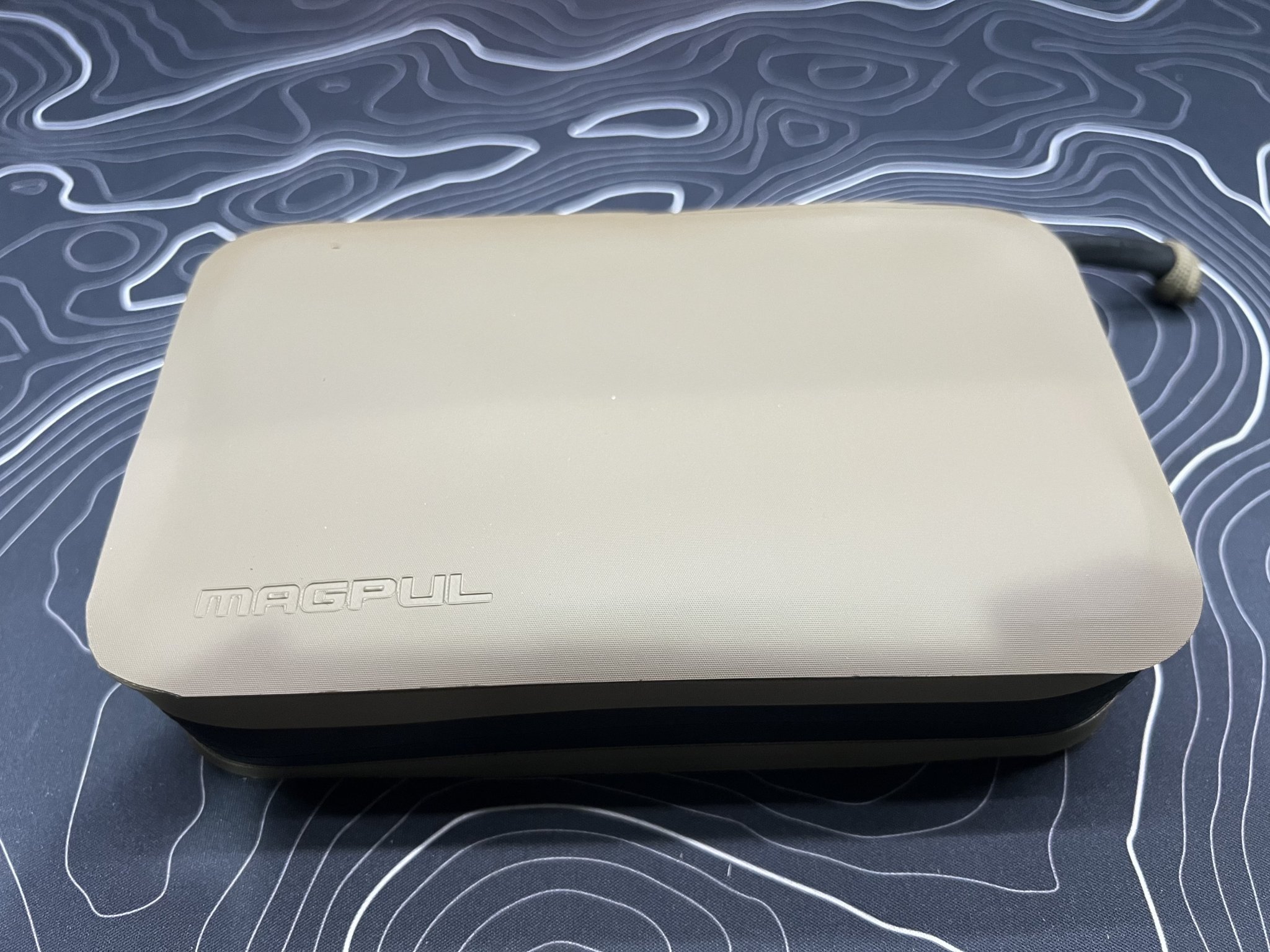

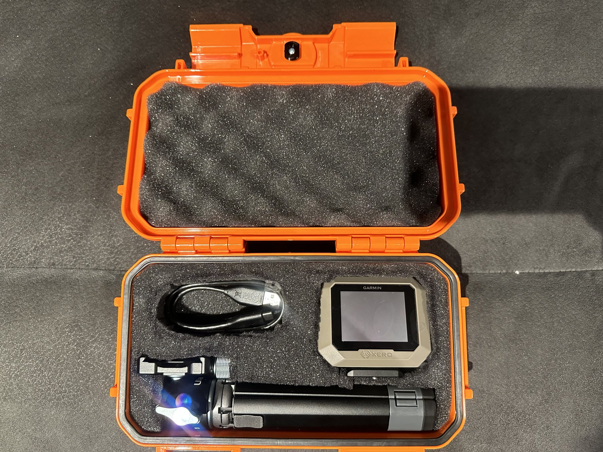

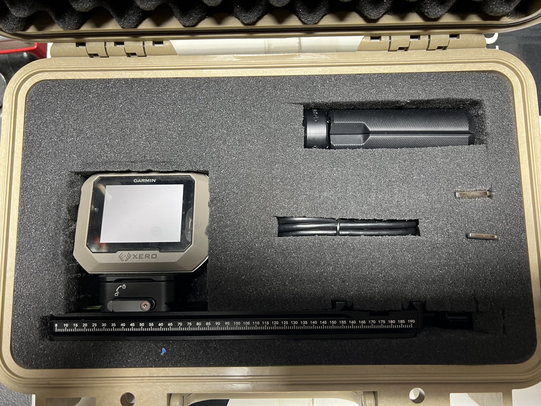

Well here is mine, I finally got around to fitting in a pelican case. Was super easy since it came with pick and pluck foam. Not much more to say, but good luck and enjoy.

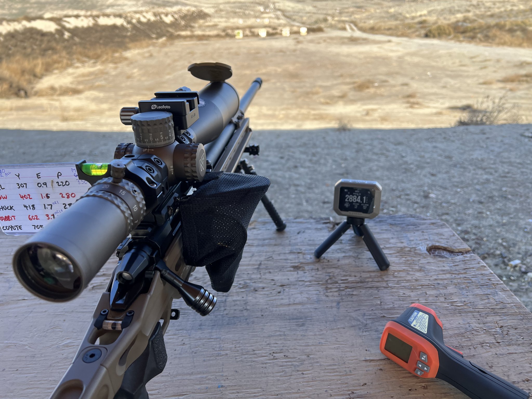

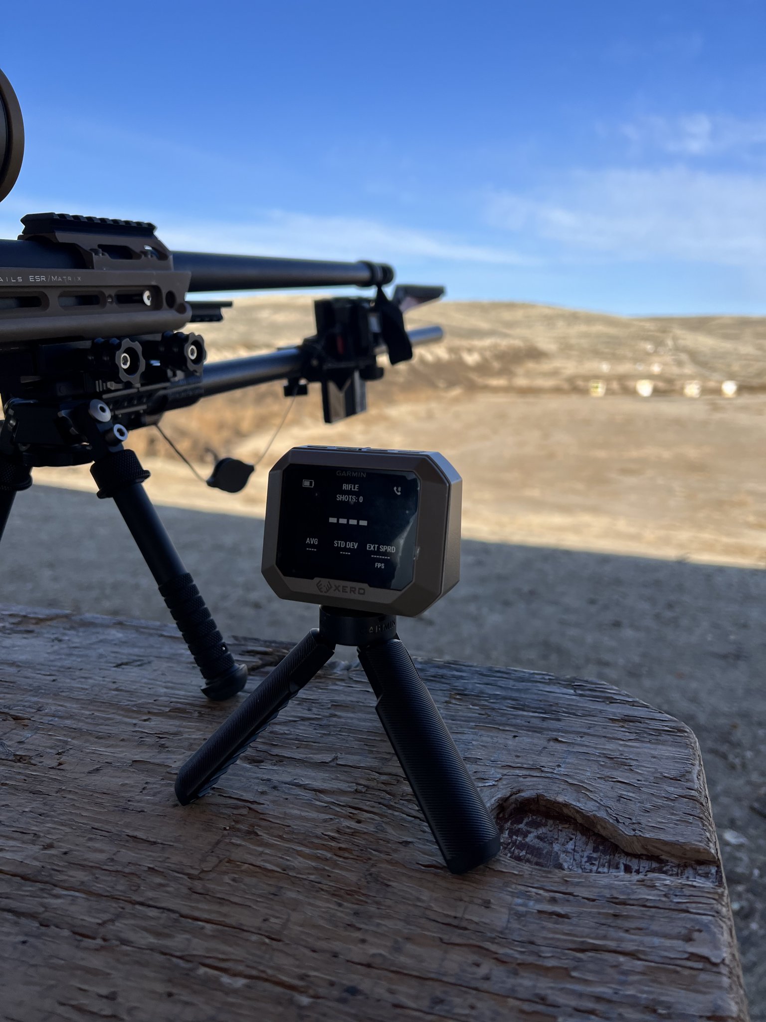

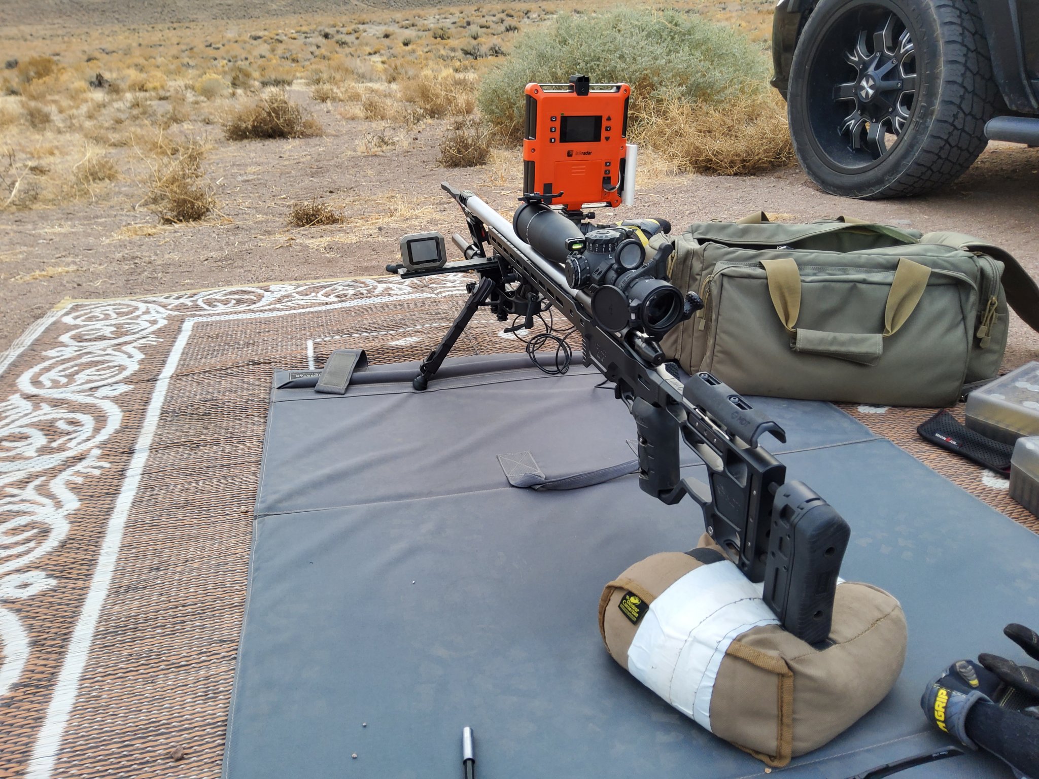

My outing today. Labradar and Xero were almost identical with ES of 3fps. The V3 was faster every time. Average of 7fps, ES of 12 fps faster than Xero. Did not miss a shot.
