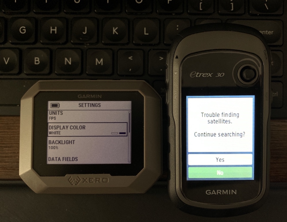

Probably won't matter much outside, but I was pretty shocked how weak the backlight on these is. Seems even weaker after the software 3.13 update but that could just be my imagination.
Side by side with a 12 year old Garmin Etrex 30 both at 100% backlight. No flash, mid day, cloudy, fairly low light in room. Xero is 100% charged, no idea on the eTrex just grabbed it with whatever batteries it had in it. In person the difference is even more than the photo suggests. The one good thing about the older transflective monocrome displays garmin used here is they do quite well visibility wise outdoors with no backlight. A colored display would need a ton more backlight to be useable, so it probably conserves battery and color really serves no purpose in this application.
Looking at say an iphone display the 100% brightness on the garmin is equivalent to an iPhone on about 10-15%

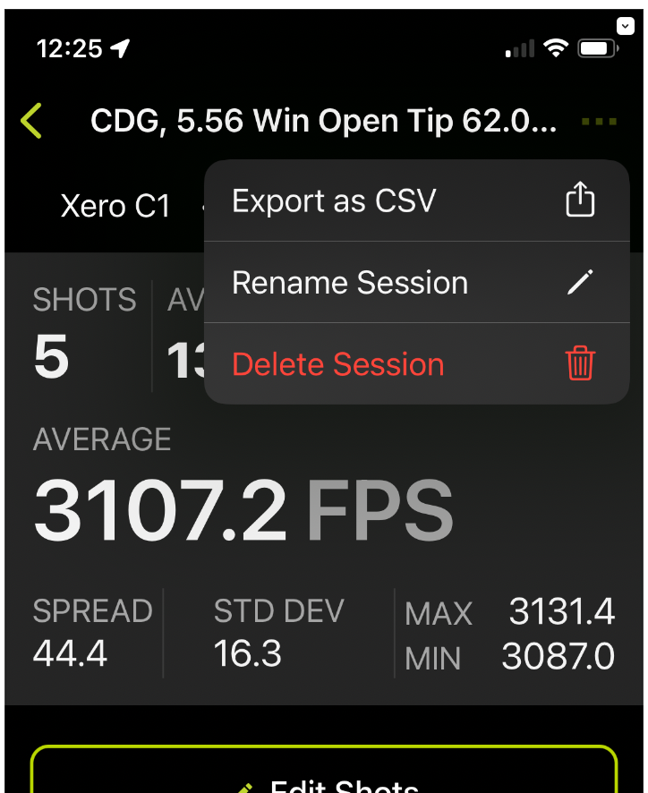

Having played with mine a bit, there’s one feature I wish it had. Clearing the data also resets user settings. I wish it didn’t. I reconfigure the data fields for my use, and I have to re-configure them when I delete all the sessions. Not a big deal by any stretch, but if anyone from Garmin is monitoring this thread, that’s my opinion.
Or perhaps I’m an idiot and there is a way to delete the data I don’t know about.

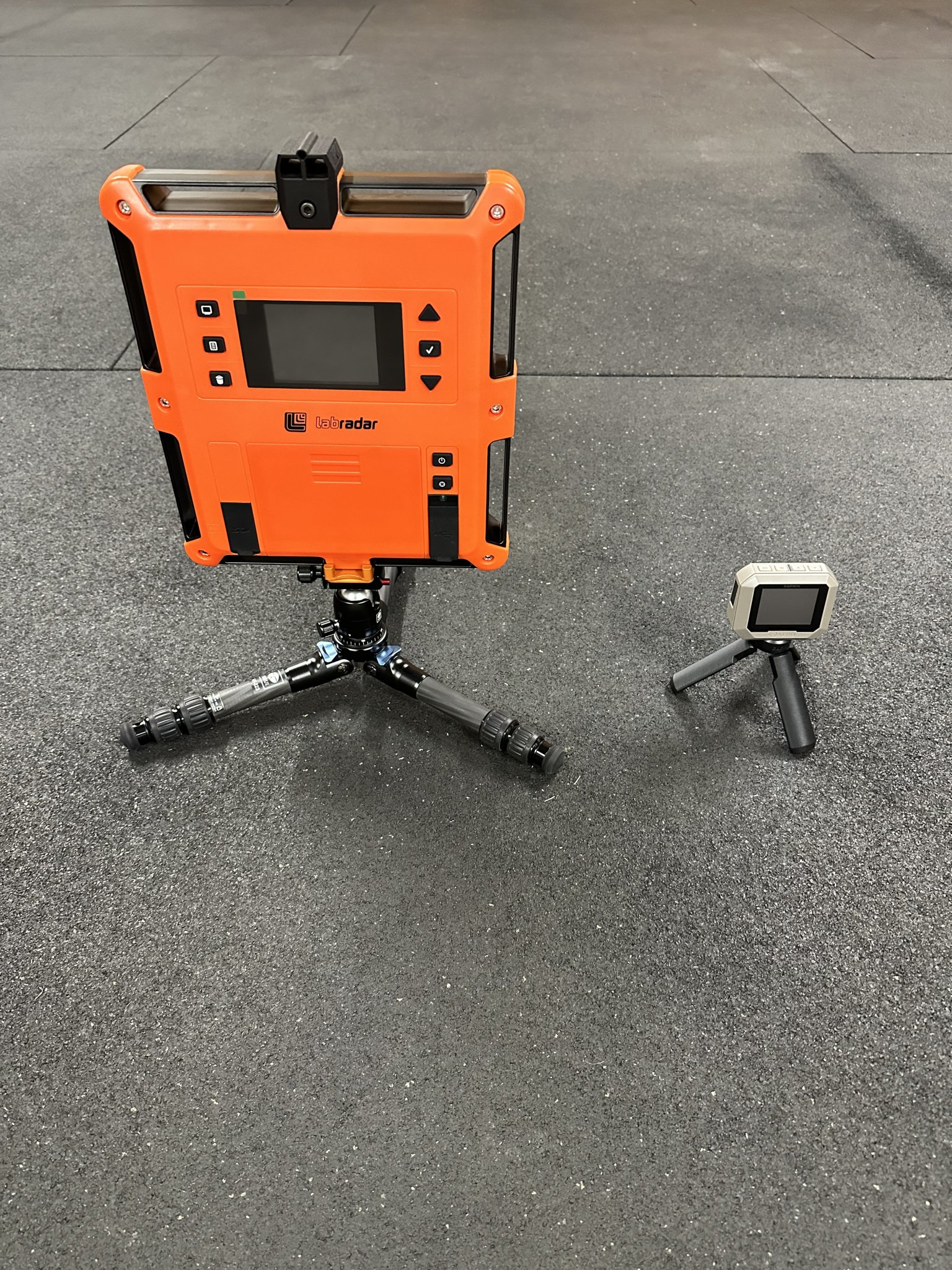

Jumping the bandwagon because the labradar is trash when it comes to reliability.

WOW! What a difference in size! I've seen a few guys with the LR at the range I go to. No wonder everyone is jumping on the bandwagon

Couldn't agree more about the level of brightness.

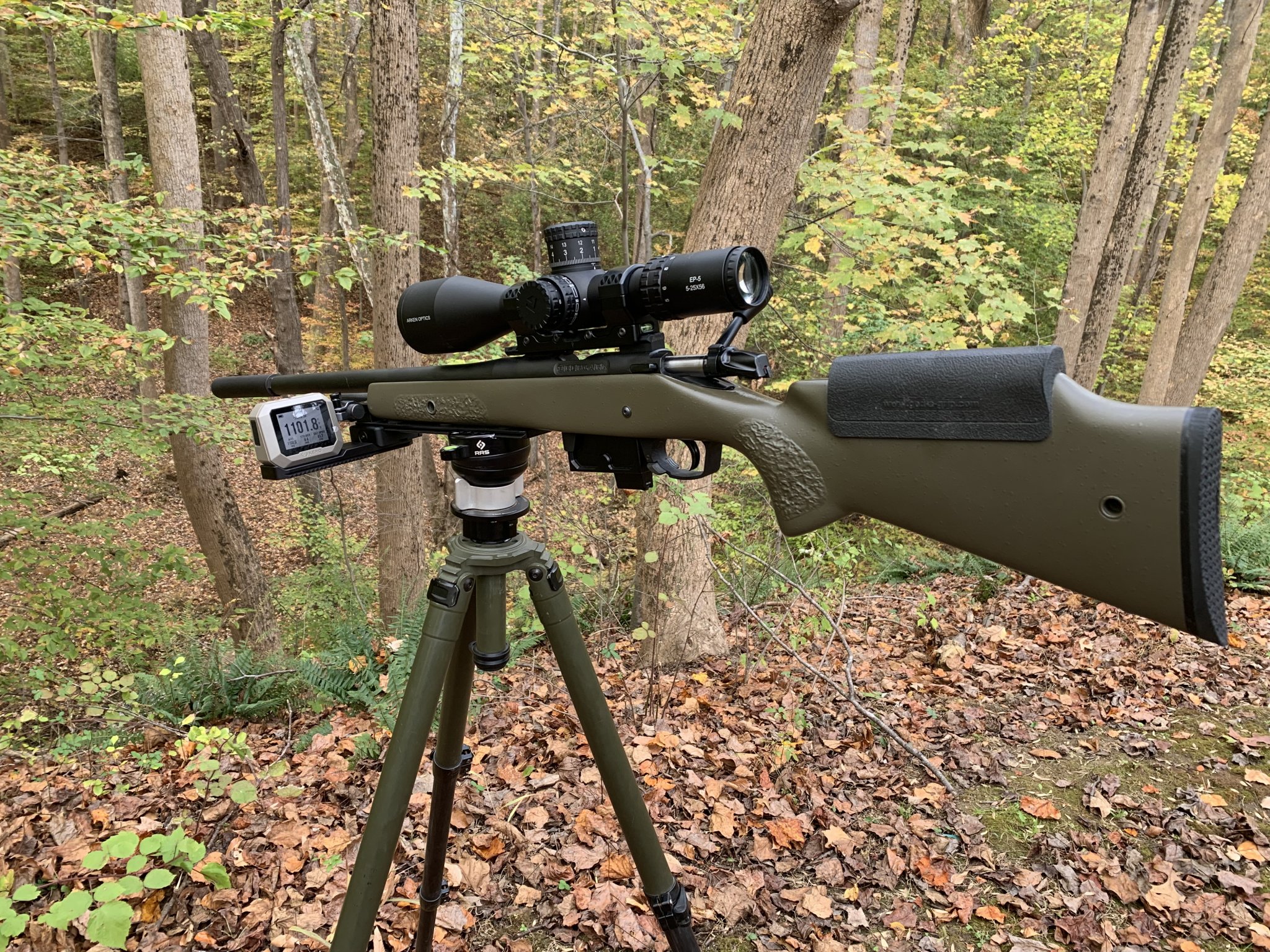

Ran 20 rounds from suppressed 22 & this thing rocks. I was shooting about 75y through a lot of branches & it didn't miss a shot. Must be picking up projectile pretty close to muzzle.

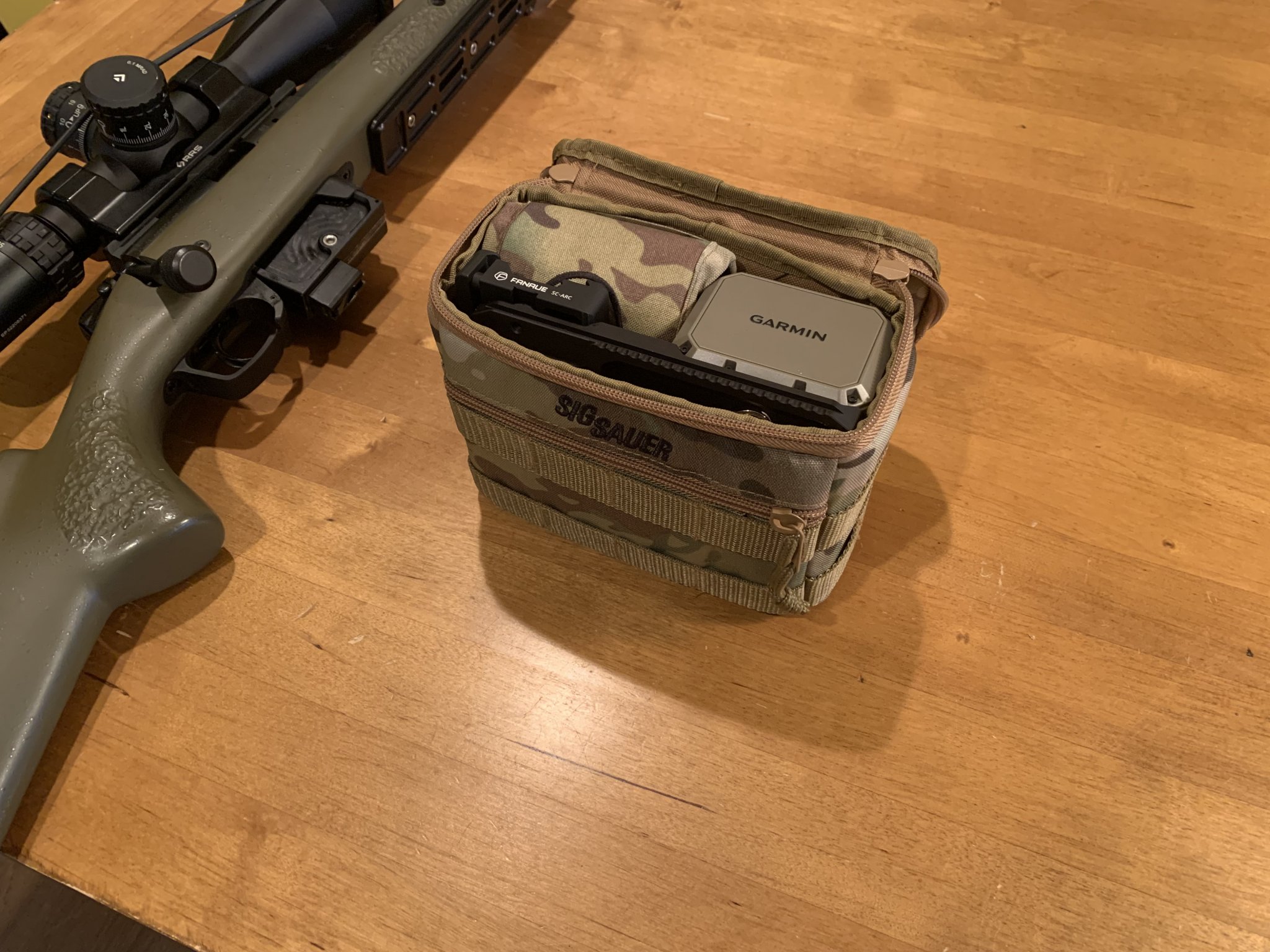

Ordered a Pelican 1120, but mean while it fits the Sig 8K case with the RF.

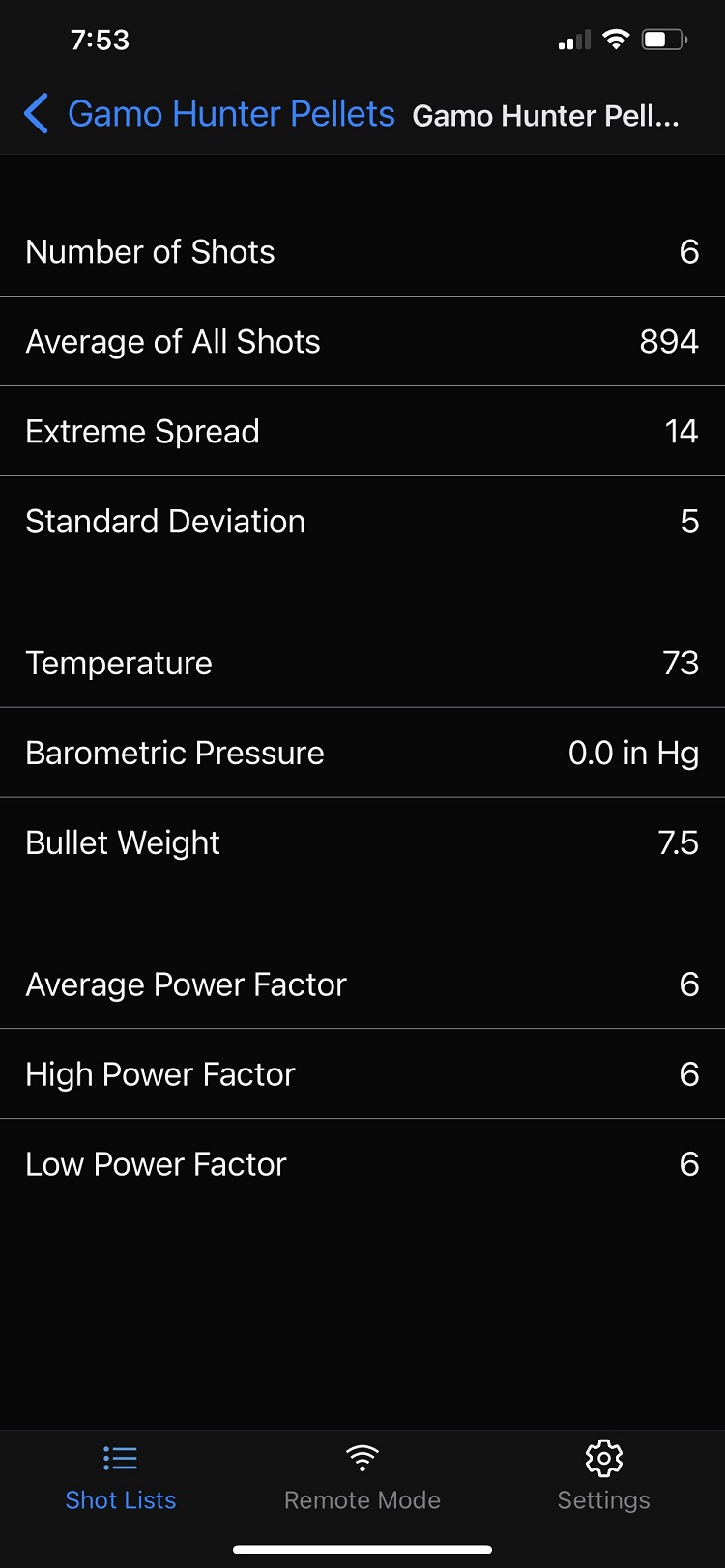

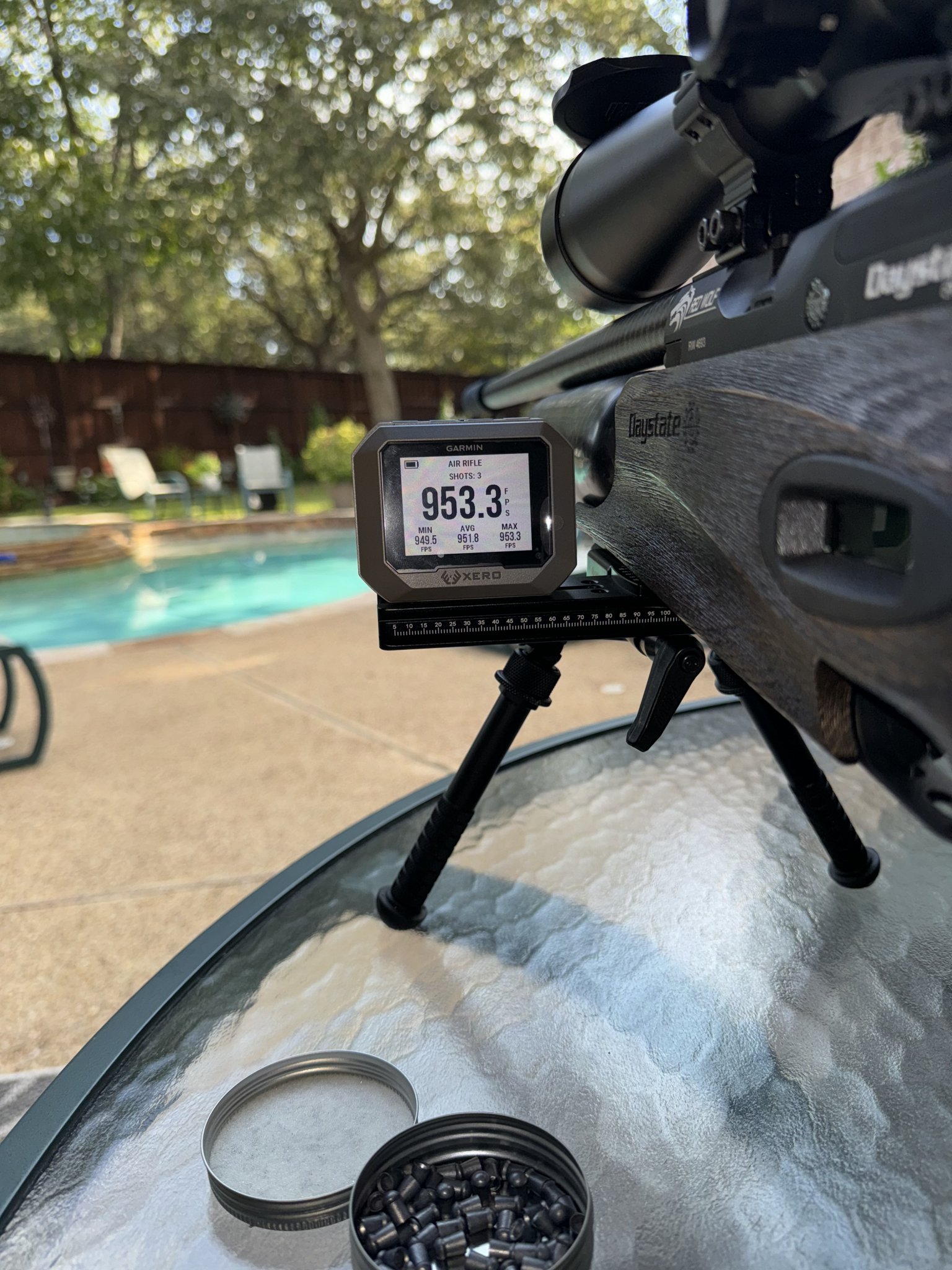

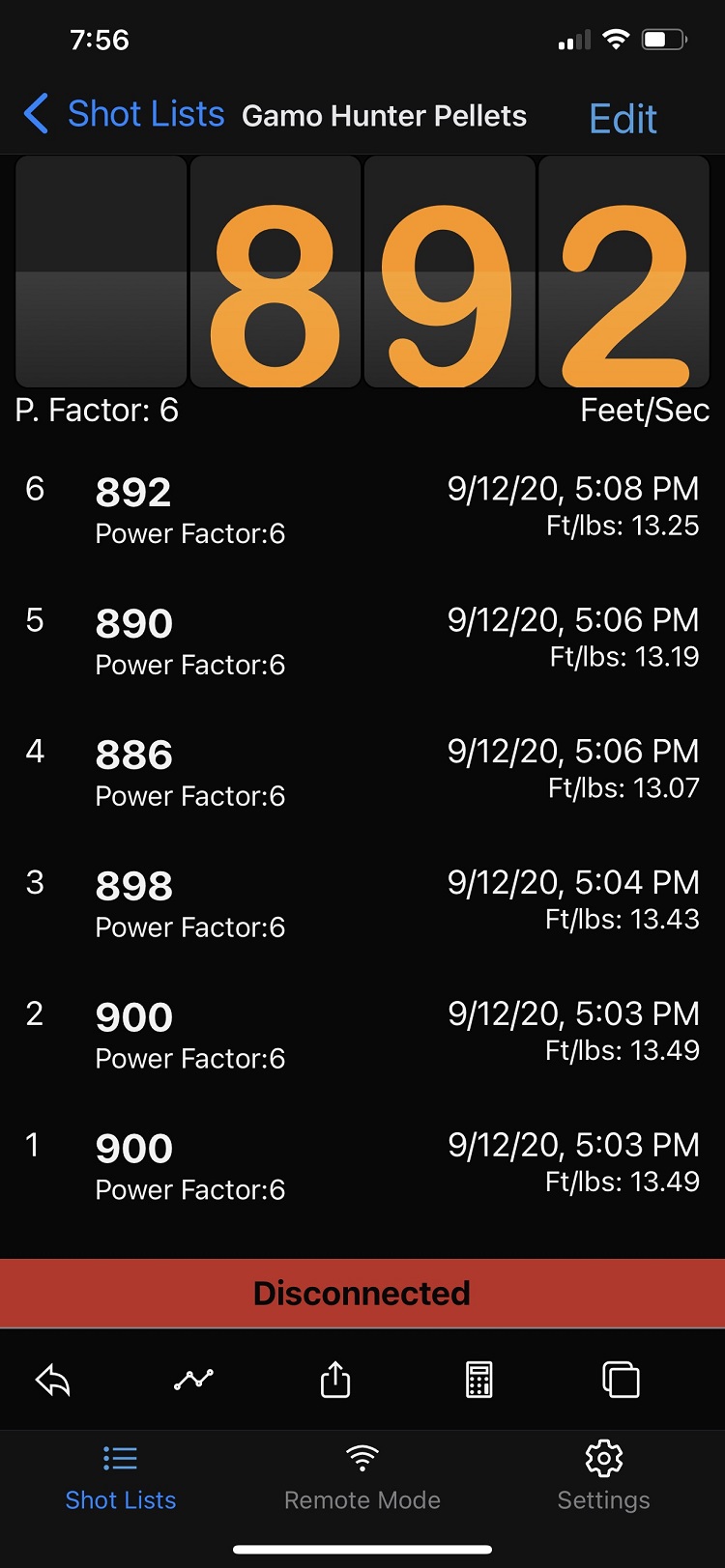

I tested some pistol rounds yesterday, the garmin was on a table about 26 inches off the ground and I was standing behind it I'm 6-1 so about 52 in above ground , recorded every shot , finally a fool proof chrony , verified some factory rounds and some hand loads I was just guessing on , I was off about 70fps , on the slow side , so good info .
As a side note I'm having a little trouble navigating through the menu after the shot string to find the info I want , but that's on me as I'm somewhat computer slow, but I'll get there.

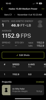

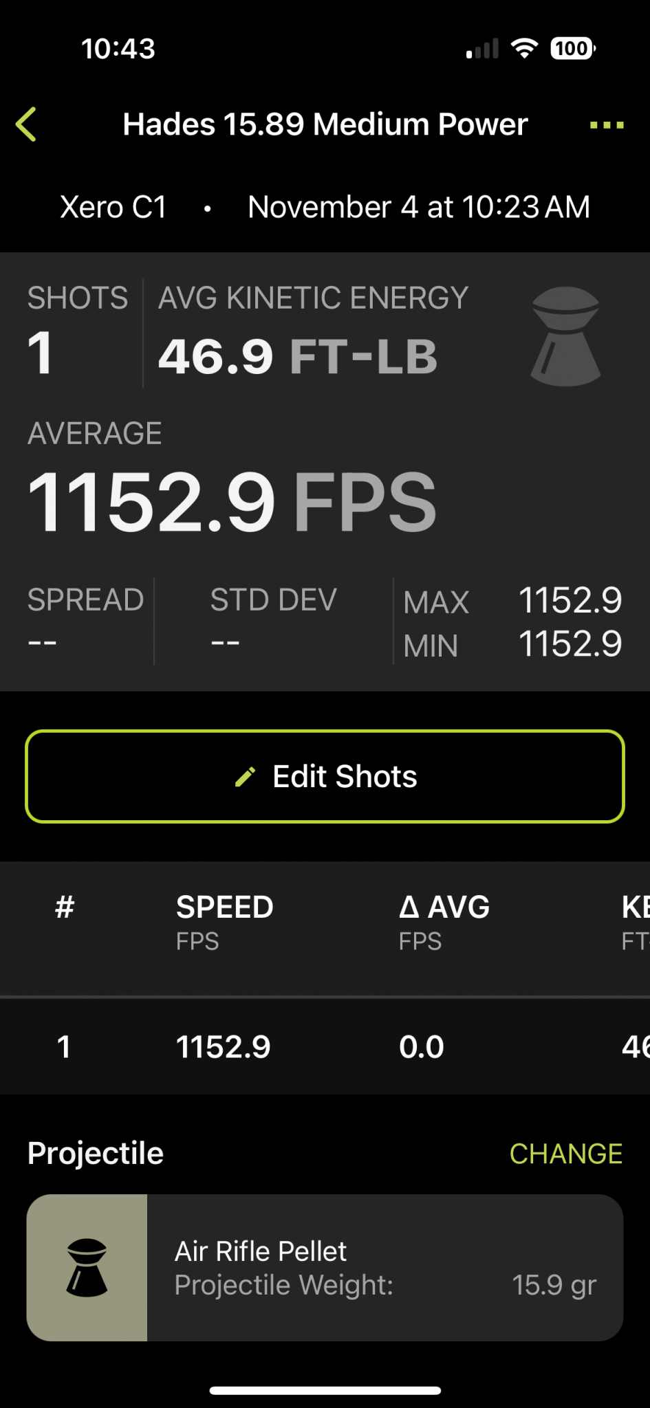

I clearly need to up my 'air rifle' numbers.
(Can we add fields to the load data in the Garmin app, to track, for example, power/charge/primer/bullet/etc/etc/etc? I have hundreds of loads in the ProChrono app, using it like a virtual log book, so like to add custom fields for future reference...)
At this time, you would have to use the "Note" section of the Garmin ShotView app to store the additional data points.

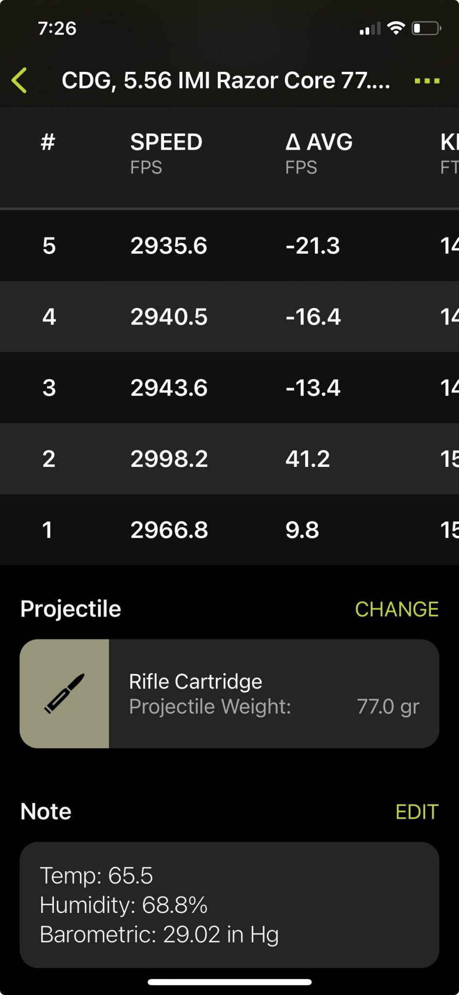

Used mine for the first time today. Shot an AK over it just because, picked up all 6 shots no issues. Swapped to my 6 ARC gas gun and shot 10. Again not a single missed shot. Grabbed my 338 Edge and same result from 6 shots. Tossed it in a Nanuk 904 case with a custom insert.

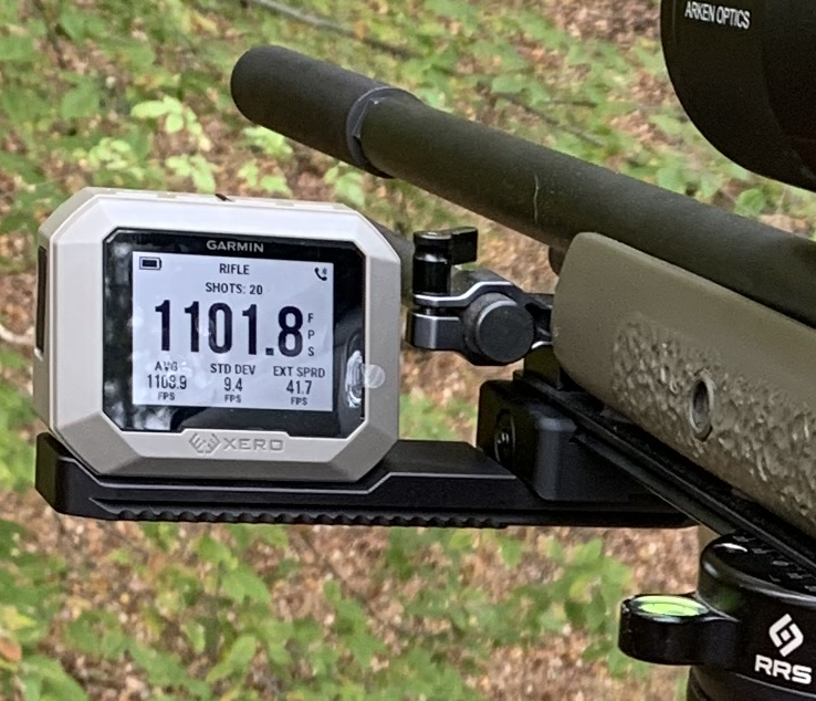

The only part about mounting on rifle for matches is you can’t shoot too fast it won’t pick up the followup shot...
Shot pretty fast today during one stage of the PRS finale and collected data with my Garmin. It caught all shots. Not a real problem unless your running a 25 second PRS skills stage barricade 😅

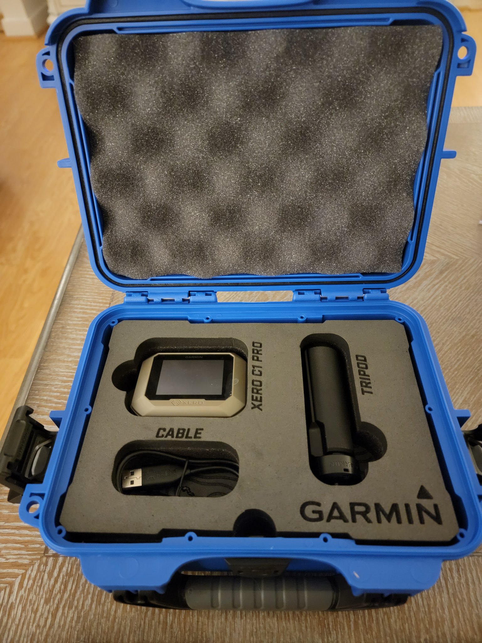

Do those inserts come with a pre-cut foam layer under the insert, or you do have to pick-and-pull it the best you can, then just overlay the insert? I assume it comes with the under foam, as it looks like you have nice, clean corner cuts on the underlayer...
The insert I bought from a place called Range Panda and it comes all cut out. I linked it earlier in this thread. I found them when I was looking for a case for my LR after I got it and found them. The case I ordered from Amazon.

Still waiting to use mine, does the app allow you to print out results?
No.
The app allows you to download each session (separately only) as a CSV file other apps like Quick Share, Gmail, AOL Email, Drive, Yahoo Mail. It's not very convenient. I simply export each session to one of my email addresses, then open the attachment and put it into my spreadsheet. And since it only does one session at a time, having multiple session, I have multiple emails to combine all the day's sessions into one Excel file.
I really think before too long Garmin will do a software update to make this less of a hassle. And eventually, they'll probably come out with another model all together that has an SD card interface and maybe some other features, like extra fields for entering other ballistic data like temperature, humidity, density altitude, etc. Of course, such a model will have to cost more. ;)

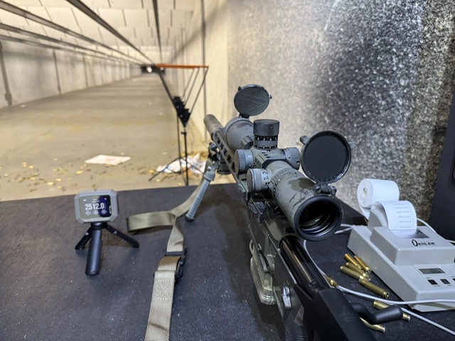

Last week at my indoor range...the Oehler got zilch bc not sufficient light to get any readings... fucker next to me had a 30-06 w a big muzzle flash the printout on the Oehler was from his muzzle flash (all 0000-0000s). 🙄
In one string I fired 7 shots but the Xero only picked up 6. I was not deliberately trying to shoot fast. I fired, had my reticle settle while I ran the bolt and fired again. I remember thinking...shit that was probably too fast for the Garmin.

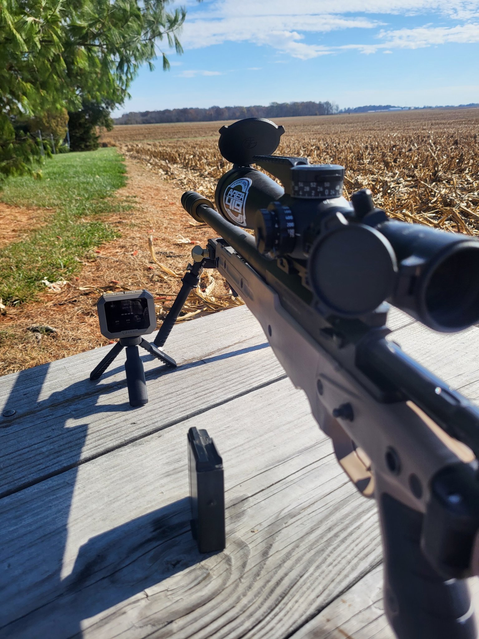

Finally got out to the range today for a ladder test on 6 ARC and try out the new Xero...
Like others here, it did not disappoint!
Never missed a shot, either on supplied tabletop tripod or mounted to the arca rail on my chassis.
Rain squall broke out mid-ladder test and it didn't affect the Garmin in the slightest, pretty heavy rain too!
So impressed!
