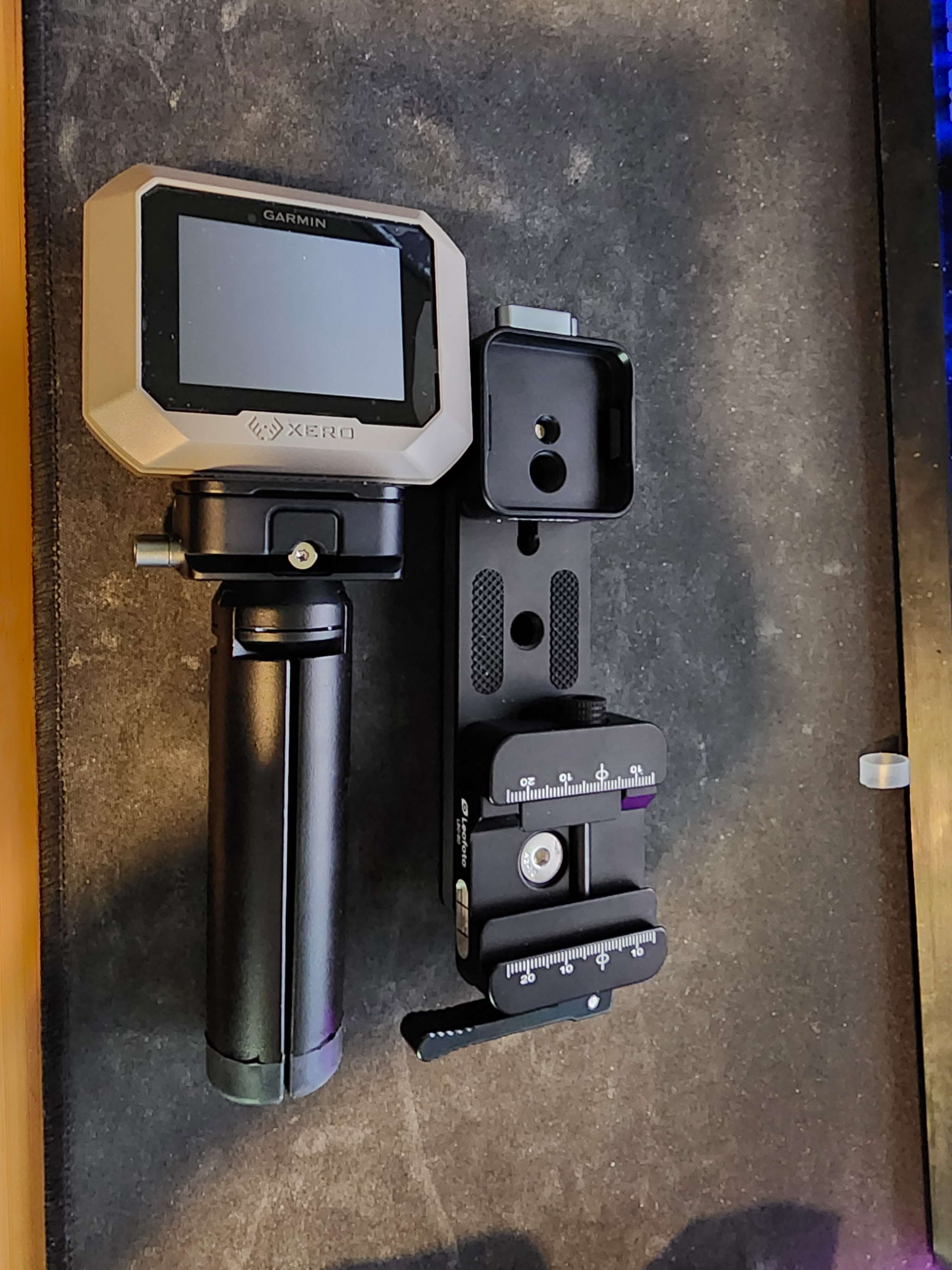

FYI: This go pro case
go pro case will fit with the neweer QD plate.
View attachment 8263141View attachment 8263142
Lol! That’s awesome. I never saw that design of Leofoto clamp with the lever. Which rail did you end up with?
I’m now looking for a hard case with foam I can cut. The Pelican 1060 with 1062 foam will work but will have almost no space between parts. It’d be super tight. Evergreen 56 case on Amazon is slightly bigger but they don’t seem to sell separate foam to cut for this case.

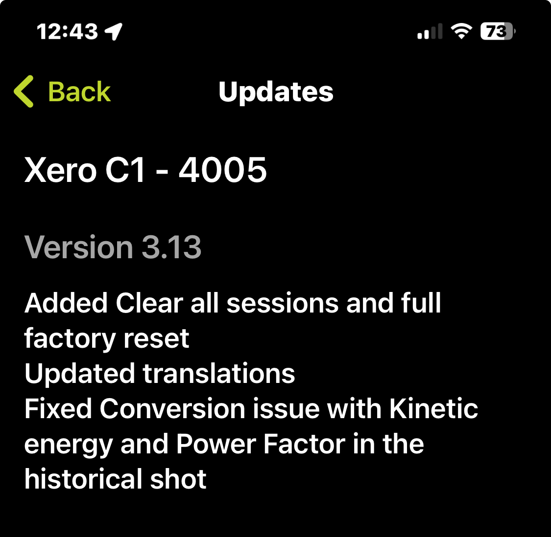

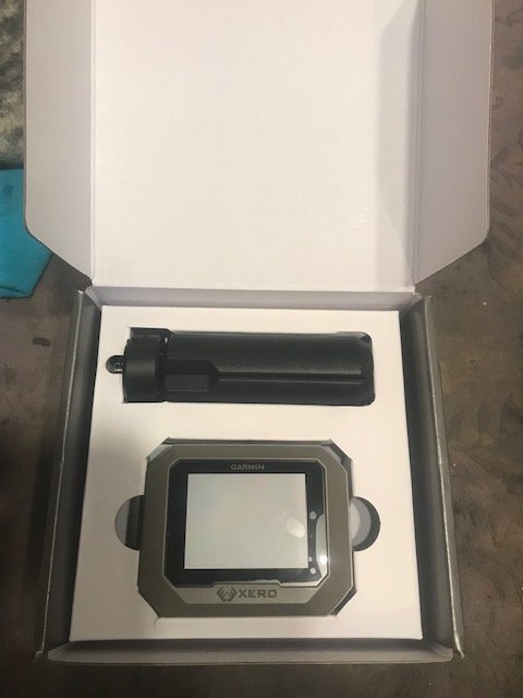

So I got a nice surprise this morning, FedEx delivered my Xero C1 Pro earlier than expected. First thing was to get it charged which didn't take long as the battery was already at 70+%. One of the things I noticed was the display. Others had pointed out that they wished it was brighter. What I noticed was looking at it directly it looked dim and could be brighter. When I looked at it from an angle it was actually easier to read and appeared brighter.
Then it was time to check for updates using Garmin Express. Once it was detected it allowed me to register it. After that it informed me that 11 updates were available when looking at the details. Only one was software related and the rest were language files I had no need for. I only selected the software and after copying the files to the device it advised to disconnect it from the computer and follow the instructions on the screen of the Xero. It only took a few minutes to finish the install.
Only thing left is to download ShotView to a phone/tablet and test it out.
Like others have mentioned, I can't believe how small this thing really it!
Any tricks to get it to update through the ShotView App? I connect and see its at 3.06 and it wants to go to 3.16 but it wont.
If you connect via USB cable to your PC and use the PC Garmin Express app you can send the firmware update immediately.
If you connect via the phone app and Bluetooth it can take about 5 minutes until it prompts you to install the update.
Desmond 140mm. Was what was available on amazon when ordering everything else. I went with a soft case so it fits in my shooting bag better, I just put the xero itself in a semi-rigid gopro case to protect it from rubbing on the other parts.
This one : go pro case fits with the qd plate attached.

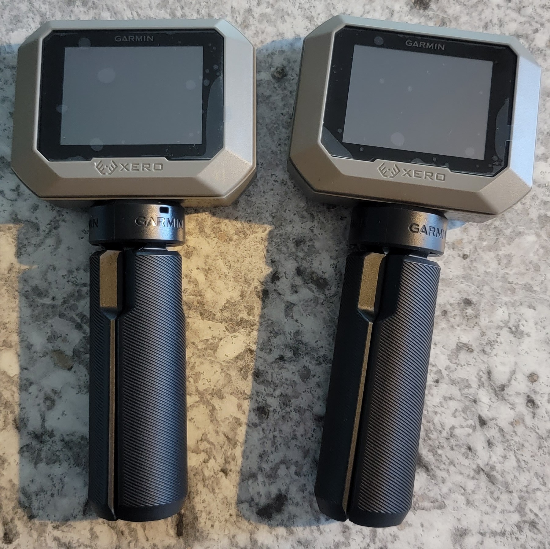

So what was it someone wanted to compare with two of these units side by side?...
Something about different locations?
It seems i have the opportunity this weekend if it's still a question
Ya sure.
3ft away, parallel with the muzzle vs as close to the muzzle as possible.
As far back from the muzzle as possible - say 3 feet behind the muzzle, even behind the shooter, vs 7 inches in 2axis from the muzzle.
Those would be a start. If they turn out to be exactly the same shot by shot, regardless of placement, I think it'll be tremendous confidence we'll get the same numbers no matter what as long as it picks up the shot.
Ya sure.
Ok I'll see what I can manage.
I'm not a video guy but I'll see if I can manage something
Start with both side by side first to make sure they get similar numbers then I'll go through as many options as I can think of

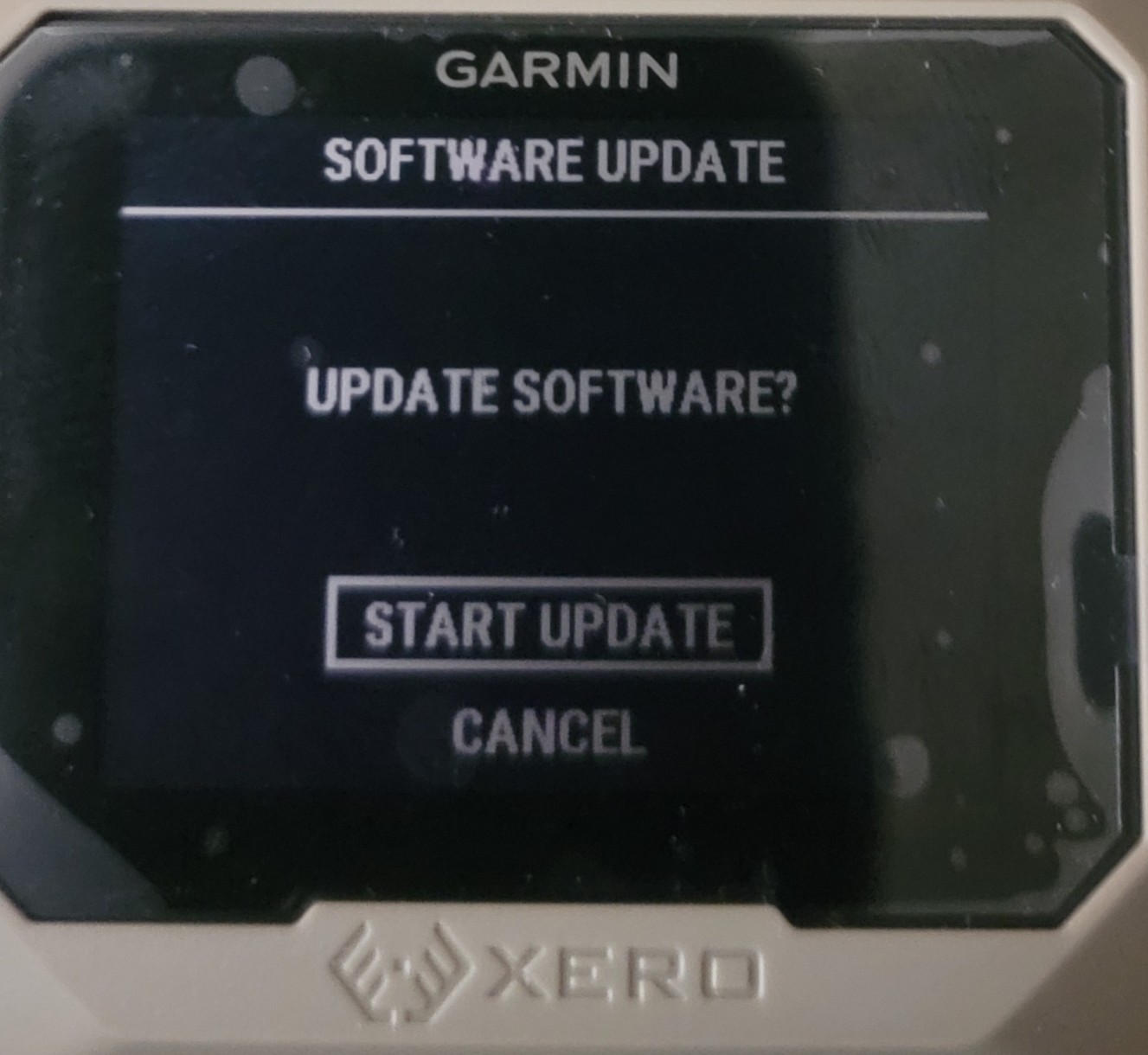

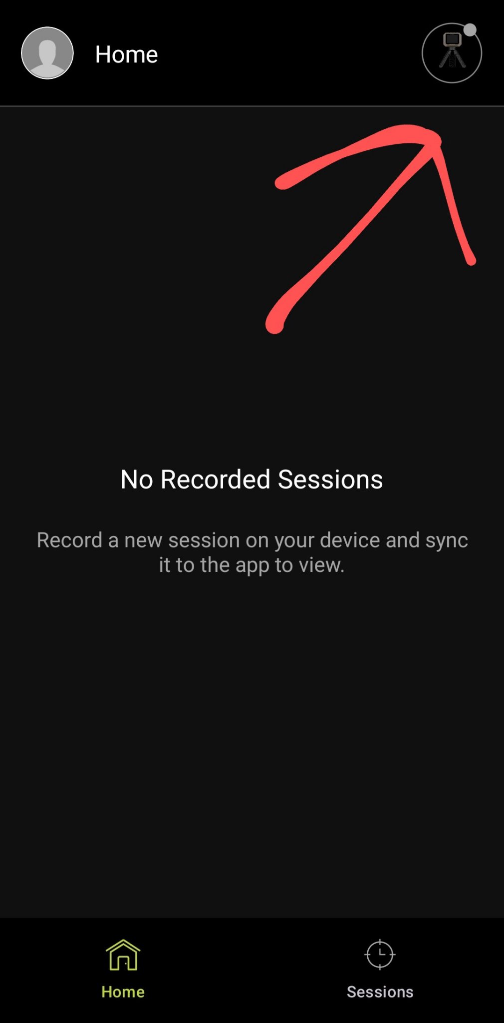

For those trying to update via app / phone...
Maybe this is written somewhere but I don't recall seeing it
I noticed there is an indicator on the home screen
If you watch that while hooking up to a unit that is eligible for an update you'll notice the wheel start loading.
After that wheel finished up I got this on the unit

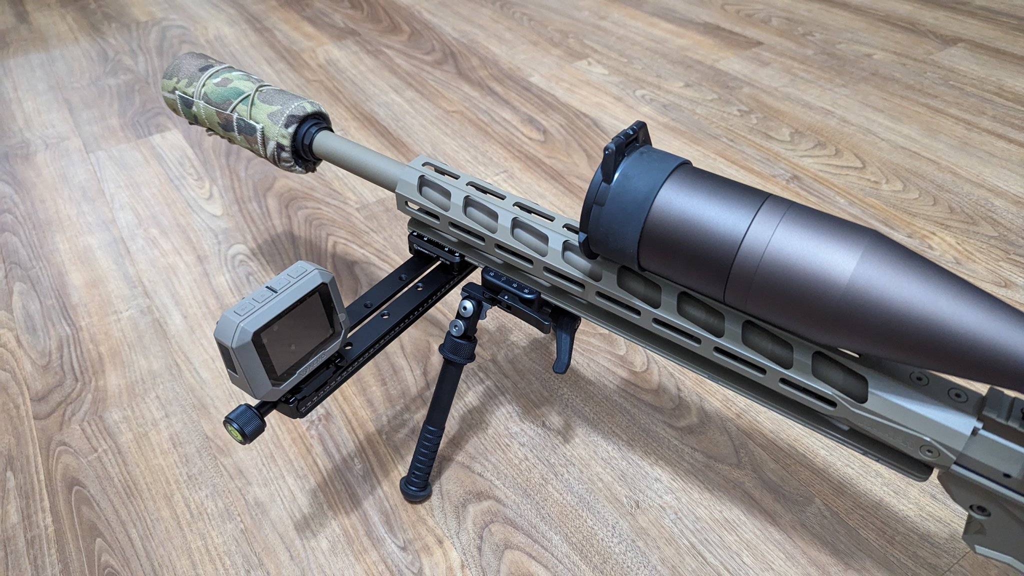

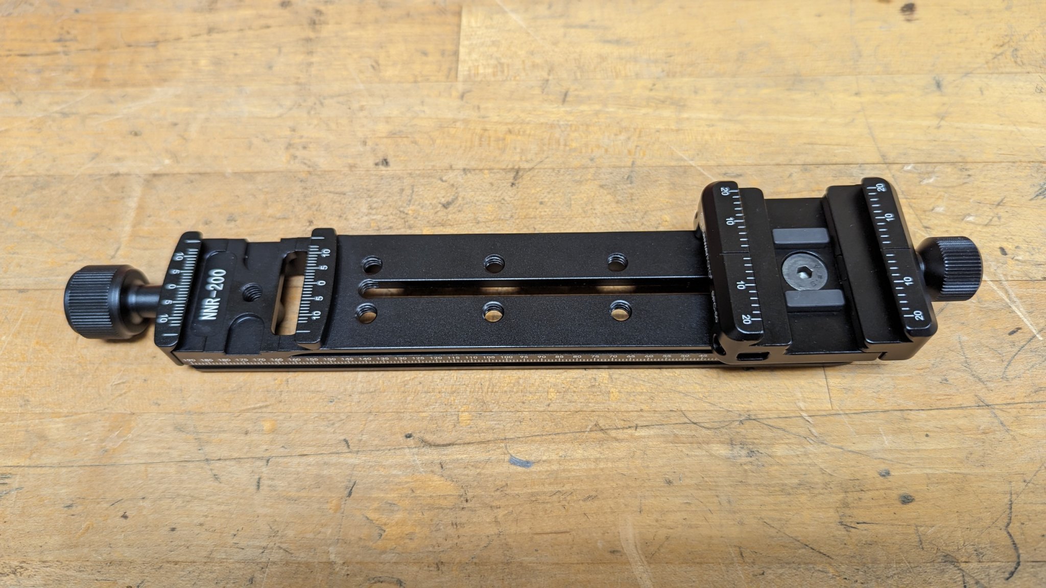

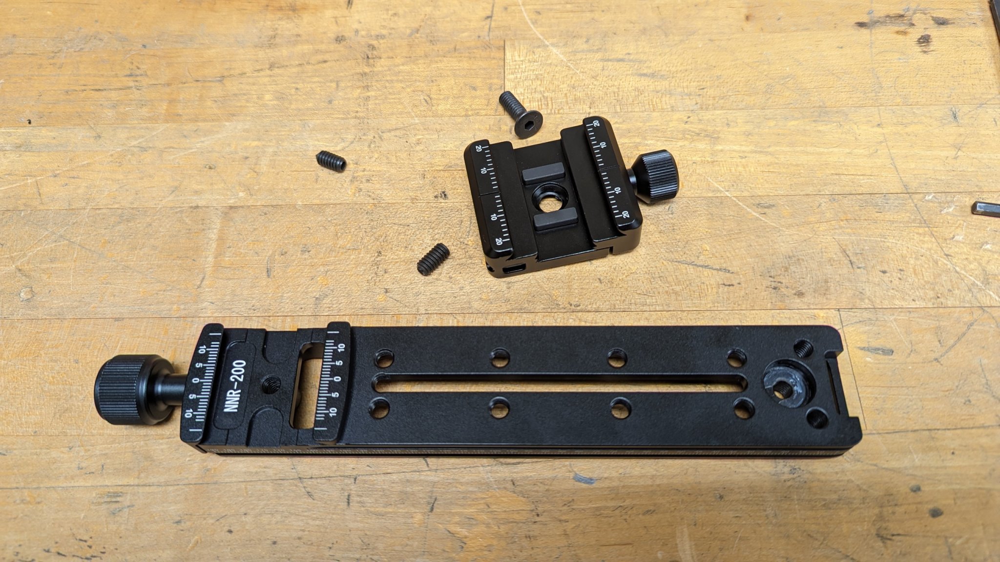

Finally found the perfect solution for me.
Pic, Arca super quick and easy.
I did something similar, but just used a 200mm nodal slide (I wanted mine to be >5" from barrel, so I chose the 200mm), popped the bubble level off, and mounted a similar Sunwayfoto SPC-50 (clamps to both arca and picatinny for $35). I did have to get a 1/4-20 FHCS as the Sunwayfoto came with a M6x1.00mm flat head screw . I found a 1" long one and cut it to length. A 3/4" long one would have worked if I could have found one. Added some 1/4-20 set screws I found in my stash to help with anti-rotation. I spent $55 plus tax. I had the QR plate, but they are ~$12, so ~$70 all in.
It gives me arca and picatinny mount to different guns and the arca QR plate on the Garmin can swap to my tripod. Puts it at ~6.25 from the barrel center to center. Definitely happy with it and works for what I want.
Worked for mine as well, thanks for posting this.

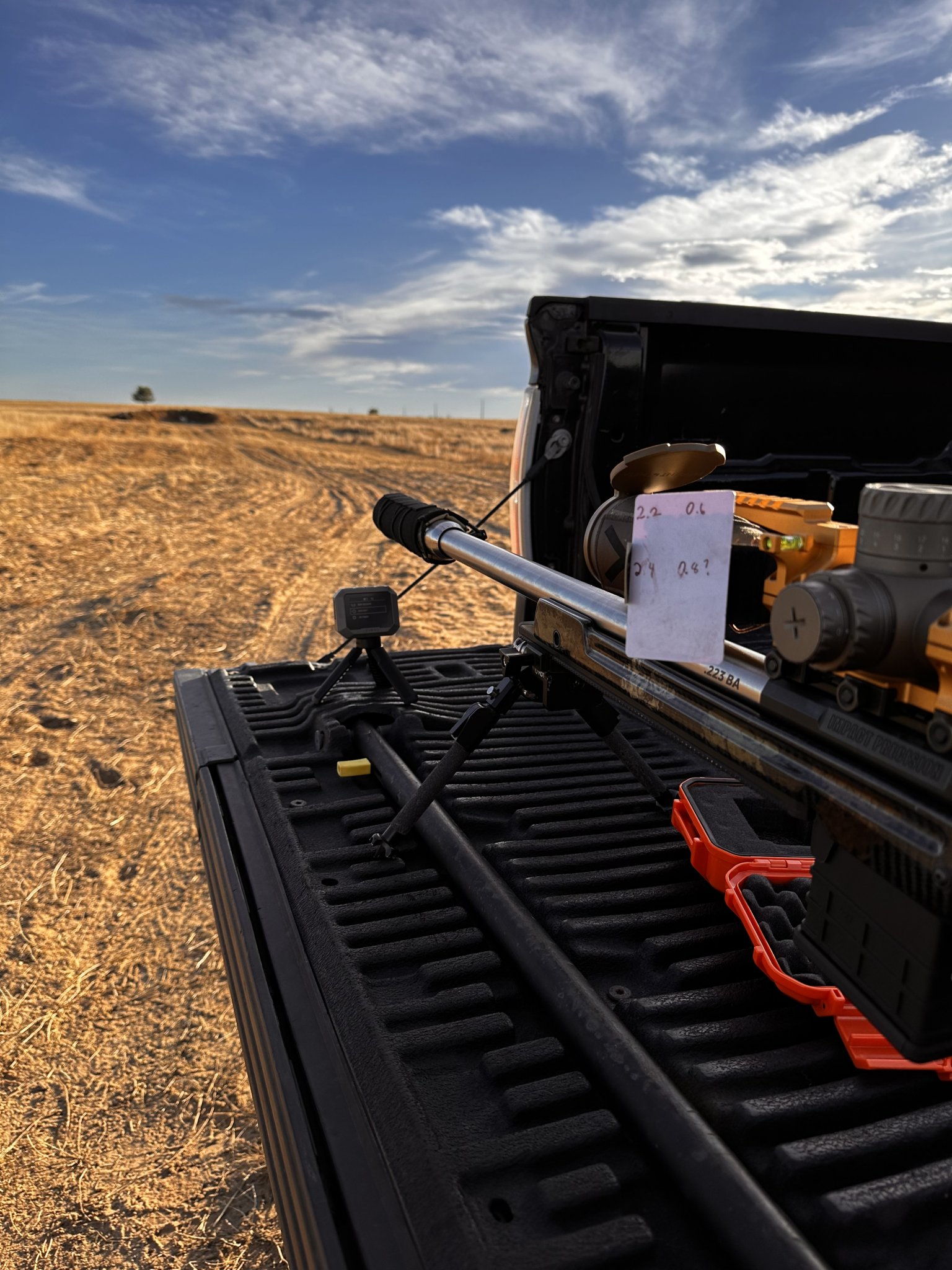

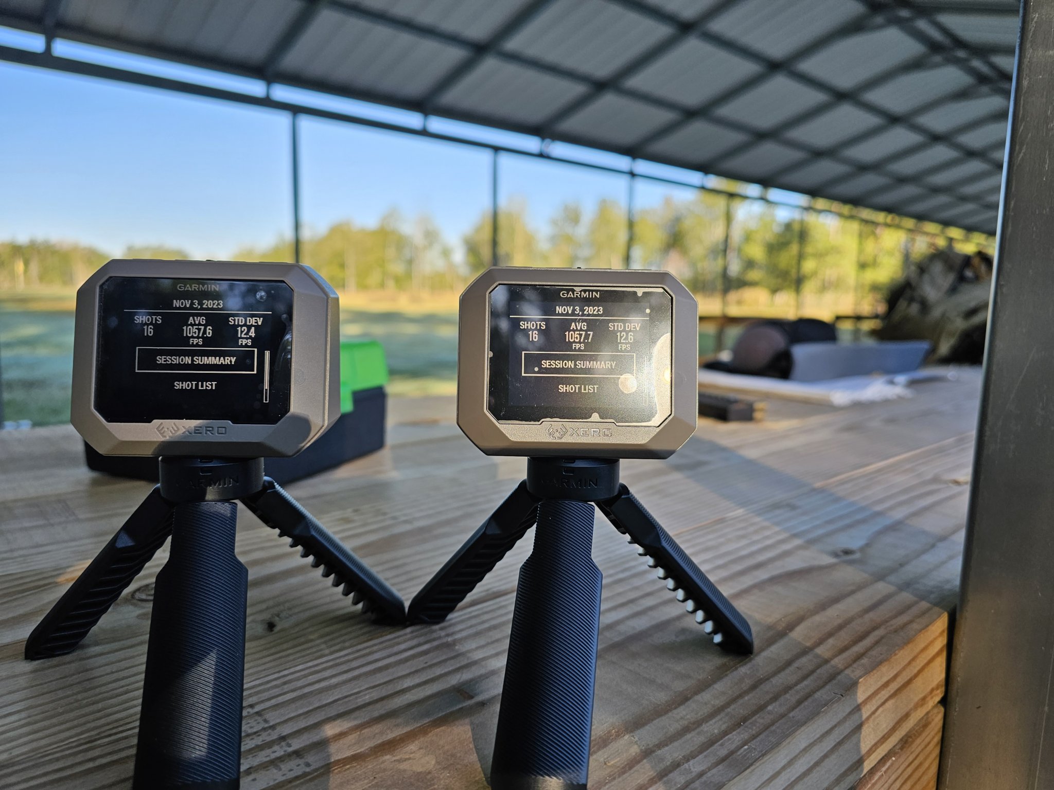

I put one of these on each side of my Vudoo while checking a new lot of ammo.
Not particularly impressed with the ammo. However, pretty impressed with the two Garmins. Most shots measured within .2 or .3 fps of each other, with the worst being 1.7fps
I also set one at 100yds and passed some shots next to it to see velocity decay. The G1 BC that I came up with to match this was spot on with a number that my buddy has used to hit with his Rim-X out to 750. I know this would be better to do a little farther out, but I was just looking to try it out real quick and see how it worked. Didn't have an immediate need to test farther as the Applied Ballistics CDM I'm currently using seems to be on.
I also set one at 100yds and passed some shots next to it to see velocity decay. The G1 BC that I came up with to match this was spot on with a number that my buddy has used to hit with his Rim-X out to 750. I know this would be better to do a little farther out, but I was just looking to try it out real quick and see how it worked. Didn't have an immediate need to test farther at the Applied Ballistics CDM I'm currently using seems to be on.

I just set it on top of a 5 gallon bucket, dialed my 100yd elevation, and held 3 mils to the side of the unit.
Hhaha, this guy fucks.
No plate or nothing. Love it.
