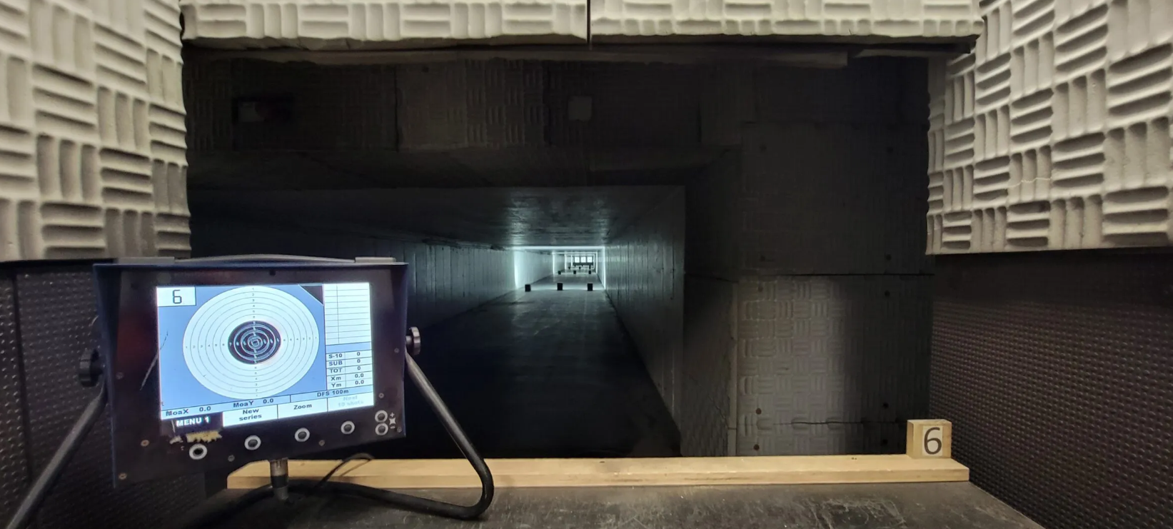

I saw a few references in this thread about use at indoor ranges, mostly short pistol ranges. What is the likelihood it would work well at a 100 yard indoor rifle range where the walls, ceiling, and floor are concrete, and you may have another shooter within 5 or 6 feet on each side of you?
Should work just fine, at matches with people on both sides of me. It only reads my shots.

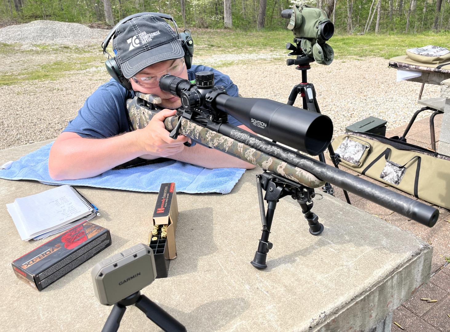

Put my review of the Garmin Chrono up today after a year of use. It's been a lifesaver I never would have gotten some of the data I ended up needing on the 350L without it and I am certain I would not have gone down some of the investigative paths that have been fruitful without that data. It is really nice having a chrono that is easy and reliable even if I don't love some of their design decisions.

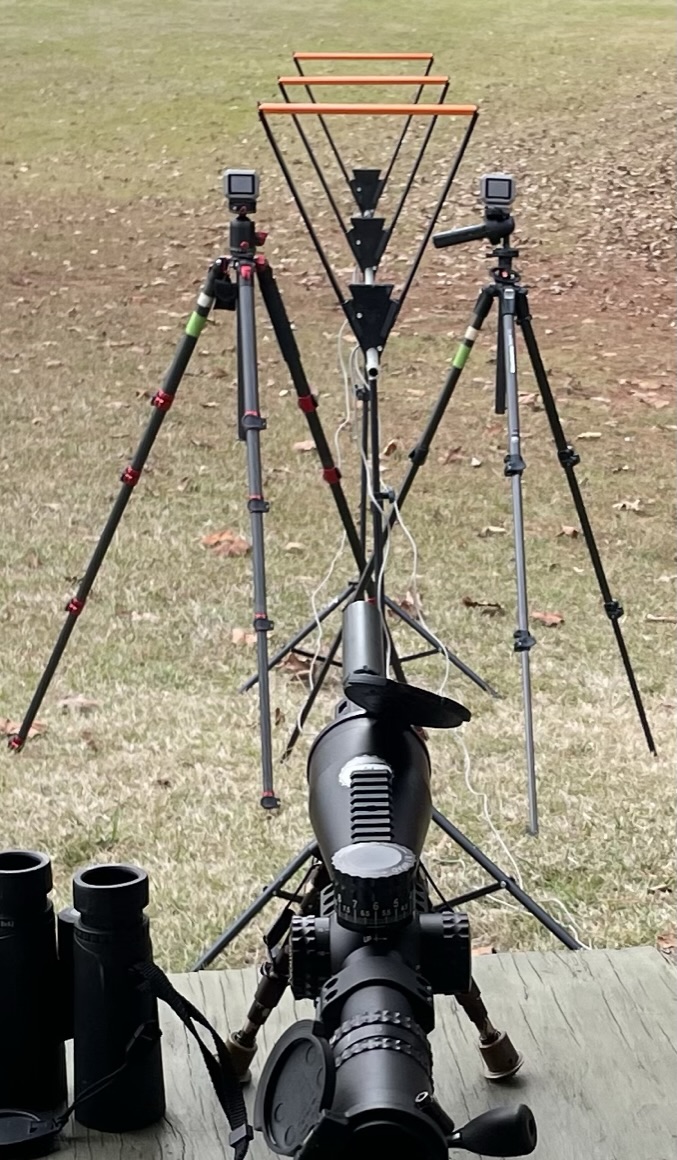

Best I can tell, the Garmins do as good a job of measuring muzzle velocity as most anything. I believe they interpolate a MV from measuring in front of the muzzle because they can't measure right at the muzzle.
To investigate, I ran a 20 round test on an Oehler 35P with a 9' spacing. That gives velocity at the middle screen. I sandwiched the middle screen with a couple of Garmins.
I put the setup and data below.
I don't trust any chronograph for better than about .1% - 3 fps on a 3,000 fps shot. I think even that is optimistic. That is my one gripe with the Garmin, it reports to the 1/10 of a fps. I don't think it is that accurate so why not have the option to round to the nearest whole fps?
So, one could argue the point is "if the Garmin measures at it's location and they tell you to place it 5" - 15" behind the muzzle, how much velocity would be lost in that distance from the muzzle?
Personally, I don't think it matters.
I could not agree more.
Awesome testing. Well done!
Would like to have seen this same test but with one Garmins back at the specified location by the rifle, to see what the differential is.
Reactions: R_A_W
Nice test!
What was the distance the Oehler Cronograph was from the muzzle?
It is dificult to say from the picture, but it seems like around 6 feet (2 meters)?
