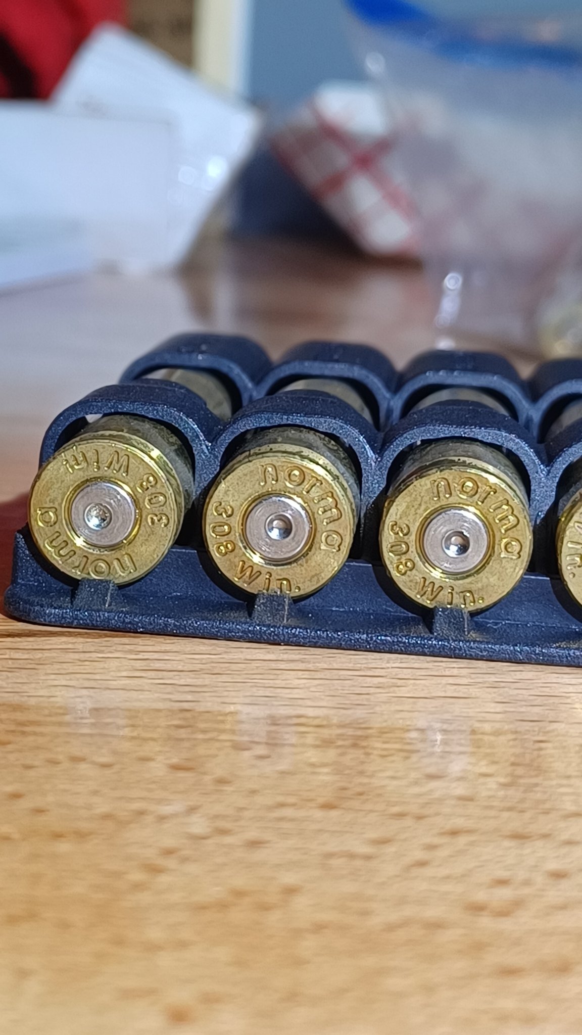

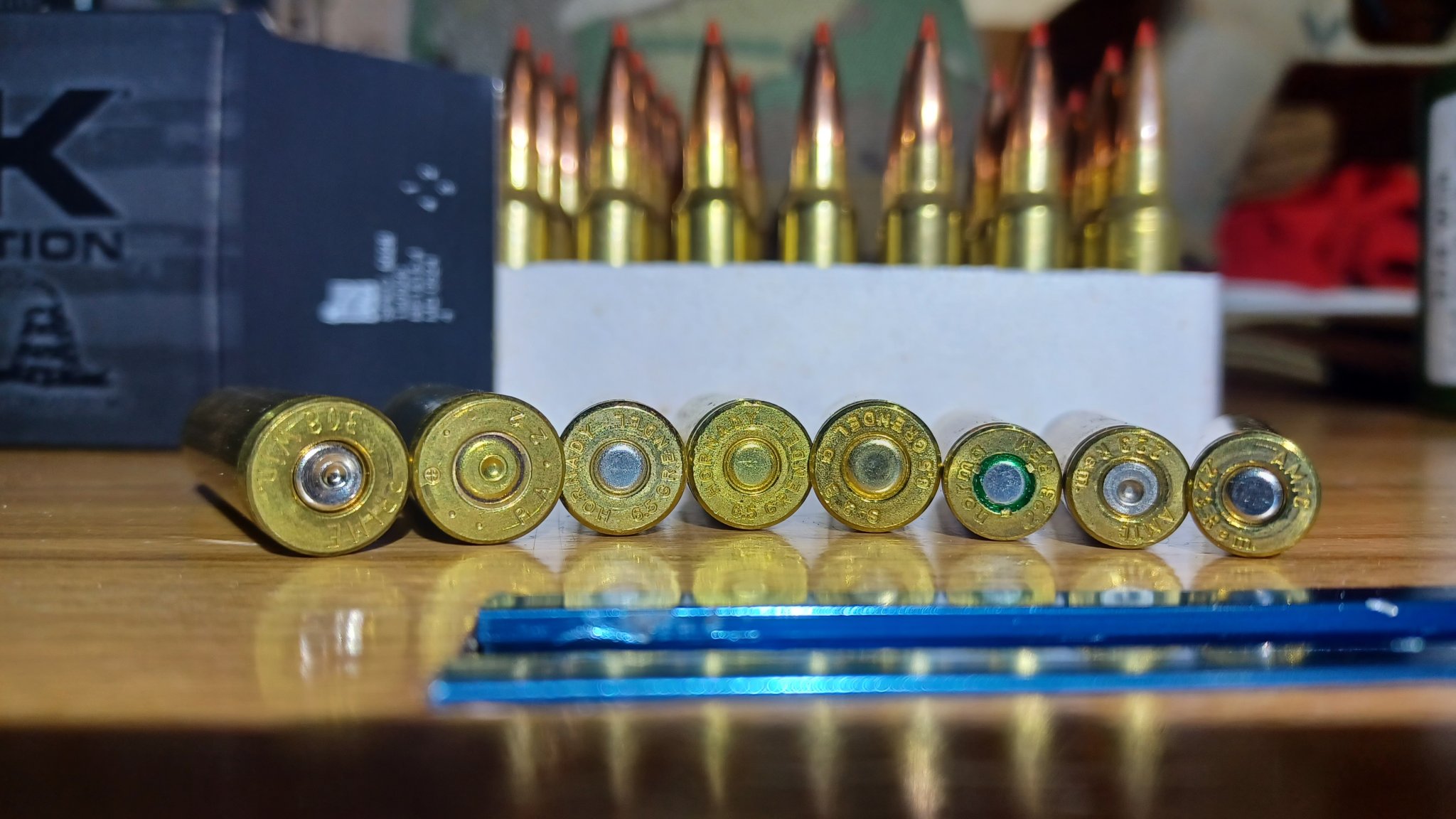

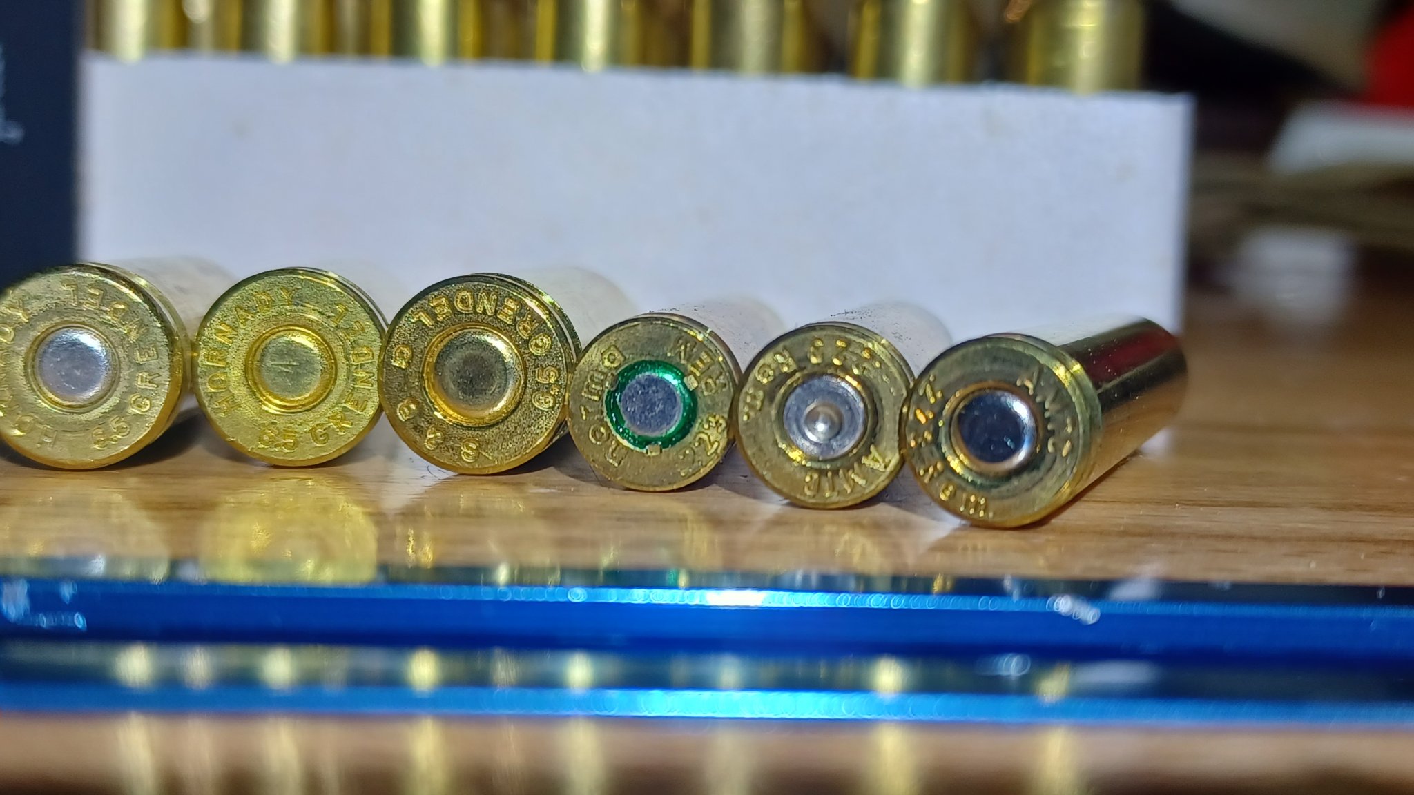

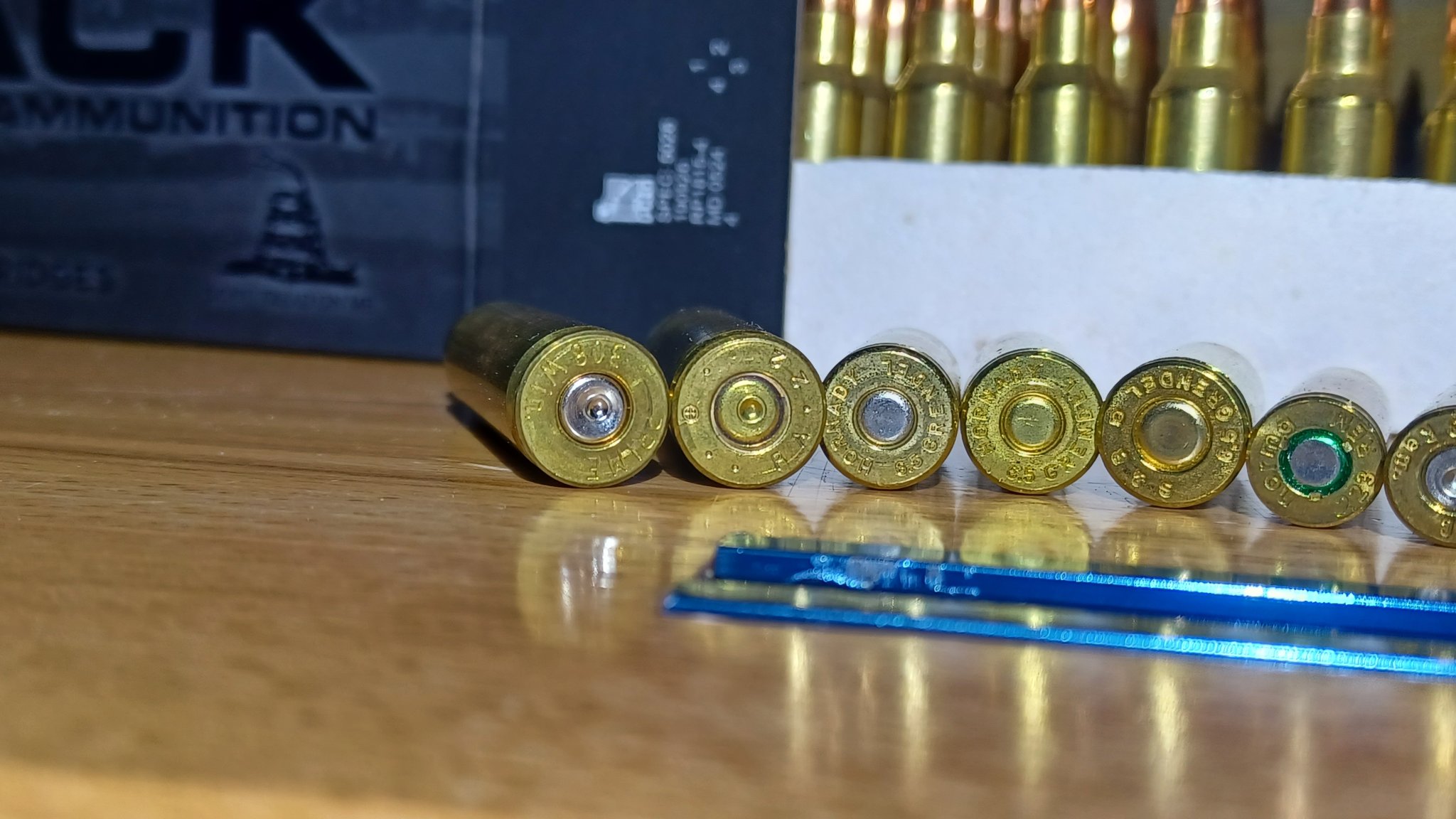

    Firstly, below are some brass cases I have. Which of these have crimped primers? I've searched online and looked at pictures. I think I know which are crimped but again, prefer 2nd opinion.
    We're going to call these brass pieces A - H from left to right so there's no confusion.
    First pic is A B C D E F G H.
    Second pic is A B C D E F & half of G
    Third pic is C D E F G H

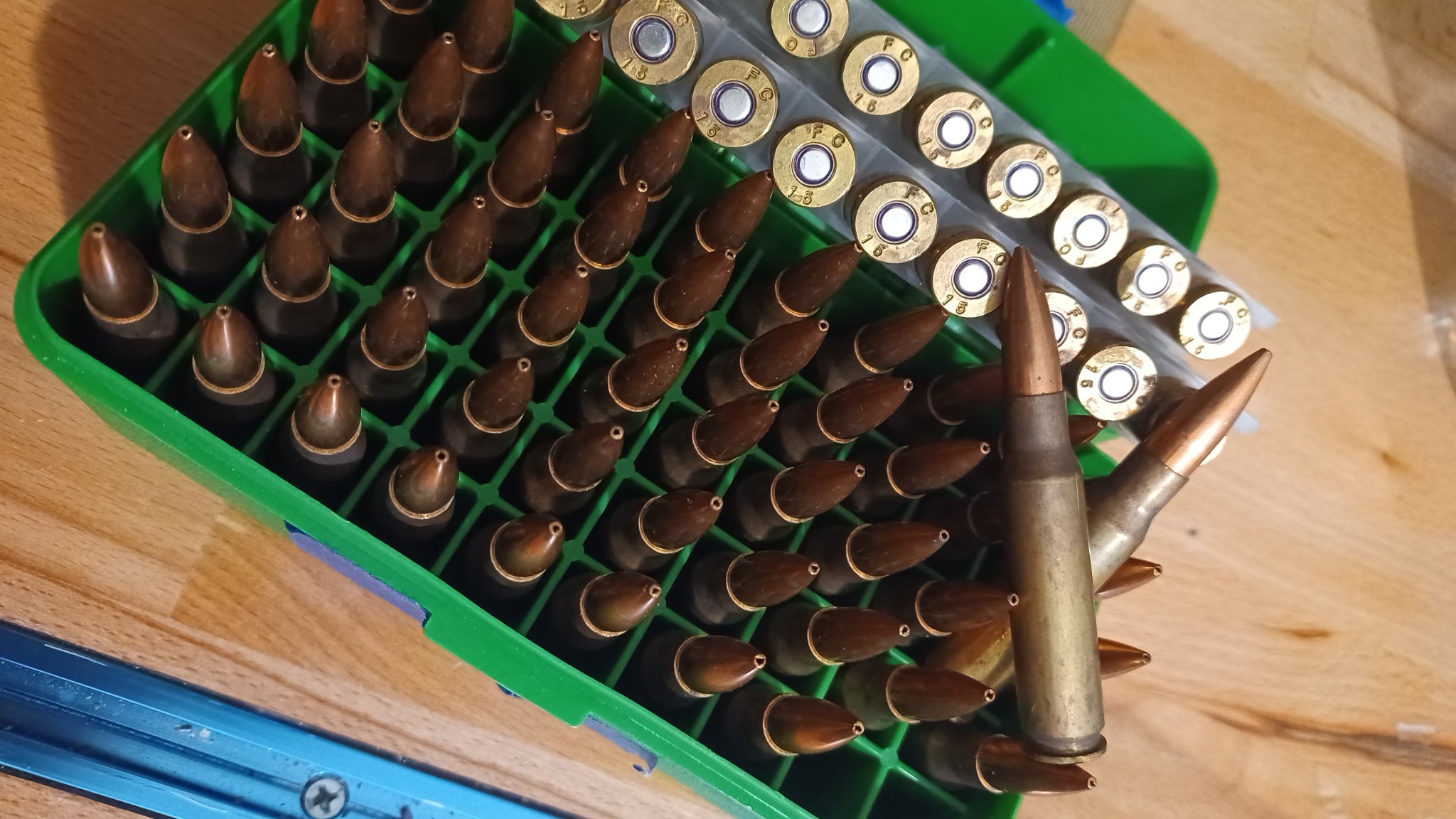

    Should have thrown these in there too.with the crimped primers question. This is fgmm 7.62
    And this...

    B and F for sure possibly D

    B is a full crimp, and F is a stab crimp.
    BTW, if you decap carefully, you should be able to tell the difference.

    Only military calibers will be crimped. So 223/556 NATO and 308/7.62x51. Oh, 50BMG.

    The two that are crimped are 308Win and 5.56.
    Grendel isn't crimped.
