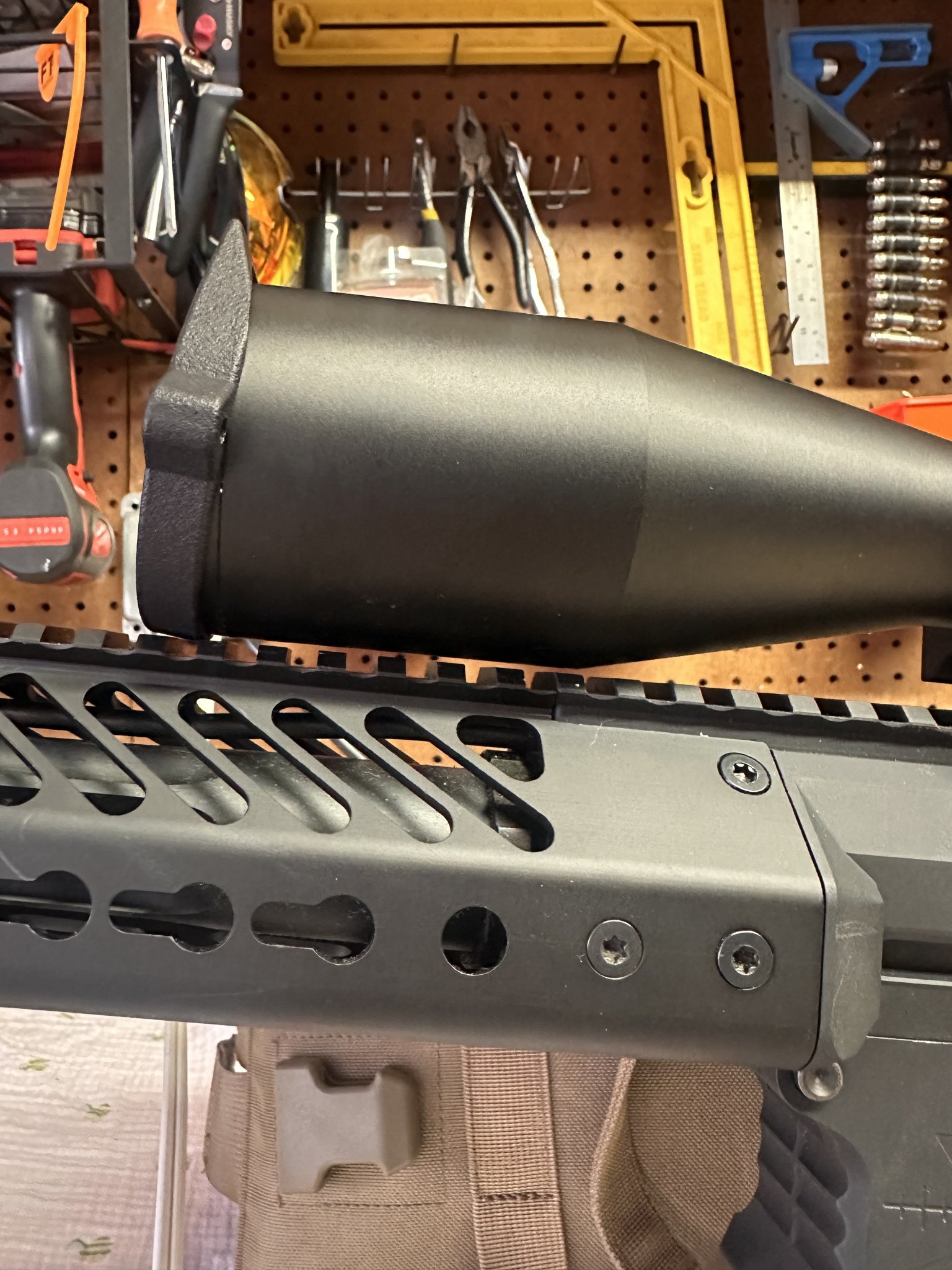

    I sort of inherited this American Rifle Company scope mount, and everything on paper says it should be ok, thing is rock solid, but the scope(Steiner m7xi) is absolutely breathing down the neck of the front handguard.
    I'm wasting my time trying to make this work right?
    I've tried 2 different scope caps and it just ain't happening.
    I'm not really wanting to mill my handguard for this should I just pick up a badger C1 that's a little taller and sell it?

    I guess the real question is how's the cheek weld? If your face is smashed down, then new mount looks like the way...

    There's almost nothing negative that comes with getting high rings. The only reason to keep optic as low as possible is if you somehow can't get a good cheek/jaw weld or for aesthetics.
    All the other reasons of the past have been debunked.
    So, just get a higher optic mount and reap the benefits along with being able to use the scope caps you want.
    Steiner actually doesn't include the centerline measurement on this scope so I'm waiting for tech support to hit me with that.
    Gonna just sell this scope mount and sort out which C1 will do the trick. Guessing the 1.7 most likely.
    Thanks for the advice guys, the cheek weld seems fine but I realize I've probably been cranking down more than I need to be I'll make my life easier and do it right.

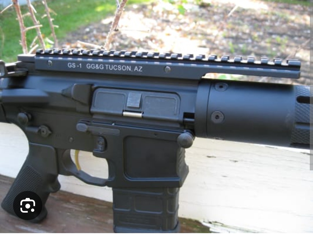

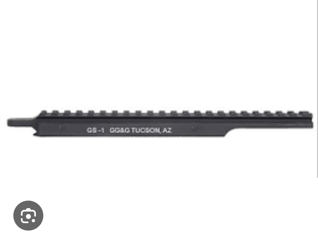

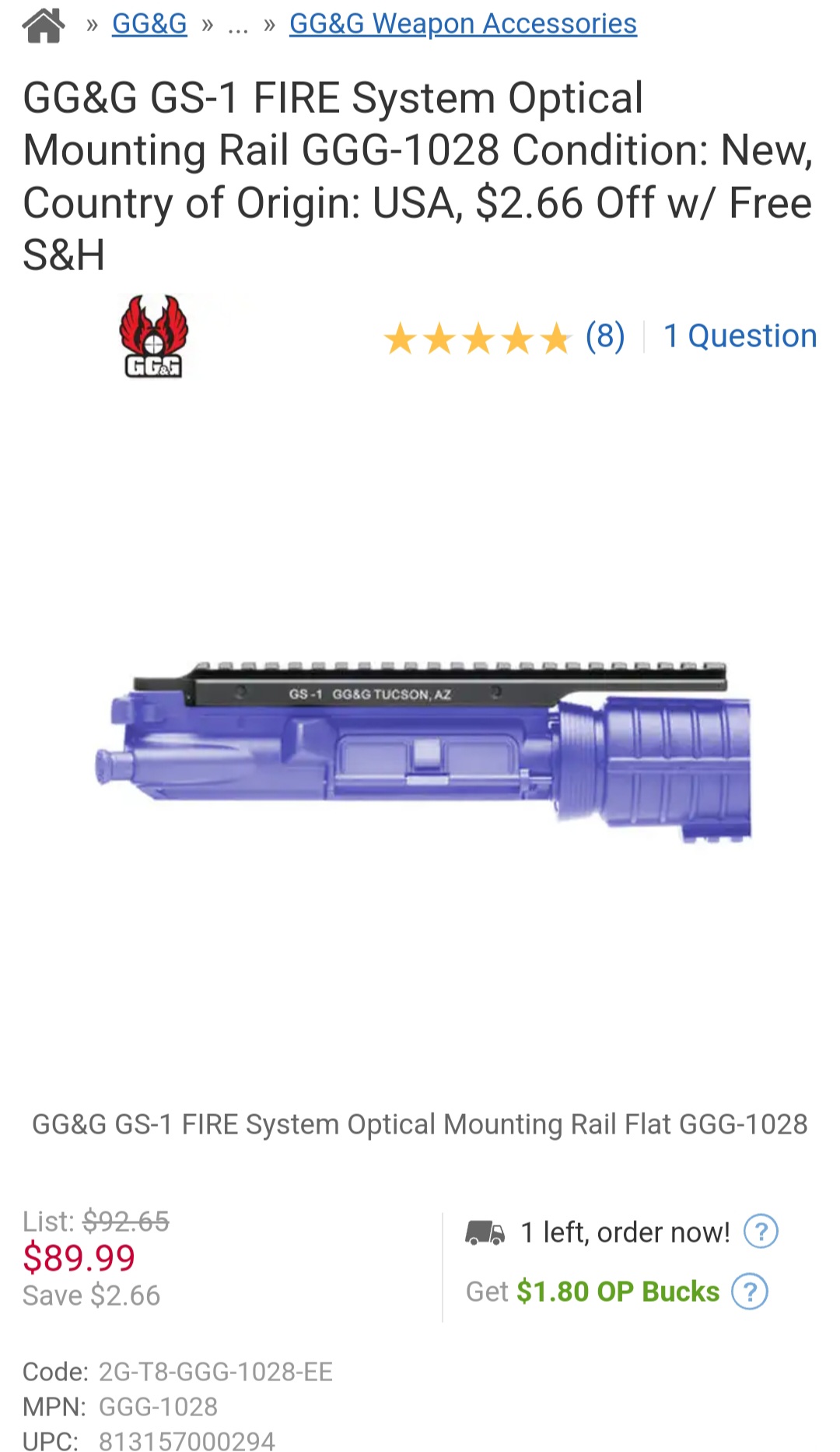

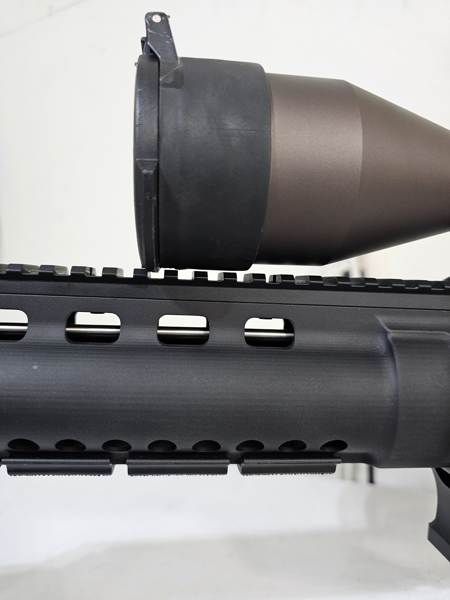

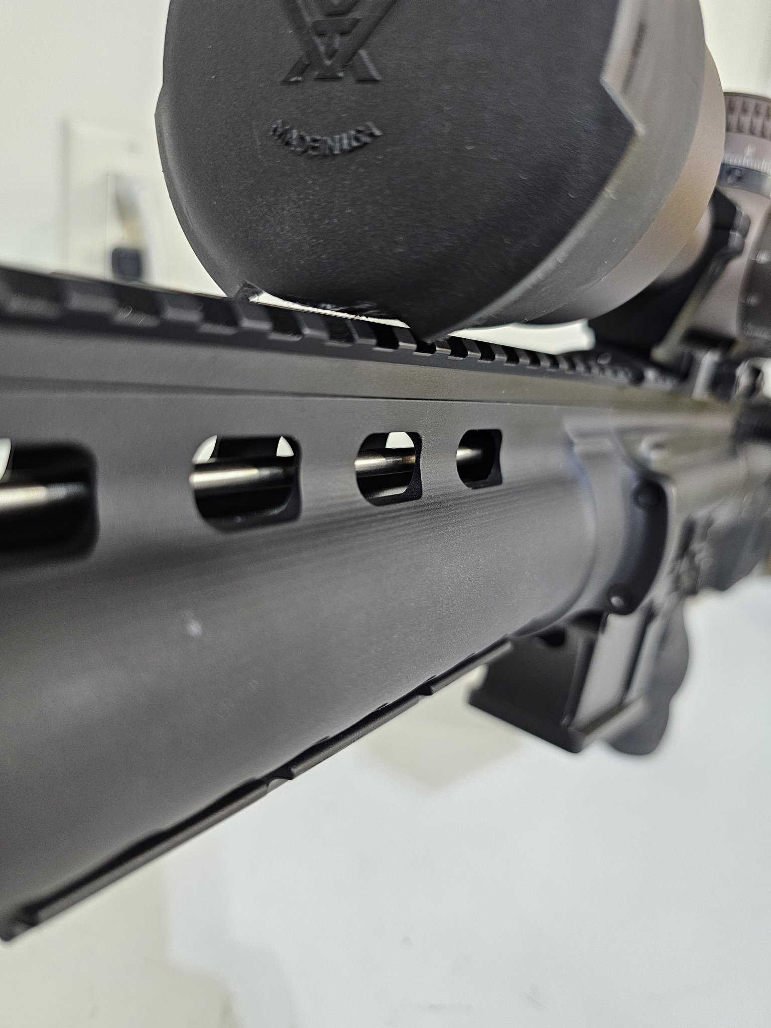

    You got a few options you can go with that are cheaper.
    (1) $35 Vortex Defender caps, they have a cut out on the bottom that will allow you to use ultra low mounts, I've got a couple that I can post pics of in a few.
    (2) $90 GG&G rail riser.

    These really qualify as solid solutions. I think I'm going to take the advices of the folks above and get myself another 9/16s of clearance and just pick up a 1.7 Centerline mount. I imagine a slightly higher centerline will be a little more comfortable to shoot with anyways and I've probably just gotten so used to all my optics hugging the barrel I've never thought about it much. My LPVO is also riding at a 1.7 centerline right now so I think there's probably something to be said of the NPA between the two rifles I shoot the most having the same exact sort of positioning.
