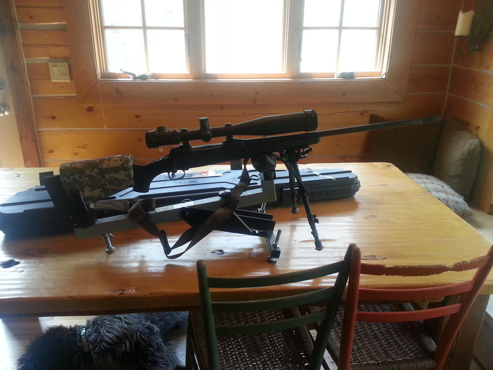

A few notes to close this out and to help people who reference this thread:
Intention:
To become effective enough to shoot consistent groups at 500 yards for hunting. No matches, etc. for me, just total confidence in the field. I had to start by stacking rounds at 100 yards and that's what I've achieved so far.
Rifle: Stock Savage 300 Win Mag Long Range Hunter.
Optics: Vortex 6-24X50 FFP Viper PST
Accessories:
1. Harris Bipod with "swivel" allowing rifle to stay level off camber. Note about this: I started with a different brand and had very, very frustrating results. My friend insisted that I get a real Harris and though I didn't want to pony up, questioning how much difference it could make, it was seriously NIGHT AND DAY in immediate results. Ultimately, this was half the equation.
2. Per the thread about Sling Shooting and at the urging of some veteran posters here, I got a shooting sling. Specifically, I opted for the TAB Gear sling. These are very well built and seemed to be the missing piece in really making me consistent.
3. Homemade cheek piece via pipe insulation and digi-cam duct tape. No matter what you use to get there, creating a custom-fit cheek weld helped my body positioning become more consistent.
Ammo:
After trying 10 other combos-everything from Nosler to Mil-Spec rounds, my rifle ended up shooting best with Remington Swift A-Frames in 200 Grain. The biggest gap was closed when I started shooting 200 grain or more--this rifle simply doesn't like smaller grain loads.
Most helpful practice and shooting techniques:
1. Repetition! This is obvious but when starting out and especially using a big caliber rifle, you have to train your brain to ignore it's reflexive reaction as well as make the proper technique automatic.
2. Quarters and dry firing. Using snap caps, I spent a lot of time placing quarters on the barrel and dry firing. This really helped.
3. Trigger work. Using the technique above, I concentrated on making my trigger pulls straight and "soft."
4. Breathing. This was most obvious and easiest for me.
5. Focusing on the cross hairs, not the target. As pointed out to me in a post above, I hadn't heard of this. The minute I started including this in my checklist, I noticed serious improvement.
6. Shooting smaller calibers. I built my .22 up to help me practice, and this made a huge difference in training my brain to ignore recoil. I even found that shooting my 30-30 helped as an intermediary and was especially helpful learning to shoot with a shooting sling. Bonus is that I'm infinitely more accurate with that rifle now.
7. Perhaps most important was learning to totally relax. My Recon buddy told me to get to the point where you could literally fall asleep on the cheek rest, your body is so relaxed. This was tough, took a LOT time and counter intuitive to the brain but once you get there, it's a huge help. Then you're just pulling the trigger very slowly and lightly with your relaxed body position doing all the work. The result is like the gun is doing the work because you're totally at rest. The biggest help to achieving this was the .22.
That's about it. I'm not claiming to be an expert nor even "good" marksman by any stretch but I do feel like I finally have the super solid foundation to start stretching my shots out and working with windage, etc. Big thanks to all you guys who helped me out!!!
