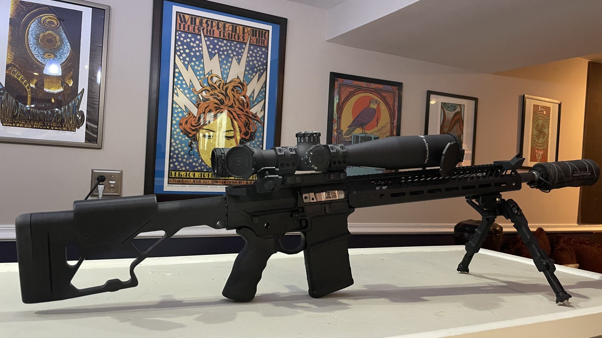

Seekins SP10 .308 w 18” Proof CF.
Weighs approx 14# as is w/ 20 rds fyi.
You could certainly find a lighter optic and bipod too. You could ditch the can as well.
