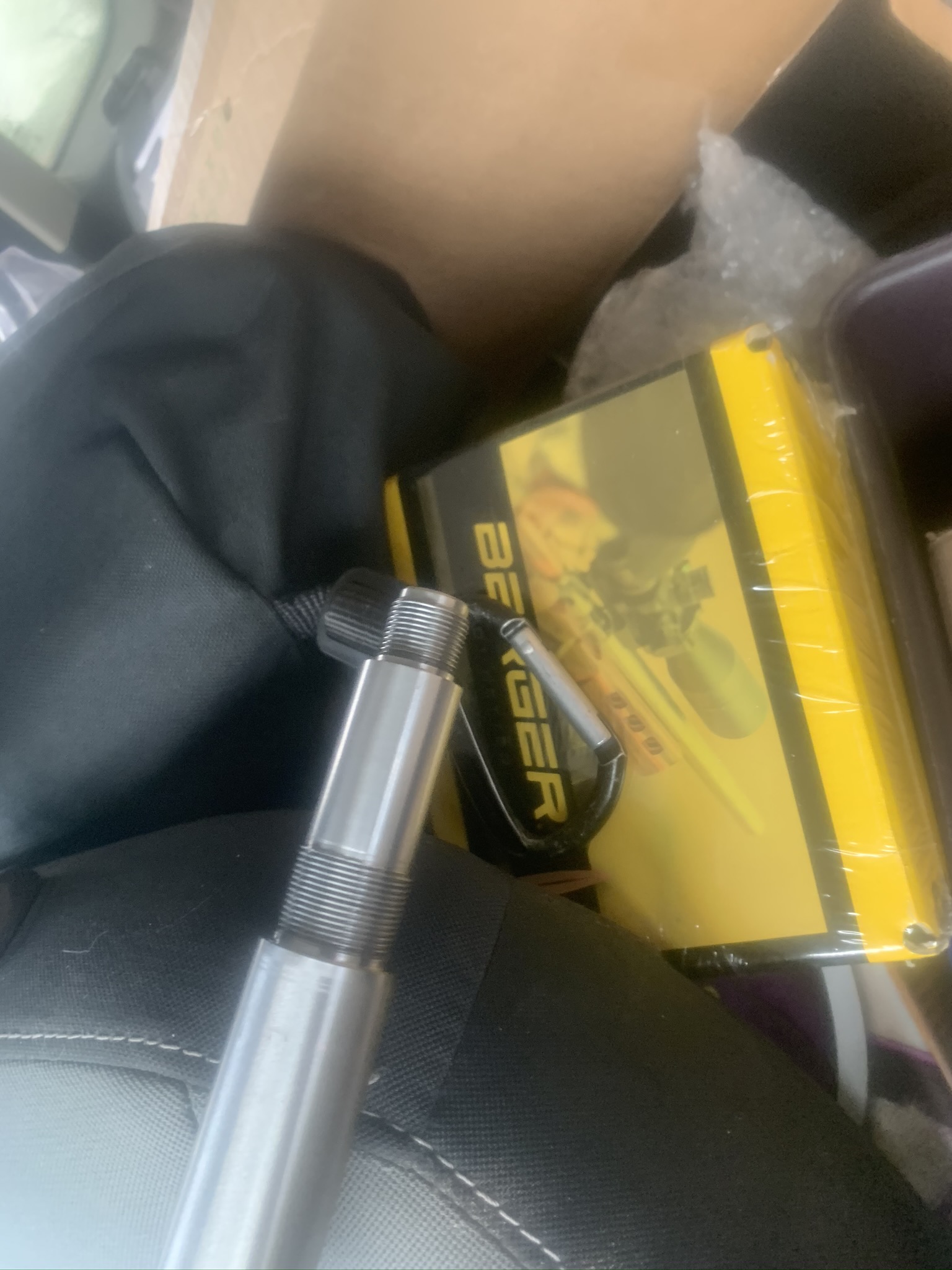

I got one from Erik and I’ll also get one from Hipp to try once they’re available. I like the idea of not having to modify a barrel specifically for a tuner, but I’d be lying if I think they will be equally as effective.
I will say the one from Eric looks like a pretty effective design. I would also think it would be more effective then other designs.
It's interesting to see this gear/technique creep into PRS/NRL. I can't say the results I have without a tuner makes me feel like I'm missing out on anything.
It's an interesting design... but a couple threads and a few set screws seems like a pale comparison for the length of threads and the alignment pad of the EC tuner. The TPI looks a little coarse, too. The proof is in the pudding, though, so we'll see how it compares once a few more of them get out in the wild. I do like the idea of being able to use it with an existing threaded muzzle without an additional machining step, though.
