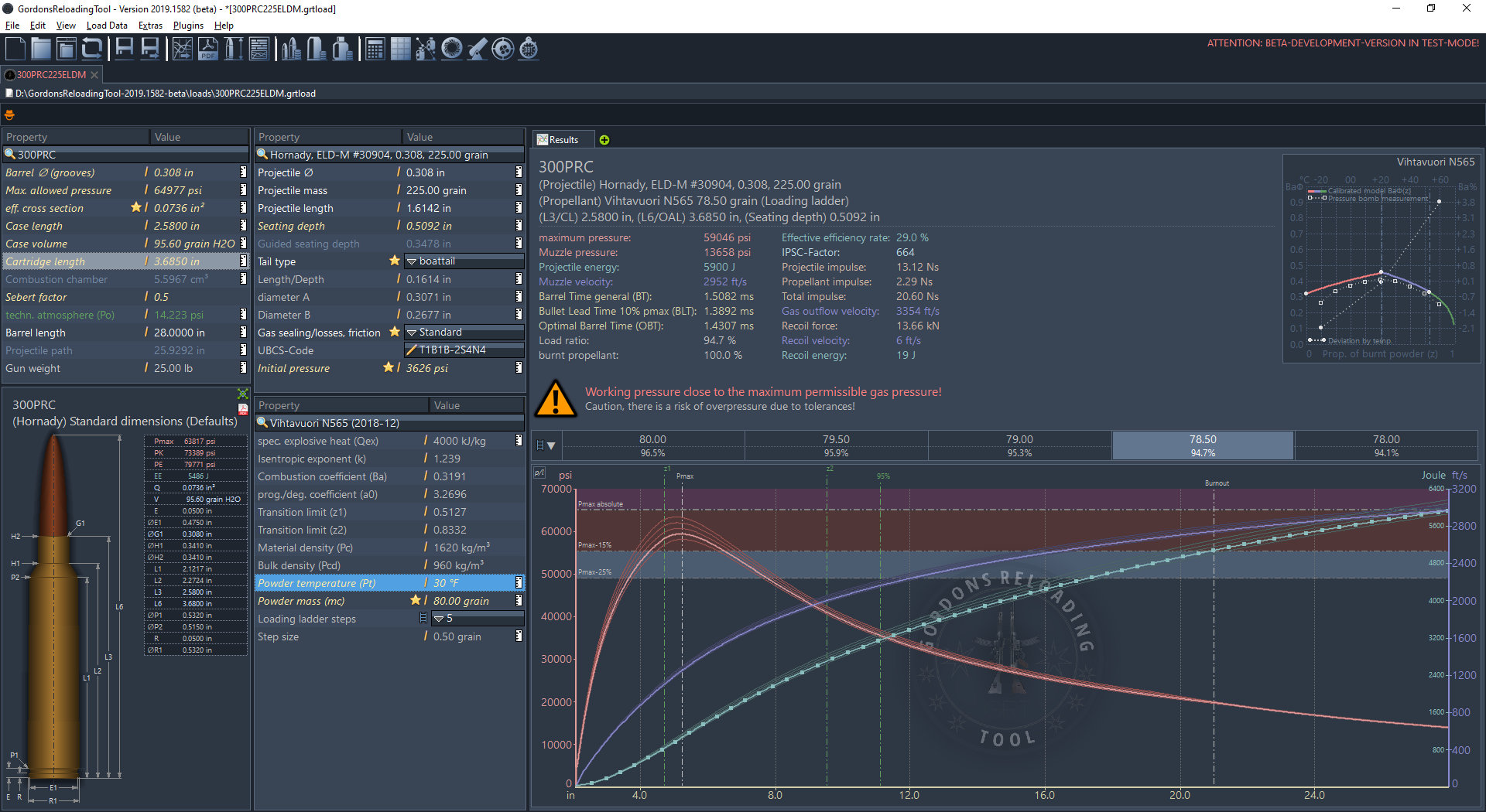

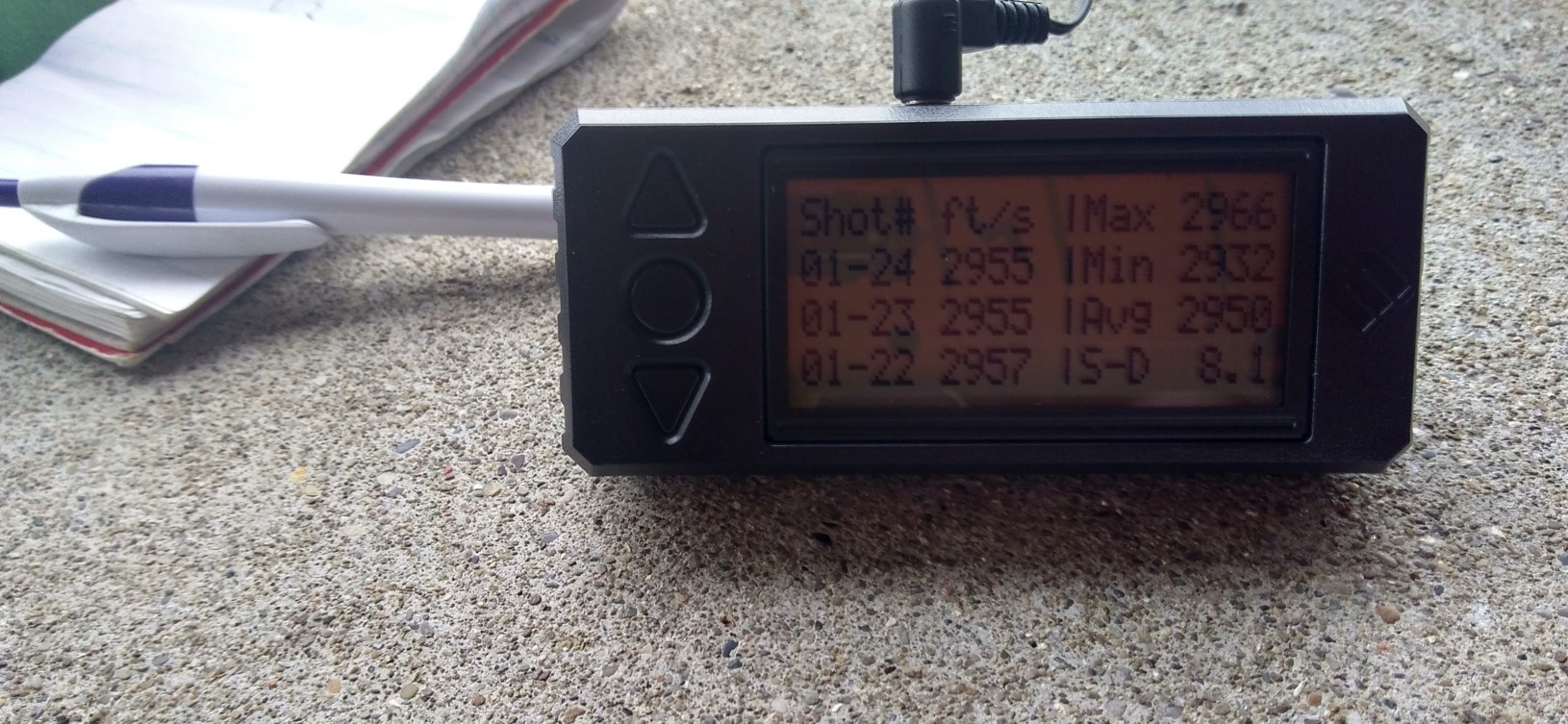

I've been messing more with this tool and I did a little guessing on some input variables as I couldn't find them for the Hornady 300 PRC Cartridge....so I had to make my own. Here's what I'm looking at:
Matched against this real world data a few weeks ago:
What do you guys think?
