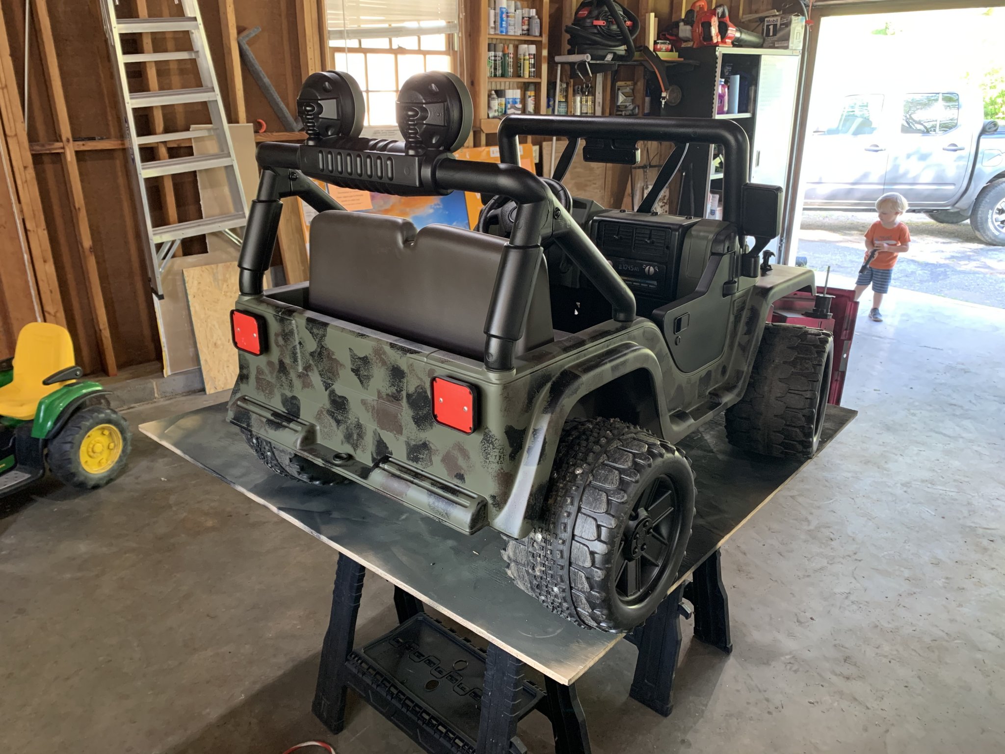

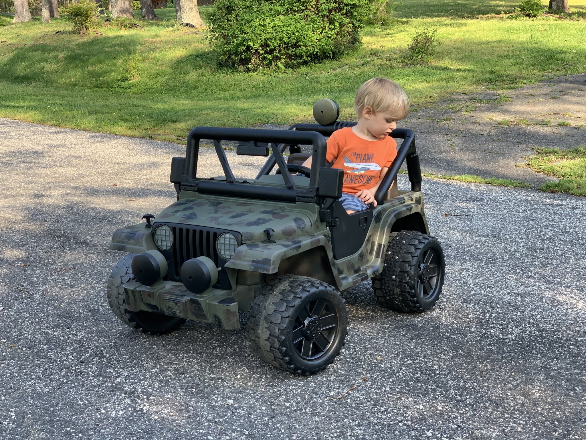

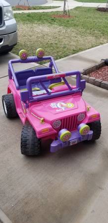

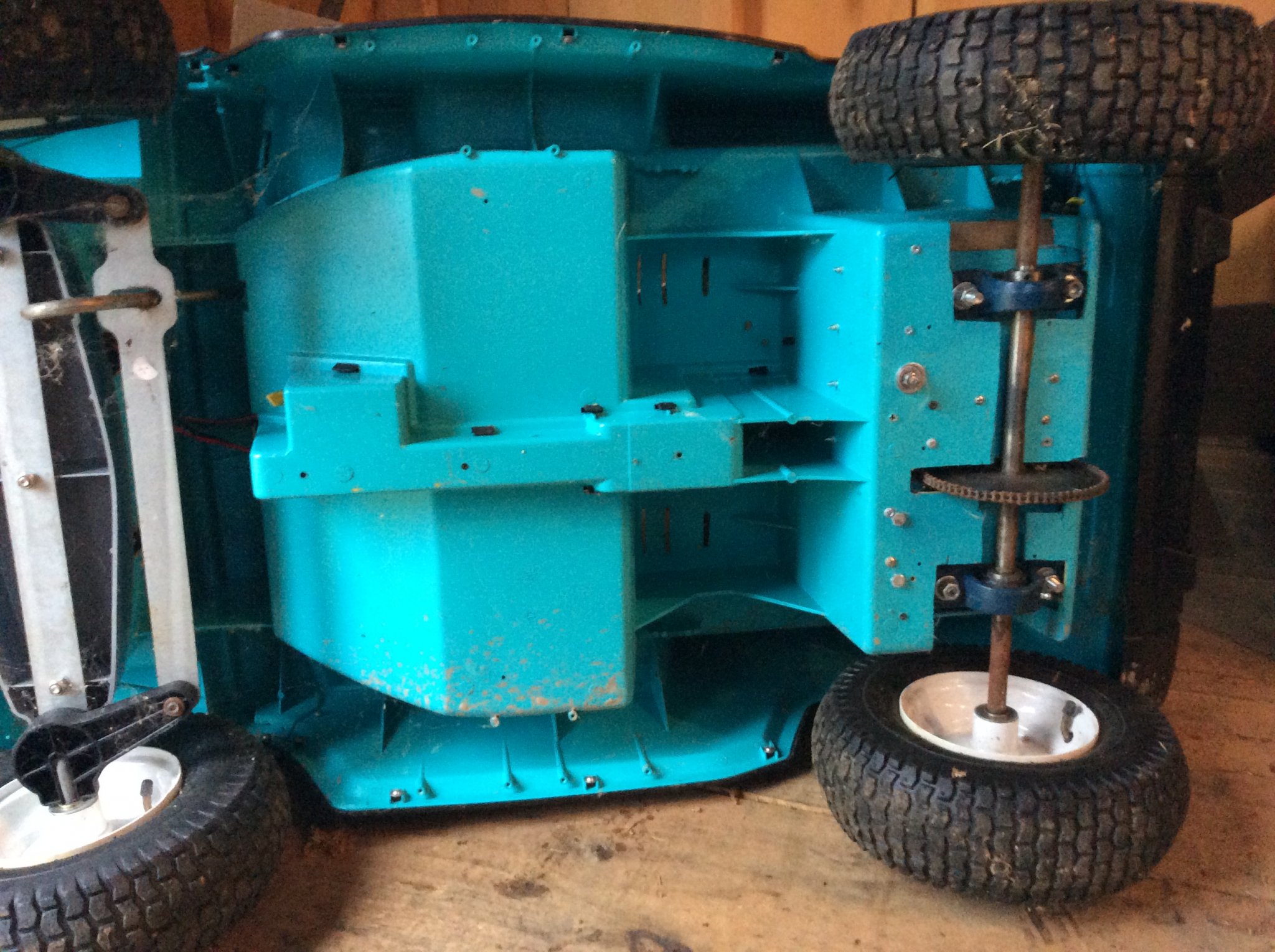

    We had already worked on my nieces all Jeep and I found this one for free, picked it up and made it not a Barbie Jeep.
    Paint and some mountain bike tires screwed into the back tires for traction. Next will be dewalt conversion.
    I did it on his ATV, without a voltage controller and it broke the gears lol. Waiting on amazon to deliver that. But this is what I’ve been doing the last few days.

    I’m going to convert them all to dewalt, he has a JD tractor, a Kawasaki atv and this. But need controllers for them. In 2nd gear, with the 20V, it was hailing ass. Way to fast lol, and breaking shit.

    I had to order 2 near gear boxes, his four wheeler had older ones that aren’t as strong as the current model anyways so it’ll be a good upgrade. I’d like to get the metal gears for it but I’m not dropping that much into these things.

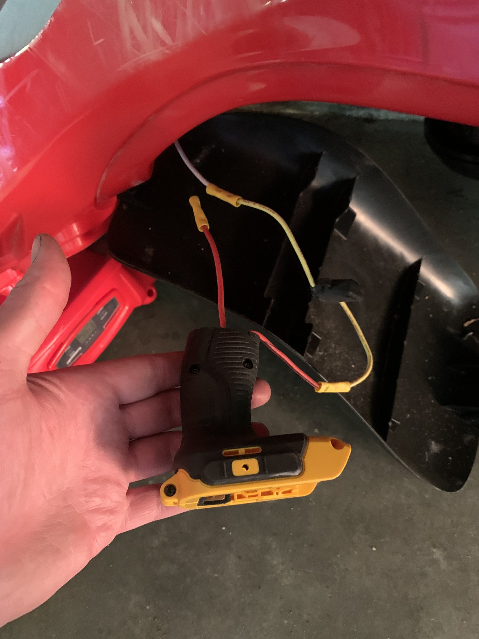

    I had a LED dewalt flash light I’ve never used, took it apart, gutted it, cut it in half and soldered on 2 new wires and ran them out the top, tapped them into the factory wire harness. I’ll post more pics when I get the controller wired in. The ATV is upside down waiting on parts. Here’s a crappy pic, but with the inline fuse in with it also. Pretty easy to do.

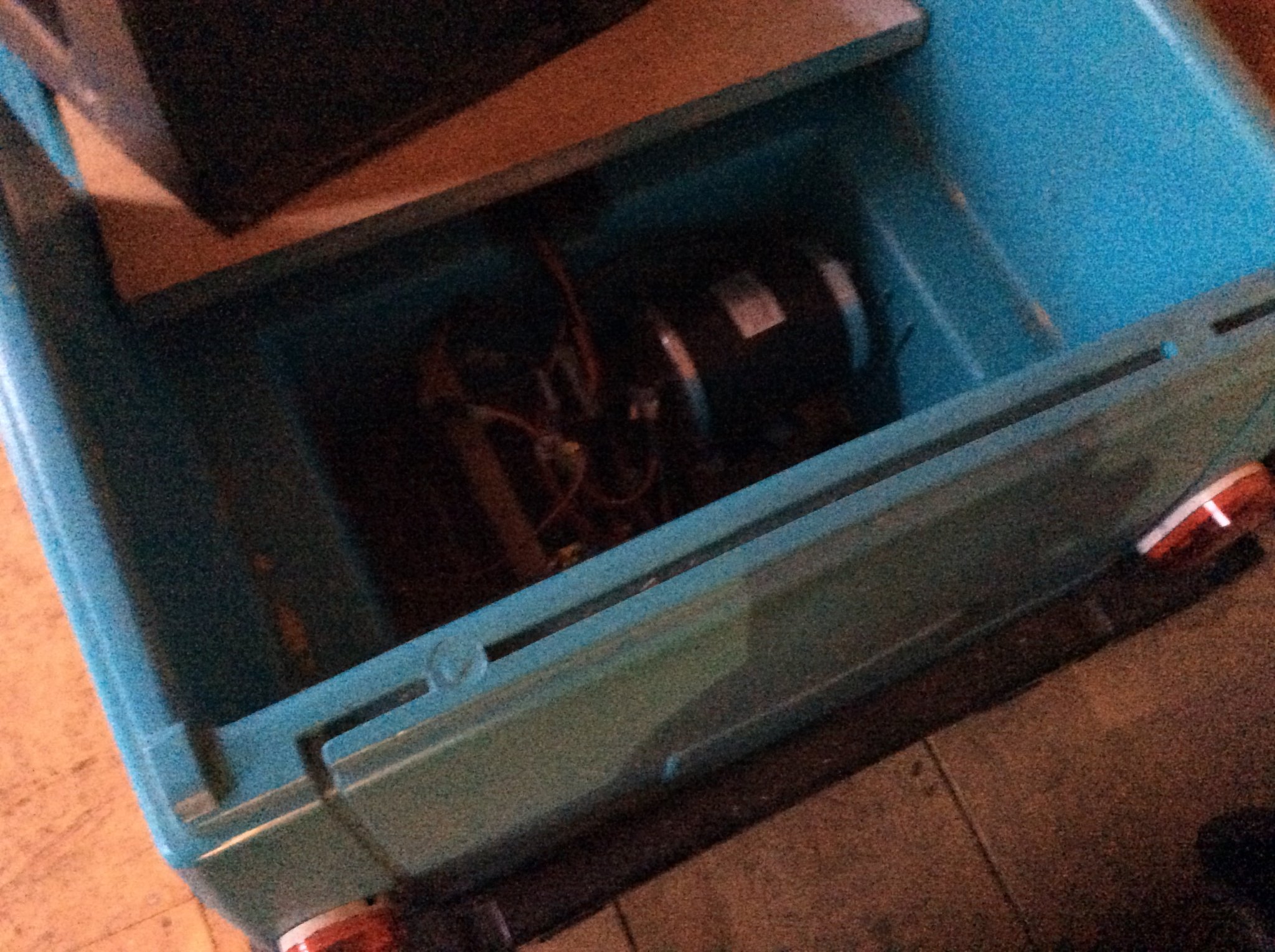

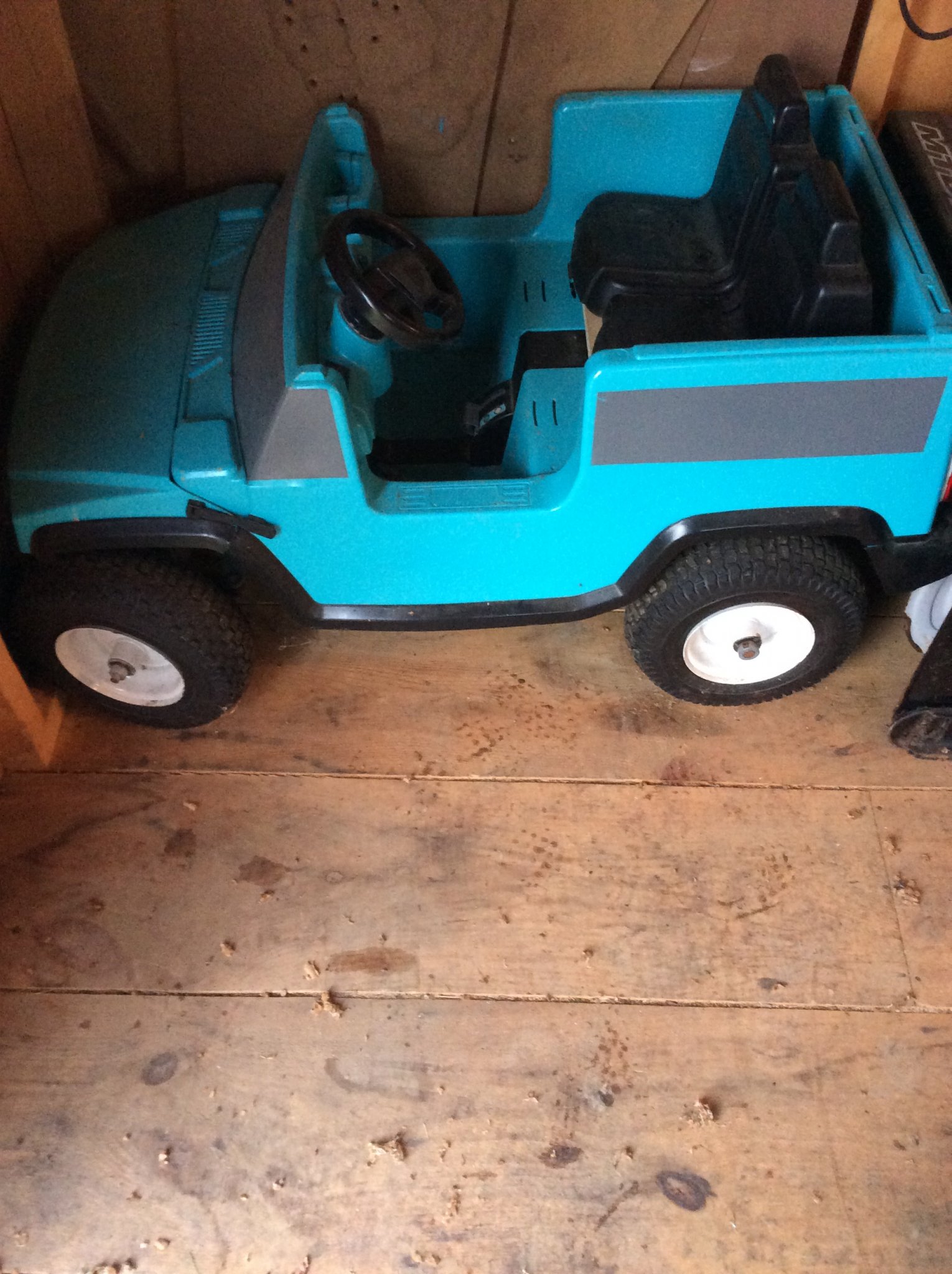

    I also went down the power wheels rabbit hole. Started out harmless with bumping the voltage up and a controller box to support a variable throttle gas pedal. Then I decided to go full custom. Built a chain driven solid axle with tires/wheels on it hummer with a 500w motor. Thing was sick. Would do wheelies. Burnouts when I held onto the rear bumper and smoke up the front lawn. Was going to change the sprockets and see how fast it would go me driving it and have a friend radar me. Never got around to it.
