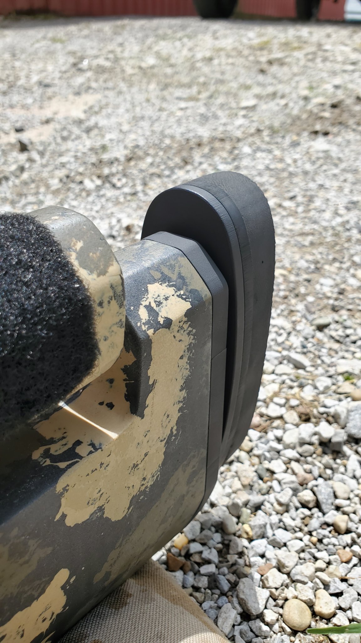

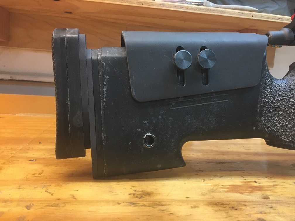

Wish I had seen the SPS system when I was searching adjustable buttplates. At least the SPS allows you to cut-to-fit the plates to match stock profile. I ended up "Bubba-ing" another pre-cut trap shotgun system similar to SPS that works, but doesn't look nice...cuz we know looks are more important, right?

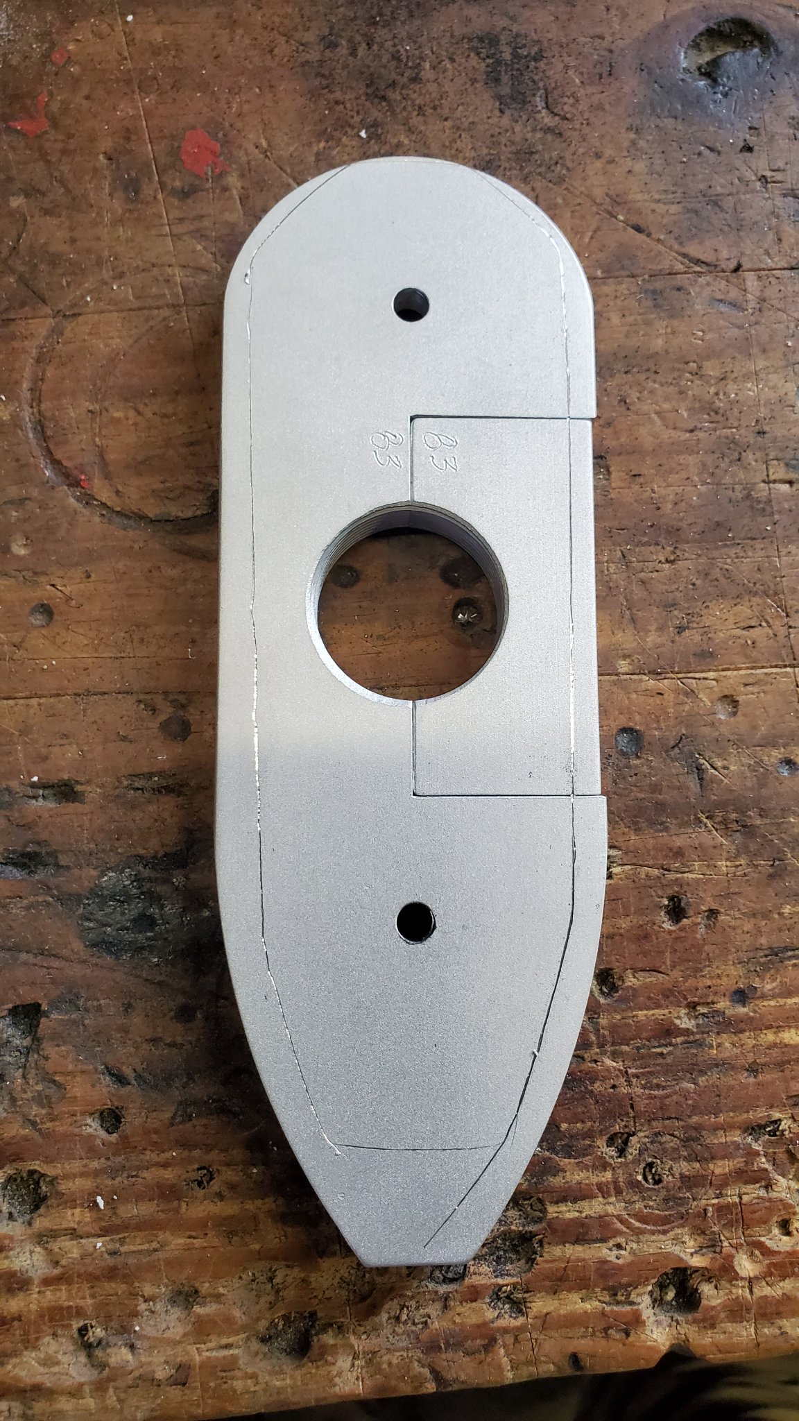

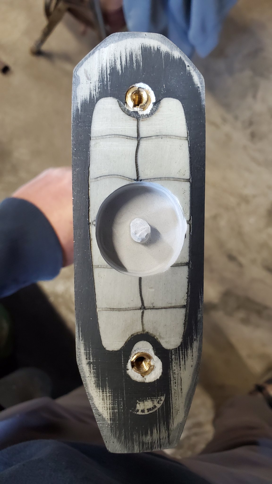

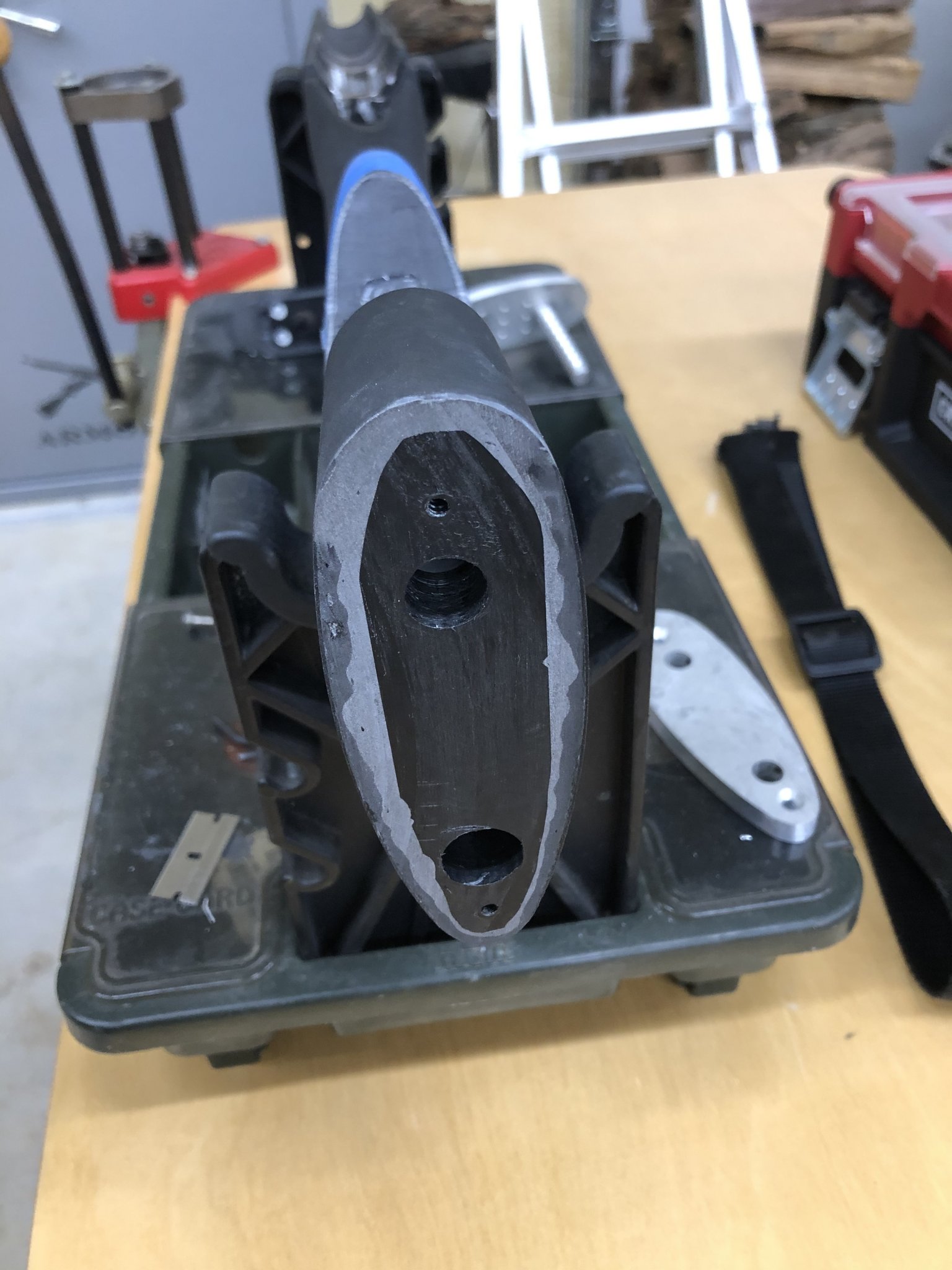

This is a Graco I started to fit for a t6a manners.
I knew I wasn't going to need 1/3 of the lop travel. I cut the threaded tube down to 1" long, so I didn't need to drill a deep 1 1/8" wide hole in stock. I actually marked and then dremeled the hole with a cylinder shaped stone. Brass inserts are glued in for 10-24 screws.
The graco added 9/16", which was close to what I needed. I mainly wanted the pad higher and about 3/4" longer lop.
This is a Graco I started to fit for a t6a manners.View attachment 7315302I knew I wasn't going to need 1/3 of the lop travel. I cut the threaded tube down to 1" long, so I didn't need to drill a deep 1 1/8" wide hole in stock. I actually marked and then dremeled the hole with a cylinder shaped stone. Brass inserts are glued in for 10-24 screws.View attachment 7315310

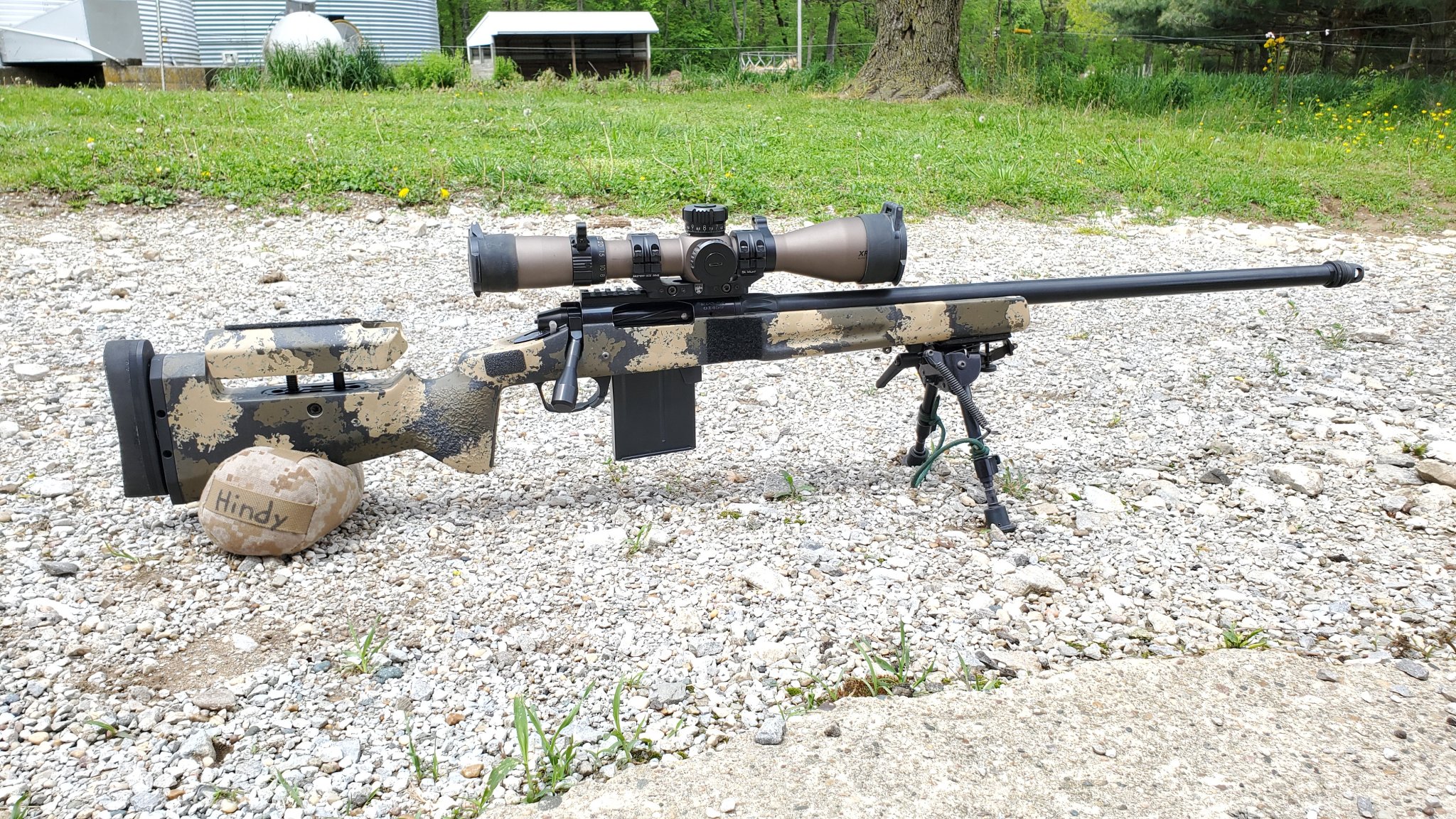

If I was gonna glue it on, like manners does their pads, I'd have it cerakoted. I blasted it with 120 grit abrasive and sprayed rustoleum grill paint on it. Same paint I spray on hotrod 6mm, lol. It matches nitrided actions and is fairly tough. A lot of guys use it on form 1 cans.
The 6creed barrel on that origin is rustoleum grill paint. It doesn't really add film thickness like duracoat or alumahyde.

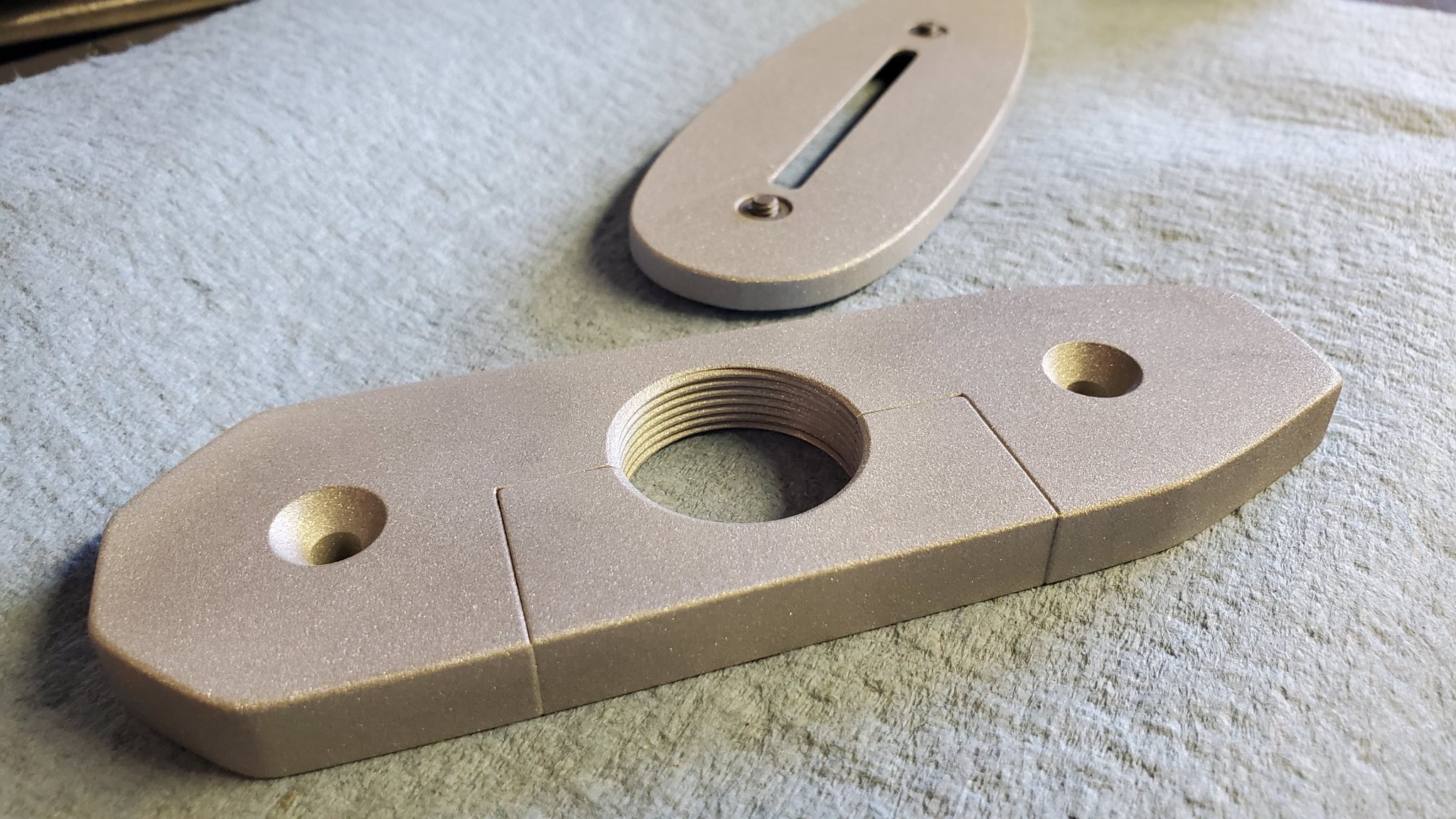

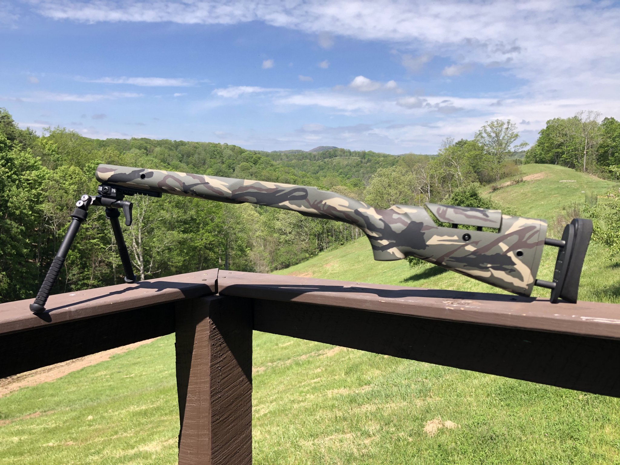

Well got my sps parts and got them fitted. Now just waiting on my butt pad and paint. Still working on the loggerhead install.
