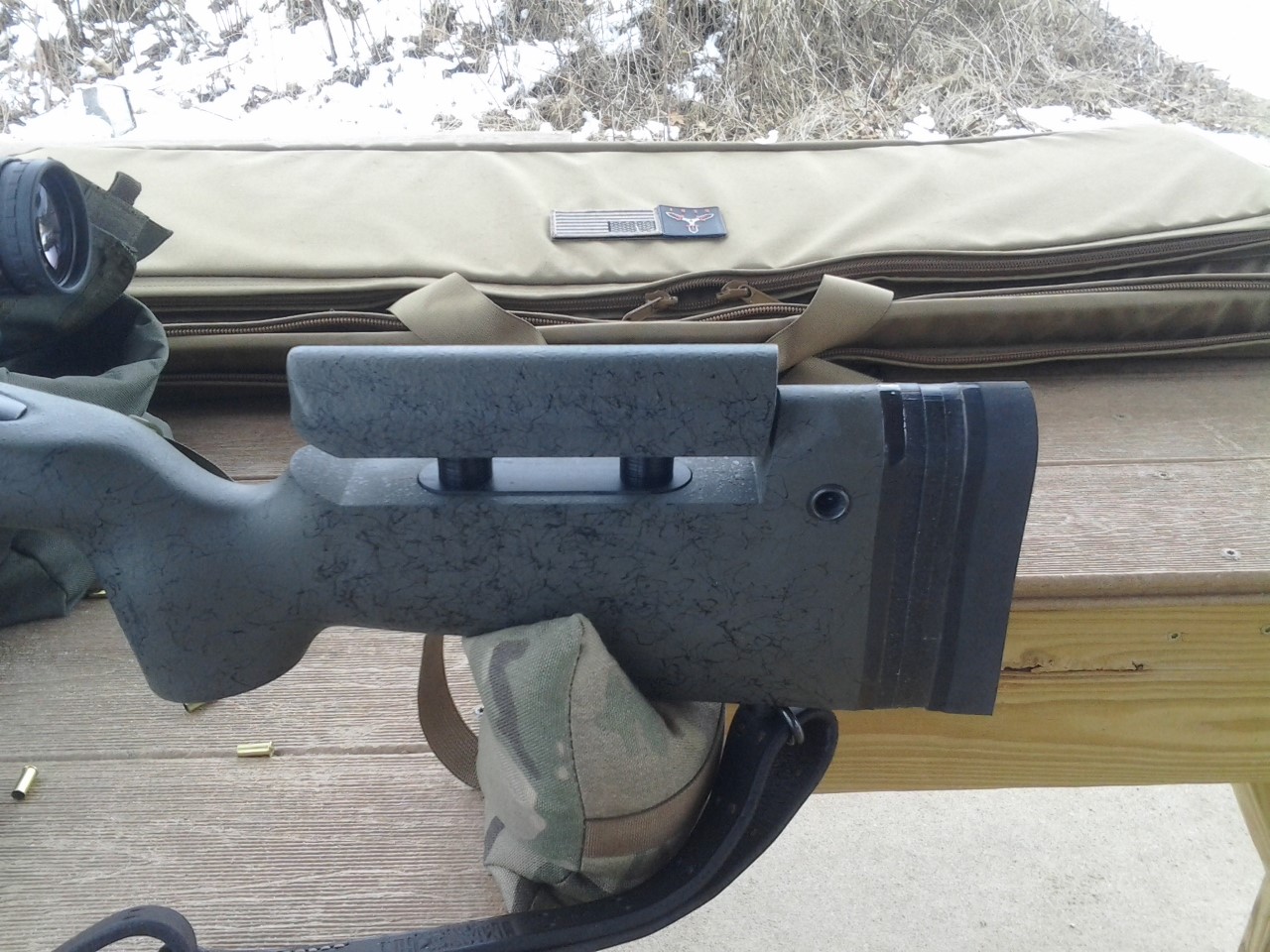

I have a Grayboe Renegade stock, overall I'm very happy with the quality of the stock, but the L.O.P. was too short, and it needed an adjustable cheek rest! Taylor Precision did an awesome conversion on both for me. If any of you guys are having similar issues with your stock, check these guys out, great quality work and fast turn around! https://taylorprecisioneng.com/t/grayboe-renegade-adjustable-cheek-riser

Yes, Taylor did the LOP spacers...he has them in polymer like mine, and also in anodized aluminium. It was right around $100 installed and the turnaround time was like 3 days. I'm not sure why it isn't on the website yet...go ahead and contact him. He is quick to respond and awesome to deal with!
Reactions: JKFlyfish
What does the locking mech look like/function? On the website it just shows 2 holes in the cheek rest.
Those two holes you see are recessed bolts...It works basically the same as the McMillan adjustable cheek rest, however instead of the knobs sticking out of the side there are two recessed allen head bolts you use to tighten it in place. I didn't experience any loosening of the bolts or slipping of the cheek rest, however I later added some spacers to ensure it can't slip under any circumstances, And it helps put it back at the exact same height after removal for cleaning! : )

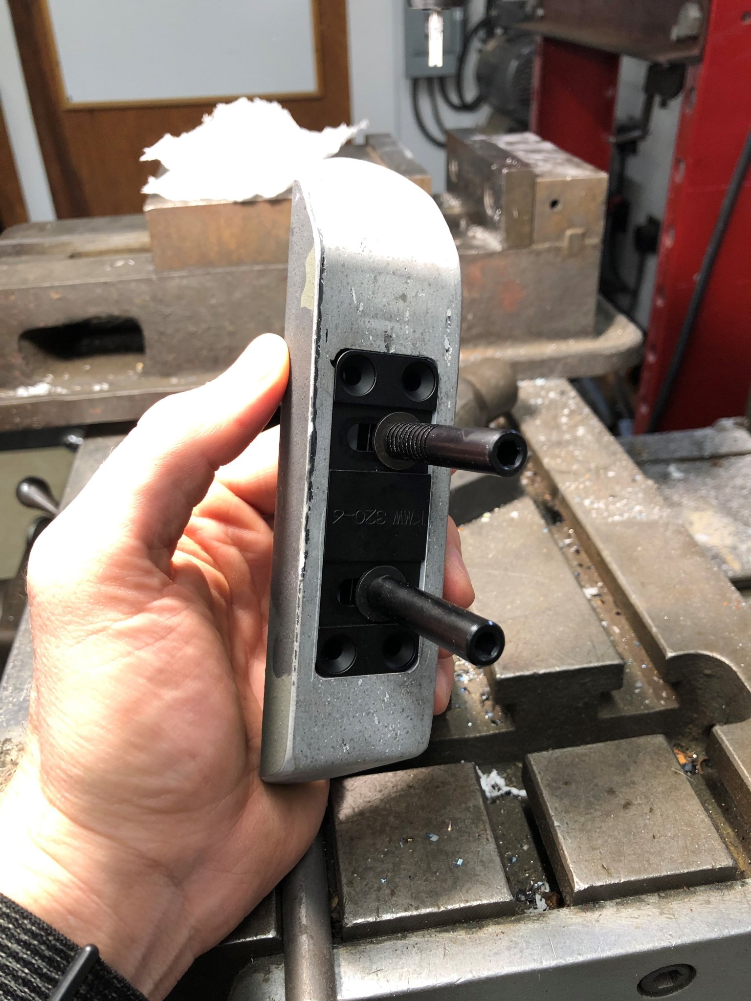

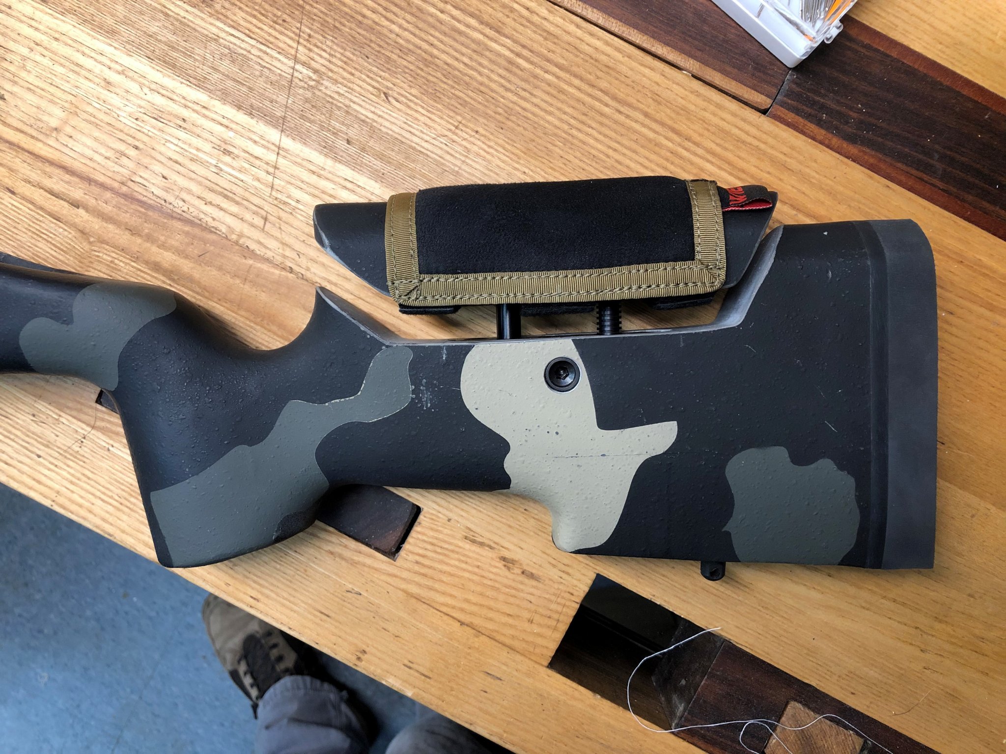

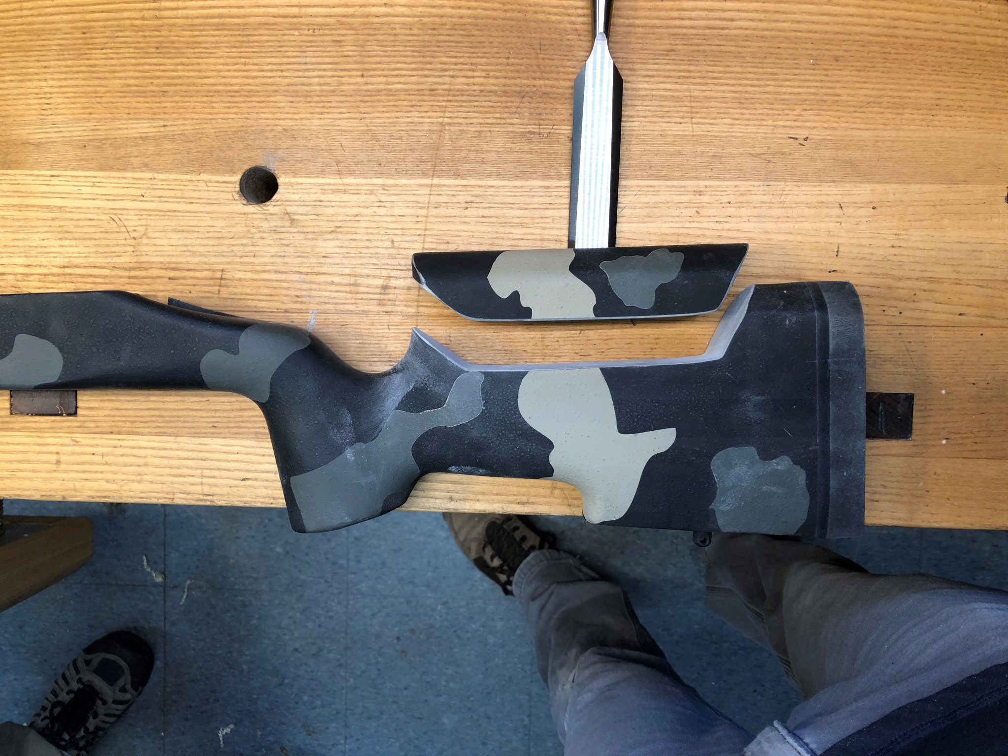

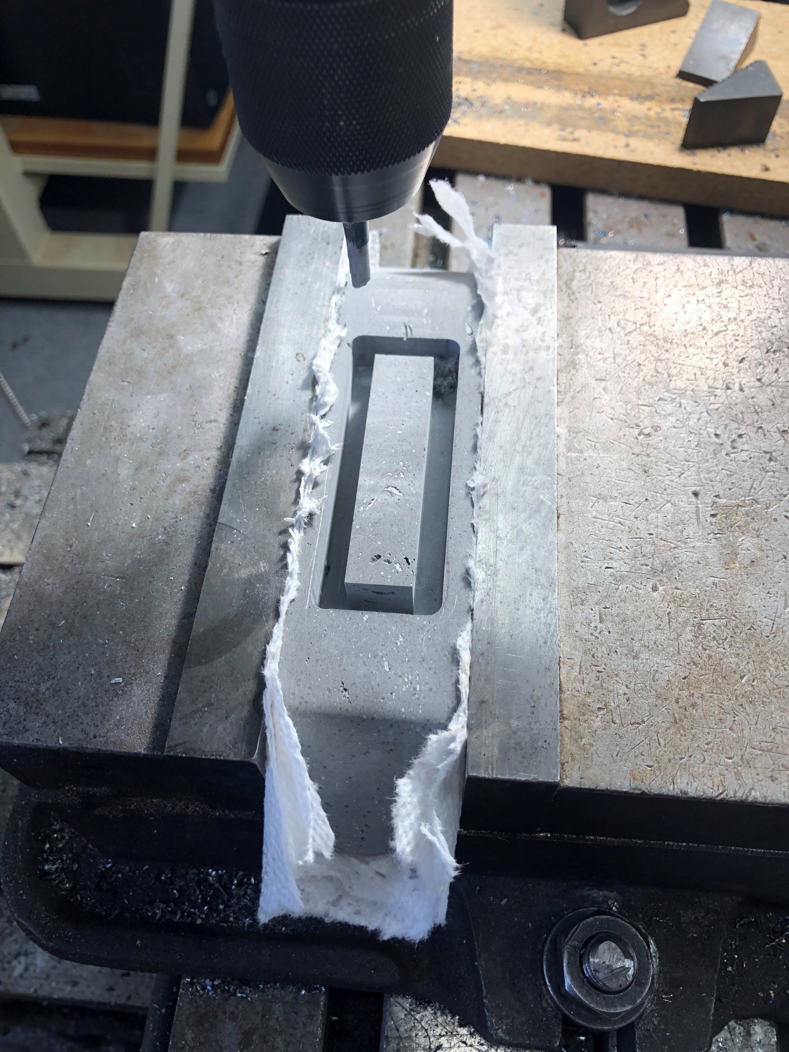

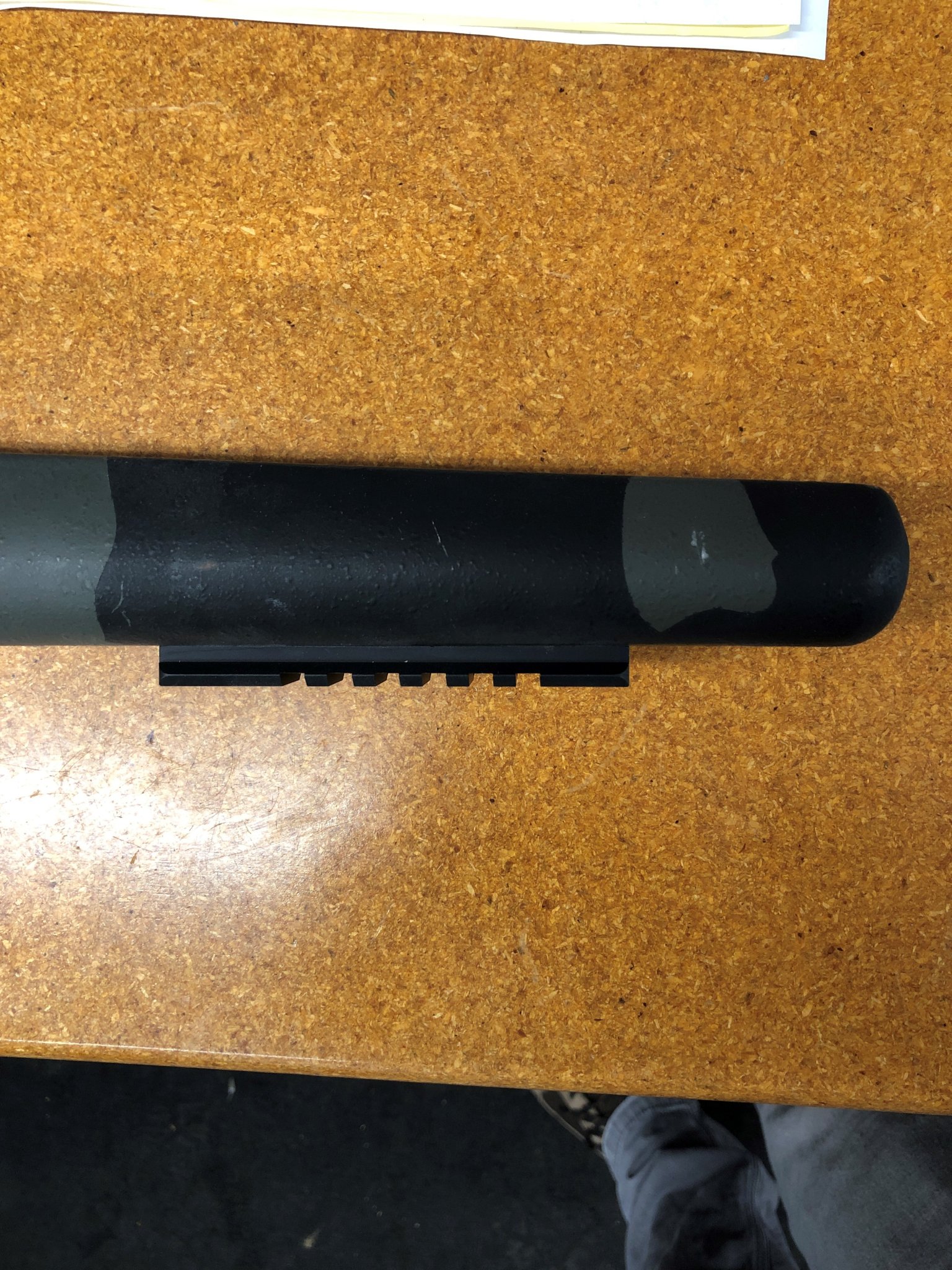

Here is a look at my Renegade mods, added the KMW Loggerhead riser kit and a McMillan pic rail upfront. It was a fun project, knocked it out in a few hours on a Bridgeport mill. The paint job was another DIY project with a stencil kit from Branson Cerakote and good ol camo rattle cans. It will probably go off to Alamo for a real Cerakote job.
