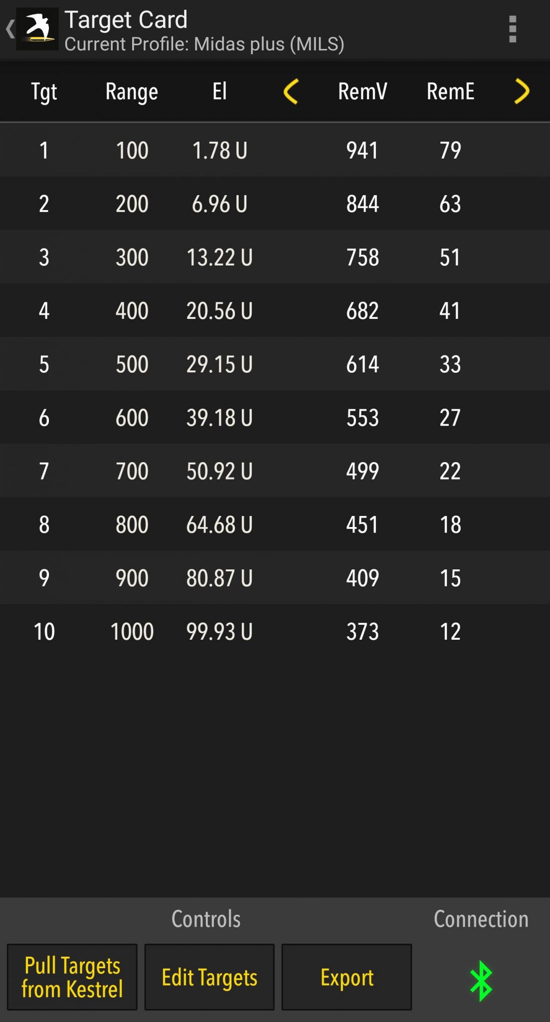

I'm starting to push out into work territory and considering putting together some rimfire elr events here . As the target size goes up, so does the price for AR400 or 3/16 mild steel.
Does anybody have experience with sheet metal or cheap/ thin steel for 500-1000. Sizes will be 2'x2' and 4' x 4'
Ideally I'm looking for the minimum thickness to effectively stop the SV ammo allowing me to shoot it multiple times and hear the "ding" better. Almost surely I'll need a hit indicator for past the 6-700 range.
Here's the velocity and energy if anybody finds that helpful
I shot 4 or 5mm mild steel at 100m and it was bent all over. It was quite fun shooting it into shapes.
22LR is a very powerful cartridge. As you can see above, it only loses 3ftlb of power between 900 and 1000.
I use 1/4" mild steel from 20 yd to 150-170 yd then use 1/8" mild from there out except if running a indicator then you will want 3/16 to 1/4 plate. At our 22lr matches we typically run indicators past 200-230 yds
On sound a 3/16-1/4" plate is easier to hear then a 1/8" generally as the 1/8" has a duller sound. I tried 10 ga at 350 and 400 i could only hear it in no wind conditions it also tended to move tomuch in the wind for a even semi experienced spotter.
Reactions: JKW70
