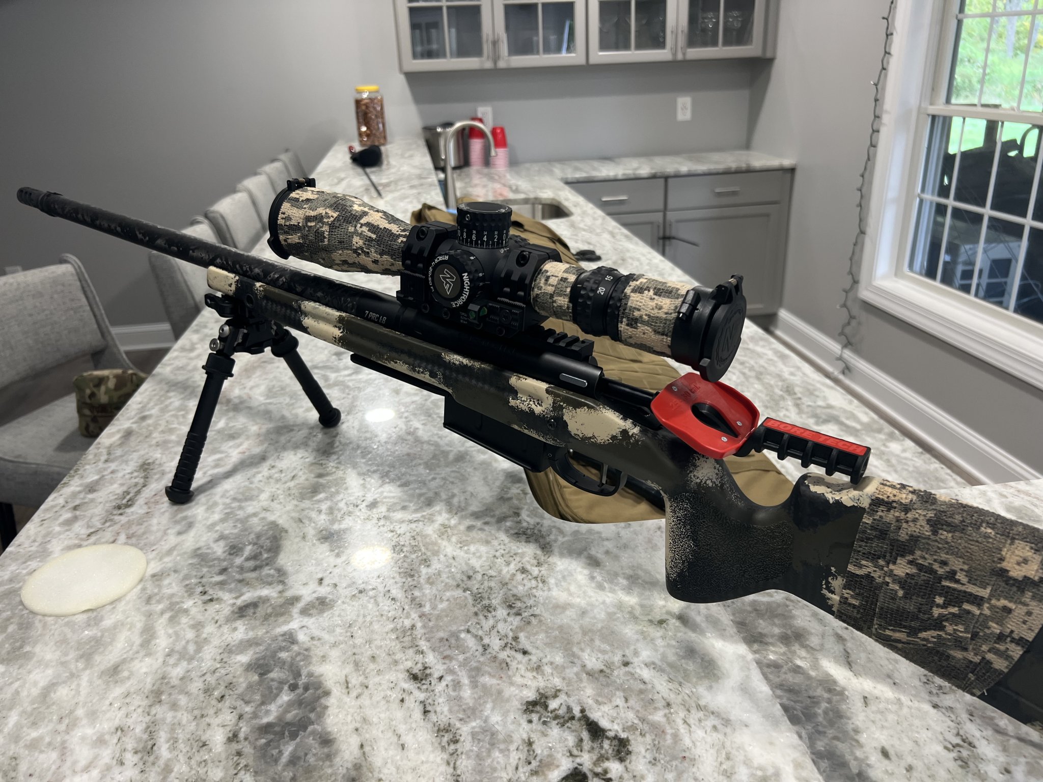

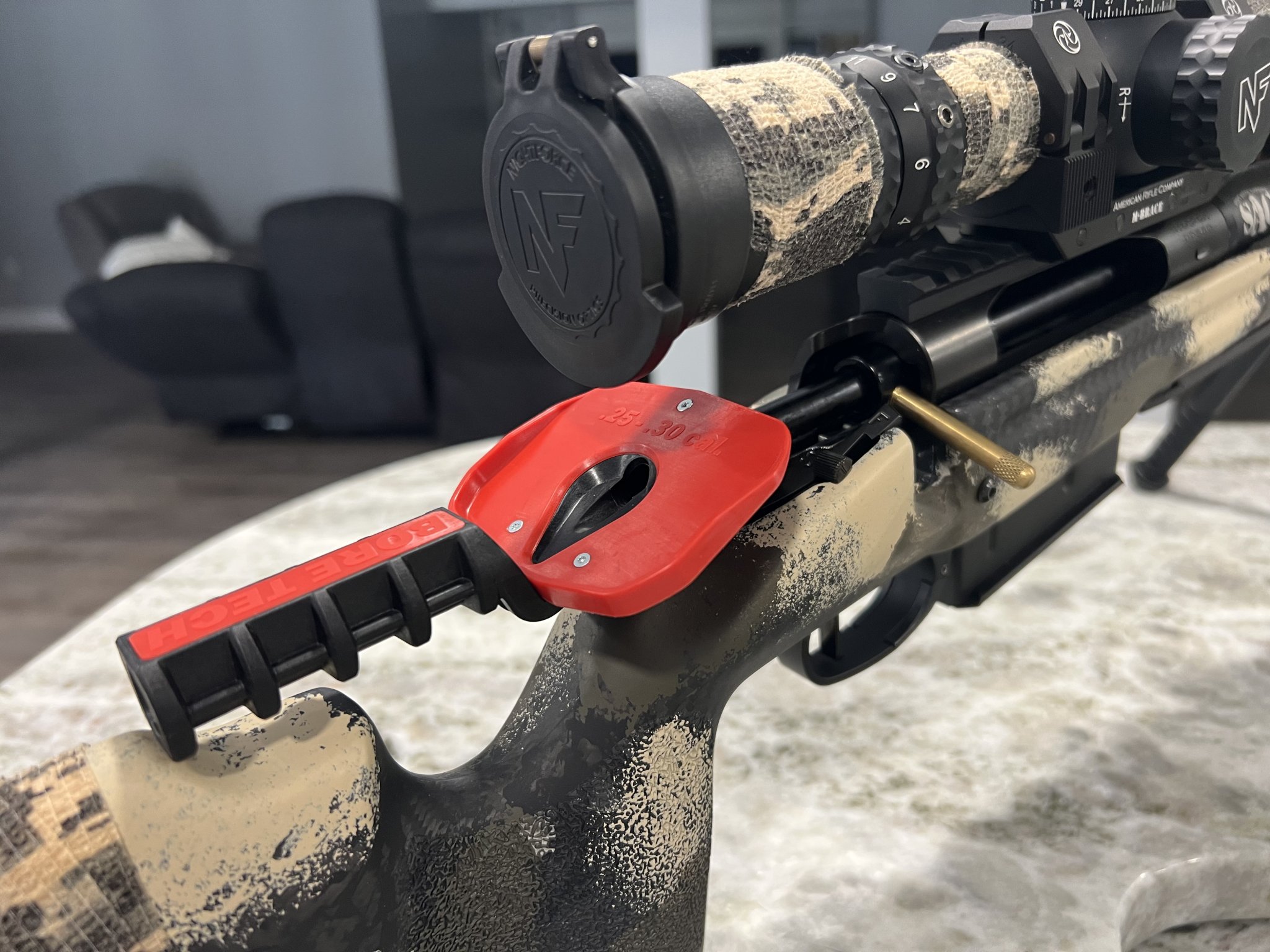

OK, so tried putting my guide rod into my new seven PRC however it goes in at too much of an angle because of the height of the cheek rest. Wondering if I can just shorten the Boretech rod by cutting an inch off the front end of it or any other solutions. pics included
Basically the guide rod is too long and goes in at an angle . I do know per Boretech customer that the guide rod will fit my Zermatt action . Just the cheek rest gets in the way and creates an angle

I looked at your stock on the Manners site. If the cheek rest is adjusted all the way down it should work. The fancy rod guide you have might be too long. I use their standard one and it's shorter.
That said, I see in your picture that the rod guide collar is already in contact with the back of the action while there is more than an inch of the rod guide tube left behind it.
Release the rod guide collar lock by loosening the brass handle on it and then move it all the way to the back of the rod guide. That will give you more wiggle room to fully insert the rod guide.
Then move the collar lock back up the rod guide until it enters the back of the action all the way to where you can fit the collar's brass handle securely in the rifle bolt handle cutout on the stock. If it doesn't go that far then you need a different size collar lock or a different rod guide.
Also, I'm almost certain you might need a longer cleaning rod because with that stock and too short a rod the rod handle will hit the top of the stock and wont go over your stock unless you flex it - not a good thing.
Call Boretech tomorrow morning with credit card in hand and tell them what you got. They are well aware of such problems and will straighten you out.

Luckily I live 20 min from Boretech, I can just bring the setup down there for him to look at and give me ideas. I am definitely not removing the action from the stock each time I want to clean. There has to be a better way with just a shorter length guide rod therefore the back of the guide rod not hitting the cheek rest 🤞🏻🤞🏻🤞🏻
The patch guides on some of those Bore Tech rod guides are held in place with an Allen key detent. If yours is like that & the guide tube isn’t stepped/shouldered, it would be very easy to just remove it, cut some off the rear, deburr, then reinstall

Haha for what I just spent on this rifle I don’t wanna skip out on anything. Did speak to Boretech today. They are going to shorten the guide for me and all will be OK. I’m only about 20 minutes from them so going tomorrow morning to get it squared away.

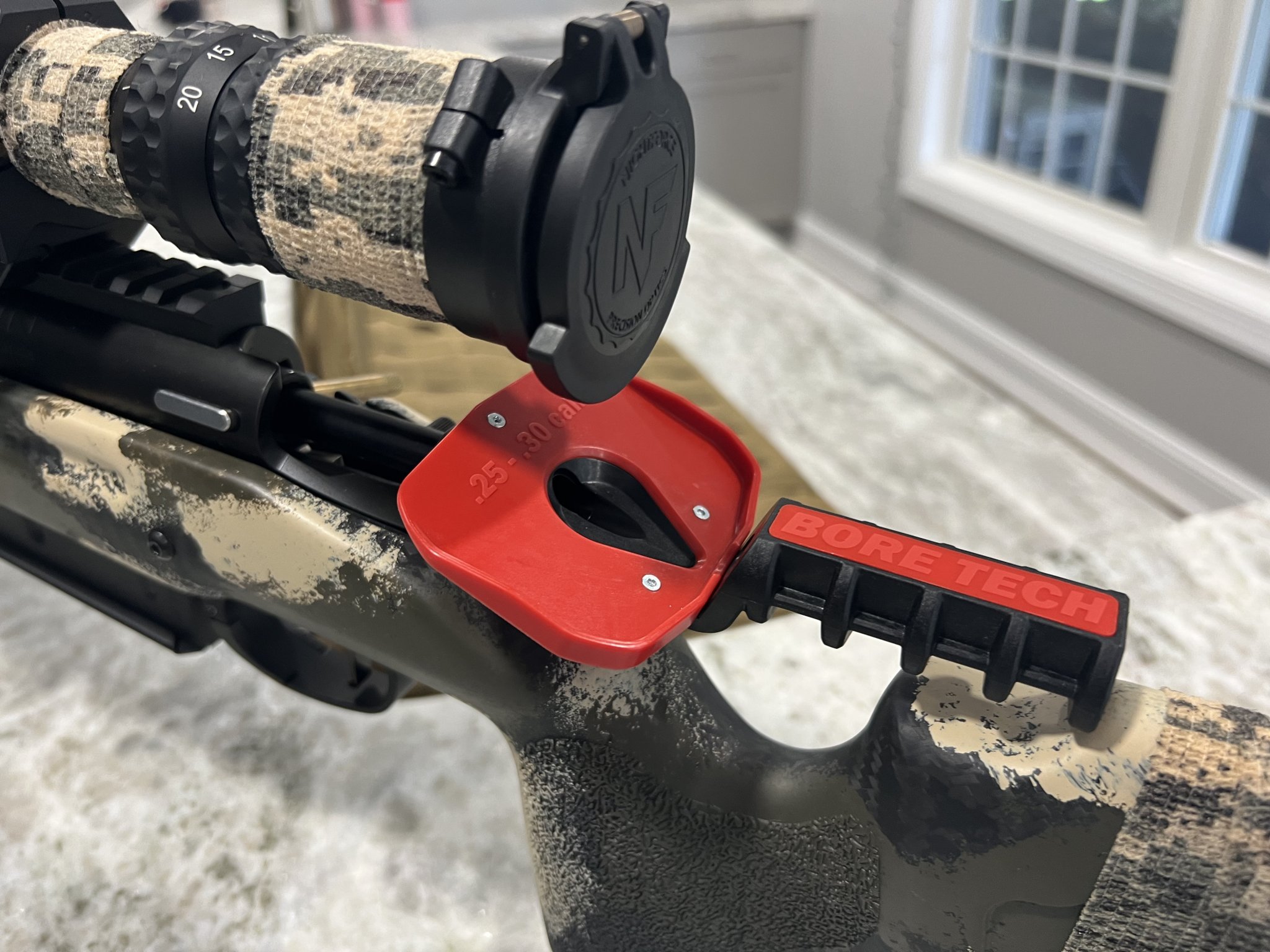

Big shoutout to Boretech customer service . I took a ride down there today to have him fit me a new board guide, he got me squared away, didn’t charge me a dollar and gave me the newest low profile model a little bit shorter than what I had and it fits perfectly.
