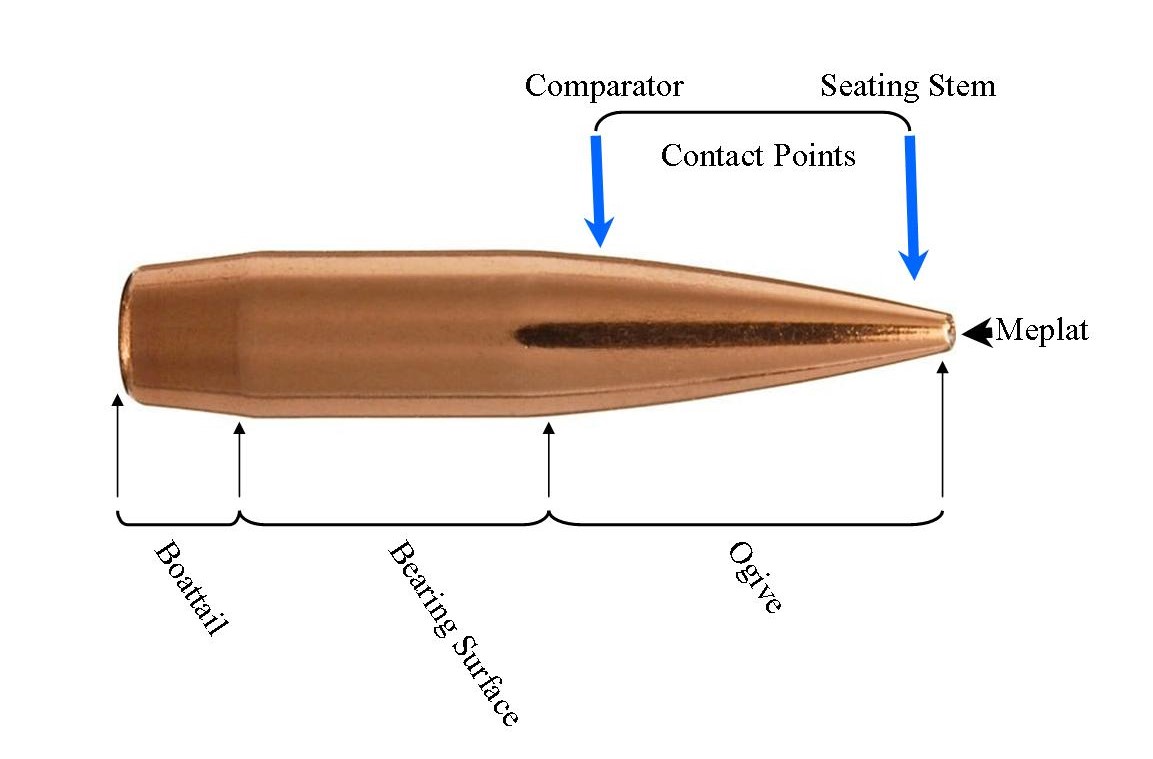

How does one go about measuring the distance from the bullet to the lands? Do you load a round in a engage the bolt and just see if the bullet hits the lands, or is there some kind of tool that can do this properly?
There are other variations of the tool from different vendors

There are a lot threads about measuring. Hornady has a tool with modified case. I have seen people say they use a fired case and locktite. Or a case with split neck.

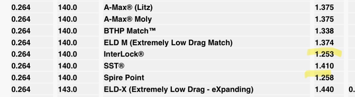

I didn’t realize the bullets were that different. There aren’t any 6.5CM SST’s laying around here, so decided that was the next best thing I could try. All the research I did on powders, just said they “performed” about the same. Nothing relating to the granule size (not sure what the proper term is here) and how much might fit into the case. I adapted with less powder until I could get some SC in my hands. I’m generally open to user-based feedback as relational information. I will certainly continue as necessary. The books showed very similar powder volume and COL, but generally fail yo give good info on powder characteristics.

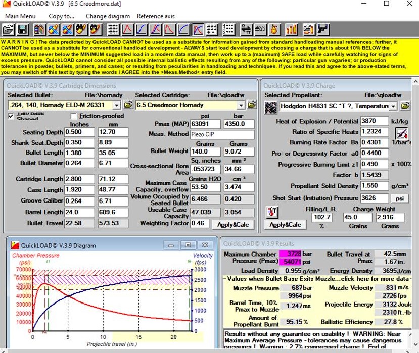

I have the software QuickLoad that get me into the ballpark for how the powder if performing and what other powder might work. It has a database for most powders and gives a default burn rate that I'll adjust according to my recorded velocities. It's a very handy tool that saves me time and components when trying to find a decent combination that I'll need to fine tune. There's quite a learning curve to using the tool well.

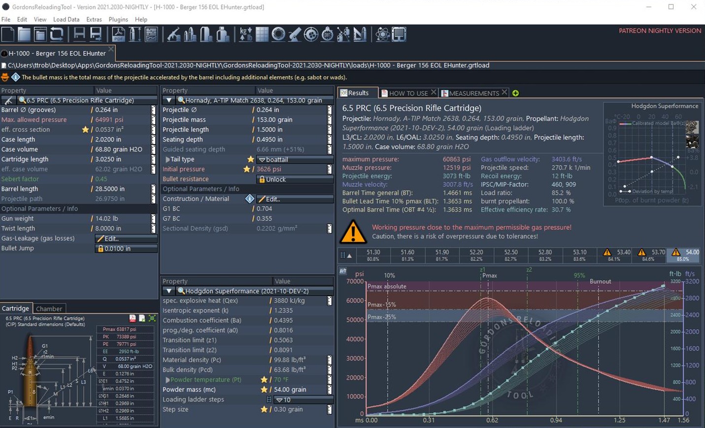

You might want to download a tool similar to QuickLoad called Gordon's Reloading Tool (see pic at the very bottom). It too has quite a learning curve, but since it's a free download, it's something you can play with that'll probably help you learn some things too.
I don't have all the input data for your particular set up, but here some info/example that should give you some idea about the powder you're about to use. It's not fine tuned for you, so don't take the info as something you can count on:
This is what Gordons Reloading Tool looks like:

BTW, I checked the Hornady manual, the 140gr SST COAL is listed as 2.690", compared to the 140gr ELDM at 2.800. I would have to look further but that tells me the SST is a shorter bullet OAL, so if you load it out at 2.800 then you won't have a compressed load. Then the question is where does the ogive sit relative to the lands IN YOUR GUN.
This is why you have to have the proper data and not just switch out components willy-nilly.
According to Jbm the sst bullet is slightly longer than the eld, only by .036
Interesting! I didn't realize there was a software program that cataloged this data. I'll look into those!
I understand that burn rates my vary with environmental conditions, but I assume since there is a table "from fastest to slowest" burns, there must be some documented burn rate for a given set of conditions (temp, humidity, atmos pressure, etc.). That's all I was looking for - for a base understanding of how the H4831 I have compared to other powders that were in the books I have. We have LOTS and LOTS of the H4831, so I wanted to use that, if it was similar to the H4831SC that was called for in the Carolina Load.
I do have a chronograph so I can fine tune into the power with that. Thank you for the suggestions!
Yeah, I didn't yet look into the overall specs on the SST bullet, and I wonder if the length dimensions of the bullet play a role in the compress or not compressed load.
