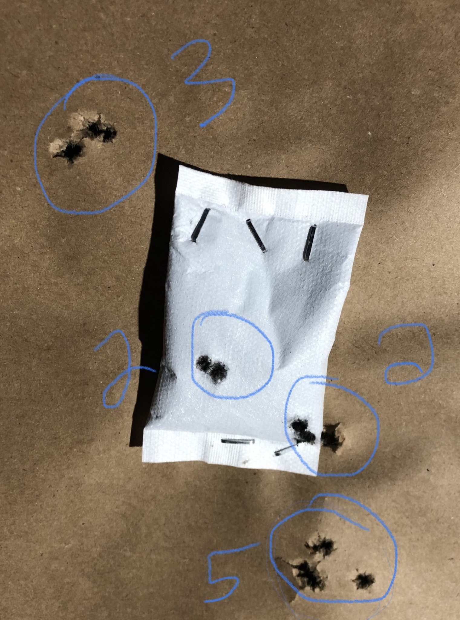

I checked zero again Friday and it was off 2” at 100. I had to move it 4 numbers to get it on with 2 movements not moving the group at all. I hit power to save coordinates and it went back to shooting screen. I then started doing that rechecking numbers and then powering off. The reticle is moving when you watch it when changing numbers. Saturday it was 1” off consistently with a 7 shot group. I moved it again and left it powered on and missed 3 shots at coyotes at 200-275. I got home and checked zero and it was off 3” at 100. Sunday I put my kahles 6-24 on it and shot groups, beat the heck out of the gun, scope and it shot consistent 3/4” groups. The lever mount was about as tight as I could get it on the thermal. Screws on bottom are snug. Running a anker battery pack.
I shoot PRS matches and got 3rd Sunday out of 59 shooters. I understand trigger control and can do more than my part.
All sighting and shooting with thermal are standing with gun on Really Right Stuff Tripod so there is not a difference in pressure or recoil impulse imparted in gun.
I really believe it is some sort of scope problem
anyone else had a problem? Or just me?

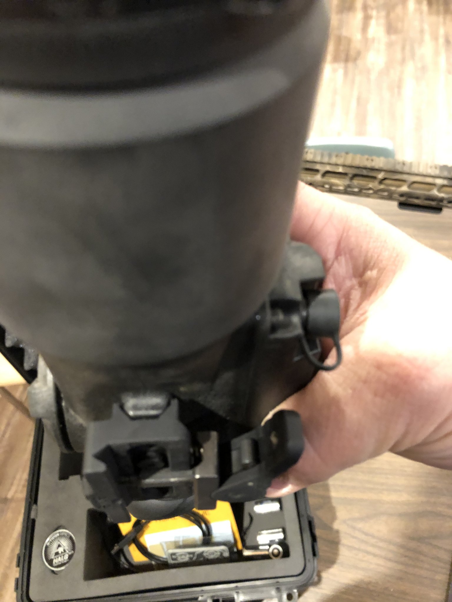

The mount interface was one of the first things I looked at. N-Vision did a good job of dovetailing the mount. It keys in well so the screws aren’t the only thing keeping everything tight. My buddy’s ATN Thor has just a flat surface on the scope and a few small countersunk screws through the mount to handle recoil and side to side movement. His has already come loose.
Judt so I understand, you are putting the laser directly on the upper receiver. Is that correct?
I am assuming that you have no other optics on this rifle.
Did you end up getting yours figured out? I took mine out tonight, heated steel up at 300 and 385 to confirm it was me missing a dog at 350 and not the gun. So I laid down held .6 at 300 and it was low. Had to actually hold under to hit a 6 in disk at 300. Then 385 was supposed to 1.2, I ended up. Needing .5. ok so zero must be off after I check, double checked and burnt 20 rounds the week before making sure I felt it was spot on, so checked it tonight and it was high 2.5 in....ok so adjust, the numbers would move, the reticle would move, I'd save the zero and then cycle through the zoom and I could watch the reticle jump and in the same position that I needed to correct the first time around after I've already saved the correction, so then I would confirm and now my zero would be off the opposite direction....this thing is making me wonder what the heck is going on. It doesn't seem to be moving in a repeatable path, i can adjust it and it doesn't seem to move for correction then jump a couple inches.

Got my scope back on Tuesday and was able to check zero, tracking and holding. Beat the scope/gun around, turned scope on and off, disconnected power while on, and ran 80rounds through the gun. Shooting great now. Hunted the eastern coyote contest with it over the weekend making 9 kills myself to 280 yds. Clarity and detection beat friends mk3 60mm easily. They were impressed.
