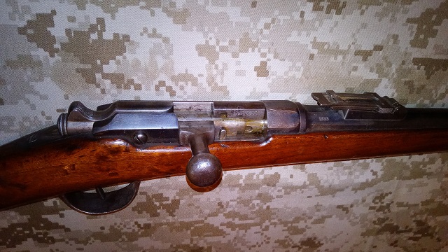

HI EVERYONE.
i received as a gift a beautifull Hammerli Straight-Pull Competition Single Shot Target Rifle, BUT, i am not sure about which is de correct caliber.
the wooden stockk is brocken, probably they fell the rifle, it´s a heavy barrel gun, too heavy.
the rifle has a # 310 -105 number in the receiver.
can you help me with some information about the correct caliber for this rifle ?
thanks a lot,
Marie Franzika Vargas H.

Well the one in the picture is described as being 6.5x55mm Swedish on an auction site. But that doesn't mean yours is. You can measure the muzzle diameter to get a rough idea, though. It'd help if you posted photos of the actual rifle and not one you found on the internet.
Reactions: clcustom1911
My Google-fu isn't strong on this subject but it seems like a lot of these Swiss target rifles, either commercial ones or converted military rifles, are gonna be in 7.5mm Swiss. So it's a high likelihood yours will be, but again, no guarantee. Muzzle/bore diameter & bolt face diameter are your best methods of finding out. But I find it odd that the calibre wouldn't be on the rifle somewhere. I thought that would be standard practice even for a custom piece.

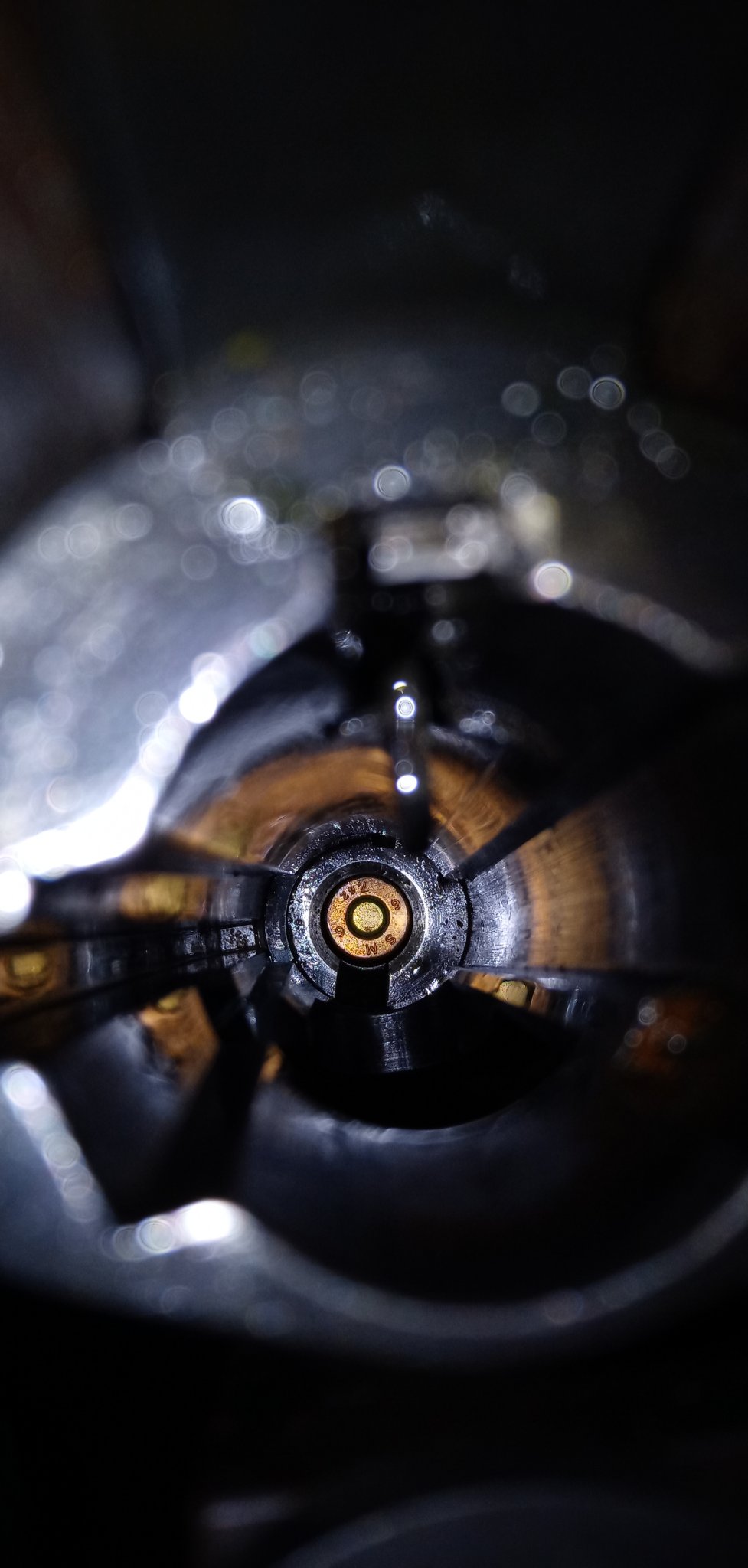

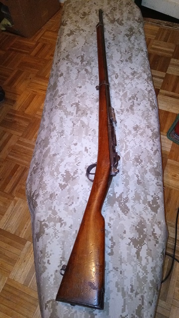

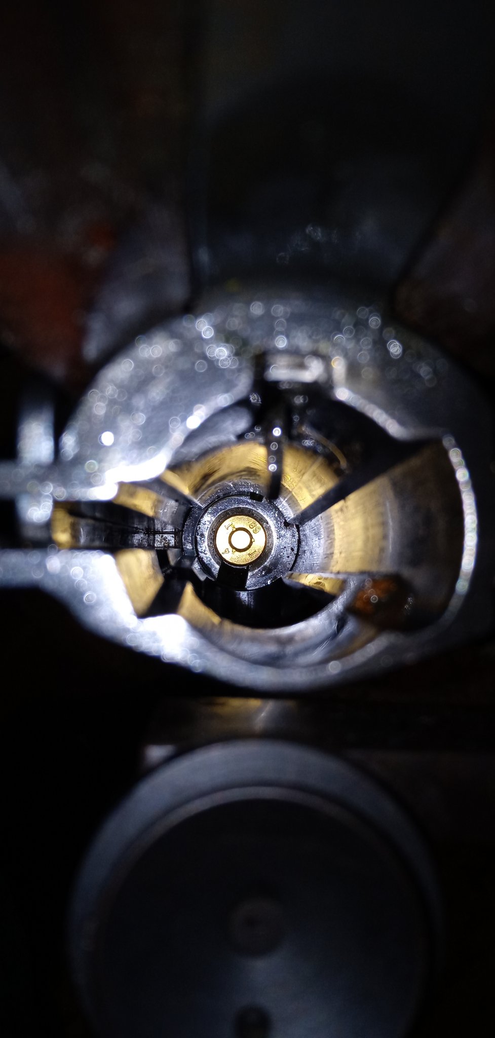

Hi, here are few pics.
Um... why is there a live 7.62 NATO cartridge in there? Those pics don't exactly help, I'm afraid. A 7.62 NATO cartridge will slide into any number of chambers it's not intended for, after all. I meant, for example, the receiver/action and any markings upon it. Or the bore/muzzle with a measuring tape across the diameter.
Reactions: Josh1978
i use live bullet, because its the unique that i have, but, i removed de bolt.

No offense meant! I was more afraid for the OP having trouble with the cartridge getting stuck in there or worse. This one time when I accidentally put a .308 snap-cap into a Kar98k... Not a fun experience, lemme tell you, and I'm glad it wasn't a live round!
But aye, any and all pics of markings, numbers (minus the serial if you don't wanna give that out, we'll understand :), but the general serial range might help for those with stronger google-fu), even proof marks can tell us more. The Hammerli rifles are K31/K11s AFAICS, so I think 99% of the time it's gonna end up 7.5 Swiss, but some are rechambered for .308 WIN (which is different from 7.62 NATO so be a little careful with load pressures, these are older rifles), and as I said earlier, at least one was redone for 6.5 Swedish, although I wonder if that wasn't an error on that auction site...

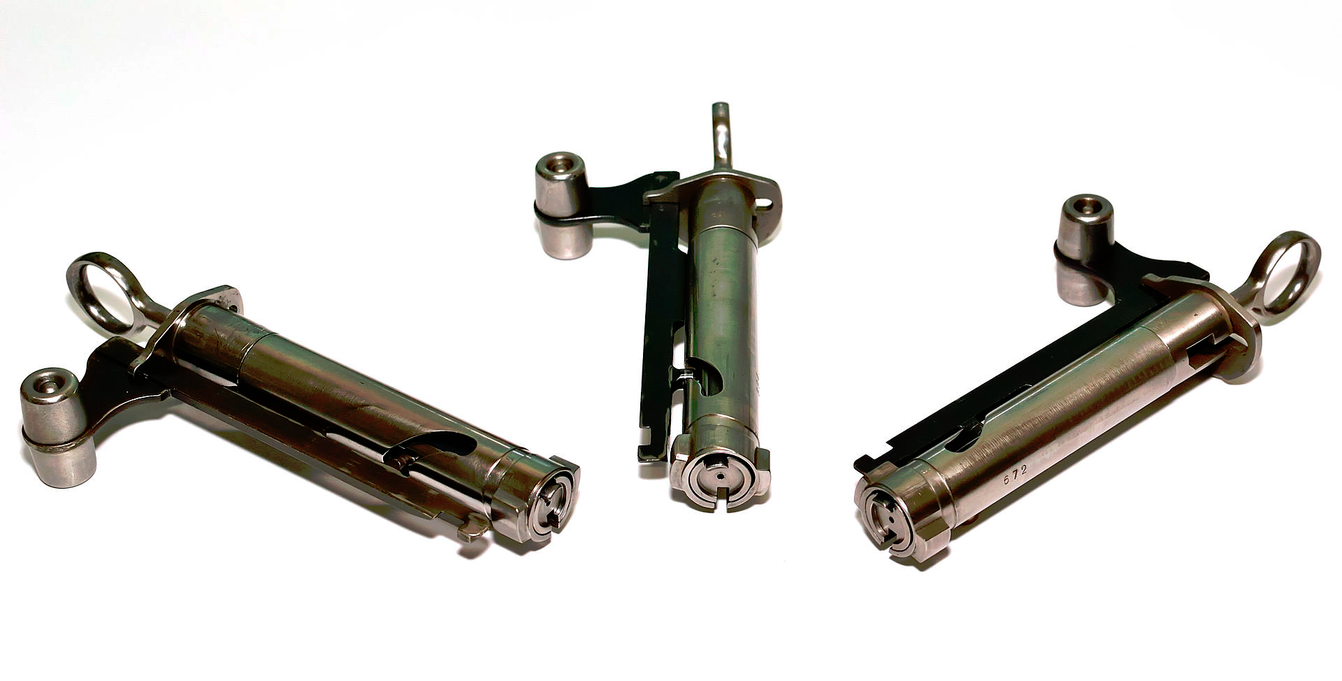

Now, here's something that might help you out. This is a K31's bolt and it oughta be just about the same as yours:
If you measure that indented circular section (where the wee little hole for the firing pin is) and it's just a smidge over 12.5mm across, your rifle is probably a 7.5mm Swiss. You'll need a very fine ruler or tape for that, though.

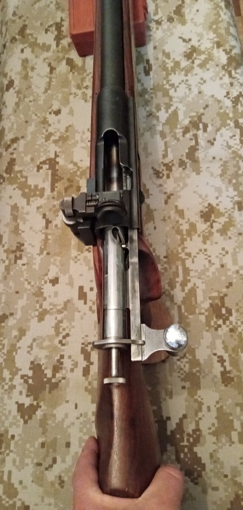

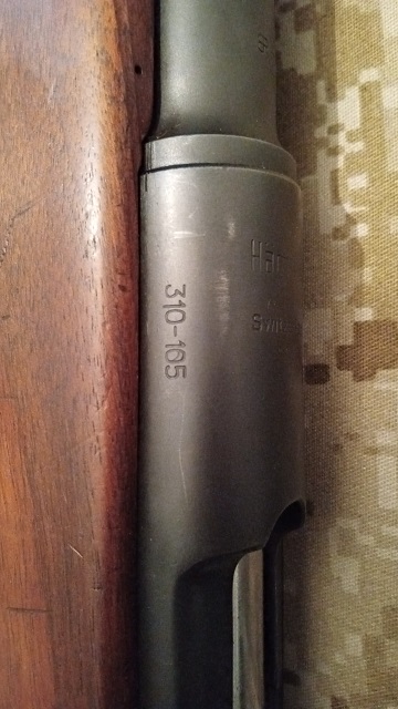

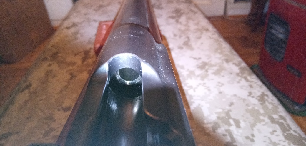

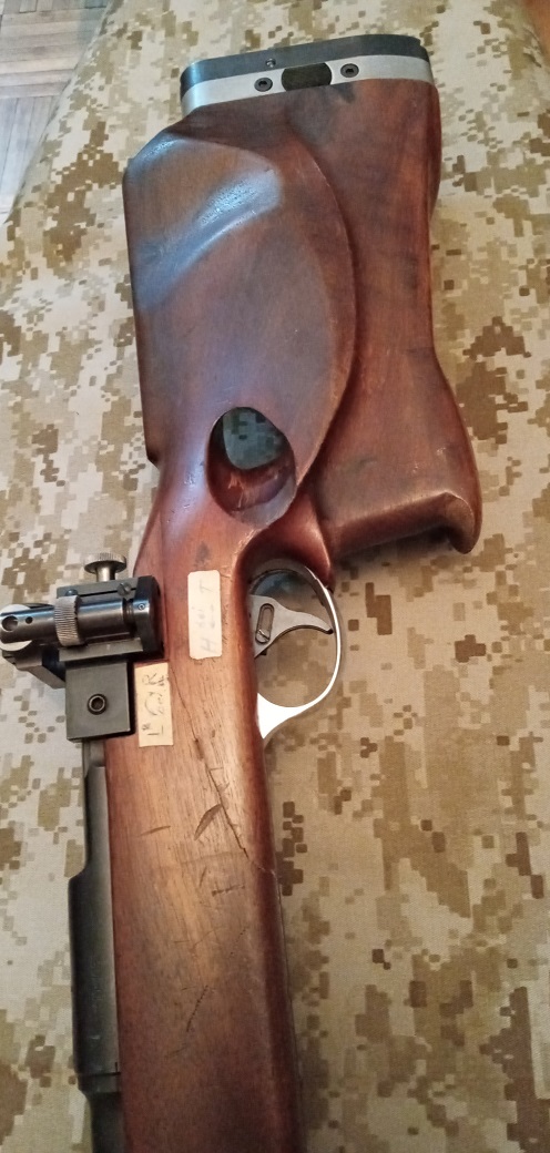

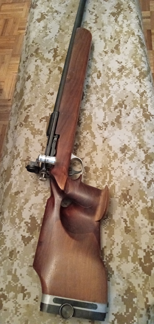

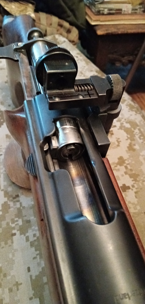

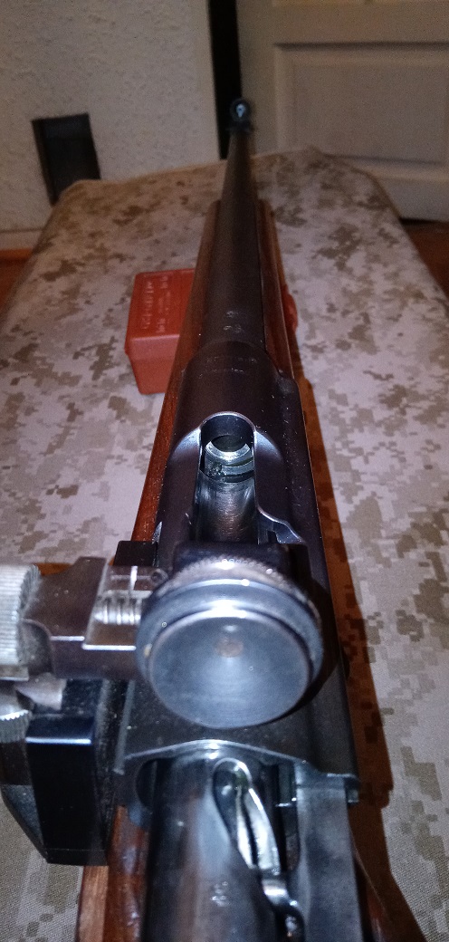

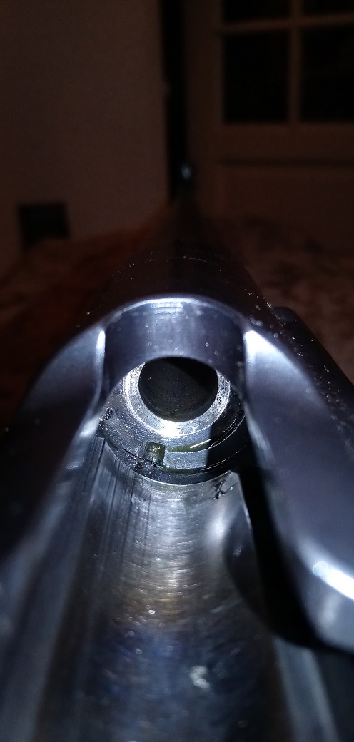

FEW PICS OF HAMMERLI 310 - 105
Oh now that's nice. Shame about the crack in the stock, though.
And it doesn't have a calibre marking anywhere on it? At all? Why on earth would it not, I thought the Swiss were fanatical about detail what with their fancy watches and triangular chocolates and putting every tool imaginable in their pocket knives... ;)
What's it say on the top of the receiver? Hammerli and something beneath it?
Reactions: COUGAR SECURITY
THE ONLY NUMBER I FOUND ON IT IS " 310 - 105 "
If you've never tried casting with metal before (I sure haven't), I'm not sure I'd recommend doing it? Especially on an old rifle like this one?
Its pretty straightforward.. If one aint comfortable doing it tho could always take it to a smith
Id definitely go with cerrosafe over wax or anything soft like that if it was me.. how in the world are you gonna pound anything soft out of a chamber while keeping dimensions the same??

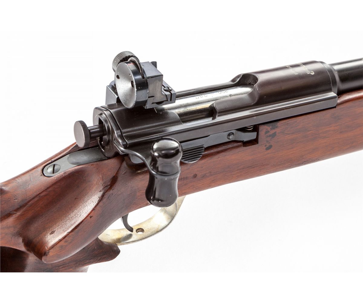

Oookeydokey here's what google tells me:
What you've got there appears to be a K31 that Hammerli reworked into a target rifle. It's probably a single-shot rifle now and it's almost guaranteed to be a 7.5 Swiss. They were converted, I think, in the early 1970s.
If you feel confident about doing a chamber cast, good luck!
Correct. @buffalowinter has one thats quite similar, think his was modded by Tanner tho. Nice rifles.

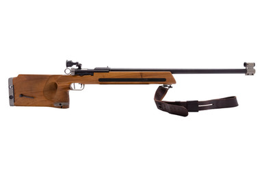

Closest I could find with a little Google-fu is this rifle. It's called a 312, which makes me think that the 310 number may be a serial number prefix or model number.
Based on the descriptions, there should be markings, but maybe concealed by the stock or wood? The Swiss marked everything religiously. It's part of being Swiss.
Also, the target rifles are often left in Swiss Caliber. First, it is a very accurate caliber/cartridge. And second, if I recall correctly, the Swiss ammo was free at matches and only canned military ammo was used. No handloading. So it was you and your rifle against the field. Not handloading. But I could be wrong on that front. Buffalowinter used to compete in these matches. So he would know. But there was little need to convert to 7.62x51 (.308) unless a gun was specifically being exported to a place where 7.5 Swiss was hard to get. That said, I am sure there were guns made in 7.62 NATO as mentioned above.
Anyway, you have a beautiful rifle and with a stock repair, probably an amazing shooter! I'll post some pix of mine, built by Buffalowinter, later.

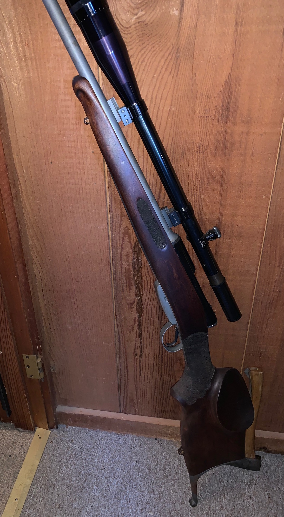

Scheutzen 7.5 Swiss made by BuffaloWinter. Amazing rifle. The barrel is still 'in the white' and the scope is just loosely attached until I get the metal finishing done. I have pretty much decided to 'brown' it rather than blue it. I think it would look amazing that way. Lots of interesting things were done with the Swiss straight pulls.
Cheers,
Sirhr
Cheers,
Sirhr
Nice. Who made the stock?
Oh wow!
Talented indeed.
Do you know what brand the barrel is?
Yes. Swiss Army rifle barrel. It's a stock swiss military rifle, re-stocked as a scheutzen in the same traditions they use in... Switzerland. Where they compete with these sorts of things on the weekends. Winner gets little pieces of triangular chocolate and a Heidi DVD set.
Sirhr

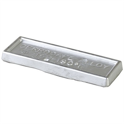

Don't use soldering wire... that is generally a 50/50 mix of lead and tin. And will NOT release from the chamber. The only safe material to use is Cerrobend or a similar low-temp alloy for the purpose. Also called "Woods Metal." It's a metal that melts at hot water temperatures... and then shrinks back enough to let it come out of the chamber. If you put solder in your barrel.... you will cause really serious problems. Getting it out being a serious problem!

thanks for your advise, i´ll look for CERROBEND.
thanks a lot.
Marie.
What you're looking for is" cerrosafe". It is available at Brownell's, they ship internationally. Go to https://www.brownells.com/gunsmith-.../cerrosafe-chamber-casting-alloy-prod384.aspx I t is very easy to use and comes with instructions. I am travelling right now and am parked in front of a restaurant leeching off their wifi so can't talk. Your rifle is almost certainly 7.5x55 swiss, but a chamber cast can't hurt. The caliber should be marked on the left side of the barrel in front of the receiver.
here are various products on the market which can be used to make a cast of a gun chamber. To be certain that the product we are offering you is the best and most practical, we contacted the basic manufacturer. They recommended Cerrosafe because of its unique features. Unlike Woodsmetal which swells upon cooling and cannot be removed from a gun chamber, Cerrosafe shrinks during the first 30 minutes of cooling and then at the end of an hour, is EXACTLY chamber size. At the end of 200 hours it will have expanded approximately .0025". This factor is well known by all toolmakers and they will take it into consideration when making dies or reamers or gauges from your cast - if you will tell them the cast is of Cerrosafe. Cerrosafe melts between 158° - 190° F. It should be melted in a clean, iron ladle. Source of heat should be removed as soon as the alloy is completely melted, at which time it is ready to pour. The solidified casting should be removed from the chamber before, or when, it cools to room temperature. If allowed to remain in the mold over an hour, it will grip the chamber walls and be difficult to remove. Clean the chamber of the rifle thoroughly, then plug the bore immediately ahead of the throat with a small rag - but not so tightly it cannot be driven out. If possible, pour the molten Cerrosafe through a small tube into the bottom of the cast, gradually removing the tube as the chamber fills. If the barrel is cold, warm it to room temperature or above before making the cast. When cooled, remove from chamber, using a rod or dowel from the muzzle end of the gun.
