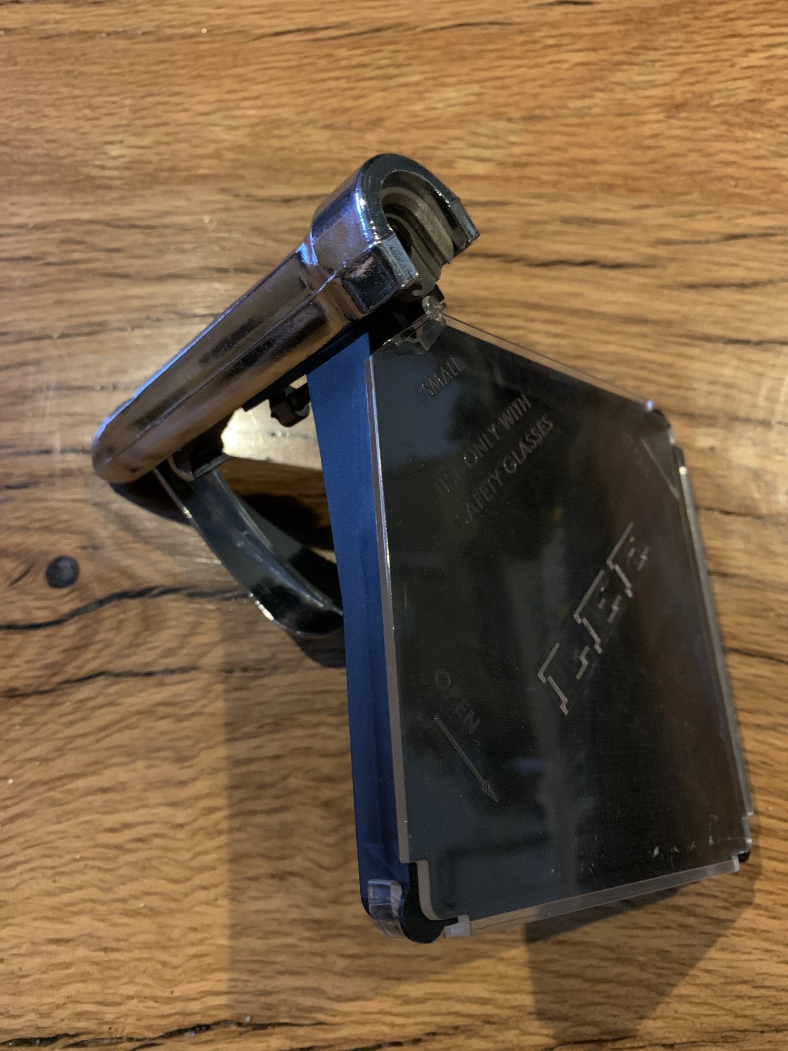

The Lee is the worst hand primer I have used. The length and angle of the lever on the Lee makes it a lot harder to seat primers with. On average I would break 2 or 3 lids per year. I really just can say enough bad things about it. It will seat a primer though, so there is that.
They will flip in the loading shoot. A primer mashed in sideways is ruined, a primer upside down can be popped out and used.
Maybe you had a defective one? I’ve not had any issues? Though it’s large rifle. I’ve used it for.
I have worn out more Lee hand primes than you own likely. The older unit was better, but still the worst hand prime I have used. The angle on the lever on the old one made it easier to seat primers with, and there was transfer shoot where it lifts the primer out of the tray, before putting it in the shoot. That is where primers get flipped. I still have an old and new Lee hand prime sitting hear. I kept them about 7 years ago in case the RCBS unit didn't work out. Its primed enough cases by now to have worn at least one of them out.
Well I’m not in a rush when using it. If need be I’ll sell it and get something else. Til then I’m fine with it
I have to say, the Lee with all its faults, is way better than the Hornady. That thing was the worst. Luckily I could and did return it.
My lee hand primer has never given my one issue. Never broke a lid, never had one flip, weak spring letting the tray fall out, none of that. My one complaint is that it DOES seem to have worn in and on my 223 it only puts the primers flush instead of below flush.
Its only fault mainly is lack of leverage. The rcbs Ive used has the same lack of leverage only it was way more trouble to switch primer size and shell holders.
