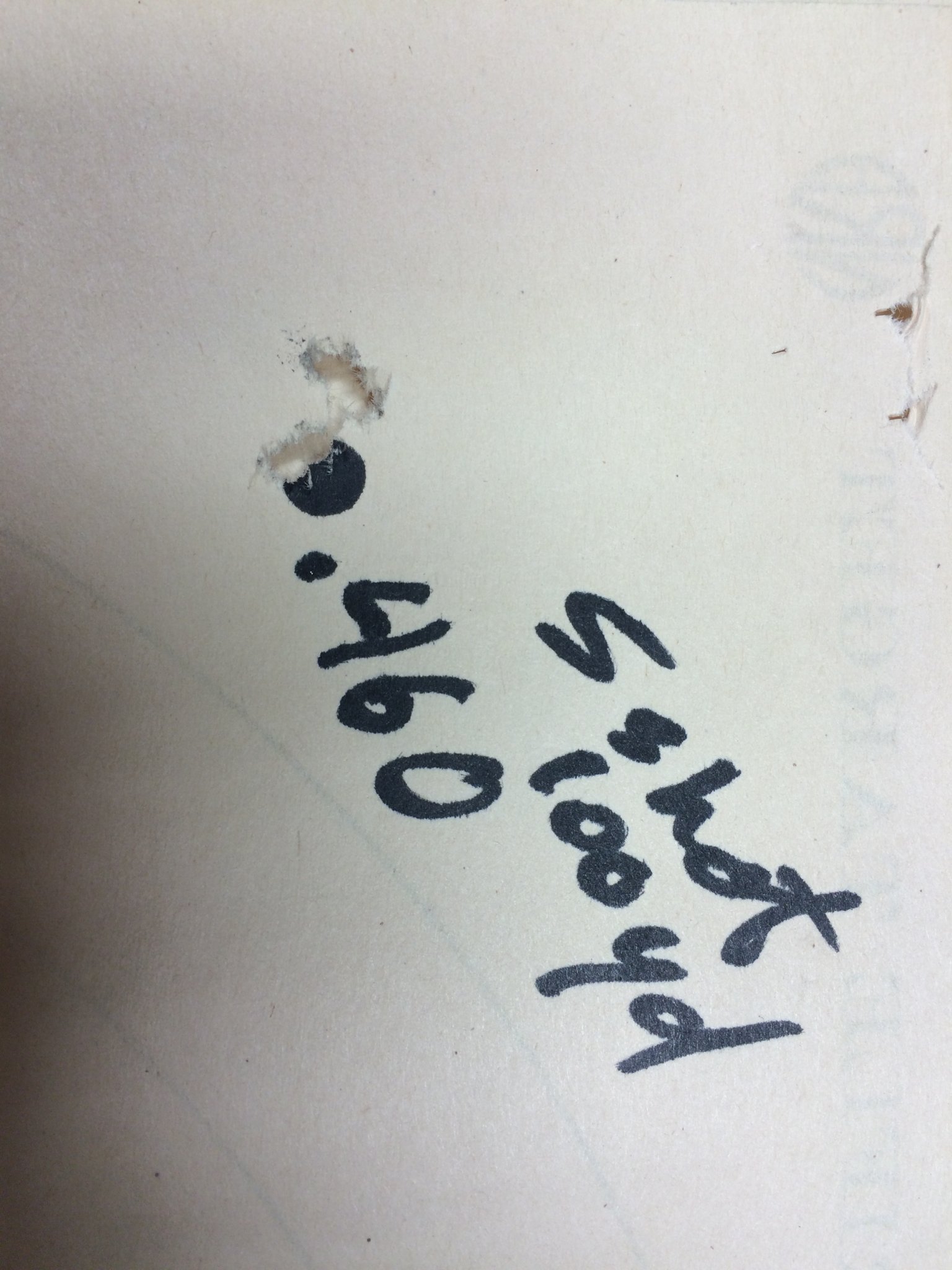

A super high power scope is not required
to get good groups.
My old 6x Unertl does fine.
