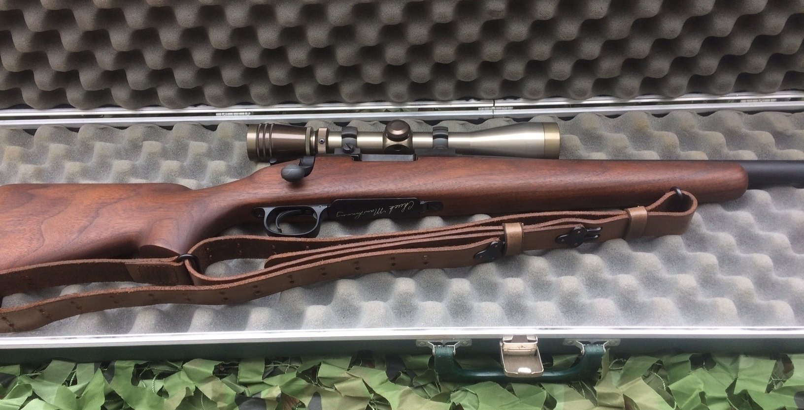

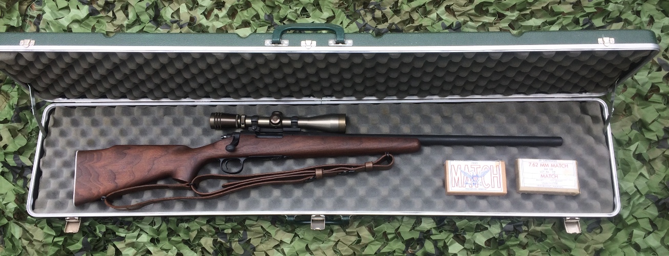

For the average collector like me with limited resources, the best option turned out to be a Chuck Mawhinney commemorative rifle, which I lucked into back in 2015 for $2500. The is a replica of the 1969 M40 configuration, and while it is not a vintage collectible, the upside is I can shoot this rifle from time-to-time without guilt, unlike that extremely rare 1966 M40 auction rifle, which is a true collector's item - for presumably display only.

I'd share this with @buffalowinter, but he'd just trade it for a Kel-Tec or something... ;-)
Cheers,
Sirhr
Nope, next item on my list is the newest release from Hi-Point, the YEET CANNON G1 TB, suppressor ready, MSRP $250. Seriously, I might get one of these and re-work it into a true match ready pistol, just to add the insult to injury factor when people get beat by an old guy limping around shooting a hi-point.

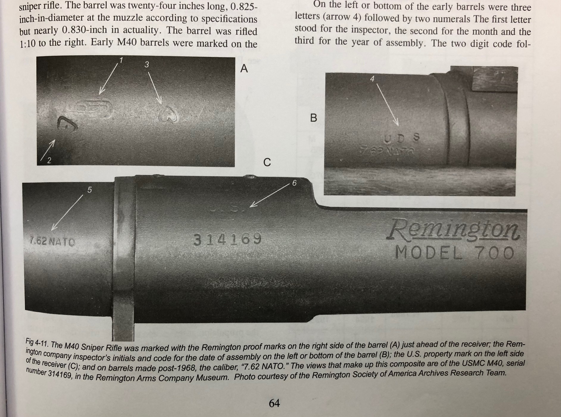

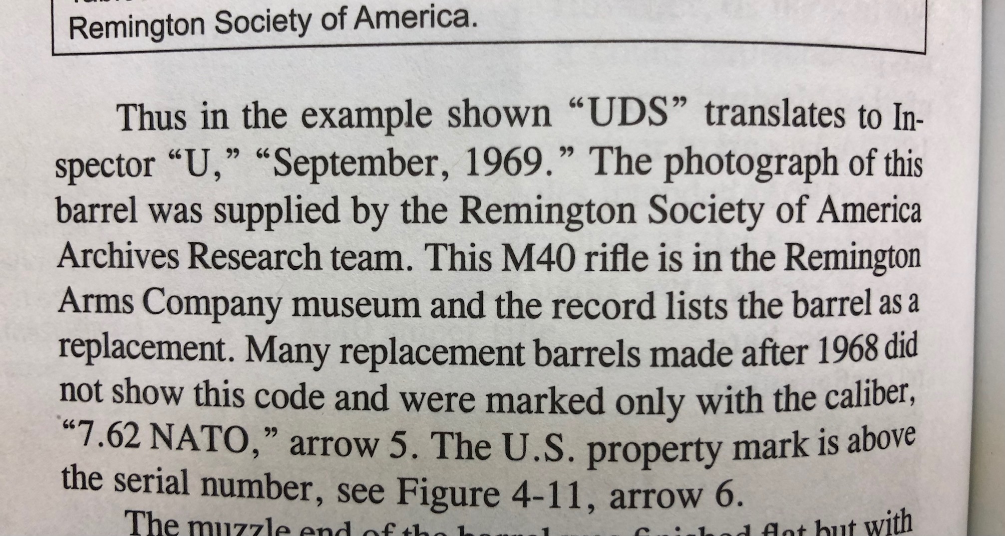

What's also strange is the 7.62 NATO marked barrel, I've never seen one of these barrels on an early 6 digit rifle. Normally these marked barrels are on the 6257xxx rifles, I need to match up the markings to a date chart and see what pops up.
Everything else about the rifle is legit. There's numerous characteristics that prove it's a real receiver, so I'm not worried about it at all. If it's a rebuilt rifle with newer markings on the scope and base, then it's the best I've ever seen. I need to do some more research on it, it could be an original rifle, it could be a rebuild with force matched parts. There's some interesting characteristics that aren't standard for this serial number range, so I'm excited to learn more. Here it is with Major Dick Culver's M40:
Here's my 2cts. The auction rifle appears to have a barrel with an install date of March 1968 - if I understand the "A" plus "R" stamp on the left side of the barrel.
The Remington M40 drawings (aka blue prints), underwent 3 subtle changes b/t 1966 and 1969. This involved a change from the 'flat-face' safety to the round style, a change to the trigger and sear mechanism, and I think a slight change to the bolt as well. In addition, Joe Poyer's book noted that "post-1968" barrels have the stamping "7.62 NATO", which was presumably added to the 1968 drawings. So a 1966 M40 is very slightly different from a 1968 or 1969 rifle.
I digress, but I will note that a decade or more ago, I understand the SSA and Chuck Mawhinney M40 commemoratives were built using the 1969-dated M40 drawings, which is the latest (and I think only) drawing that Remington had on file. Some folks were upset about the round safety and where expecting a flat-style safety, but the fact is both are "correct" for a Vietnam era M40, it just depends on what year the rifle was made.
More importantly, Joe Poyer's book, Collecting the American Sniper Rifle 1945-2000, also noted how quickly the M40s were worn-out during the harsh tropical monsoon climate of Vietnam (pg 75):
"By the spring of 1967, ample numbers of M40 rifles were in-country, enough for sniper instruction and to arm all two-man Marine sniper teams then in the field. So rough were conditions and so great their need that by the end of 1969, only 90 M40 snipers remained in-country and only 23 were serviceable according to Marine Corps Records....The barrel tended to erode and pit after as few as 1,000 rounds. The trigger would not hold pressure adjustment as parts wore in. Stocks tended to absorb moisture, swell, and warp which caused changes in the point of impact (POI)....The telescope was easily damaged...The telescope sight often fogged in the high humidity of the Southeast Asian operating areas. Seal technology still had a long way to go in the 1960s and some of the more effective seal materials that are used today had not then been developed."
Bottom-line: There was an extremely high attrition rate in Vietnam re both M40 rifles and those greenie scopes. They needed constant re-building by Remington back in the USA to keep them serviceable, including new barrels. The Redfield scopes also failed a lot, so many were replaced as well. So my theory re the auction M40 rifle is something like this:
Rifle was built in 1966 and went into service with the USMC probably by early 1967...where and for how long is of course unknown, probably somewhere in Vietnam, but it could have also been used stateside for sniper instruction training, etc. Regardless, within a year the barrel needed replacement thanks to harsh conditions (or wear) and in the spring of 1968, Remington re-barreled it. I suspect they also put a new scope and mount on it during that process as well, based on how fragile the scopes were back then. The person at Remington engraved the scope and mount in the spring of 1968 during that re-furbishment process, accounting for the odd location when compared to where they originally engraved them back in 1966. (Note: Redfield was under contract to repair or replace the scopes as needed, as part of the M40 contract, and the black “Gen 2” replacement scopes came into play at some point in 1968-69).
IMO, this rifle was not likely fielded after the re-barrel (and possibly a new optic system was installed as well) - as it's just too pristine - and somehow a Marine was awarded or acquired that rifle in 1969, and it has remained in this configuration since. This history takes nothing away from the rifle as almost all M40's apparently needed to get re-built after a 9 or 12 month tour in Southeast Asia.... Again, it's a truly collectible M40 rifle still in its Vietnam configuration, of which only a tiny few are in private hands. It's the only one I have seen with a matching green scope and mount. That's my 2cts.

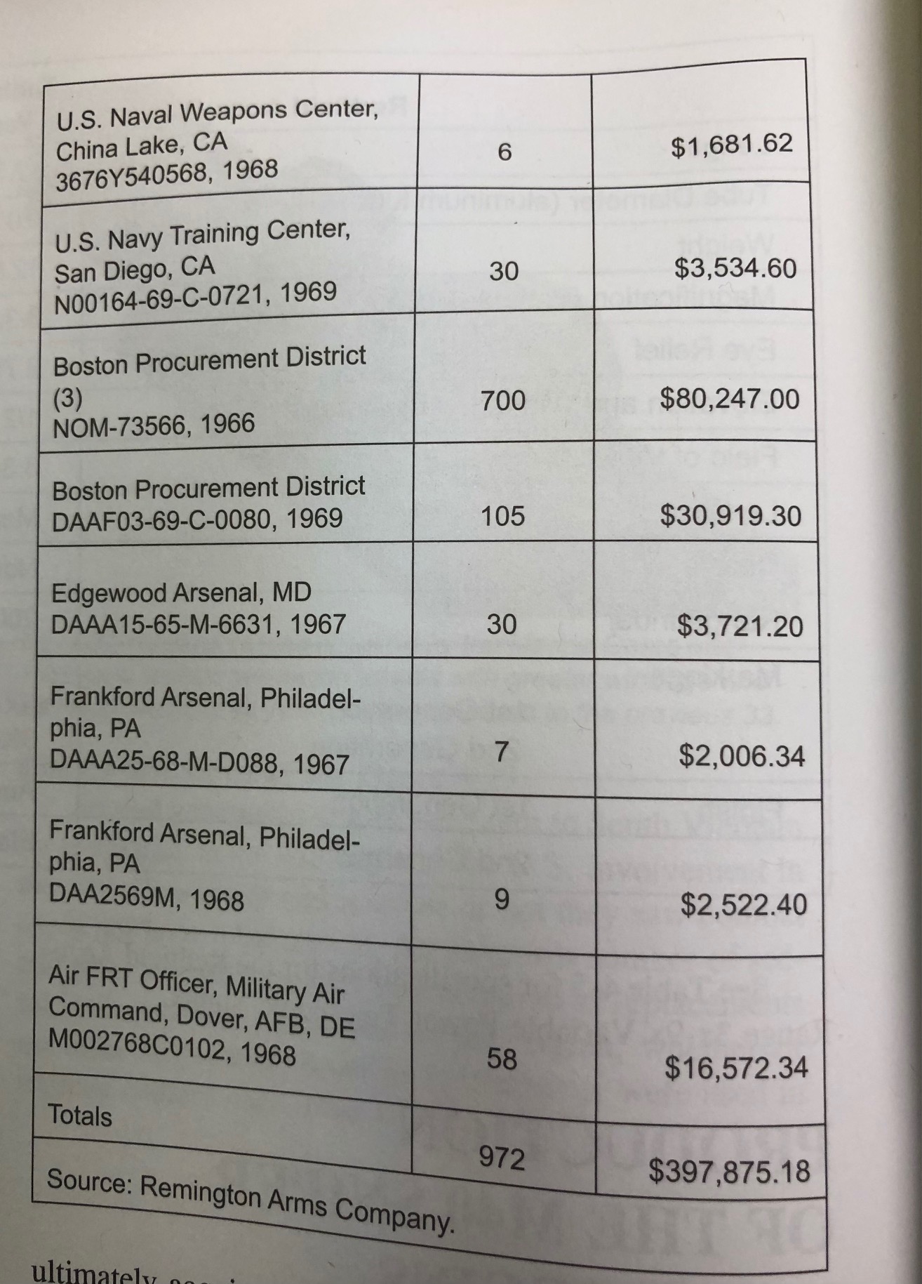

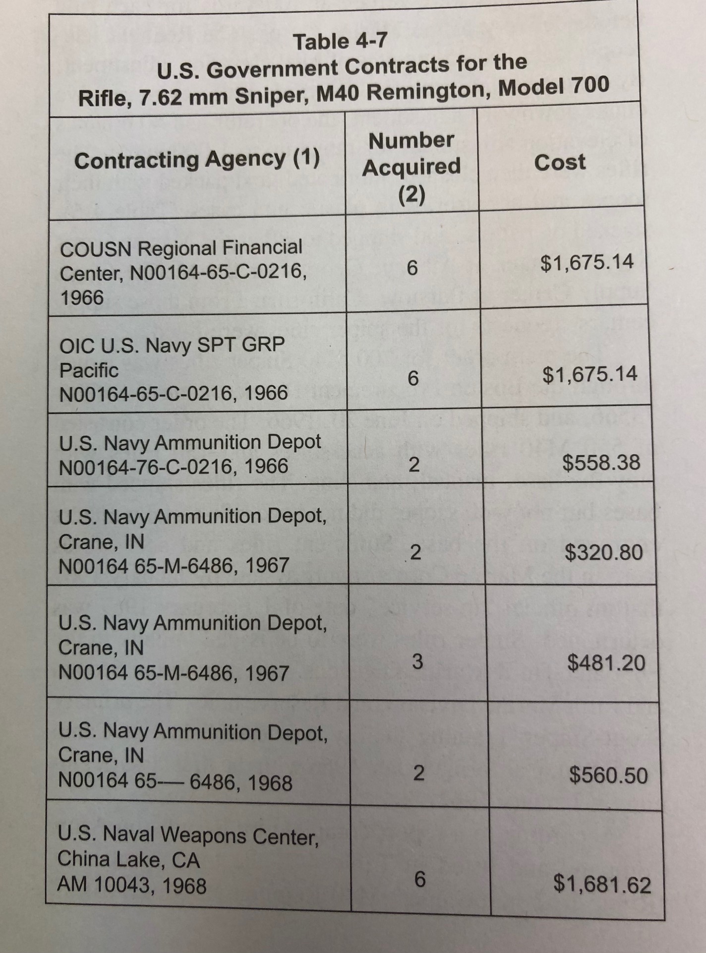

Thanks for the details re your latest acquisition. Given the Remington archival history in Joe Poyer’s book, my guess is both the 221k and 322k rifles were part of the original 1966 order and delivered by late 1966/early 1967, but that is an educated guess. I don’t know how Remington handled any replacement receivers for M40s that came in for rebuild in 1968 that were deemed unserviceable (oxidation/pitting could have been an issue after a hard tour in Vietnam).
The small M40 orders from 1967-1968 do not appear to be for the USMC, but their is a curious order in 1969 out of the Boston Procurement office - which is the entity that handled the original order in 1966 for the original 700 USMC M40 rifles. Not sure where those 105 rifles went, and presumably they were 7 digit rifles in the 6 million range. (Source is Poyers book, data is from archives at Remington Arms Co.):
M40 sniper rifles sold to the US gov't by year:
1966 = 714 (biggest contract was Boston Procurement District for 700 M40s - these are the original USMC rifles. Small contract for 6 rifles each for COUSN Regional Financial District and NAVY SPT GRP Pacific)
1967 = 42 (biggest contract was Edgewood Arsenal, MD for 30 M40 rifles, followed by Frankford Arsenal, PA for 7 M40 rifles)
1968 = 81 (biggest contract was Military Air Command, Dover AFB in Delaware for 58 rifles, followed by Frankford Arsenal, PA for 9 rifles, and US Naval Weapons Center, China Lake, CA for 6 M40s)
1969 = 135 (biggest contract was again Boston Procurement District for 105 M40s (unclear from records who received these), followed by US Navy Training Center in San Diego for 30 M40 rifles)
TOTAL = 972 rifles

Thanks for posting the info, for some reason I kept thinking those were all USMC order dates. Even though the Corps ordered their rifles in 1966, the very first ones to ship to Vietnam was in March 1967. All of my original take-off barrels are dated 1966. It appears that even though the Marines ordered the rifles in 1966, they were being built and delivered over the next 2 years.
I have 2 Remington 700's in the 322xxx serial number range that I'm going to use for M40A1 builds, one of them has an XP barrel code, the other has a BR barrel code. This dates them to December 1967 and January 1968, respectively. Here's a link to the Remington 700 barrel date codes incase anyone here needs to use it: https://www.leeroysramblings.com/Gun Articles/remington_barrel_date_code.html
It appears that the 322xxx rifles were being made at the end of 1967 and into 1968. It now makes sense that this 221xxx receiver could have been in the bottom of a box (first in, last out) and was built with the 322xxx rifles. This would explain the later AR (March 1968) M40 barrel, the 40X base that's engraved exactly the same as the 322xxx bases and the extremely late serial number green Redfield scope. The bolt also appears to be in original condition, had it been refinished the matching serial number engraving wouldn't be in the white. By this time, Remington had also moved from the split sear to the single sear in the trigger. This M40 and both 322xxx rifles have a single sear trigger from the factory.
If it were a rebuild, it would have to be one of the first rifles sent to Vietnam in early to mid 1967, used extensively, sent back to Remington, get rebuilt with new parts from 1968, get sent back to Vietnam, come up as an extra rifle in inventory and then be sent to Camp Pendleton in 1969. I just don't think this is the case, there's a lot of movement in a short period of time, especially when Marines had spare parts and could fix rifles in country. I doubt the armorers in Vietnam would have wasted time trying to force match serial numbers, especially with how often parts would need to be switched out and swapped around.
Assuming that the rifle was shipped to the Corps shortly after it was built, it fits the previous owner's timeline of being in Vietnam and then receiving the rifle at Camp Pendleton when he got back it 1969. That would mean this rifle isn't a rebuild, it's in original condition and it's truly one of a kind! After taking all this into consideration, I'm 99% sure this rifle is a late build and is in it's original configuration. In the off chance that it's a completely rebuilt rifle, that makes it even more interesting, since the receiver would have gone through hell and back in Vietnam! Either way, it's a fucking great rifle and I'm extremely happy to have it in my collection!

ON EDIT: Attached is the info from Poyer's book that appears unique in that it's based on Remington Society of American Archives Research Team's access to the company's archival info. While Joe Poyer's books do contain errors and assumptions re various sniper rifles, nothing in the attached information appears remotely incorrect to me re the M40 rifle. Thus I won't impugn him over his research re the M40 program, nor impugn the Remington Archival Research team who provided Poyer with the attached info. Not even Peter Senich's excellent books contain this type of hyper-specific information on the M40, but on page 161 of 'The One-Round War', Senich notes exactly what Poyer stated about the initial delivery: "Remington completed the 1966 Marine Corps order (700 rifles) that same year (550 rifles with telescope sights, and 150 rifles without telescopes)." The only difference is that Poyer provided the original gov't contract number, and the exact date, that Remington shipped those 700 rifles to the USMC: reportedly June 20, 1966. Just say'n...
Poyer's books are hot garbage, I don't trust anything he writes. For fucks sake, even in his M40 section he talks about the Model 700 having 3 fucking receiver screws, the middle one apparently has something do with accuracy (page 63, top right paragraph if you want to double check). Just say'n...
You say that Senich's books don't contain the "hyper-specific" information on M40 production, but in actuality, Senich had that same info and more. Senich didn't list all the other contracts and the years because it didn't pertain to the 1966 USMC M40 contract, which was his focus. What he did do is talk about the supply contract NOm-73566 (17 May 1966), Senich even had the exact day of the contract recorded. My point is, Senich had that exact info and more and stayed on focus with what he was writing. Additionally, look Poyer's book and add up the contract production per year, then compare it to the production per year in Senich's book. Guess what, the numbers don't match. Seems the only thing they agree on is NOm-73566. We haven't seen the other documents that Senich had, but he put those numbers down for a reason, he isn't known to cut corners on paperwork/documentation and analysis.
You say that "Bottom-line: The auction rifle (and all other USMC 6-digit M40s) were apparently shipped to the USMC on June 20th 1966....," but this is straight up impossible, the 322xxx rifles were made in 1968, not 1966. Coincidentally, neither author talks about the 322xxx rifles being made by Remington. The 322xxx M40's were some of the very last M700's made by Remington in 1968 before the change in serial numbers and started anew in the 62xxxxx range in late 1968. We know for a fact that the Corps had these rifles, 44 serial numbers are listed in DFA vol. 1 and that's only a portion of what they had. This is important because my M40 shows the same scope base engraving as other known 322xxx bases. Interestingly enough, there's a 322xxx shown in Senich's book with the same type of engraving as the previous 221xxx/224xxx rifles. So, another question arises, when/why the change in engraving in the 322xxx range?
You know what, where are the USMC 322xxx orders documented? I don't see them in Senich or Poyer's books. Chandler documents 44 of them, but where's the NOm-xxxxx or whatever the contract would be? The Corps had enough rifles on hand, but still wanted more? We're also assuming that Remington's records are good when they say the built and shipped that number of M40's those years.
If we use the Remington Society's M40 contract lists for 1968, 2 went to Crane, 12 went to China Lake, 9 went to Philadelphia and 58 went to the Air Force. Where are at least 44 USMC M40's in 1968? Did we get them from the Air Force? Also, the 6257xxx rifles that pop up at places like the CMP with 1969 dated barrels, are they from the group of 105 rifles that went to the Boston Procurement District (same place as the original 700 1966 USMC contract)? Are those USMC rifles? If so, where the hell are 105 of them and why have we never seen a single one as an issued A1? The Corps ordered 6257xxx rifles for testing, but I didn't think they'd get that many. I've gone off topic quite a bit with this, my point is that even with this contract information, it's next to useless and it raises more questions than it answers.
You speculate that "my assumption is that Remington serviced/re-built the majority of those rifles due to wear and tear in Vietnam in the 1968-1970ish period. Remington was presumably under contract to fix them for a period of time (probably 5 yrs), hence the issue of only 90 in Vietnam in late 1969, with the majority back in the USA. I presume by the mid-1970s the USMC took over the support of M40 sniper rifles, leading of course to the much more robust M40A1 rifles made by the RTE guys (2112s)."
This is incorrect, the Marines took over the support of the M40 sniper rifles the moment they received them. There were RTE 2112's in each Division in country who specifically worked on sniper rifles, including the M40. They constantly repaired rifles and worked on absolutely everything, except for in country rebarreling for the M40 (according to Senich). So, Remington had absolutely nothing to do with wear and tear in Vietnam, the Marines handled everything and even had spare parts for the rifles (i.e. "adequate supply of spare trigger guards").
As for the 23 serviceable M40's in Vietnam in 1969, Senich addresses that in his book. He states that "both 3d MarDiv and 1st MarDiv personnel tasked with Scout-Sniper "requalification" in mid 1969 have indicated there was "no perceptible shortage" of M700/M40 sniper rifles at that time." So, of the 99 rifles that were sent to Vietnam, 54 were unserviceable and 45 were in the field. Of those 45 rifles, 23 were serviceable and there wasn't an issue with shortages. The Corps also states that these 99 rifles were list as the only 7.62mm USMC sniper rifles "in all of Vietnam" in 1969. This 99 count goes back all the way to February of 1968 (presumably there were less then that throughout 1967 as they were still receiving rifles). Senich thinks there could have been more than the 99 recorded rifles, but it's not going to be a massive swing of numbers. We're probably looking at a discrepancy of a few dozen rifle at the most, seeing as how they were keeping decent records at the time.
23 rifles was still enough for the Marine snipers and they had accountability for pretty much all of the unserviceable rifles. The other 601 M40's we apparently stateside and could be shipped to Vietnam on a moments notice if they were needed. But they weren't, so they weren't. It would be much easier to have a new gun sent to Vietnam then to have one sent to Remington for repair. And from the sound of it, they had accountability of their rifles and didn't send any back stateside
There's the basis for our discussion, is my M40 a Vietnam rebuild or is it an older receiver that was built later on. A 3rd option could be somewhere in the middle, it was brought back from Vietnam and was worked on at the RTE shop. However, that 3rd option still raises various questions about the scope/base markings in the same style as 322xxx bases, the original mint condition bolt with factory serial number (Poyer covered the bolt engraving, but he somehow still got information wrong, so I'll correct it here in this post - the serial number isn't visible with the bolt closed), the highest known serial number greenie and the perfect barrel marking index.
Speaking of barrel marking index, I think I have the only currently known real M40 that was rebuilt at the RTE shop after the Vietnam War, it's Major Dick Culver's rifle. And I've personally talked to the Marine armorer who built it. The barrel isn't indexed at all, they didn't care about the markings, they only cared about headspace. The markings on the rifle are as far off as you can get, they're at the 12 and 6 o'clock positions, lol.
I'll give that gentleman a call when I have time, he served as a 2112 armorer in Vietnam and will have the answers, if he wants to share them. With accountability of rifles in Vietnam and a massive supply of them in the Corps, how often did they even change barrels? Did they even bother with it? Just use a new gun and rebarrel for the A1 program, it sounds like there were enough M40's to just do that. And what happened to the missing 300+ rifles after the war? They sure as hell weren't lost in Vietnam. Probably needed new barrels and just threw them all out! Lol, just joking about this, I doubt that happened.
Anyway, who knows if we'll ever know the answer. I honestly want you to be correct, I would be extremely happy to know that this is a Vietnam rebuild, it would add even more to it's history! But, with the information on hand, it's just easier to assume it was an overrun receiver from the original batch of 700 and was just set aside to be built when a new order came in. Occam's Razor and all that. More research needs to be done, other questions I've asked in this post need answering.
Also, you can stop calling it an auction rifle. It wasn't an auction, it was just for sale in their shop.

The rifle also came with it's original tan Protecto Caddy case, cleaning gear and pamphlets on the rifle and scope. I've only seen copies of the Remington sniper pamphlet in Senich's book. I'm not even sure if he had a copy of it, the documentation is credited to Remington.
I can't believe the rifle came with the Remington pamphlet, I highly doubt many survived, the armorers probably just threw them away. Or they're all still in mint condition stacked neatly next to a pile of 300 missing M40's, lol. Anyways, here it is:
It's not the most exciting thing in the world, but I enjoy seeing original documents.
