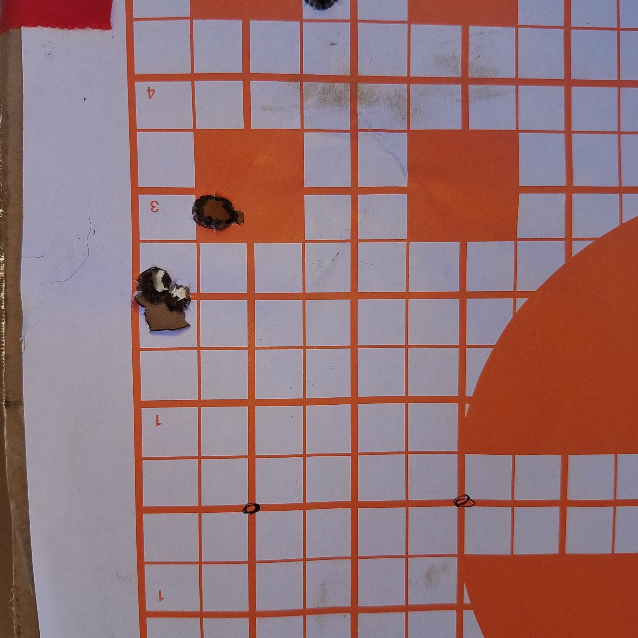

Here is a pic of one of my experiences with mirage. Checking zero @ 100yds prone on a gravel surface. Wind R-L @ 2-3mph. 1st 2 shots just low & L under clouds. Next 3 in the string were just after the sun peeked out & was shining directly on the gravel. Mirage instantly became heavy from what was very light mirage.
