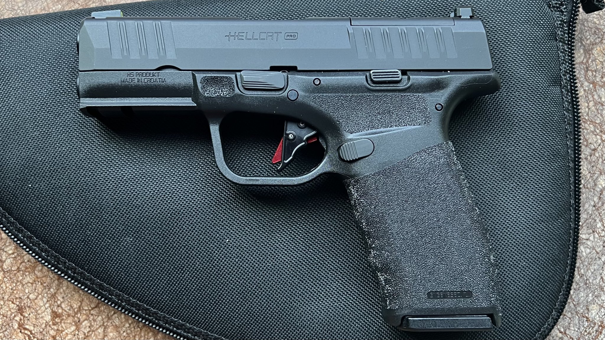

My wife is currently using this trigger in her Hellcat Pro and likes it. She's mostly a 1911/2011 gal, but she has a P365 and the Hellcat Pro for carry. She much prefers the Hellcat with this new trigger.

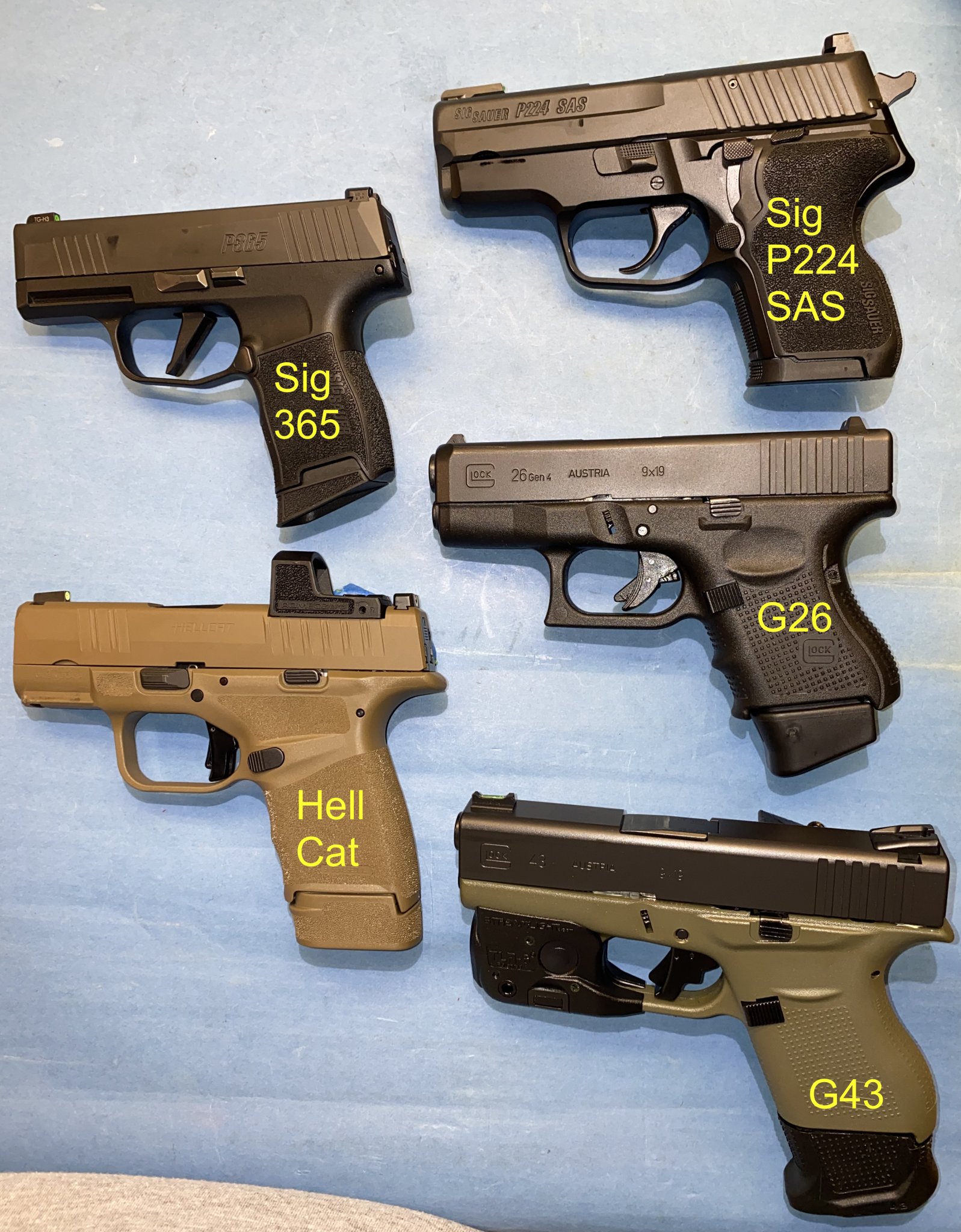

I like the Apex in the standard Hellcat and Glock 43.

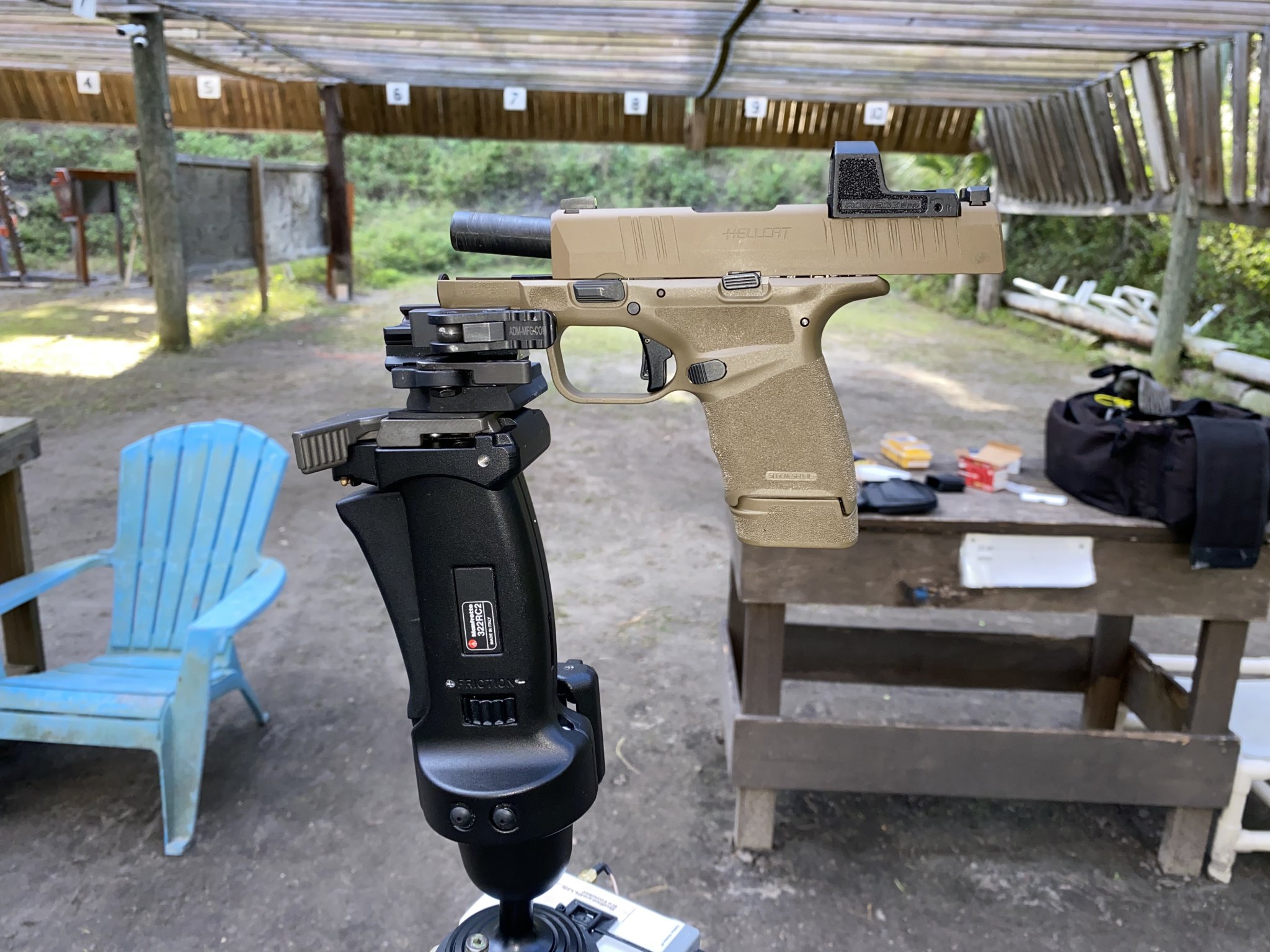

Used Gray Guns flat trigger in the Sig 365.

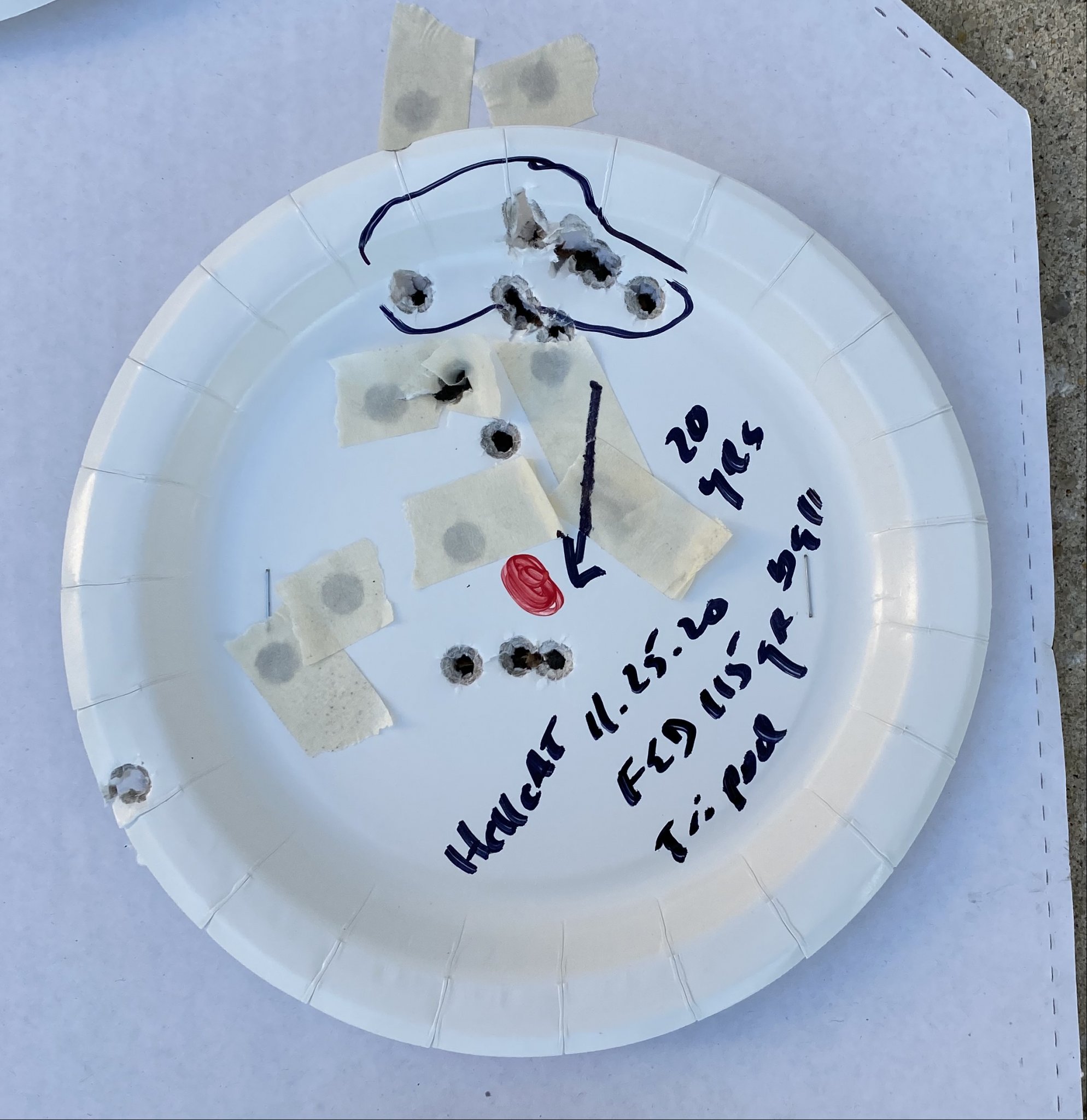

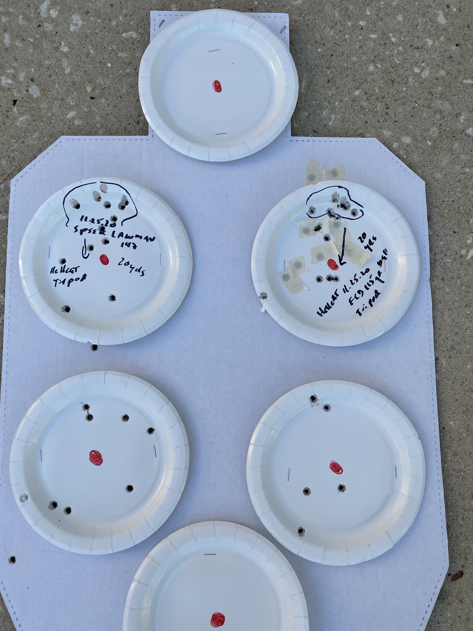

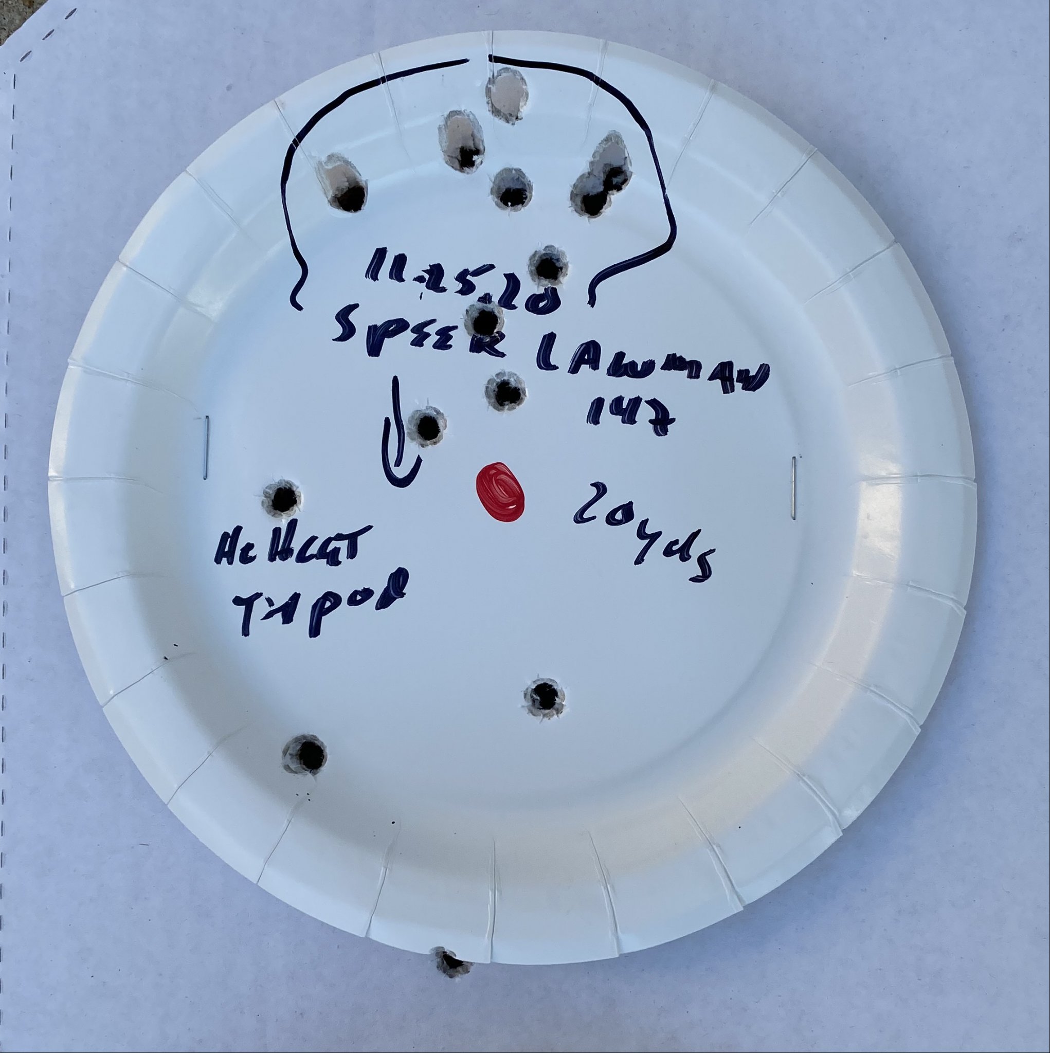

Pleasantly surprised at capability of Hellcat at 20 yard target groups with Romeo Zero optic.
Springfield Armory Hellcat  Apex Trigger QD Mount Romeo Zero Sight In 11.25.20IMG_6995 copy.jpg
Springfield Armory Hellcat  Apex Trigger QD Mount Romeo Zero Sight In 11.25.20IMG_6999 copy.jpg
Springfield Armory Hellcat  Apex Trigger QD Mount Romeo Zero Sight In 11.25.20IMG_7001 copy.jpg
Springfield Armory Hellcat  Apex Trigger QD Mount Romeo Zero Sight In 11.25.20IMG_7002 copy.jpg
