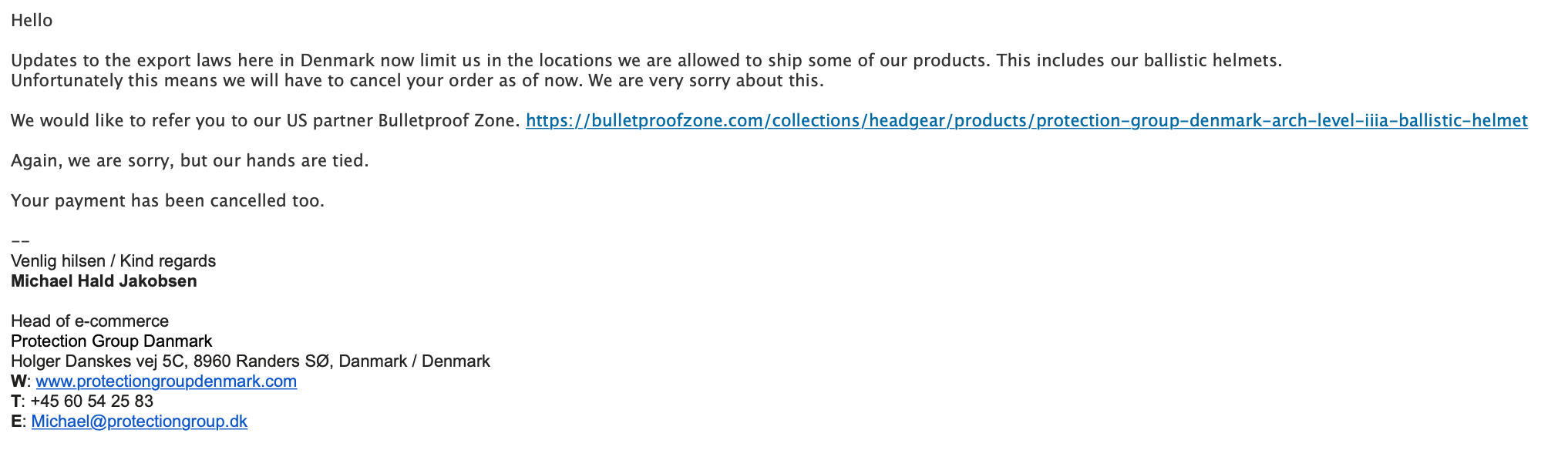

@TheHorta You still think this is the best helmet for the money at $550? It was $411 straight from PGD until they cancelled my order.
Not looking to get shot, maybe I should be looking at bump helmets? Mostly looking for comfort and weight second.
$550 is dubious. At $375 delivered, it was a great deal. Plenty of more local alternatives in that price range.
That’s really odd. I pre-ordered the new Gen3 April 6th straight from them with no issues. Still hasn’t shipped yet.
Interested as to why they are canceling anyones orders.
@zeroz can you screenshot the email? I want to send it to someone who is affiliated with PGD to see whats going on. And could this be an issue with legality in your state?
@PGDJONAS any input on this?

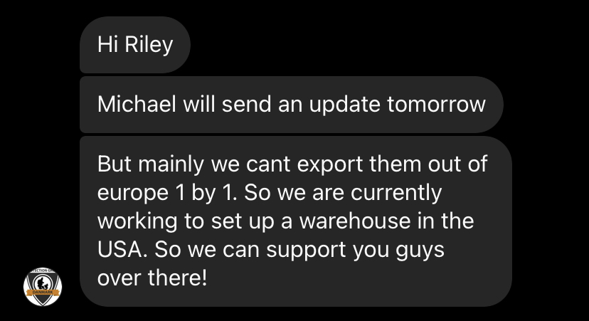

Hopefully it means they are shipping orders that were in. Like I said, I ordered yesterday and got the email and refund today. Hopefully you would have heard from them by now if you arent getting your oder.
Wtf, I wonder what this means for people with outstanding orders.

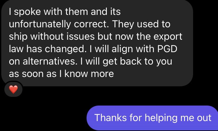

Seems as though they might end up canceling orders. Confirmed by that affiliate that they are having export law issues preventing them from shipping. It may also be tied to fulfilling orders for Ukraine. But I don’t want to sit here and speculate too much.
Slightly disappointed that PGD hasn’t responded to any emails or messages yet, but I’ll give them the benefit of doubt in hopes they are figuring out a way to take care of customers with existing orders. They may try to refer us to the stateside retailers that already have stock of the older Gen2s, but I wouldn’t be interested personally.

It would be interesting to know what the minimum is that they can ship. Then, if we can put a group buy together that meets that number and gets the helmets to our door at a reasonable cost. I'd take the order and ship them out if it makes sense and wasn't an obnoxious hassle.

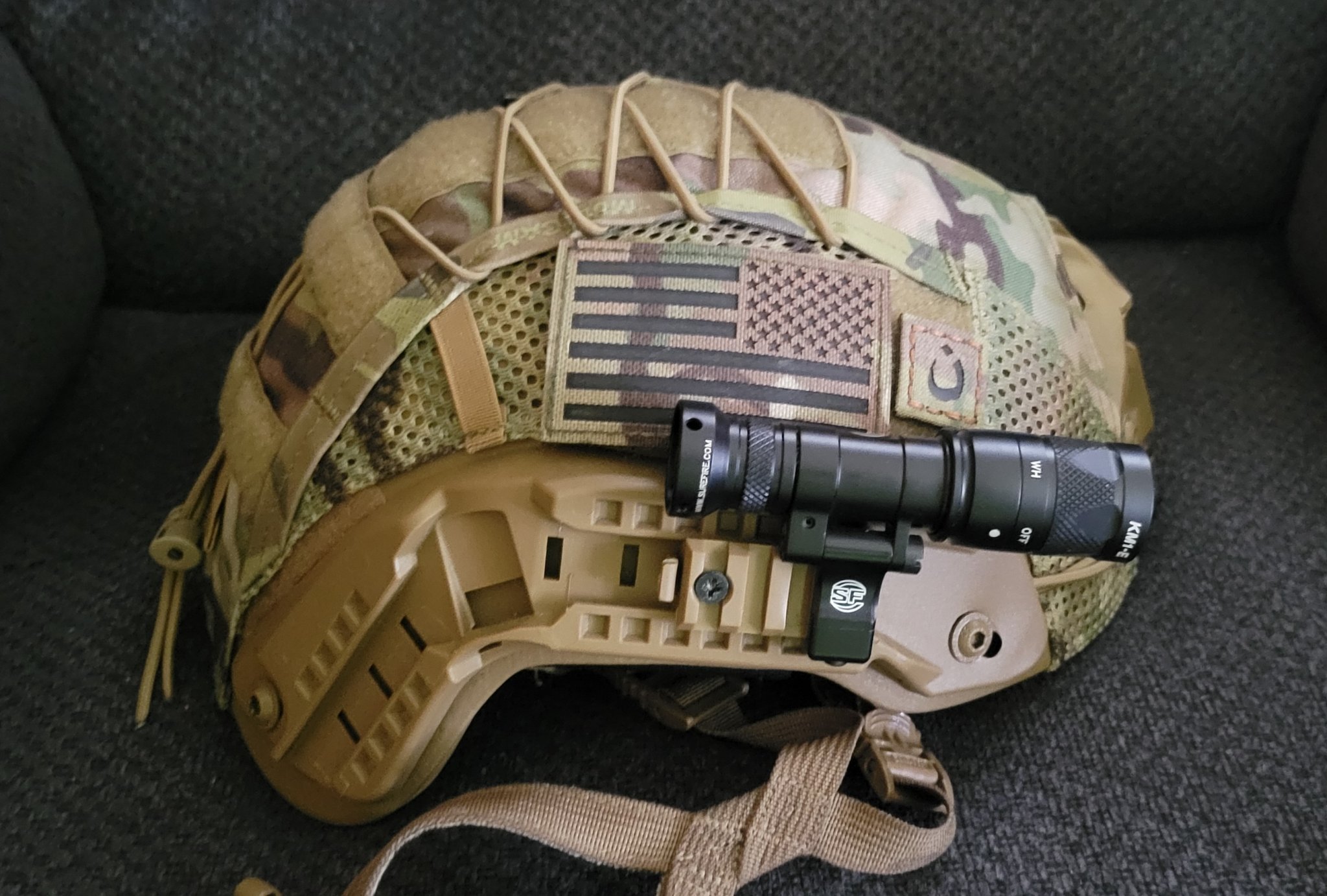

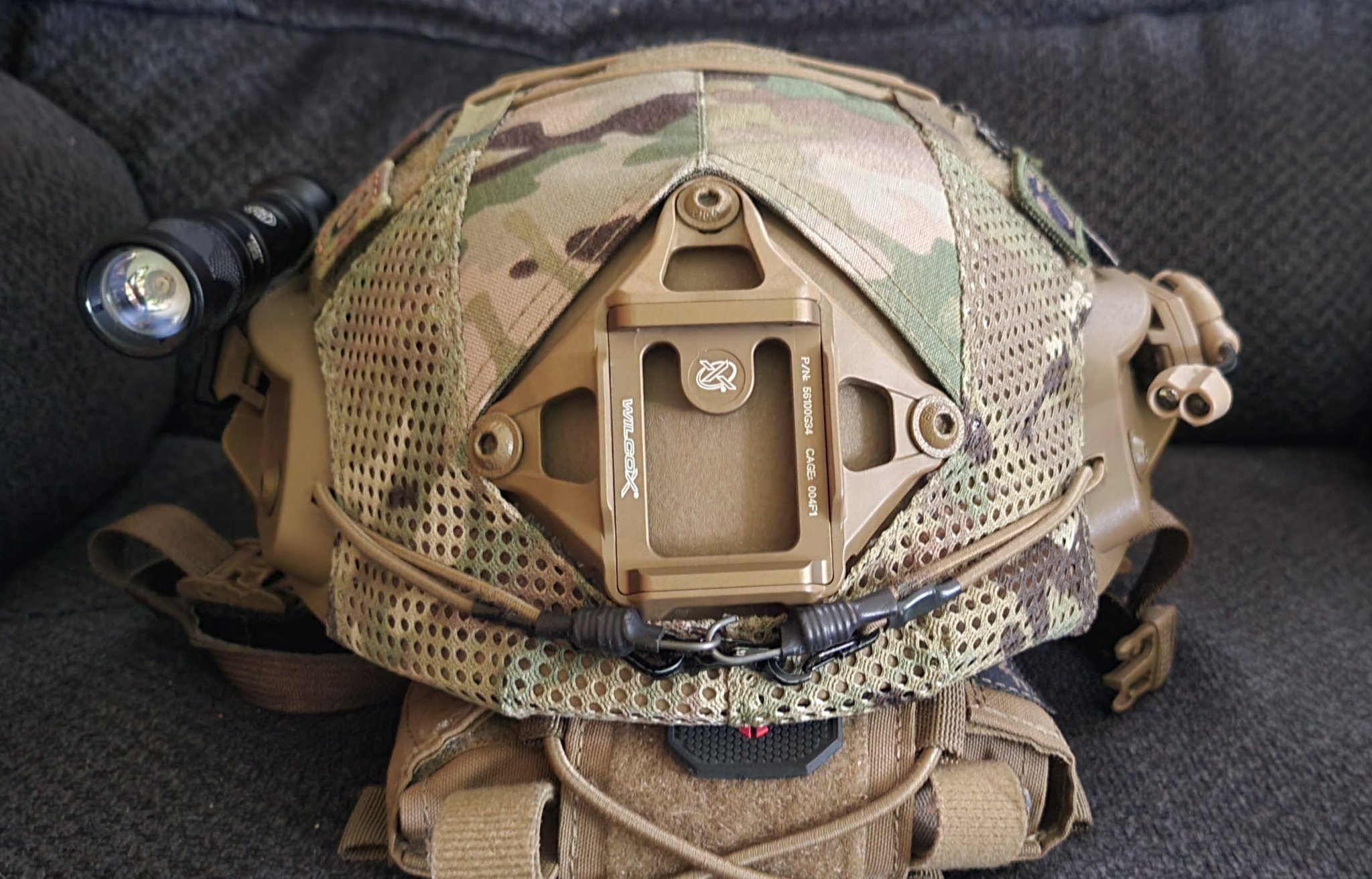

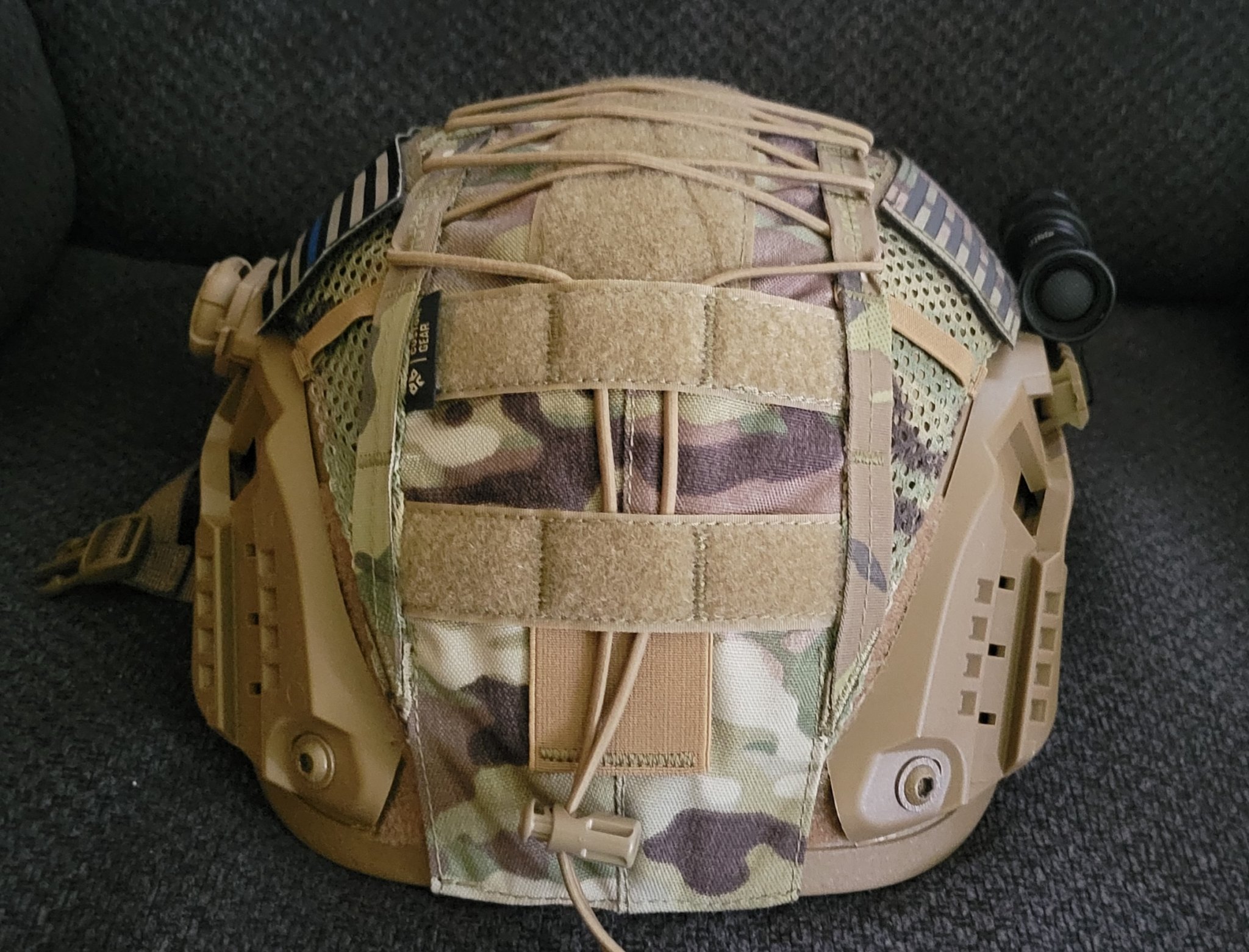

Ok... received my PGD helmet covers from DBR Custom Gear. The stitching is great and as you can see from the pictures it actually fits this helmet.
He hand sews each one to the helmets specs so the waiting time is extreme but the price, after conversion, is the same or less than other companies who advertise an 80% fit.

These are available on bpz For $399 with a 6% code at the home page. By my calc that is tyd for $375.06. I pulled the trigger Sunday and they shipped Monday for arrival on Friday.

Since the PGD Arch only comes in sizes L and XL and the DBR cover only has size 1 and 2 (2 being the larger one), when I ordered I simply assumed
size 1 = PGD size L
size 2 = PGD size XL
I hope I'm not wrong!
Thats what i was going to assume, but they specifically say to not go by the size and measure which is making me cautious.
Which size did you get and what size is your pgd helmet?
My helmet is a large. As per DBR instructions I measured and the closest measurement was the size 1. It fits nearly perfect and I am pleased with the quality. Milo's Grabski, the owner, was great to work with and answered any of my correspondence in a timely and very friendly manner. Hope this helps.

Ok, I heard back from DBR: the website is not fully updated yet, so sizes 1 and 2 seem to be a leftover from the previous versions of the PGD Arch helmet. All you have to tell him when ordering is that the cover is for the latest generation of the Arch helmet and the helmet size (L/XL), then he will make you exactly what you need.
