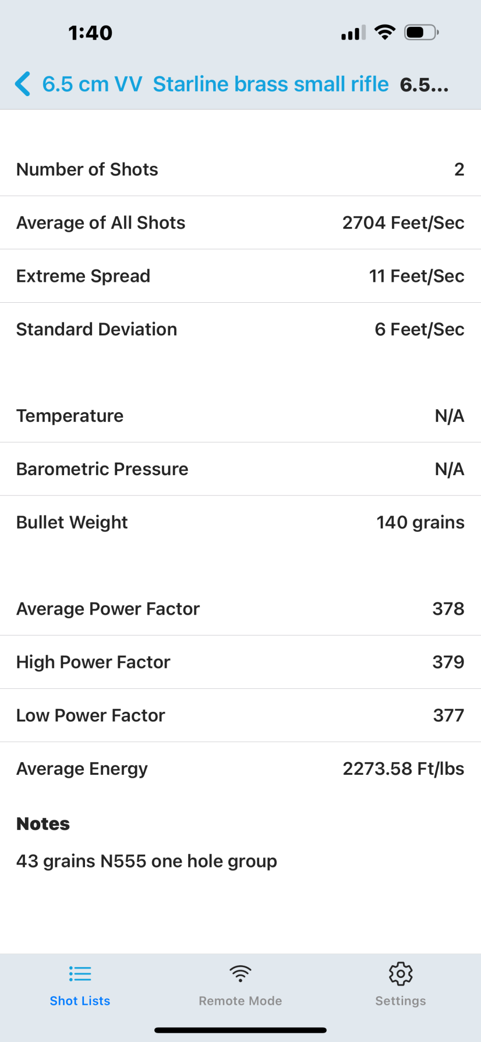

Had some issues with my “ pro”chronograph (maybe pro like 30 years ago)
had two rounds registered
Very accurate in my gun
43 grains 140 match Barns match burners freedom pills
Starline brass .20 off the lands
This was not pushing the load or “hot” by any means
One could go much hotter and most do
As apparently 2800 fps is what most easily attained with a24inch custom gun. I have yet to start to really run it hot, yet EVERY ONE runs there 6.5 cm OVER BOOK POWDER CHARGES.
This charge IS at or above max depending on what ingredients your using in you spells…Make sure you realize I am not suggesting use use this load in your gun and expect not to die

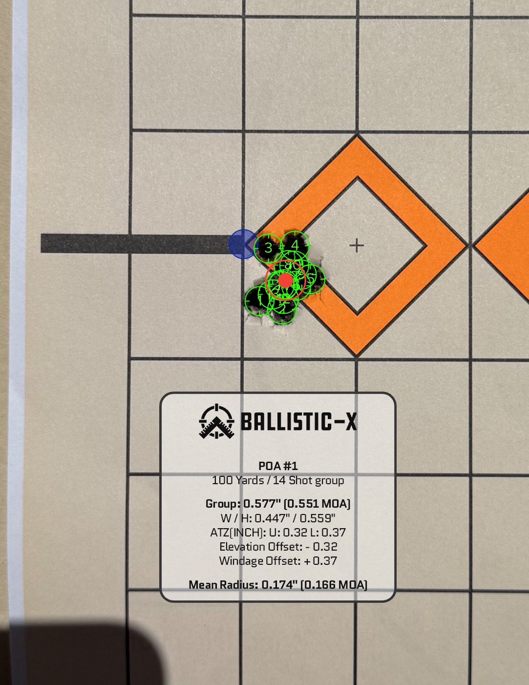

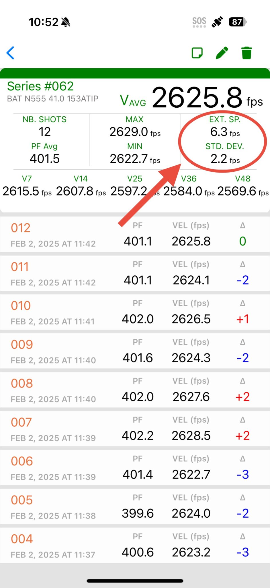

RIFLE: BAT Hammerhead w/ ACE .264 barrel 1-7.5 (26" Barrel from Unknown Munitions)
BULLET: Hornady 153 ATIPs
BRASS: Peterson SRP 6.5 CM
PRIMER: CCI BR4
POWDER: VIHT N555
GRAINS: 41.0
JUMP: 80 thou
It's not with the 140 ELDM's but this might be helpful to someone.
