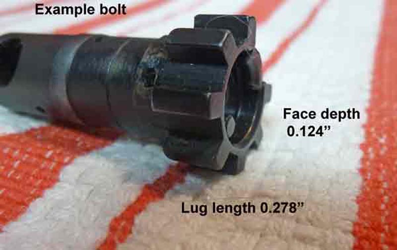

One other comment about headspace. Measure the headspace critical dimensions of your bolt.
If you ever need to replace it you can compare those measurements to the new bolt.
I have several in both 5.56 bolt head and .224V bolt head size (for 22 Nosler brass and for 6mm Hagar/22Nosgar brass).
I'm lucky that the depth and lug are the same length for both rifles.

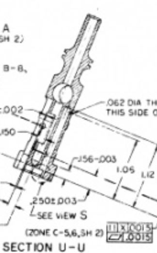

The AR15 drawing for 5.56, and copied to the most part for the 6.8SPC/224V (6mmHAGAR/NOSGAR) gives a somewhat narrow range for bolt headspace contribution.
I don't have a bolt that is more than 0.0005" from 0.154", bolt face to rear of lugs.
Drawing range is 0.156" -0.003, or 0.156 to 0.153
This is NOT the same as the 0.136" bolt face dimension often quoted for the 6.5G/6ARC.
I carry an extra .154 bolt in both case head types and pins for matches, just in case.
My "guess" is most quality bolts will be somewhere near the middle of this range. Is that what you get when you get an accuracy guaranty from a barrel maker but ONLY if you buy their JP bolt? What is the measurement range for a JP bolt?
Do bargain bin bolts fall outside this range?

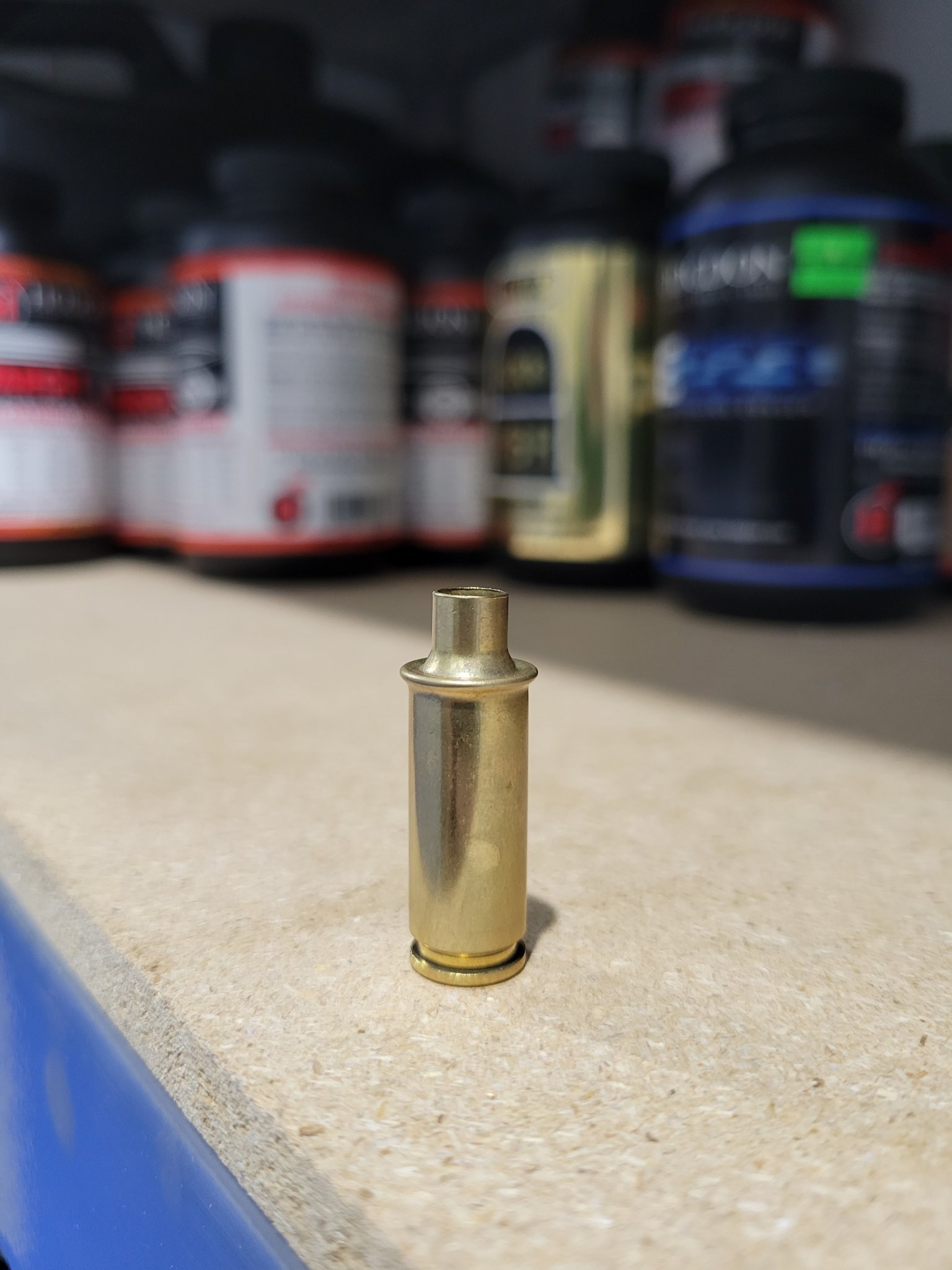

For comedic relief, I made this neat ornament when I switched from seating 108 ELD to 58 VMax in the 6mm...View attachment 7972829
That's a 6mm George Jetson.😂

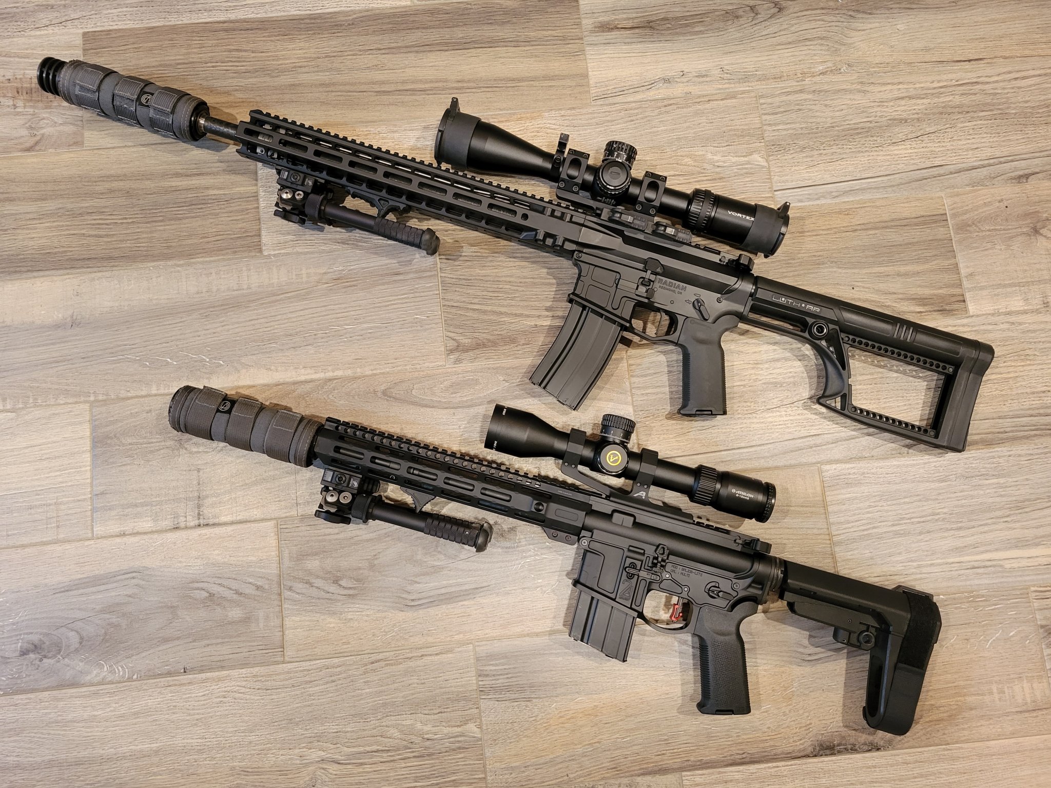

Goal with the ARC was to replace my Grendels while adding a 6mm to the stable as I didn't yet have one. Since I live and shoot in Utah and surrounding areas, temperature swings are huge and I dislike temp instability. As a result, I've tested more temp stable powders - xbr8208 and Varget, specifically.
105 Hybrids over 26.8 Varget for 2564 fps and SD 14, .545" @ 100 (5 shots)
108 ELDM over 26.8 Varget for 2540 fps and SD 6, .497" @ 100 (5 shots)
I shoot the same loads out of the 12.5" ARC to 800+ with great success (5 for 5 of full size IPSC at 825).

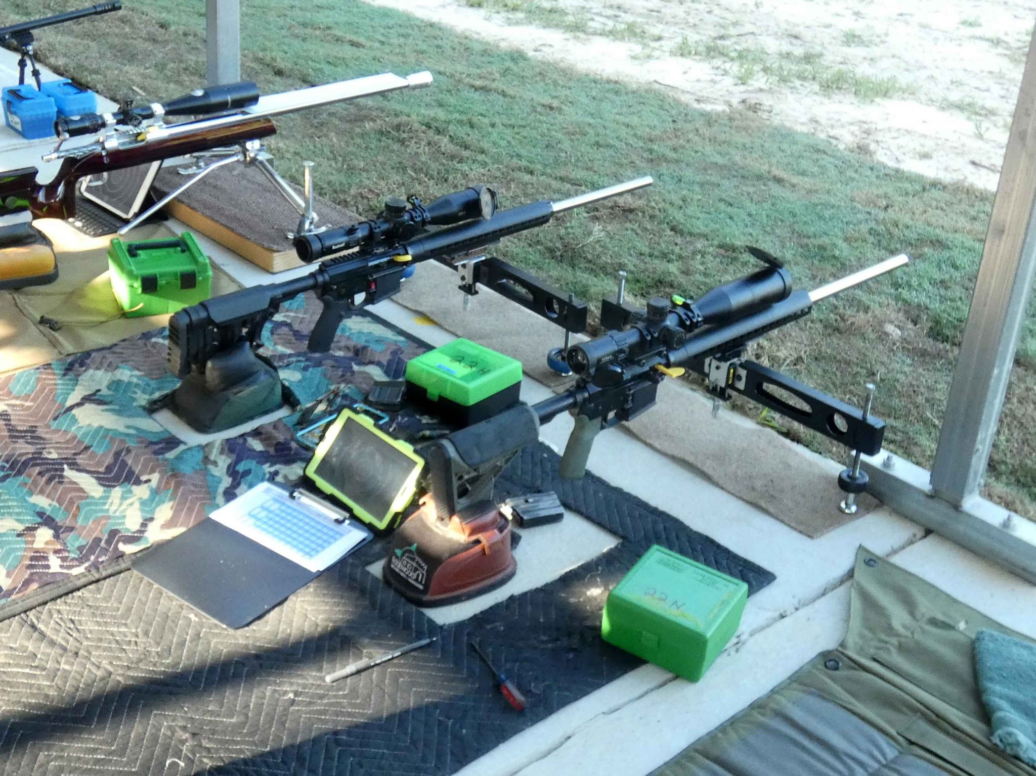

Our rifles, hers is a little less than 20 pounds (with the bipod) and mine just a little over (more lead).

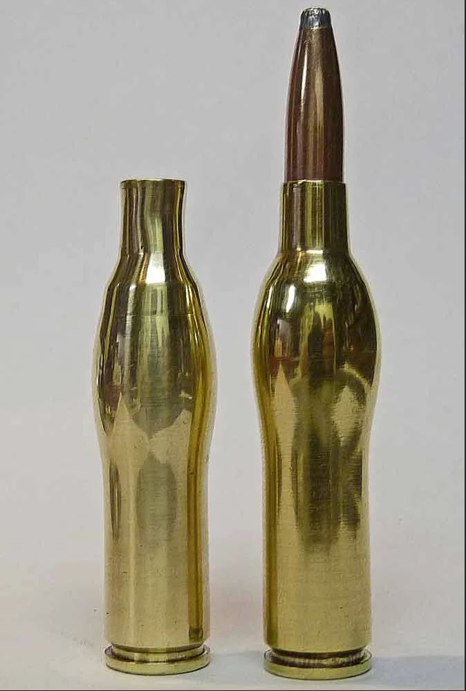

and since you showed one of your 'ornaments' here area couple of hydraulically deprimed 6.5x55 Swede Berdan primed cases for the wife's other
little girl gun :)

Our rifles;
That F-Class barrel is artillery! Gorgeous rifles. You need to come to our neck of the woods to stretch their legs. We typically set up steel at 600, 1000, 1200, and 1800 yards when we head out.
little girl gun :)
Ha! Like a lava lamp!
