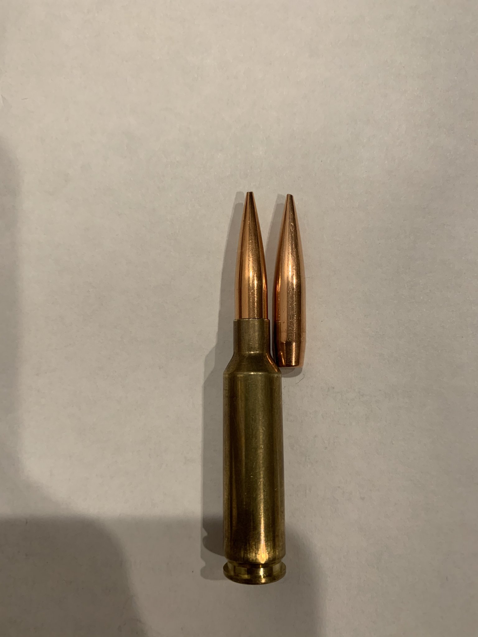

Thanks guys, really appreciate the help. This is driving me nuts.
The reloads:
140ELD-M
Lapua SRP brass
Fed 205M
H4350
the factory Berger are:
140 Hybrid Target

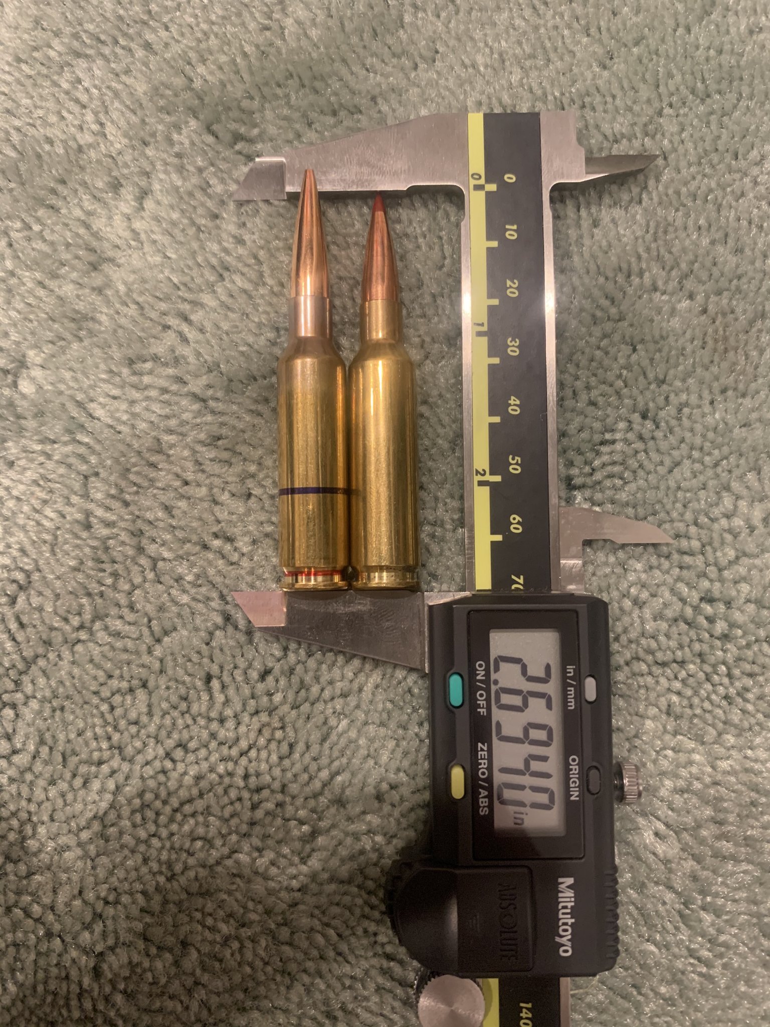

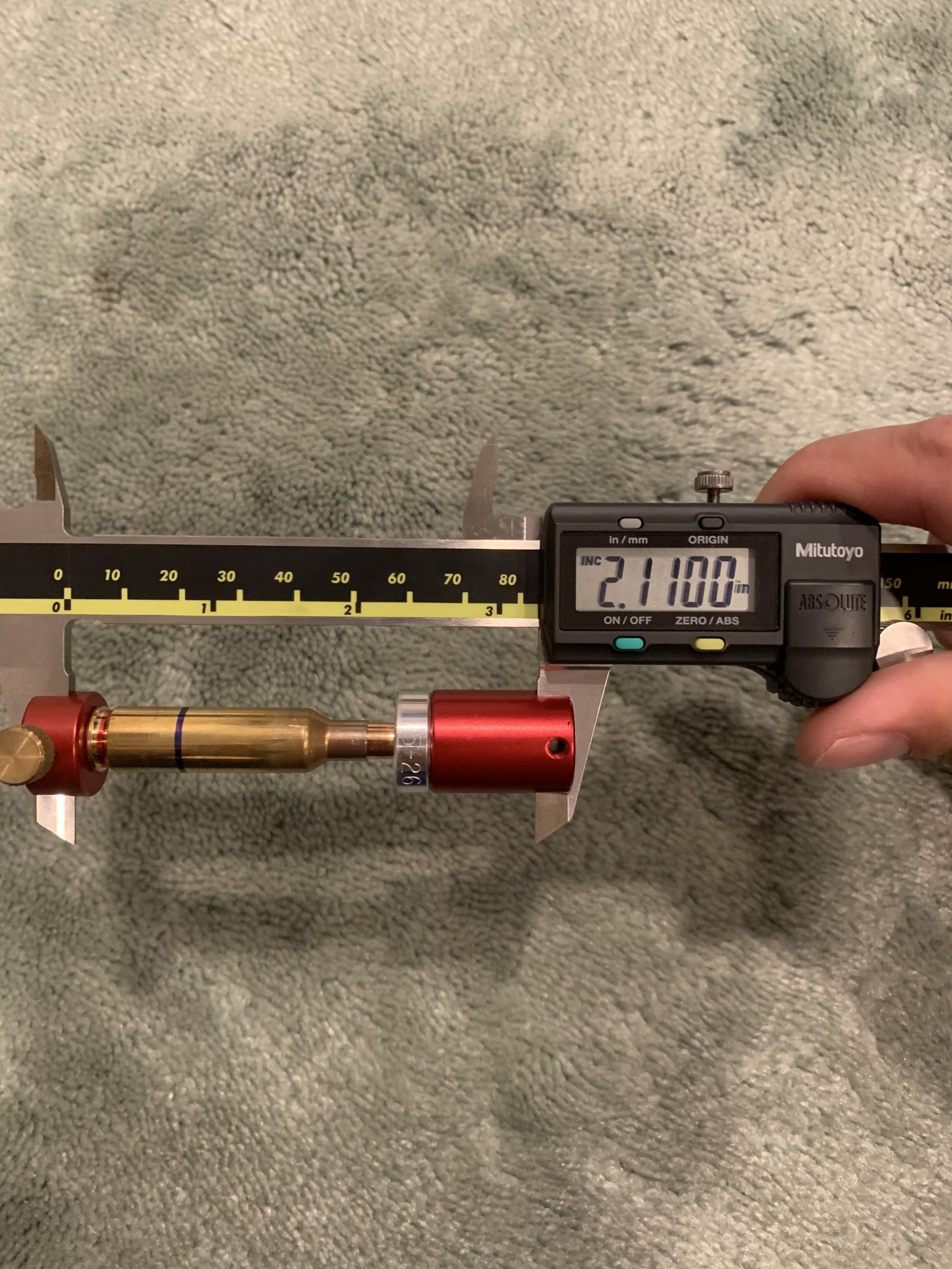

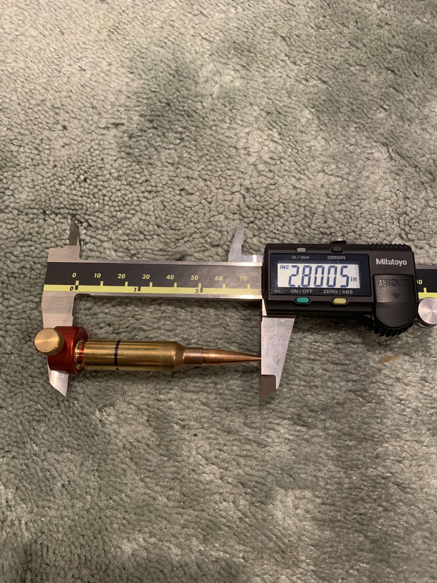

The factory ammo measures 2.110” length to ogive.
COAL is 2.800”
Length to Ogive is measured with a Hornady 5-26 Comparator

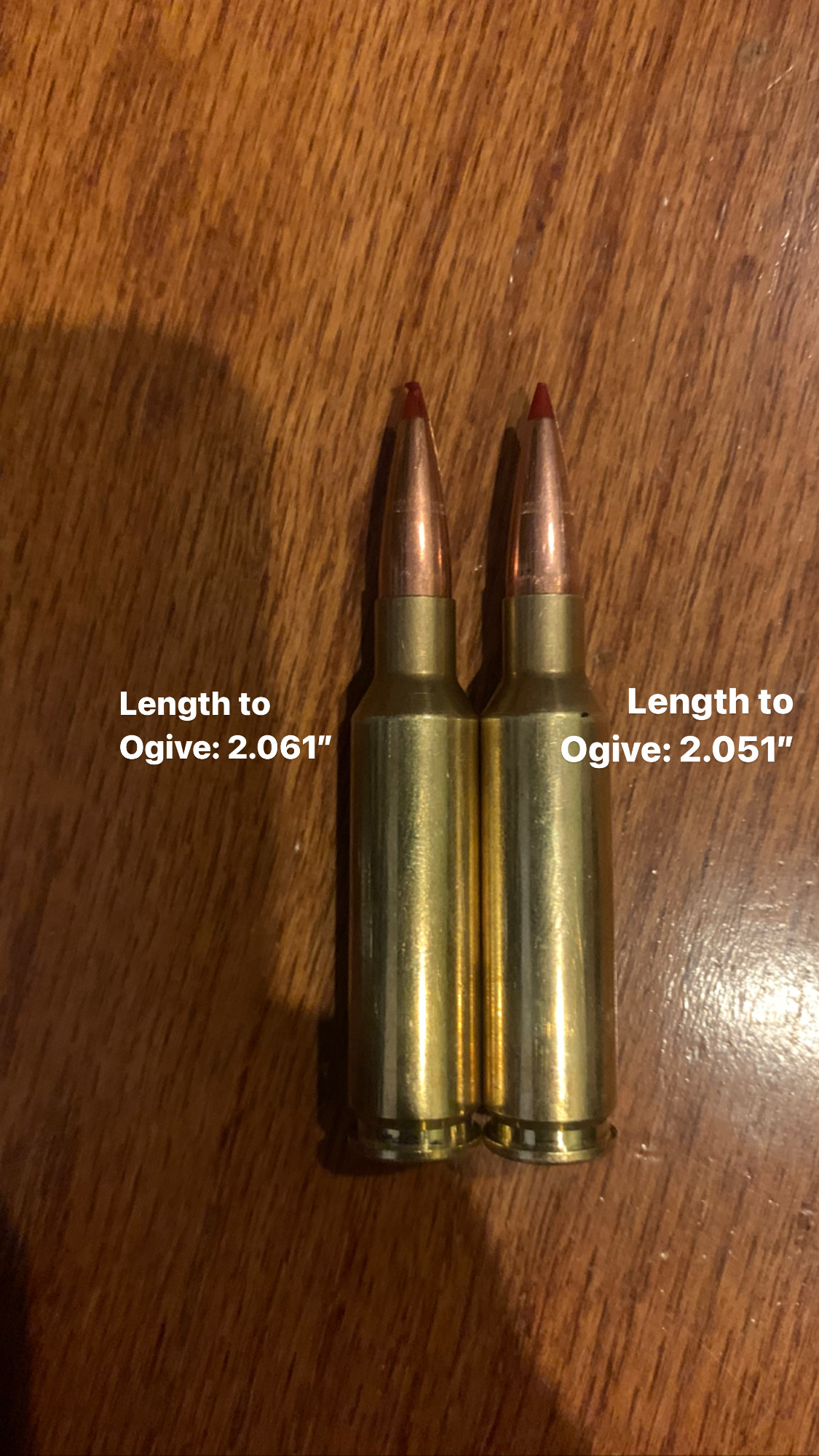

So update:
I shot a match yesterday and one of the more experienced shooters there took a look at it and helped me out. Determined that it’s slightly pushing on the lands.
Today I pulled the ejector and firing pin and kept seating a bullet deeper and deeper until the bolt fell without any resistance. This measurement using the Hornady Comparator (5-26) came out to 2.081”. I repeated this with 3 bullets, and with bullets seated at 2.081”,the bolt would fall. 2.083”, it would hang up.
Perfect, I crank my die to seat it at 2.061” and reseat 5 bullets that I had previously loaded. Measure them all after and they’re all between 2.060”-2.062”.
4 close fine, but the 5th one does not. It stops with the bolt almost closed.
That’s not good, so I try it again with another 5. All seated where I want them, but 1 out of the 5 does the same thing. So I turn my die to seat 0.010” deeper. Check the measurement and it’s seated at 2.051” with the comparator. It still hangs up and I can feel pressure closing the bolt.
The others seated 0.030” farther out (2.081”) let’s the bolt drop. In fact it even bounces at the bottom. Same thing with the others seated at 2.061”. Any ideas why this one that measures 2.051” is getting stuck?

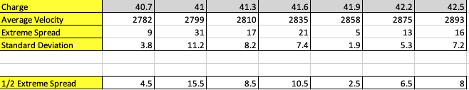

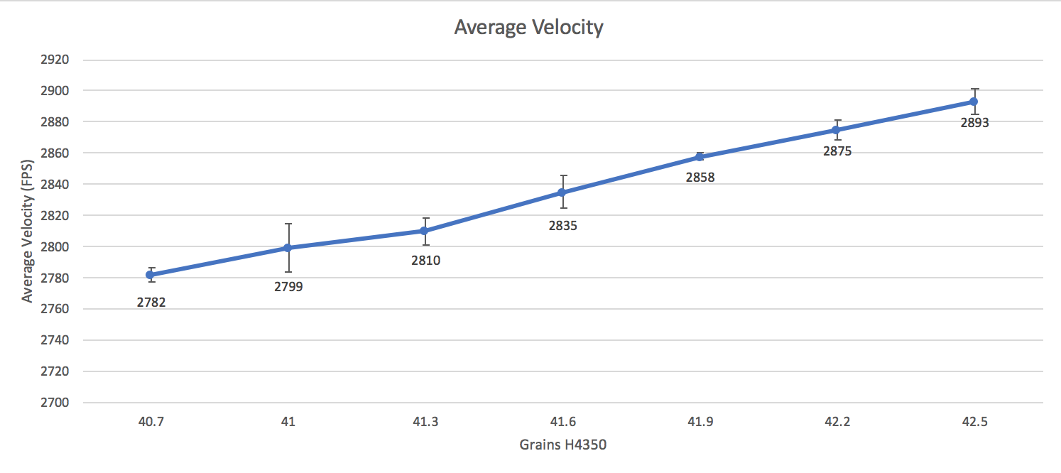

So today I took my newly finished loads with the Berger 140 Hybrid Targets out and performed the same test as last time, but varying from 40.7-42.5. All groups were shot at 100yds, 5 shot groups,
Load:
H4350
Lapua Brass
Fed 205M

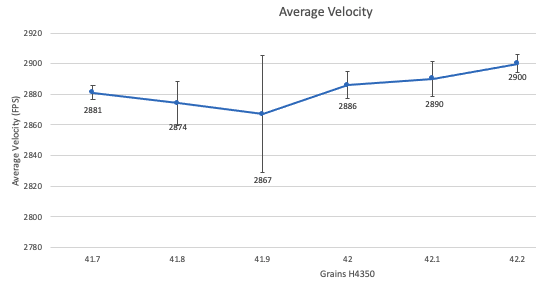

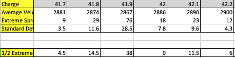

Also note, that the ES for 42.2 would have been tighter had it not been for the last shot(2876, 2874, 2870, 2870, and 2883).

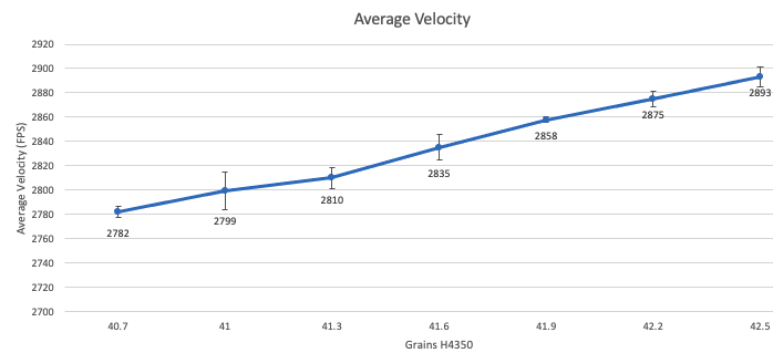

The error bars show the ES spread of each of the loads. It seems like the nodes that I noticed last time seemed to have shifted down 0.3 grains from switching from the ELDM to the Berger Hybrid. In fact, the good 41.0 load had the highest ES spread of them all this time. Wasn't expecting the nodes to shift so much when switching bullets of the same weight.

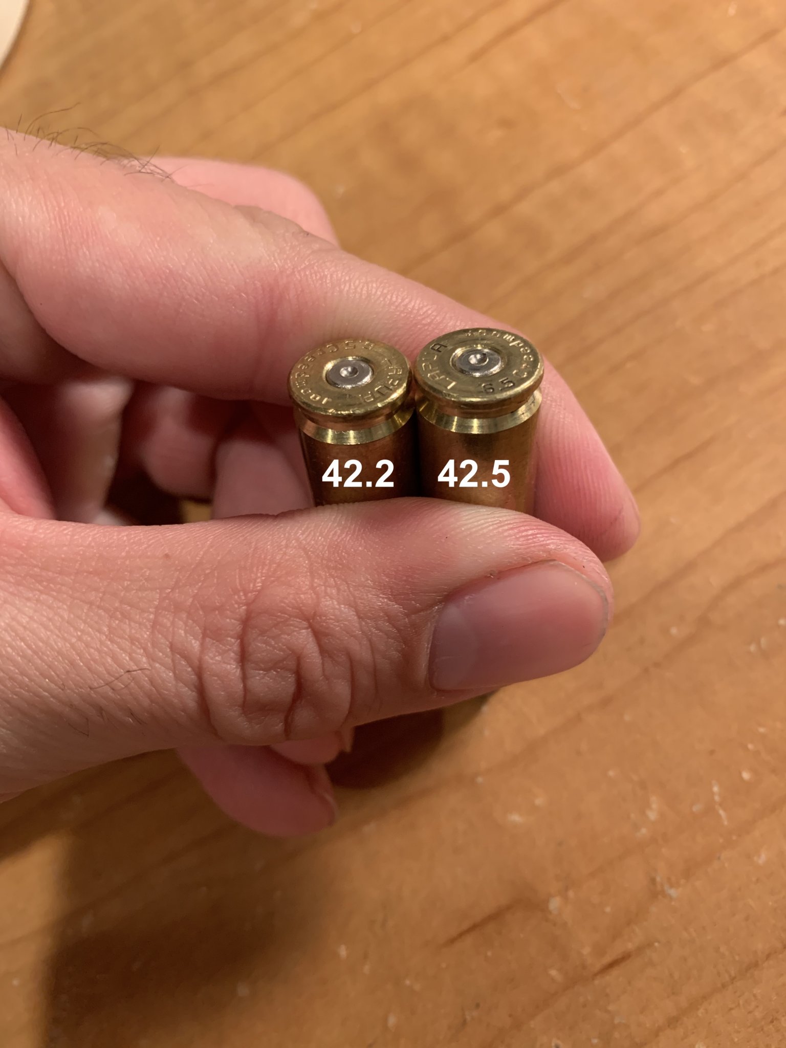

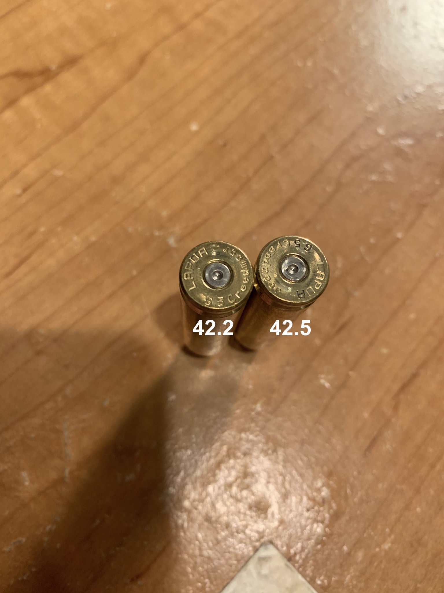

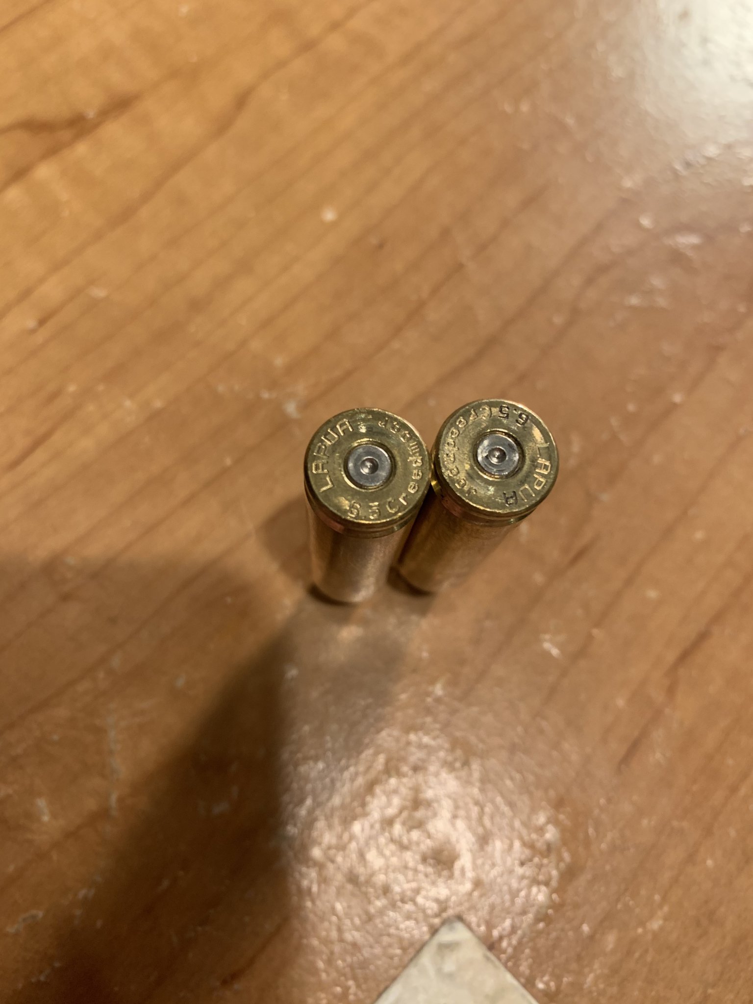

I did also start to notice a little ejector swipe at 42.2 and 42.5. The left is 42.2 and the right is 42.5.
I showed it to the RSO the 42.2 and he said he thinks it's fine. The ejector marks are very slight, and the primers are still round. I tried to capture an image of both. What does the Hide think? any input? Tempted to try and chase the group around 41.9-42.2 due to the low ES and good accuracy

I like the sound of 42.0gr for your loading. ES is good from 41.9-42.2 and 42.5 does look a little hot, so using 42 is in the middle-ish and looks good. Worth testing more for sure

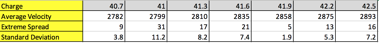

I told you that I would treat 42.2 as max because of that exact reason back here:
Primer is noticably flatter at 41.9
42.5 has an obvious ejector imprint.
I would treat 42.2 as a max charge.
Your hard seating issue with that one round was either headspace difference, or you have a tight neck and that piece had thicker brass in the neck. Though it looks like you got that squared away.
Good, safe, tunable nodes often show up between 2% and 1% off max.
42.2 grains x .98 = 41.3 grains
42.2 grains x .99 = 41.8 grains
Your targets above illustrate this exactly. 41.3-41.9 is where I would be, with some seating depth tweaking to bring the groups into a round shape.
I'd be all over 42.0 with the knowledge that I could throw it rather than weigh each charge if I were pressed for time.

Alright guys,
I could use a little more advice. I loaded some more rounds 3 1/2 months ago, and finally got around to shooting them all. They are all seated at the same depth. What I'm wondering is why I got dramatically different results from my last test in regard to ES, SD, and velocity. Any ideas?
It seems a lot worse than what I was achieving before. Here's the wider test I ran when I was loading them and firing them within a few days
I followed the same procedure when loading
Was it virgin brass last time? How many rds on barrel the first time compared to now? Same lot of powder? 100% percent sure u did same thing. And if they were reloaded and sat for awhile your es could be affected by that
So what I did was I bought 600 of the same lot of Berger Ammo, shot about 200, then started attempting to reload while shooting the remainder 400 in PRS comps. So all the brass I used last time and this time were all once fired, cleaned, and trimmed at the same time.
So I had 200 once fired brass that were primed and ready to go. Loaded the first test, shot within a few days. A couple weeks later loaded the next set from the once fired brass, but didn't shot them since work got crazy and been shooting in the comps. Between the first test, and last test, probably close to 300ish rounds of the Berger factory rounds
I would try it again and see what u get . Or pick a velocity u want to run bullet at then run seating depth test for groups
Ya, I'm trying to decide what to do now. Limited time to shoot and only have 35 rounds left of factory ammo. Next match is in a week and a half, so I might take tomorrow off to reload and shoot
