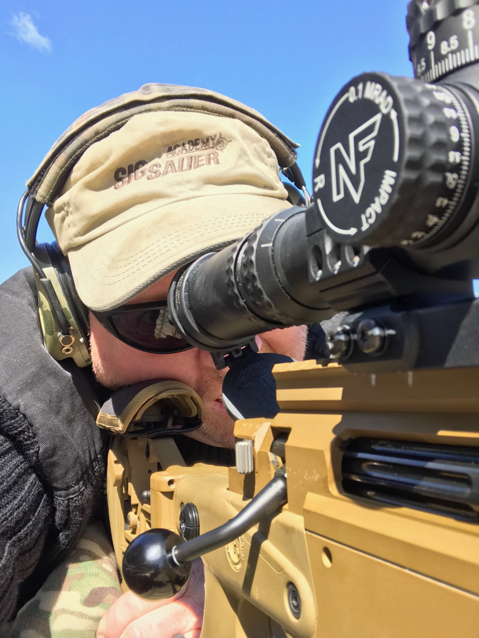

Hey guys, really looking for some feedback and help here.
So I have a new AI AXMC in .338 Lapua, picked it up in March, while the snow was still on the ground here, so had limited time to shoot it prone.
Did get behind the gun in the house multiple times, to verify and set up optic and LOP, and did some bench rest stuff (all my local rifle club allows) but my first real time shooting prone was last weekend. I was disappointed with my comfort level on the gun. I've set up a number of bolt guns before, mix of fixed stock and chassis and usually am good to go, but this one has me stumped.
Details
AI AXMC
Nightforce 7-35 F1 ATACR optic
Sphur 4002 1.5" mount
I just could not get a fittment that was natural, felt comfortable, allowed me consistent eye box on the optic, that did not have some shadow around it. I moved the mounts on the pic rail back one notch, a little better, but still did not have the perfect view I'm used to, the eye box felt very, very small, high mag, I get it, but it almost unusable.
I usually test these on the highest mag setting, so it was on 35, but even on lower setting, I found myself "fidgeting" on the rifle, making myself move to see, rather than naturally having the scope just be there.
Prone position photo attached for reference, ignore sunglasses.

You might try raising the whole rifle off the ground more. In other words lengthen the bipod legs and adjust the rear bag as needed.
That is exactly my thought. It seems like you are twisting your neck to get down you the rifle. If the bipod you have on won't accommodate much adjustment take three 2x4's with you next time you shoot and see if you are noticeably more comfortable at any combination of height.
See how high this guy has the rifle. If you are bigger than him you need to have it higher.
I think you gents are into something here.
Got back on my SSG-3000, like a glove.
Got onto the AI, realized I was looking angled through the glass. Moved the Harris bipod up to 6 notches, much better. I’m running the Harris BRM-S 6-9” but it just maybe too low. I’m going to take the outside tomorrow and will report back. ?
The AX with the tubular forend lets you mount the bipod pretty close to the bore axis of the barrel. That means your bipod will likely have to be adjusted out longer than you’re used to on a traditional stock rifle in order to get the same height of the butt stock in your shoulder.
Reactions: leftyk82
from the pic shtrrdy is on to it.
from the pic you look like a bigger guy.
the rifle is "below you" even the butt pad loos like its low on the shoulder.
bring the whole thing up a few inches.
also i may get flagged for this but not everybody can be directly behind the rifle. ive found that thinner guys have no trouble staying strait behind but if you hit they gym and have a bigger neck and shoulders, strait behind just doesnt work well at times
try this for a natural point of aim test.
get the rifle set up and on target, close you eyes and count to 30.
if you open you eyes and you are not in the exact same spot you are fighting in your position.
Reactions: Monk Medic
Here's the fix, finished it up tonight at the range, then confirmed at driveway of my home, just before the rain washed everything away.
1) Brought the rifle up on the bipod, head not craned down, wow what a difference.
2) Got on the gun, closed my eyes as BrianF suggested, opened, played with LOP and comb until the rifle was comfortable to me, now very much so, could fall asleep on it. LOP is set all the way in, feels good and I can pull the rifle right into my body for recoil control and stability. NOPA rules.
3) Moved scope forward, two rail slots. Wow, field of view opened up, set it up on max mag to confirm, tried forward and back, it is in the ideal spot.
4) Marked all the settings with Sharpie, just in case I need to tweak/adjust, but pretty sure when I hit the range again this weekend, it will be like night and day.
Many, many thanks to those who took the time to enthusiastically answer my questions, and point me in the right direction.
The adjustment abilities of the AI stock are amazing, but unlike my SIG SSG chassis, take some time to really understand and set up.
