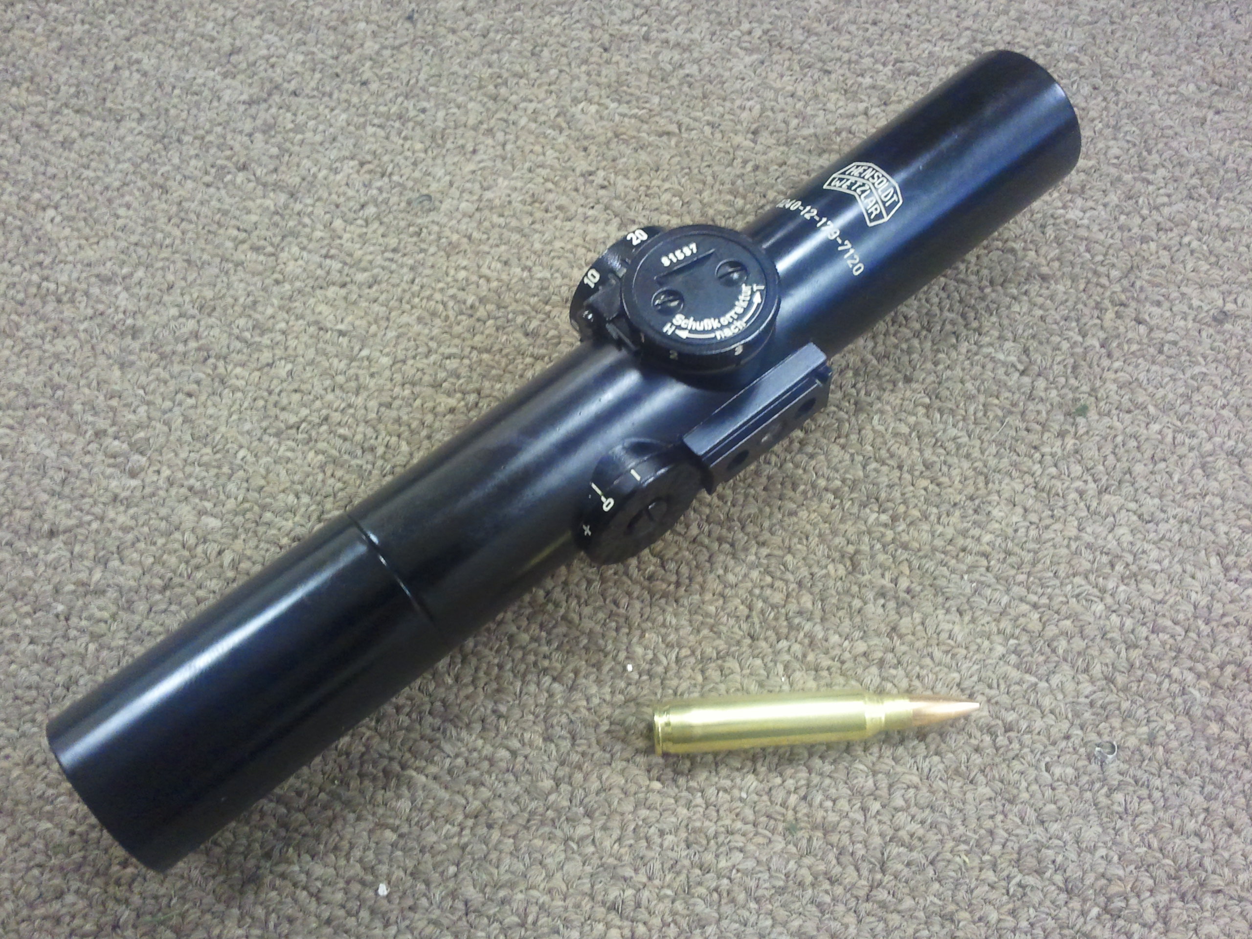

If Uncle Sugar would send me humping an M4 into some war zone, I would bet my life on what the German Bundeswehr issued to mountain ranger marksmen during my service days - Hensoldt Fero Z24. Very compact, bomb proof, and of legendary optical and mechanical quality. Available with BDC drums for both 5.56 and 7.62 NATO. There is a reason why used, surplussed Z24 scope still fetch between $500 and $700 on ebay.
The magnification is "only" 4x but the extreme clarity and optical resolution will easily outperform the capabilities of a service rifle. Keep in mind that your effective range is limited by what you mount the scope on. You are not carrying an M24. If you get better than 3 MOA out of your gun and ammo combo, consider yourself lucky.
The Z24 was issued in 3 generations:
1st: straight tube, diopter adjustment, no reticle illumination, solid posts.
2nd: straight tube, diopter adjustment, QD interface for reticle illuminator, sceletonized posts.
3rd: belled tube, NO diopter adjustment, QD interface for reticle illuminator, sceletonized posts.
The attached picture shows a 2nd gen Z24 with a 5.56 round for size comparison.
ARMS makes a QD mount for the STANAG feet of the Z24 and they have revised their QD levers to be adjustable for off-spec picatinny rails.
Add to this some sturdy, canted backup/CQB irons and you are set.
If that is something you would consider, I could shoot the same setup in the upcoming Mason Dixon Sniper match and report the results. Of course, my barrel and ammo is a bit better than GI grade but we would have a good idea about what engagements are feasible. (I am shooting this match to learn and don't care about the final ranking.)

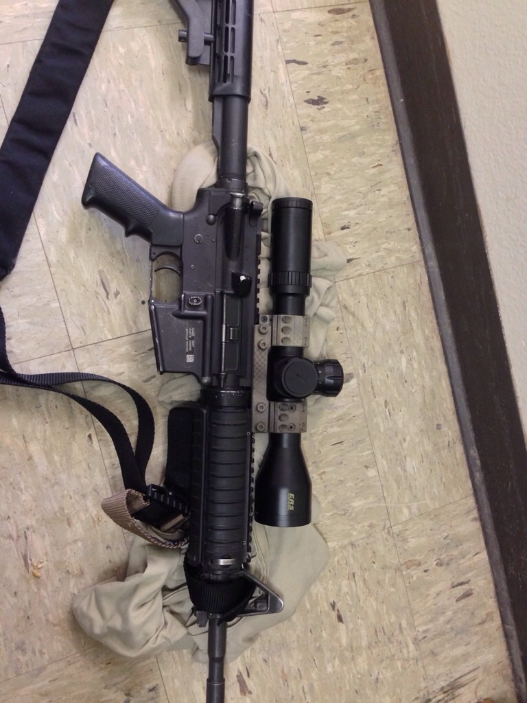

Only thing that concerns me now is at what objective mm size is it too obnoxious for a m4?...
There's my example. My bushnell ers on my duty m4... Ugly as fuck and pointless.
