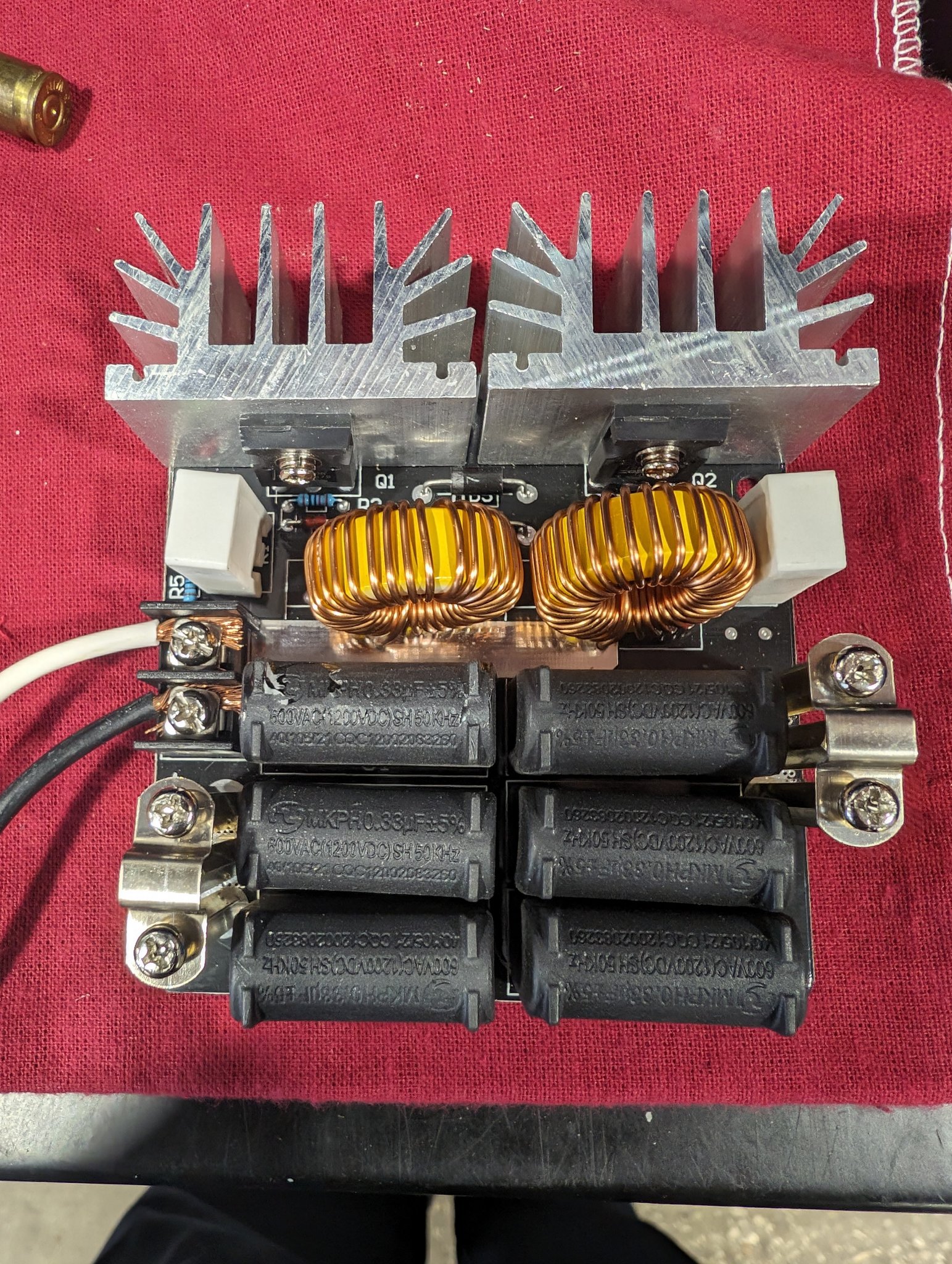

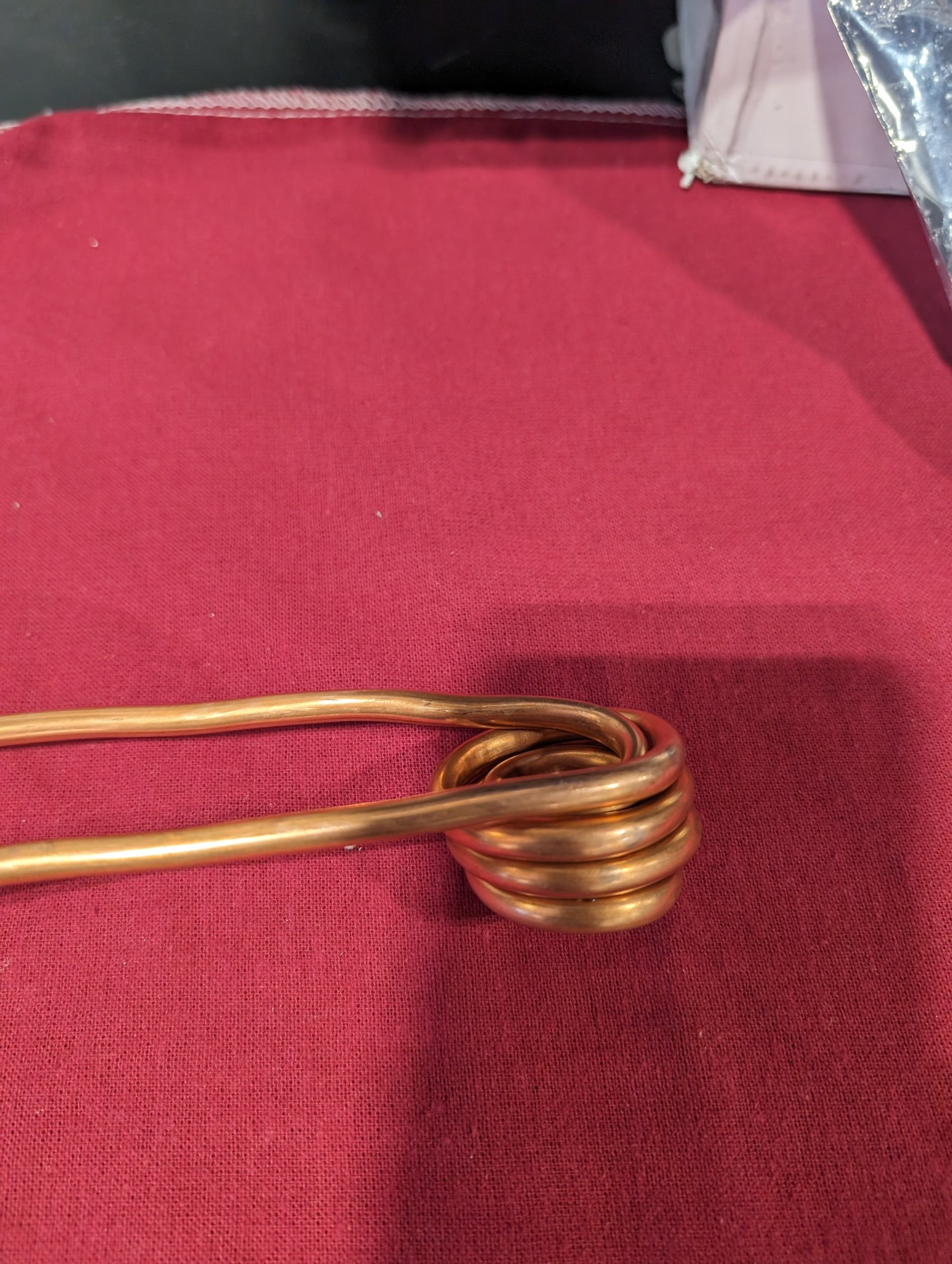

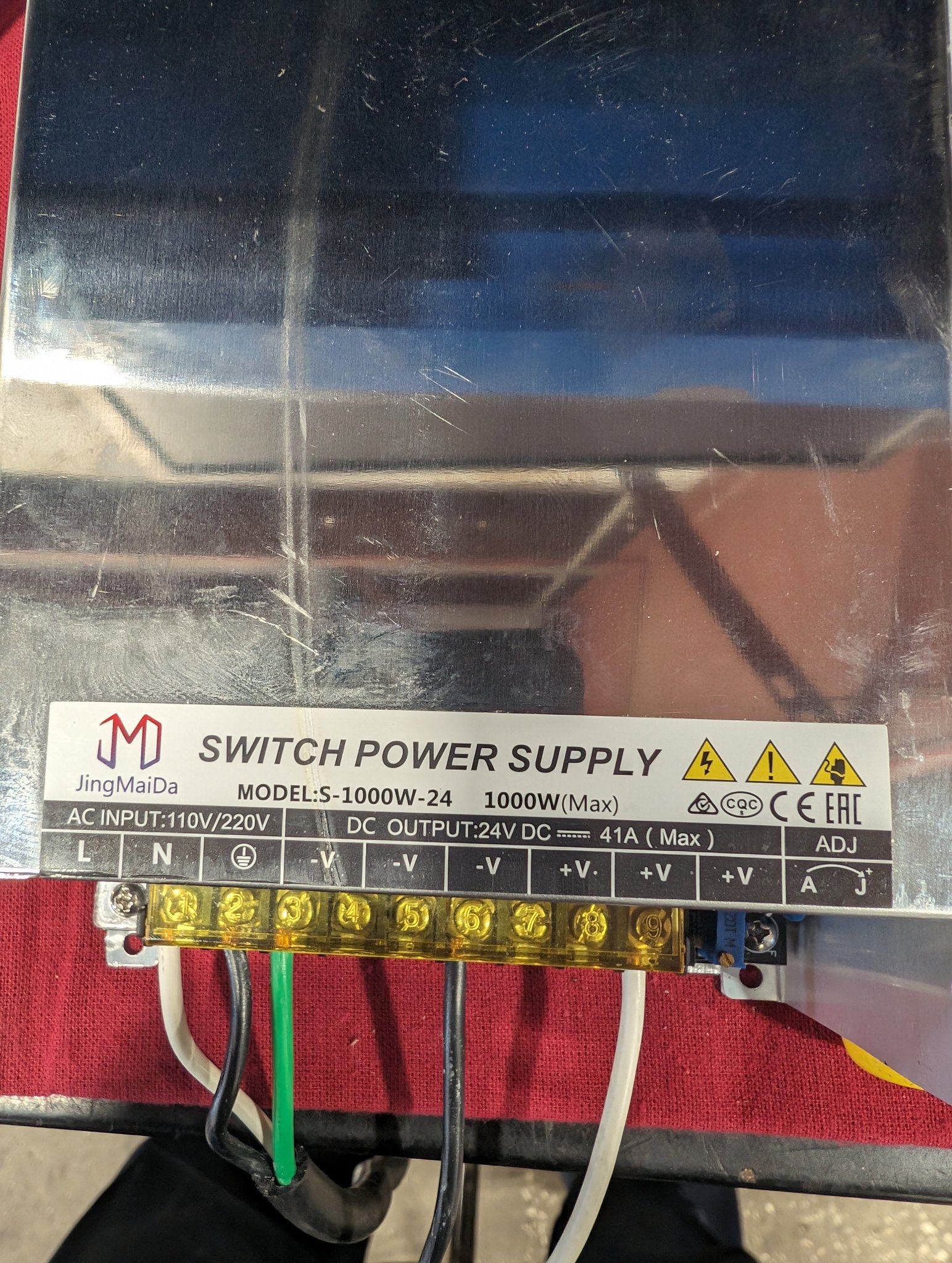

This is my power supply and board. I need help designing a coil that could be water cooled. I tried making on out of 1/8 copper tube. Inside 20mm outside is 42mm and it's 27mm tall. Using that coil on a 308 case it doesn't heat at all.
