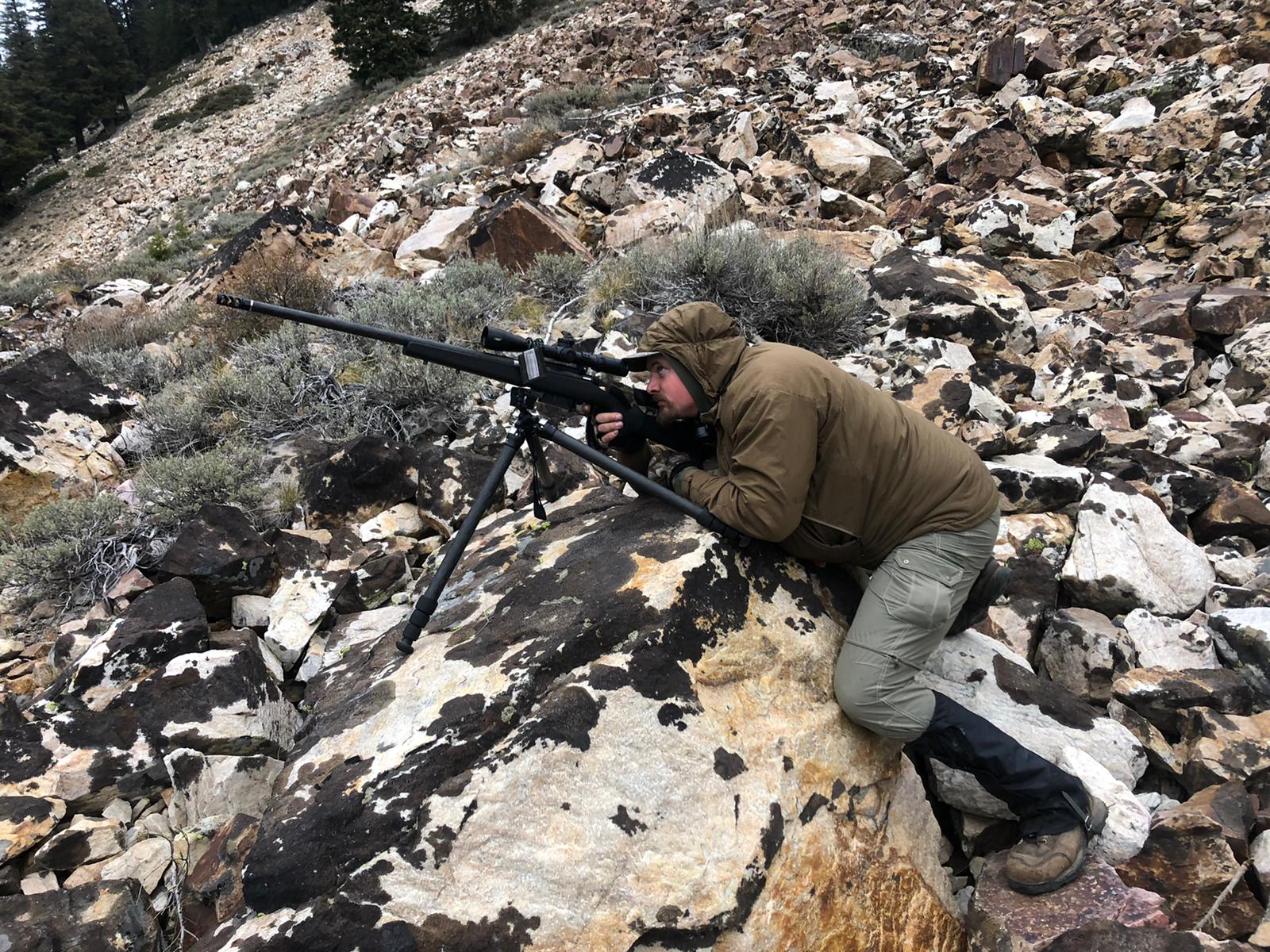

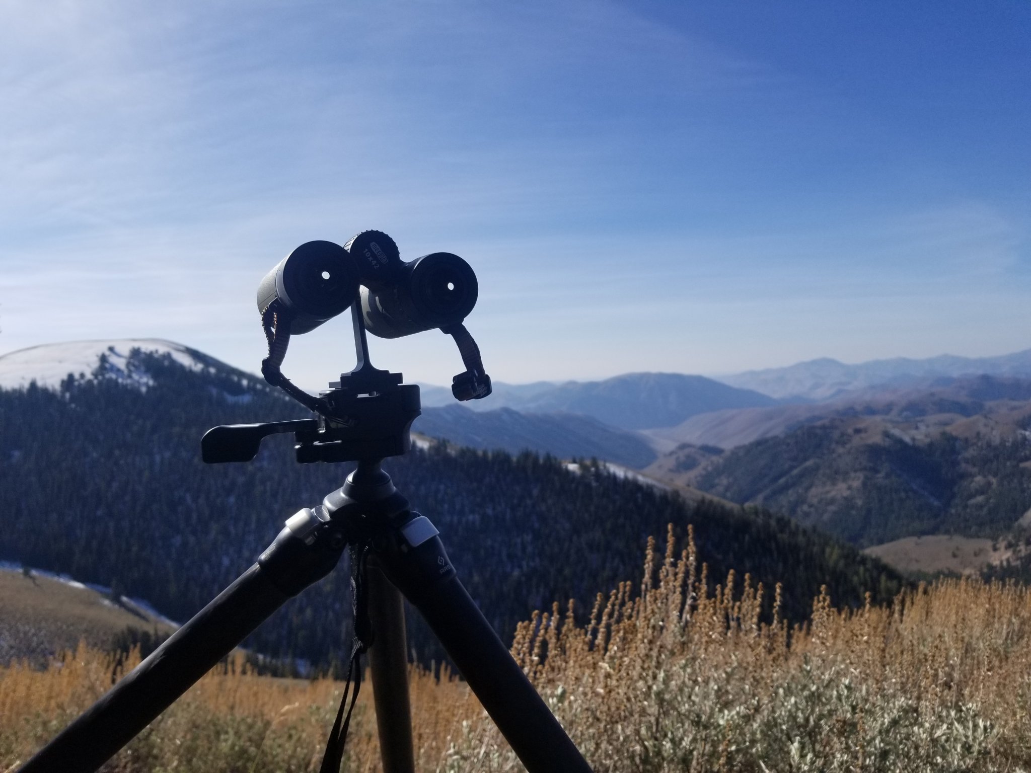

Not sure what your budget is, but i have an RRS TFCT24L-
that comes with the Anvil 30 ball head. The Anvil 30 has built in pic rail and arca attachments. For my binos i use this mount-
http://www.fieldopticsresearch.com/...e-Binocular-Tripod-Adapter-GEN-2-sku-A001.htm
on this arca plate-
and looks like this-
Since this ball head accepts both pic rail and arca, i use this bottom metal in my stock-
https://redhawkrifles.com/hawkins-m5-style-detachable-magazine-bottom-metal/
with this part added on-
and that looks something like this-
and allows you to do things like this-
I can swap between binos, spotter, or rifle in seconds..

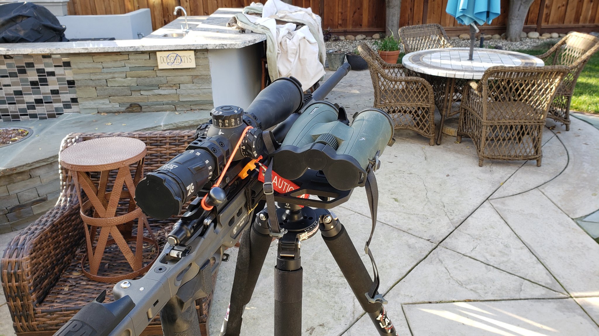

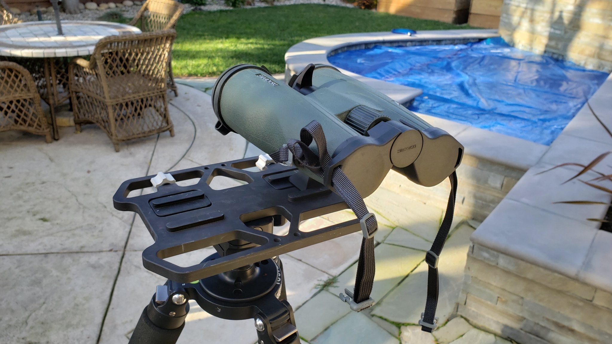

Is this what you are thinking?
If so I would be worried about the torque on the bino when the rifle is fired, not sure if I would want my Swaro's exposed to that.
In this pic the rifle is resting on the greyops plate, it has two arca slots but not in the right orientation to do what you want.
