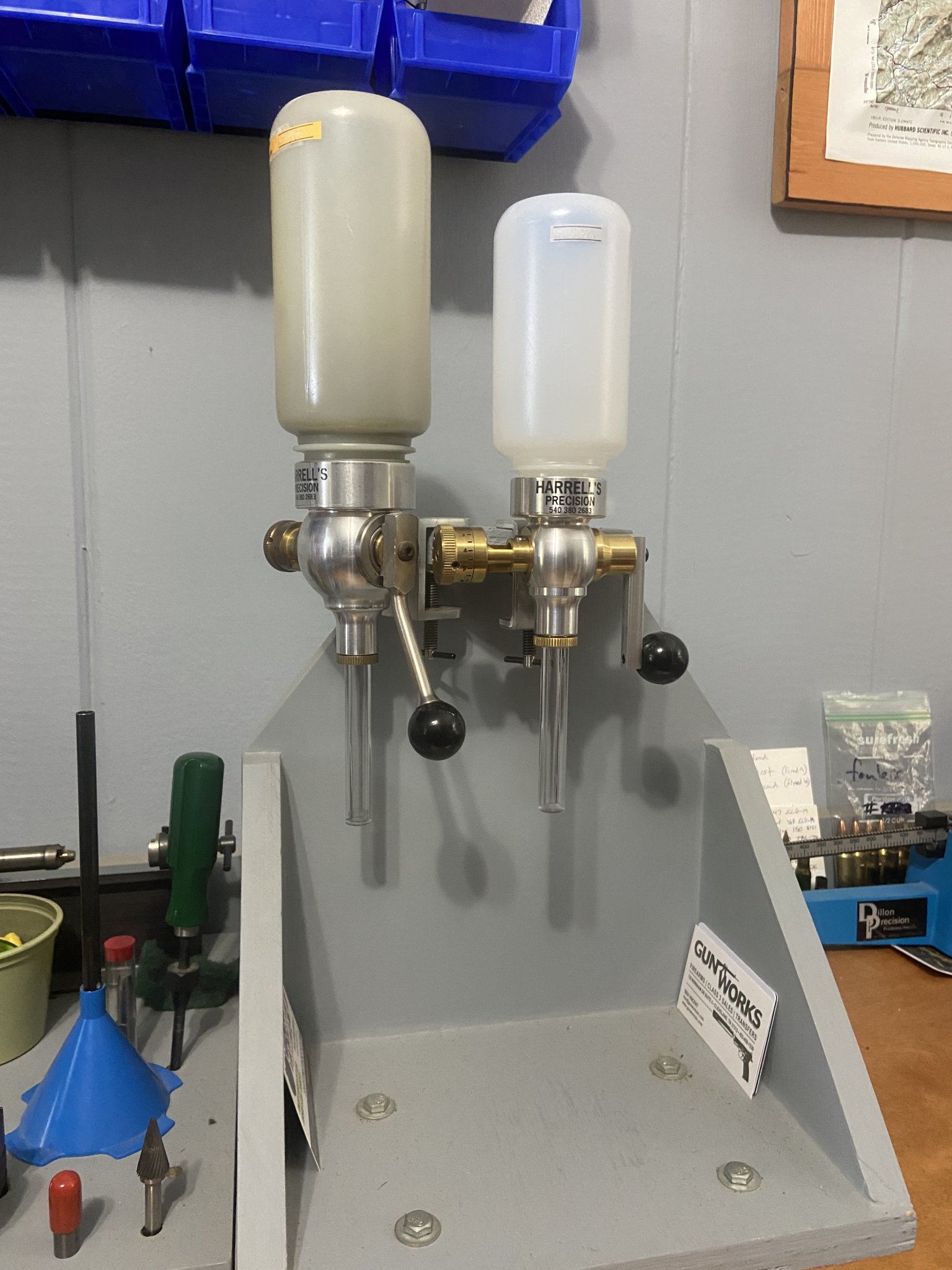

I’m using TAC for my new load in my Tikka .223 T3 Varmint stainless. It’s a really fine ball powder and I find my Lee powder measure isn’t up to the task. I’m dropping kernels all over. Can anyone recommend a better powder measure?
P
For fine ball powders, it’s hard to beat Harrell’s. Repeatable precision. They don’t work so great on stick powders so I just set it a little below my target and trickle up.
